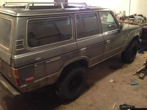

i just put these on for winter tires (we have 5 months of winter here so why not look good during that half the year too right?). they are from summit racing $127 each. 16 x 8 with 3.625 back space. lots of clearance. i used gorilla splined lug nuts with a centring sleeve (sorry no picture) and they fit perfectly.
i put studded goodyear duratracs on. i'll see tomorrow how they do on the ice.

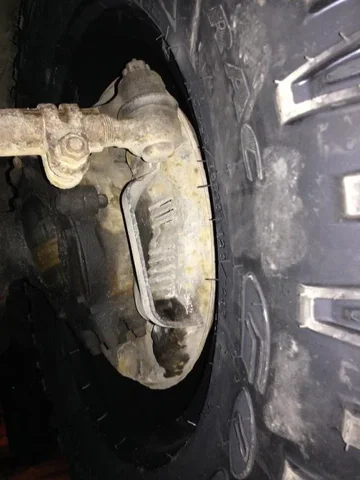

test fit before mounting tires
here is the part number from summit...
Allied Wheels 887-68060B - Raceline Rockcrusher Black Satin Wheels

Stock backspacings on the OEM rims is 3.625" (3 5/8) so a 3.5" is the minimal you are going to be able to get without it interferring with the TRE or calipers. Basically, it will all depend on the make of the rim more than the size/backspacing. You can get D-Window style rims with 3.5" backspacing but stil have issues with them touching the TREs at full lock.

Wards Dad - yes those will work but they may need spacers. Stock backspacing on our trucks is 3.625", the ones you linked are 4.25" meaning that you would need about a 3/4" spacer. However, since they are wider rims, your pro comp guy MAY be correct that they will not hit the TREs or the caliper. Easiest way to check is find someone on here that has them or buy them and mount one up (no tire needed) and turn lock to lock to see if it hits anywhere.
