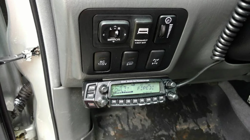

So I got my faceplate kit today for the radio, did some looking around for places to mount it, and while I liked some, other looked cluttered and some just plain were not gonna happen that I wish I could of made work, in the end I went with a 3m double sided tape mount to the interior fuse panel door... Works perfectly and I didn't have to drill any holes so I'm happy! Now I just need to remote mounting the mic and I'll be good, but for now I have my radio up and running!
Sent from my XT1585
So I moved where I had the radio faceplate after hitting it with my knee... I hacked up the mounting bracket that comes with the faceplate kit to make it fit under the ash tray, and above the 120v socket at the base of the center tower. The ash tray still opens (just have to tilt the face down) and its outta the way and more centeral to everything else. I like this much better. At first I was trying to put it on the steering column, but with it telescoping in and out when the vehicle is turned on or off, it would not fit -the telescoping tavel is to great. So i had to find a new location, after some brainstorming I came up with this.
