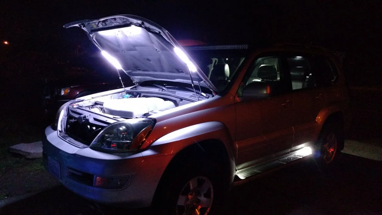

Even though sometimes I work best in the dark, or so I'm told anyhow... I installed a set of work lights to help with those late night projects/repairs.
I am very pleased with the outcome. There is almost zero shadows when working under the hood now and it's a very clean install. I'll get some pics in the daylight to show you the wiring.
I just hope my quality of work doesn't go down now lol...
