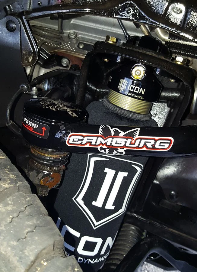

Icon extended travel front coilovers with neoprene covers
Camburg balljoint front UCA's

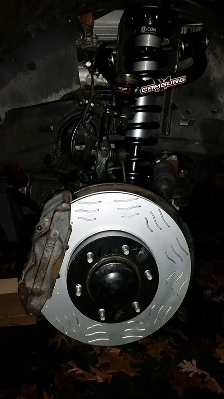

NAPA REACTIVEone front brake rotors and pads

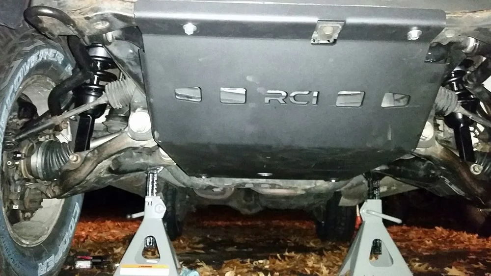

RCI skid plates all around

man, that is exactly what a wife imagines when you "finally" get to do what you want! looks like a blast
What exactly does this entail? sounds a bit more secure than tricking airbags..1/4" worth of spacers in rear suspension height sensors
-newb
There are ride height sensors in the rear for the rear air bags that are bolted onto the frame with 2 bolts. You put spacers/washers to space them down from the frame, it is a 1:3 ratio i think, so the 1/4" worth of washers equates to 3/4" of lift in normal mode. So no tricking the air bags to stay in high mode. I think the Icon fronts gave it 2.5" of lift and the rear is already way higher than the front so 3/4" more lift in the rear made it pretty level. I only did this so that I can have time to figure out what rear suspension setup I wanted to go with. I really needed to do the front suspension bc the stock components were in really bad condition and the truck sucked to drive.

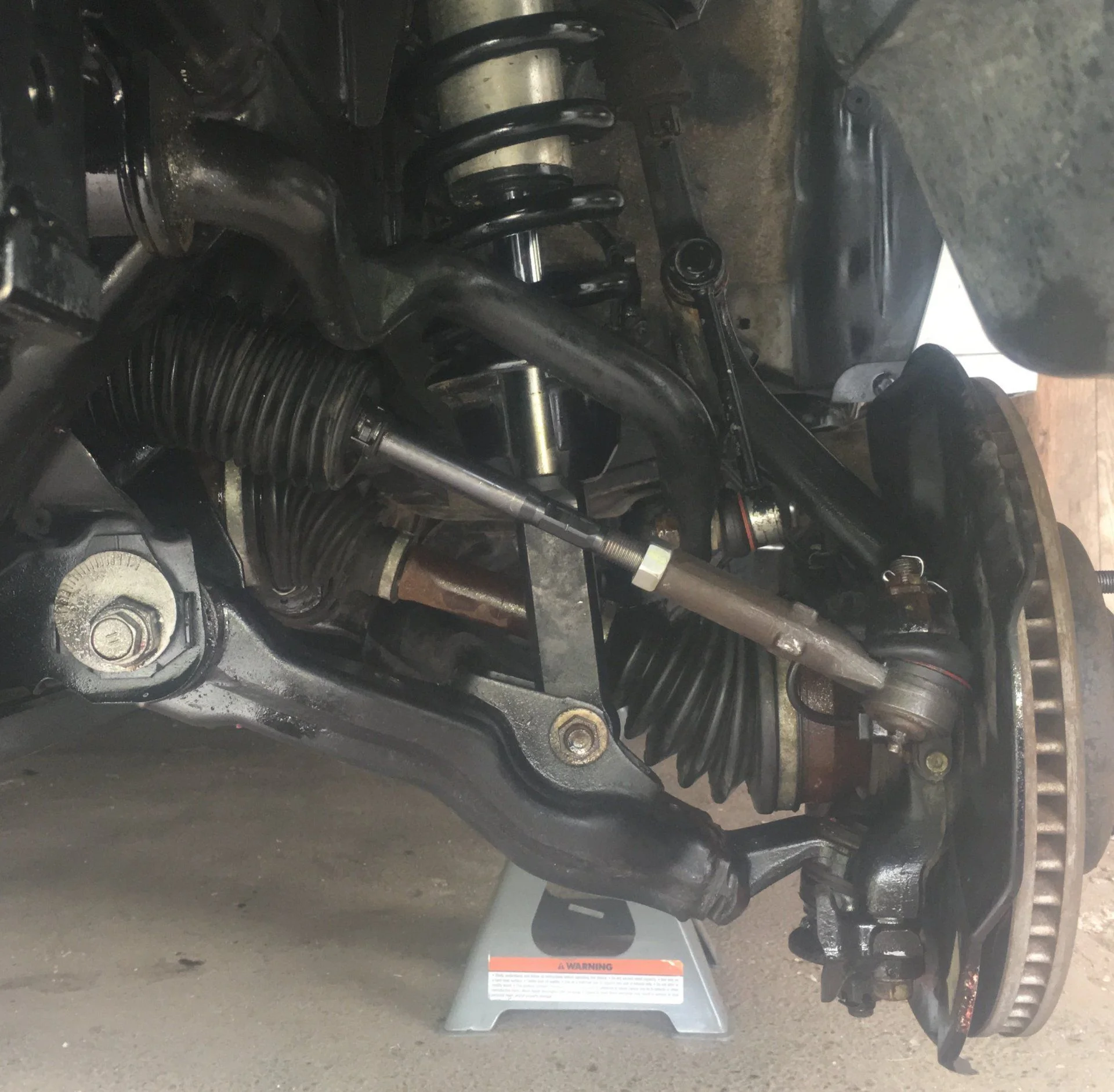

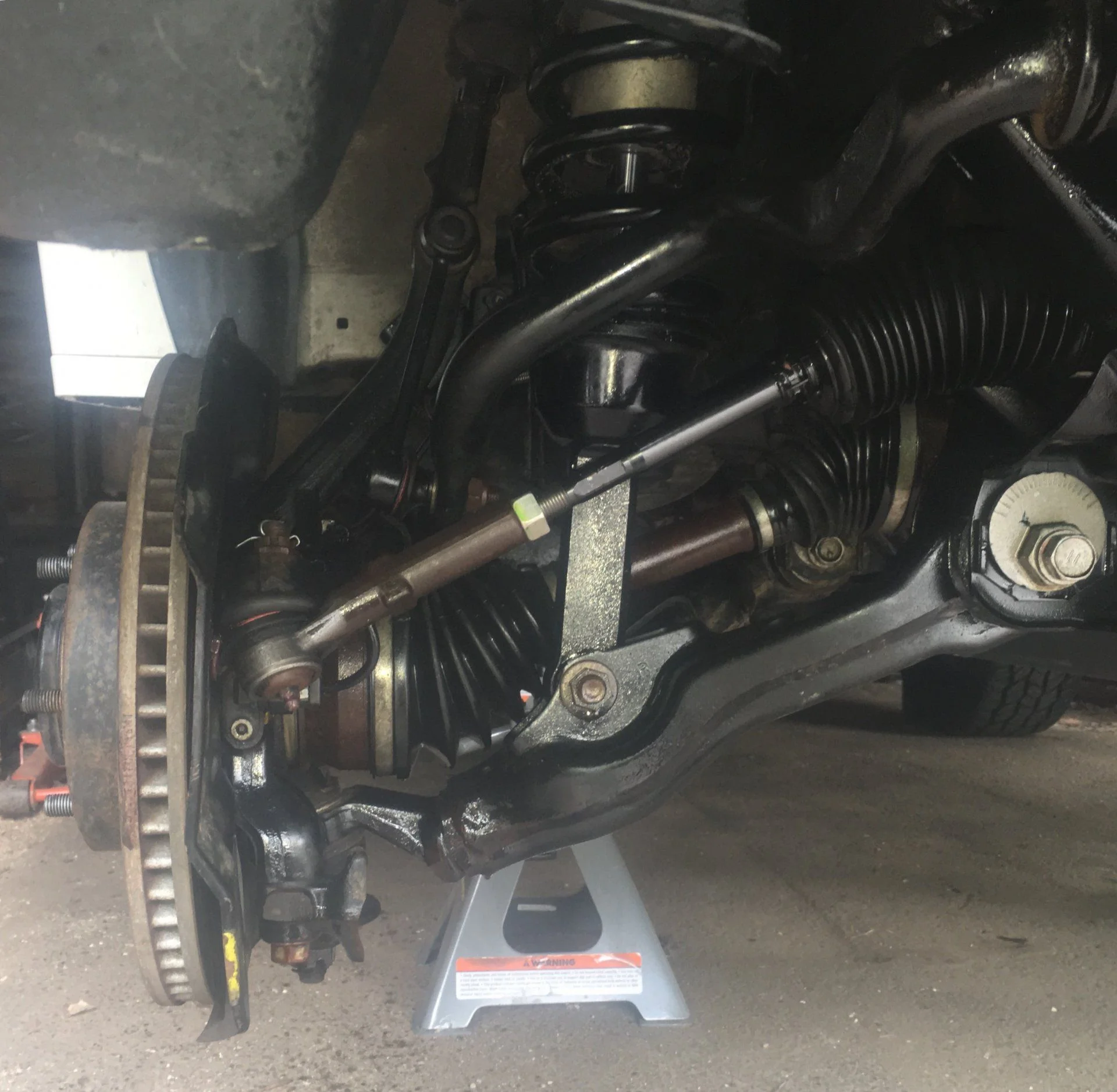

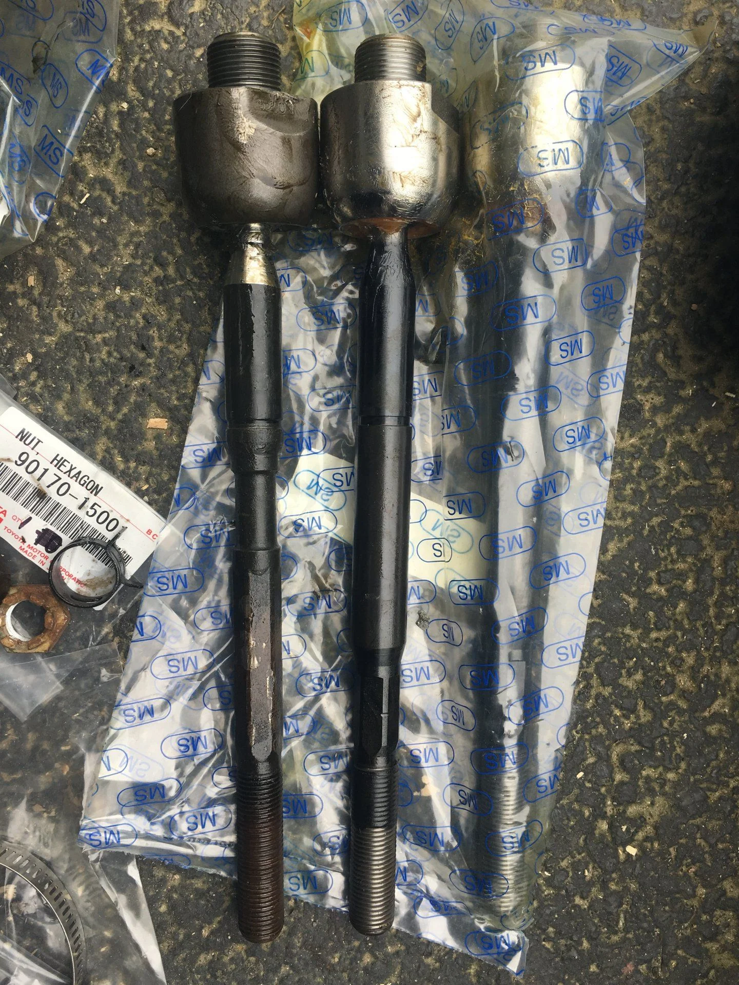

I finally had time to replace the inner tie rods yesterday. This was long over due, the stock inner tie rods had so much play in them.
I went with this brand made in Japan and they looked really beefy in the pictures I saw online.
I had already replaced the outer tie rods with greasable ones from Deeza that were beefier than stock.
may i ask why you replaced the inner tre's? you mentioned there was lots of play. i'm curious to know if there were vibrations, noises etc. that led you to narrow it down to the inner ends.
Well it has 160,000 miles on it so a lot of things need to be replaced. And yes once I did the lift and the bigger tires I did notice sloppy steering. No vibrations or anything just not tight steering, it is better now. I am slowly working on replacing everything.
I know the bushings for the steering rack flex a lot but I won't be able to replace the bushings or rack for a while.
All you have to do is jack up the front, grab a hold of the tire at 3 and 9 o'clock positions and push/pull it back and forth with some force but just enough to get a wiggle out of it. If your tie rods are bad you will feel a click or even a clunk. At this point you can have a helper wiggle it while you feel around. Put your hand on the outer tie rod ball joint, you may feel the play there, you can also grab the inner through the boot and play may be felt there as well. It's usually a good idea to replace them as a pair. Also check the lower and upper ball joints for play in the same fashion, also try 12 and 6 o'clock positions. Hope that makes sense.
