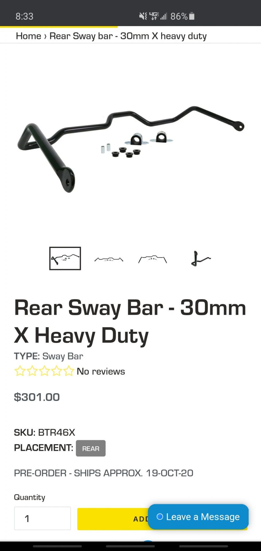

Still have the whitelines rear sway bars in stock? I am in for one. Does this come with the links as well?
Ben
Ben
Yes I do, mounts are only included, not the links.
Awesome, would you mind sending me a link to the product and what's included as well as a price. Feel free to pm me as well. Thanks in advance! Is it the 30mm? Image attached.

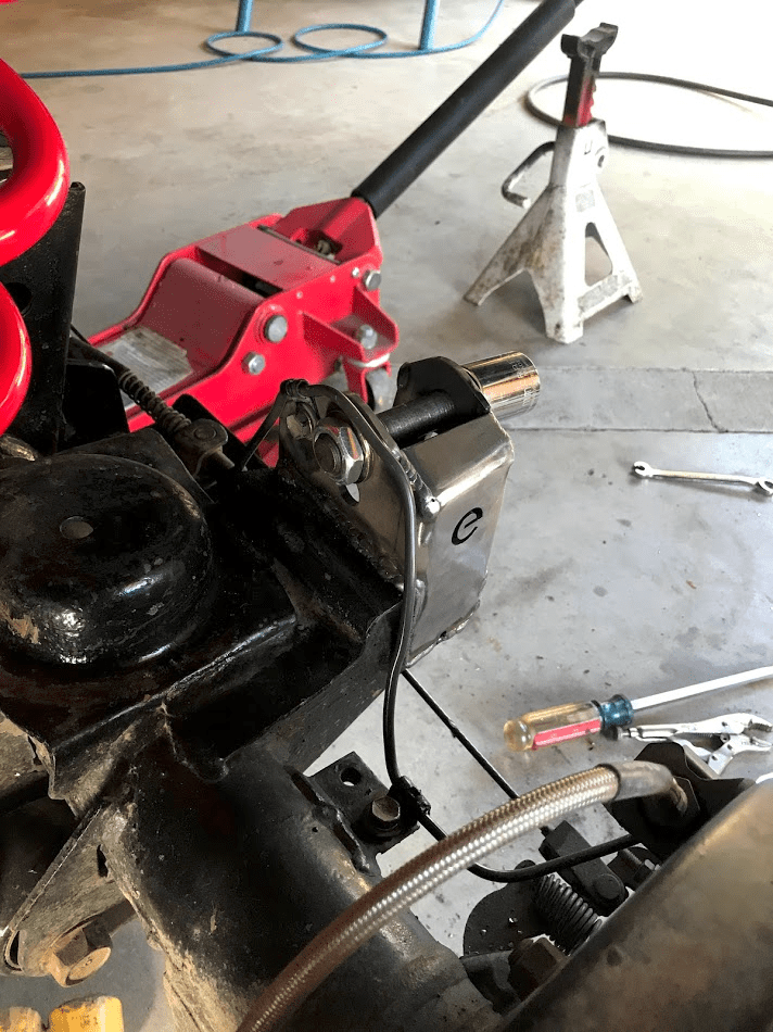

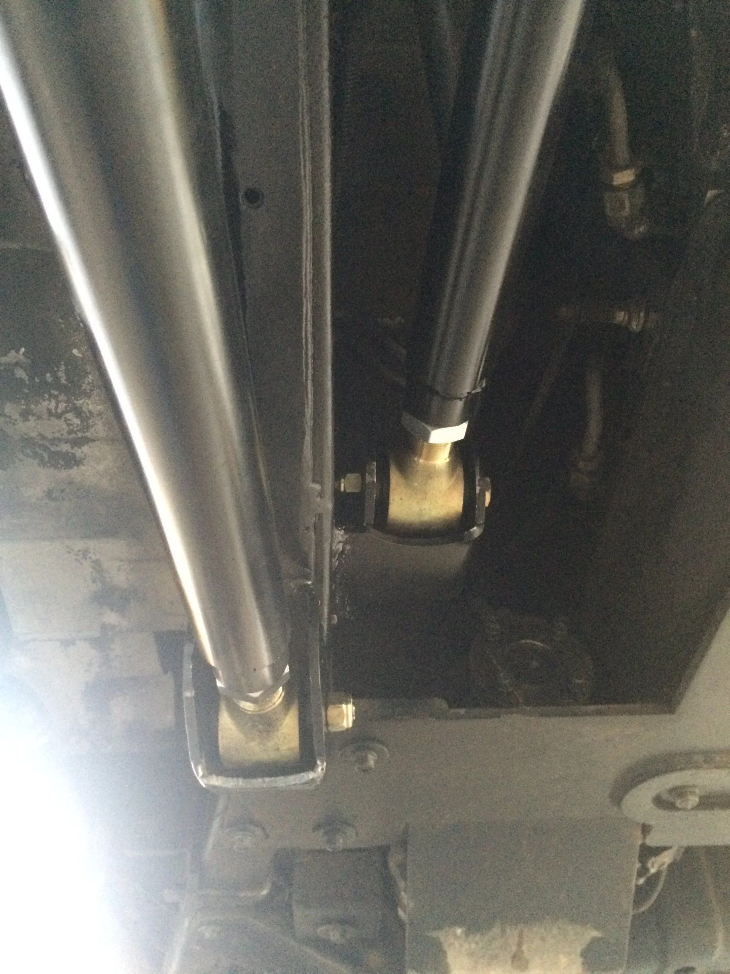

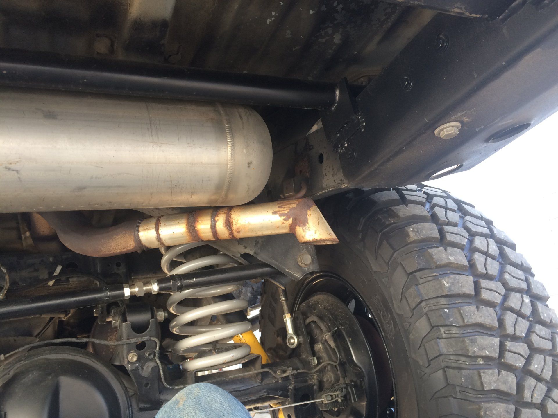

Here's the kit I used

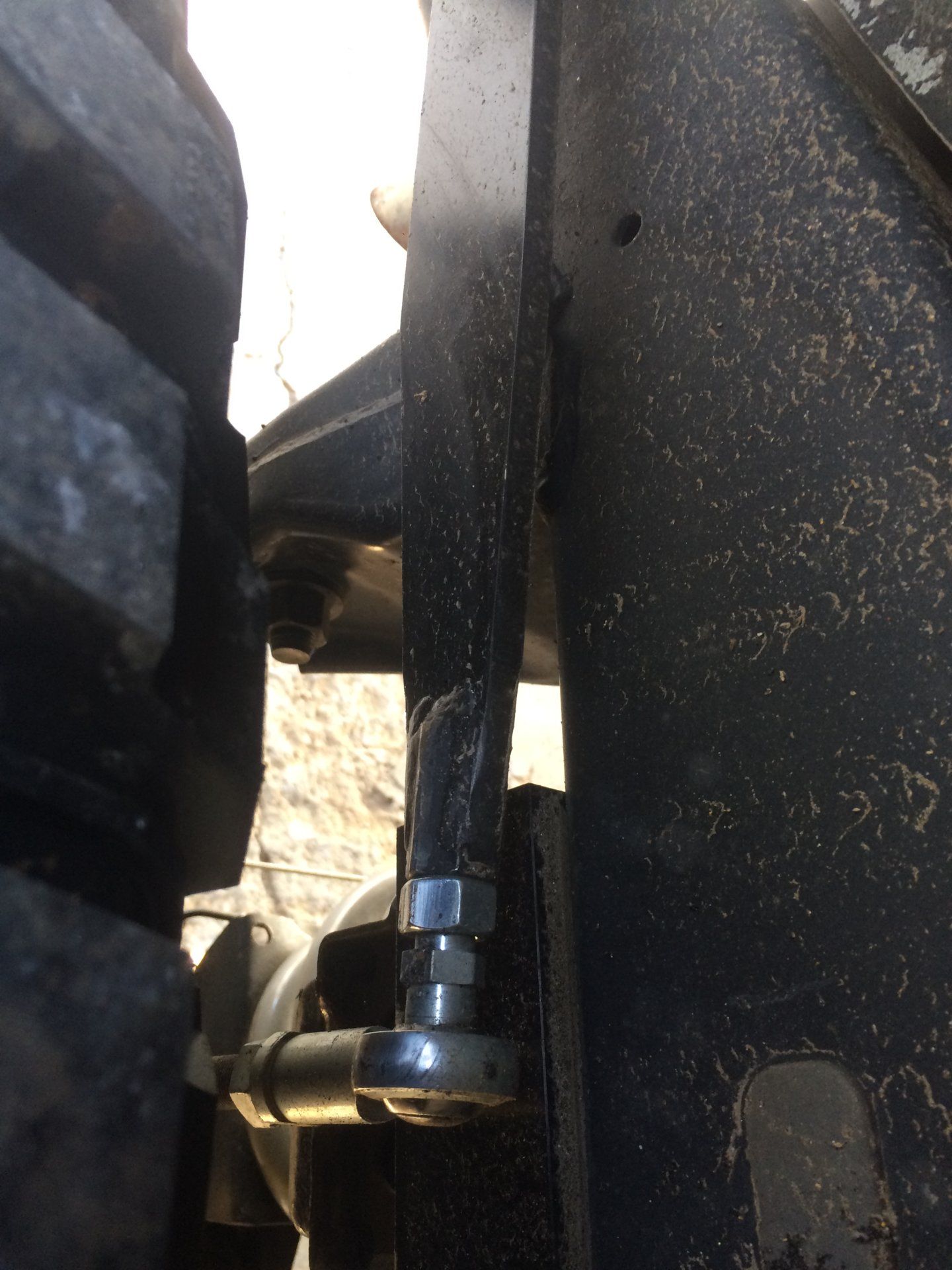

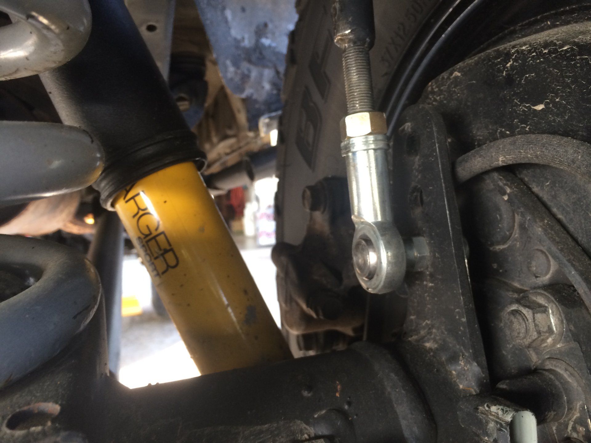

Once I had the kit, I swapped the link arms side to side to get the flat part of the arms closer to the frame.( the arms have a gusset on the inside that makes the arms sit to far away from the frame, so by swapping side to side the gusset is on the out side now).
I Pressed the arms almost flat then notched the ends of the arms and welded threaded bungs in so I could thread the links straight into the end of the arm. (The arms are too close to the frame and tire to have the links come in on the flat side).

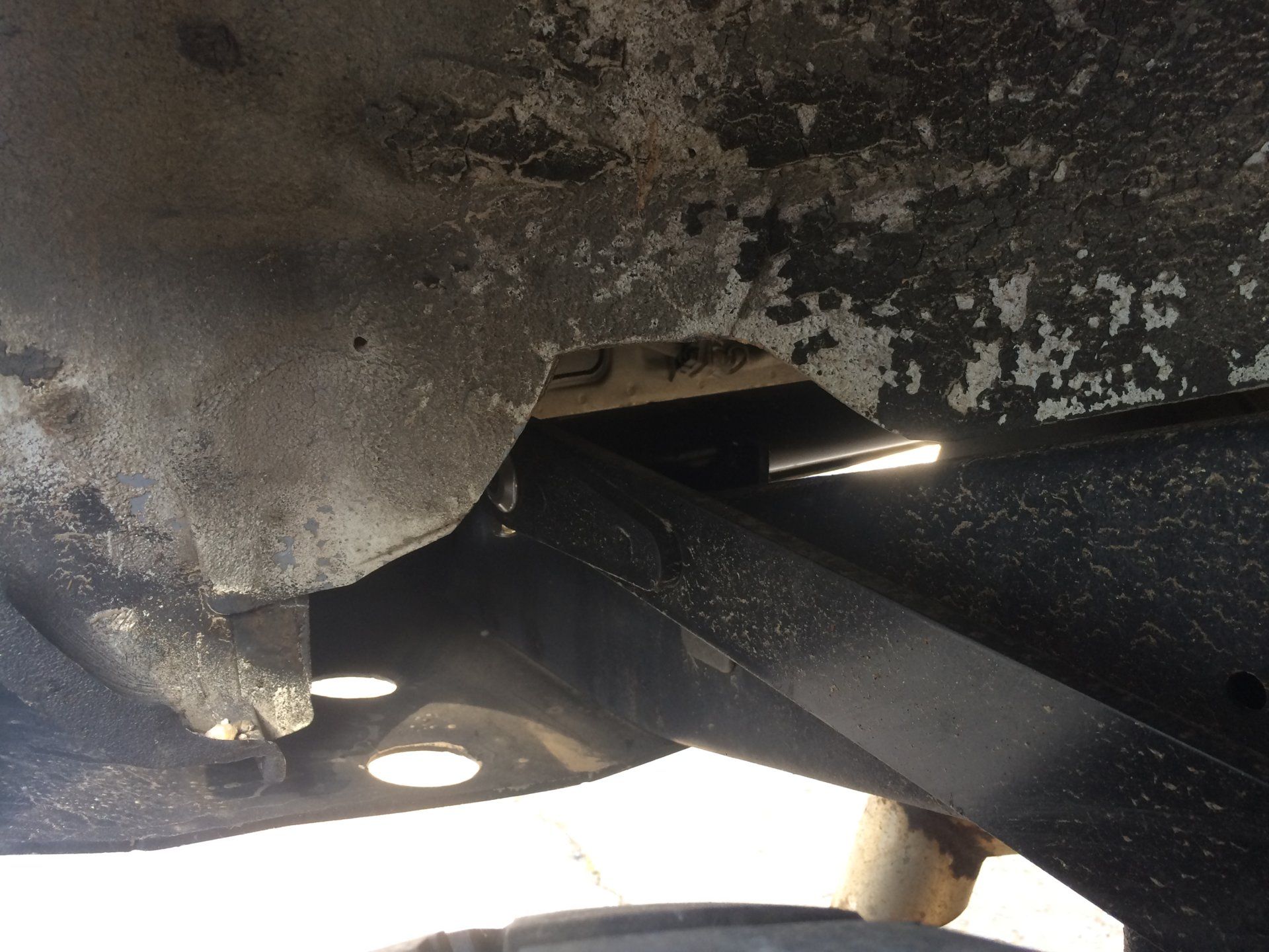

I centered my axle in the wheel well so I was able to push the swaybar back about 2" which lands the tube more on the flat surface of the frame which makes clearing the body a lot easier, you will still have to notch the inner fender well on the pass side a bit.
CE-9906-21 - Universal Antirock® Kit (50" x 1" Bar, 21" Steel Arms)

I really like the way you have it tucked in up there and with my new wheels I now have the needed room for this mod. The biggest reason that I removed the factory ones is because the hang down and get hung up on everything.

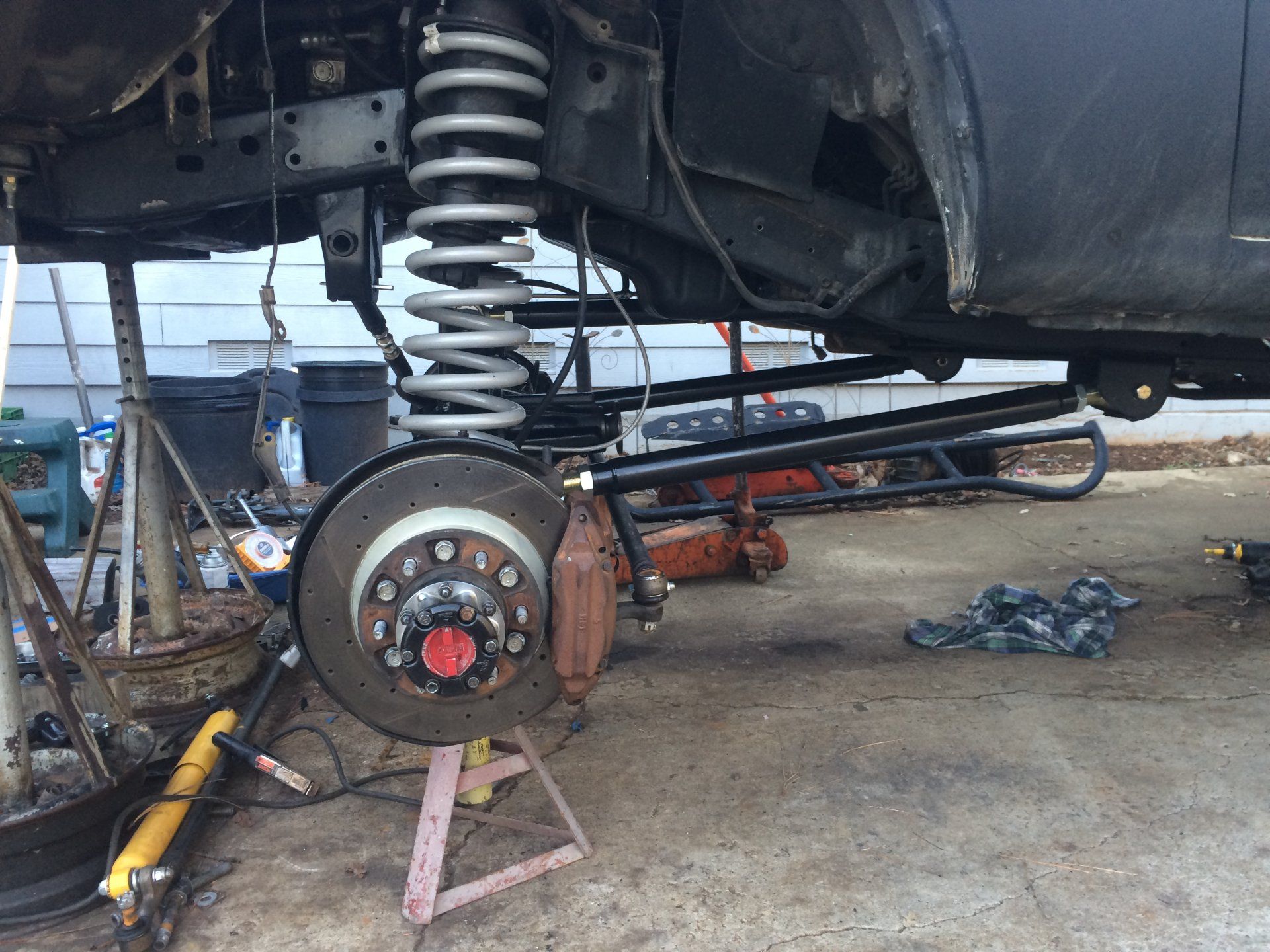

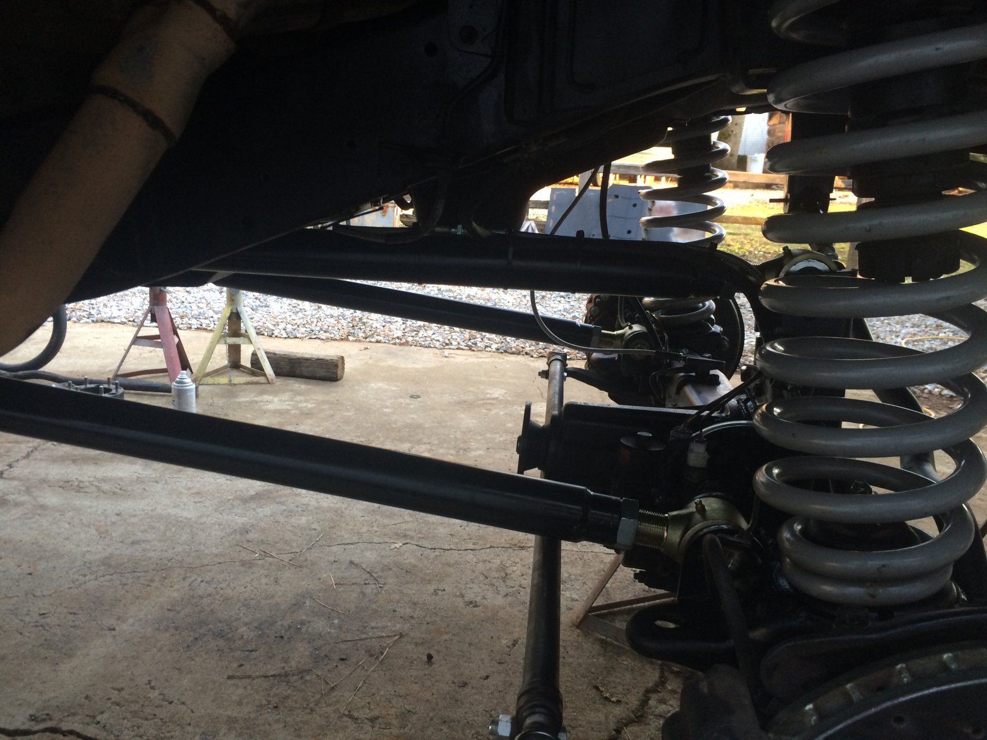

Pictures of your Three link setup ? or build thread
I did a lot of cutting to make the 39s fit on a low lift.
