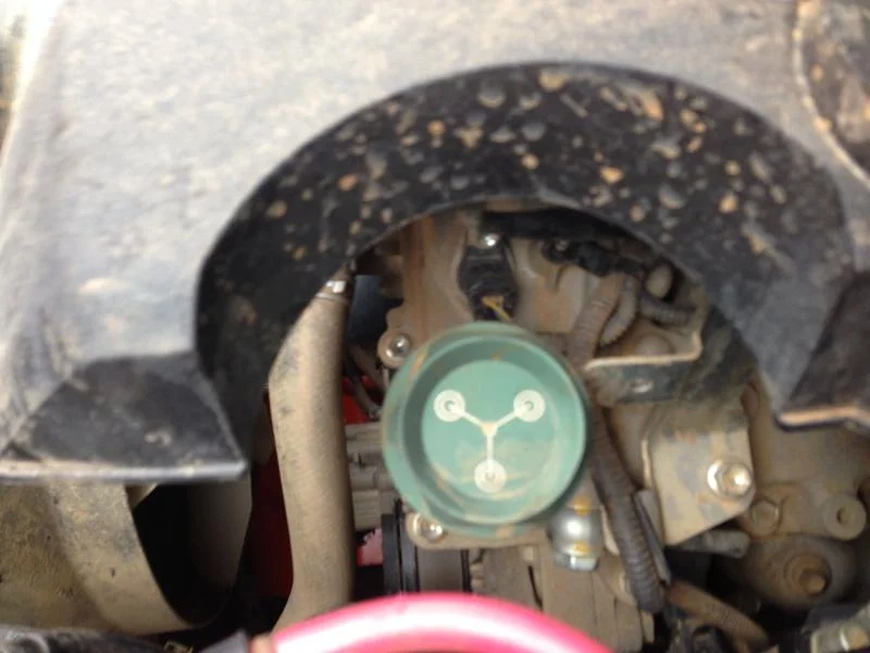

Upgraded my old 1 gallon Expedition One replacement windshield washer reservoir to a new 2 gallon Expedition One replacement windshield washer reservoir.
I've had a flux capacitor for years..... Its green , BTW.
I would think Mr. Fusion. Plutonium is just so last year.........

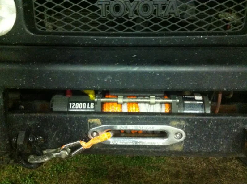

Replaced my steel cable with ultrex that I spliced myself :)
Also put on the EHEO fair lead, which will eventually get anodized for prettiness

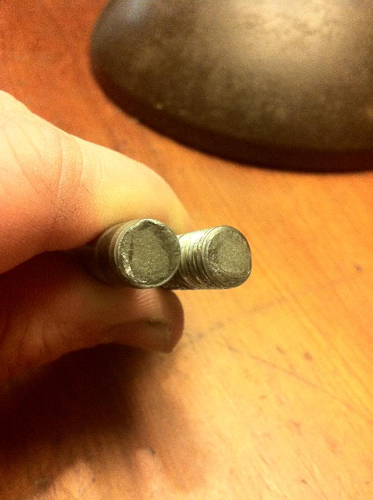

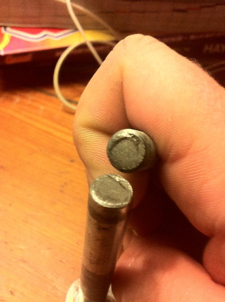

Post some pics of broken bolts if you get a chance
The more I look at the it, the more I think that it is just breaking in a weak spot in the bolt. Here are a few pics. Both bolts broke in the exact same spot. Maybe the alternator is slightly bouncing and the bolt just can't hold the extra weight. It's just weird that the first bolt lasted a while and the second one didn't.
what grade bolt is it ?
I reckon it is whatever the metric equivalent is to a grade 5. Both bolts that broke were from Toyota.
