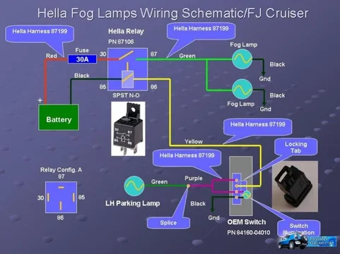

Found this on the blue room, should give you the general idea
well assuming you want them on three seperate switches you just need to make the above circuit 3 times. Plan ahead though and you can use a single power wire to a distribution block or same with grounding.

Yeah that stuff is like Chinese to me...ill give a 2x2 if ya help me out.
I'd be happy to, no need for the 2x2 though. Why not put both on your rig? Not really adding anything difficulty wise.
Let me install mine over the next couple weeks and correct any hiccups or things I forgot then we can get together and knock out yours.

Ok sounds like a plan
Do i need to break out the soldering iron and heat shrink?
