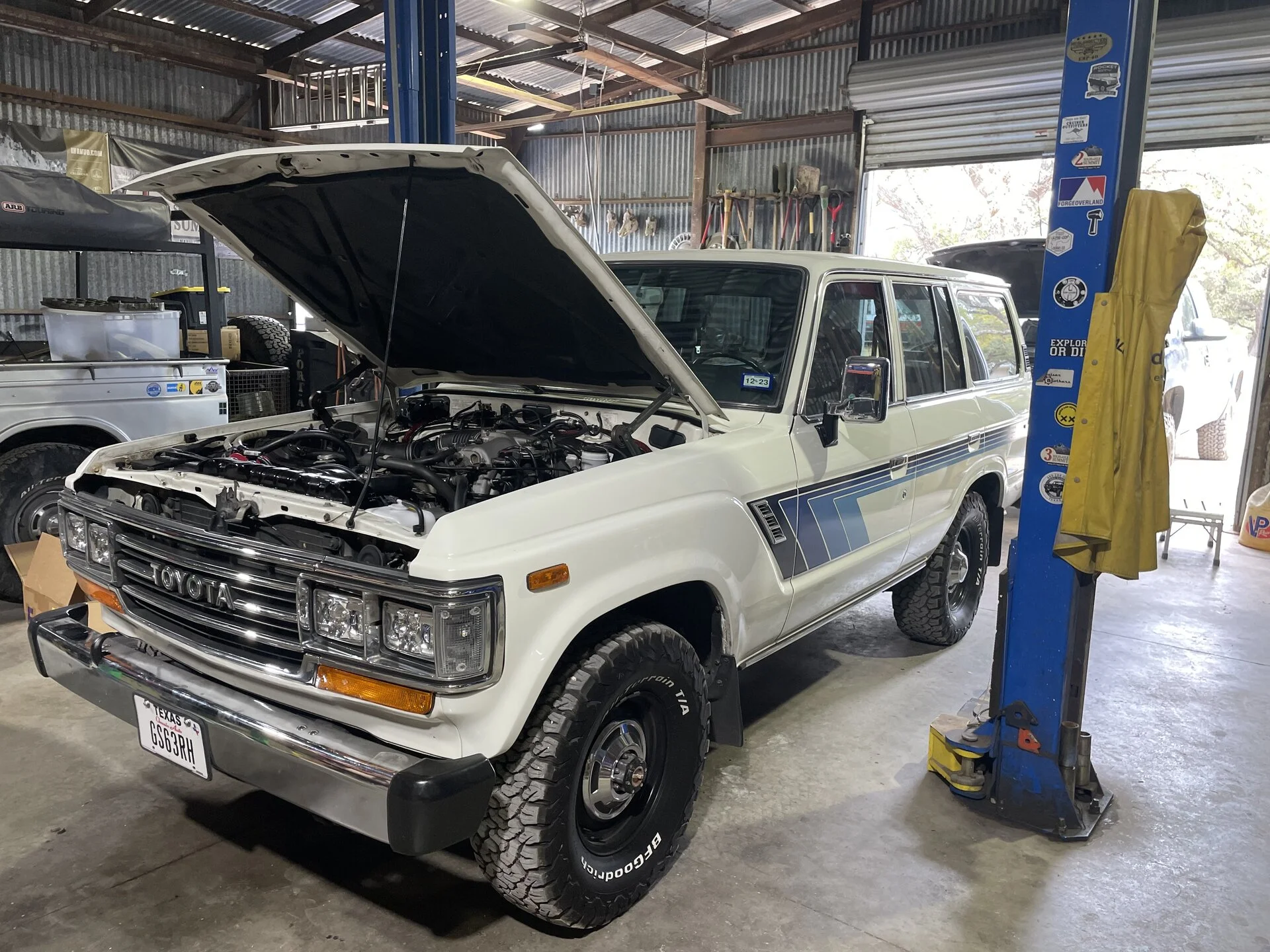

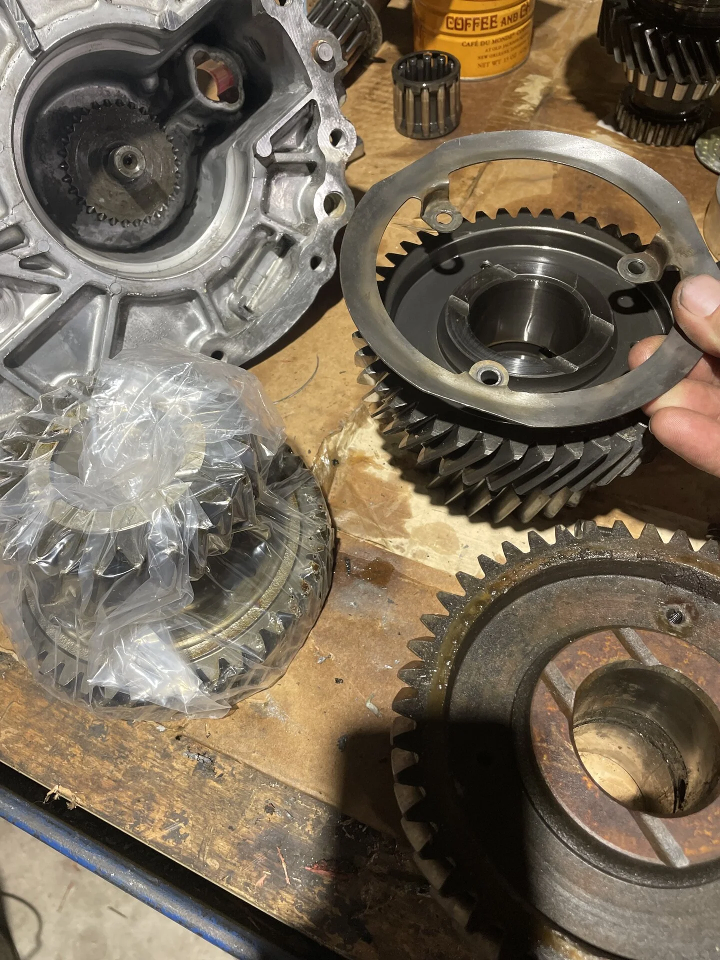

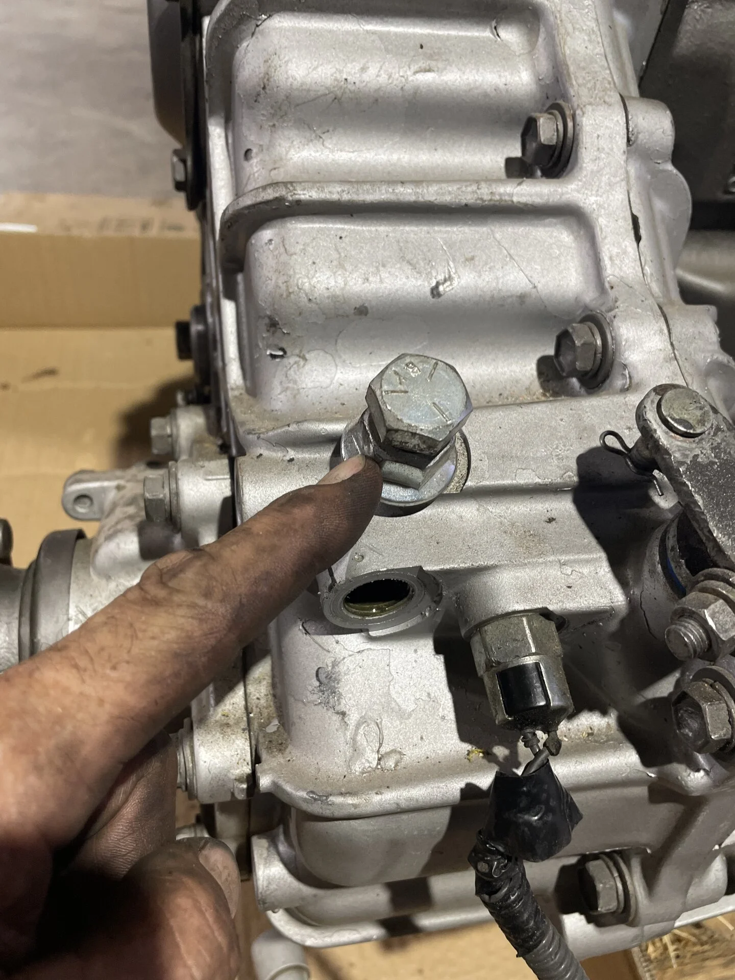

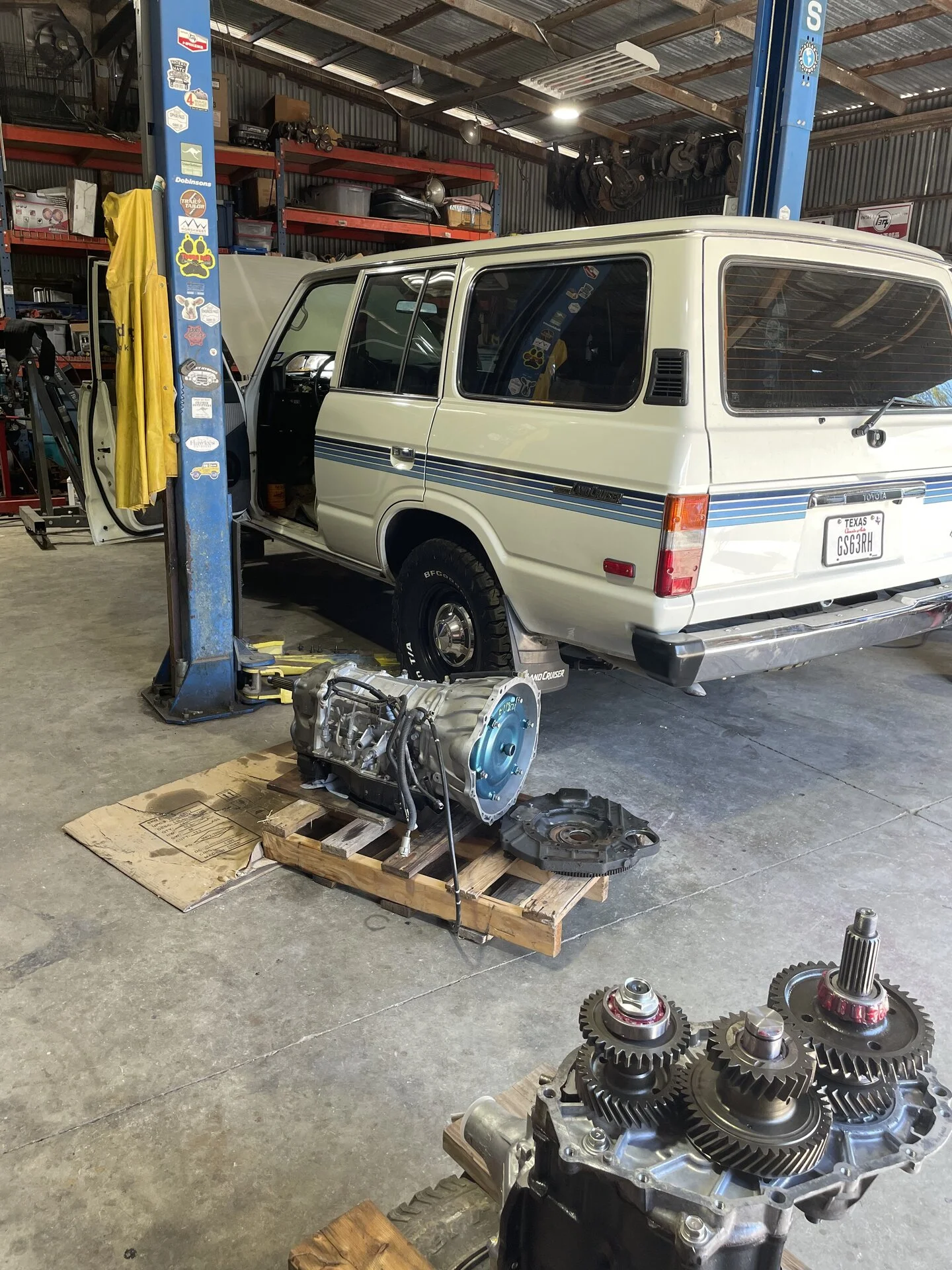

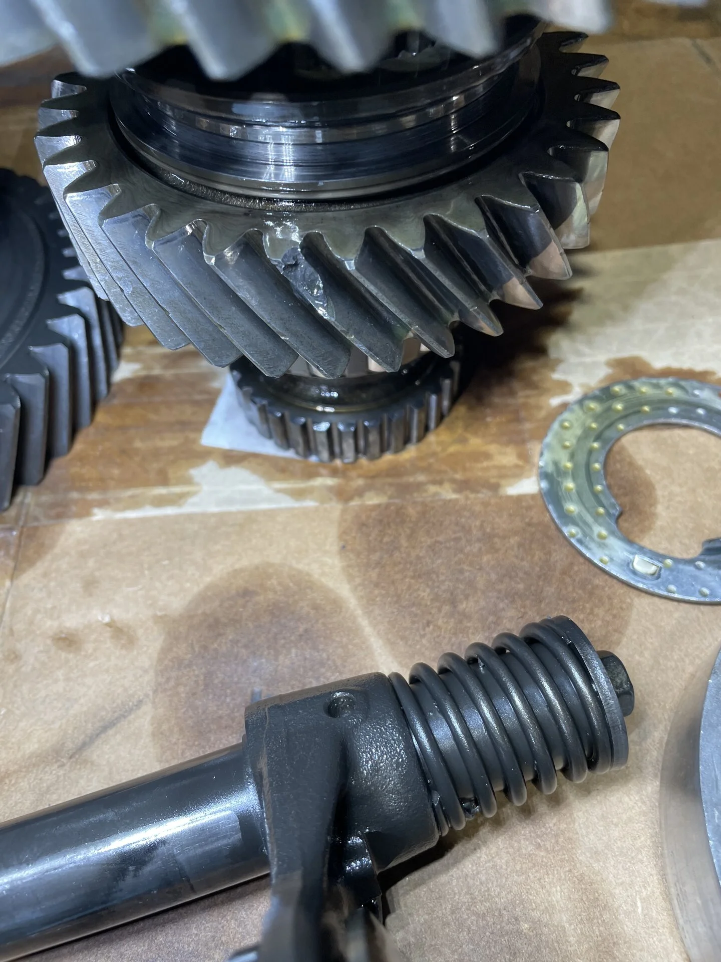

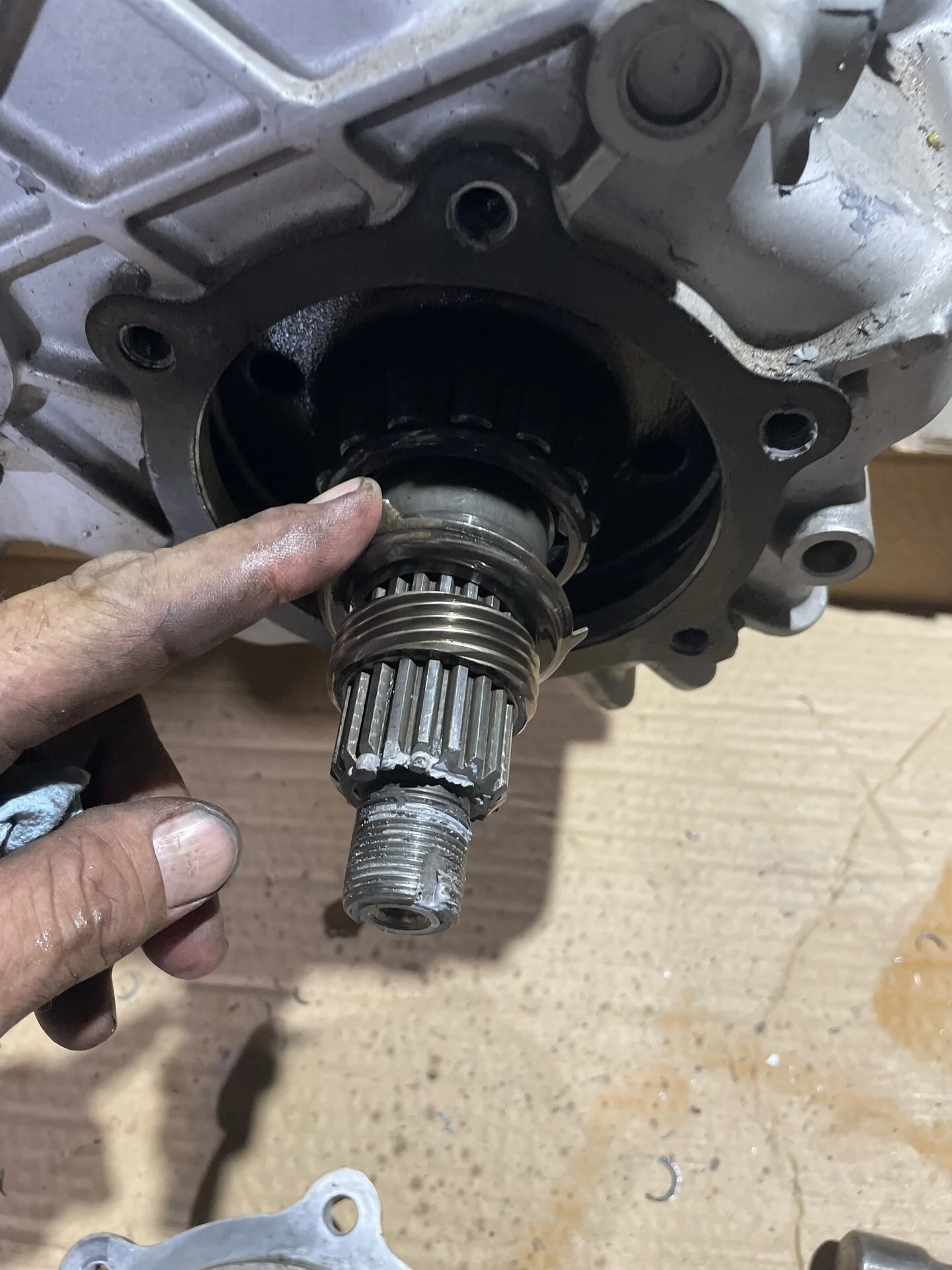

Been working on a really sweet 62 (yes, it’s trailer queen quality). Really cool owner @johnmckenna who’s not too active on mud. Los of jobs includes putting in a H55 (done), full carpet kit install from DMP, complete suspension upgrade to OME and then replacing all cooling/heater lines under the hood. Matt @cruisermatt has supplied all the new OEM parts needed for the jobs. He’s got several great parts that make the H55 conversions easier/faster (NSS harness, shifter block off plate, shifter linkage etc…). This truck has been a dream to work on due to the care it’s received with PO’s. John picked it up about 2 years ago. Funny enough it’s the first A440 I’ve pulled that was functioning correctly. Fortunately he’s found a good next owner in the Austin area. So back to the H55 conversion….there are stacks of receipts on this truck and it’s clear the trans has been gone through. The unfortunate part is a transmission shop did the work pulling and installing a rebuild kit on the t-case. You would think they have a book or can research online how to do one. There were zero shims on the output side (yep, lots of broken/worn gear teeth), they put the output oil slinger on the rear output between the spacer and speedo gear :(. They lost the bolt for the spring indent ball so they hollowed out a 1/2” bolt and used that. All good now as we installed new gears, shims etc. and the preload came in around 15-16 inch pounds. Enough commentary. Here’s some pics

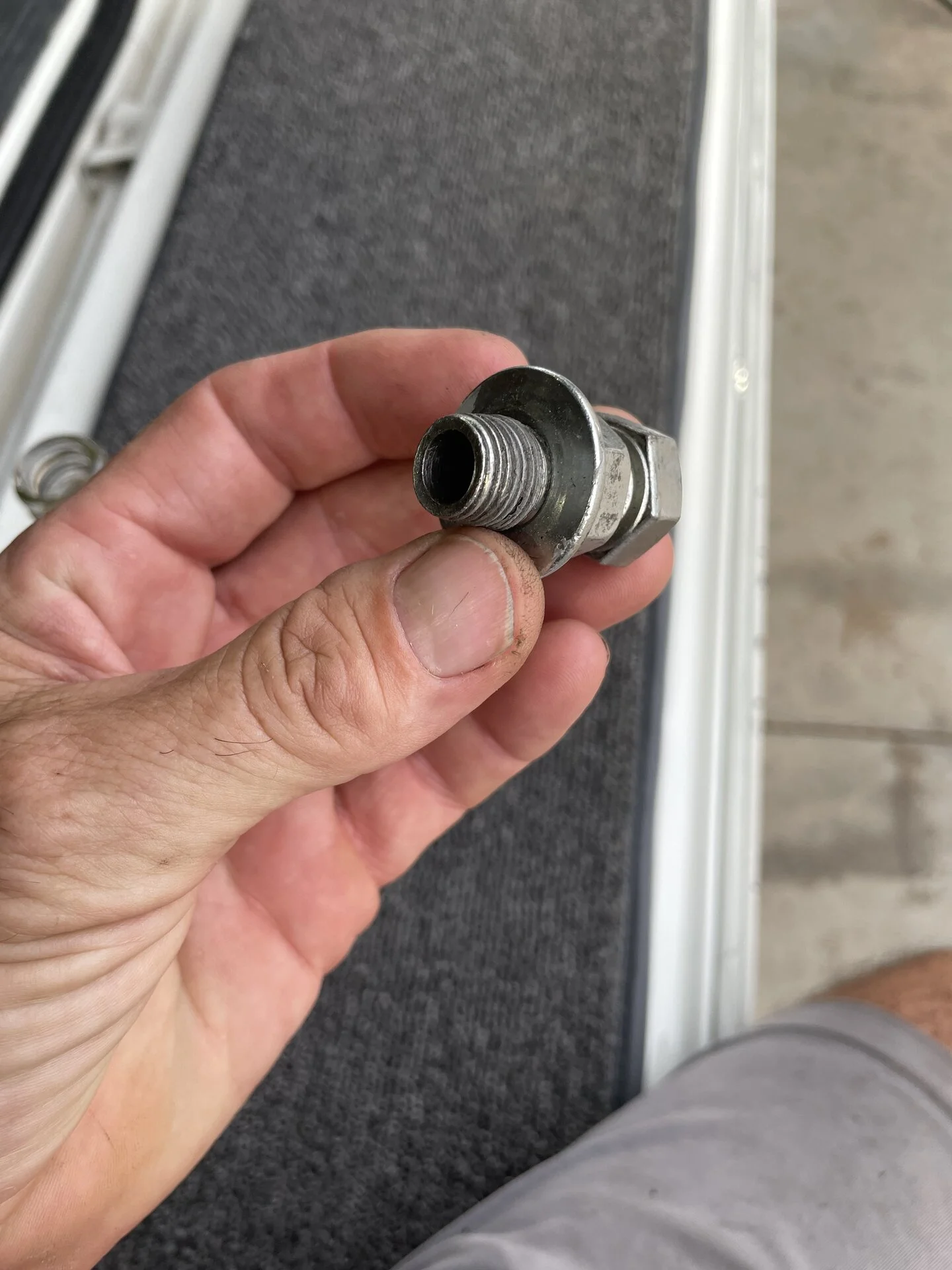

Somebody was proud as sh!t about that detent bolt fix. That guy saved the day. Probably after ruining it too…

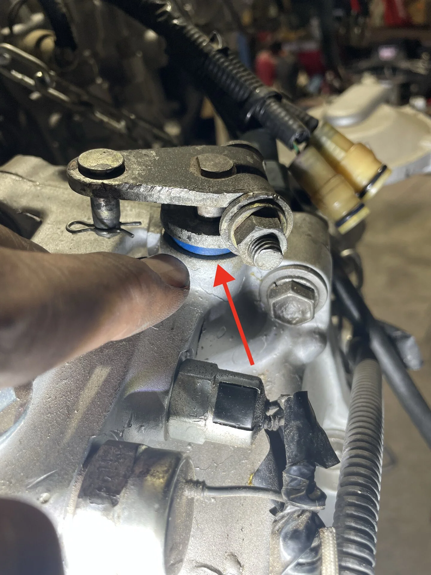

Yes sir. Saved that one and it’s on my “wall of shame” in the shop. Here’s the oil slinger found on the rear output (came on 62’s only). In the receipts they put in new OEM idler gears…but there was no oil slinger put on the new gear. The pick shows one I took off a parts case. Also forgot to mention they lost the washer for the shift selector. They used a blue rubber one in its place. This case was not going to last too many more miles
Good grief. They obviously do not frequent this forum. Any joe with half a brain can rebuild one of those things after reading a few threads. This is precisely why I do my own work.

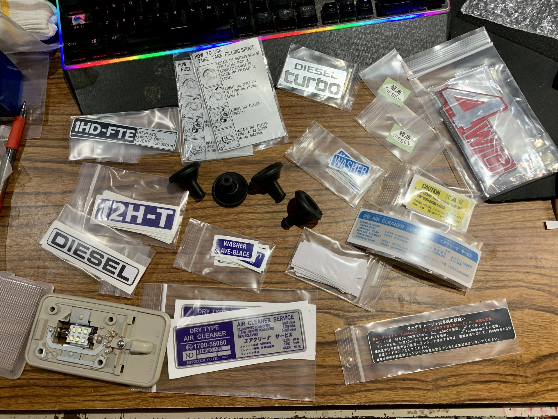

so ...........

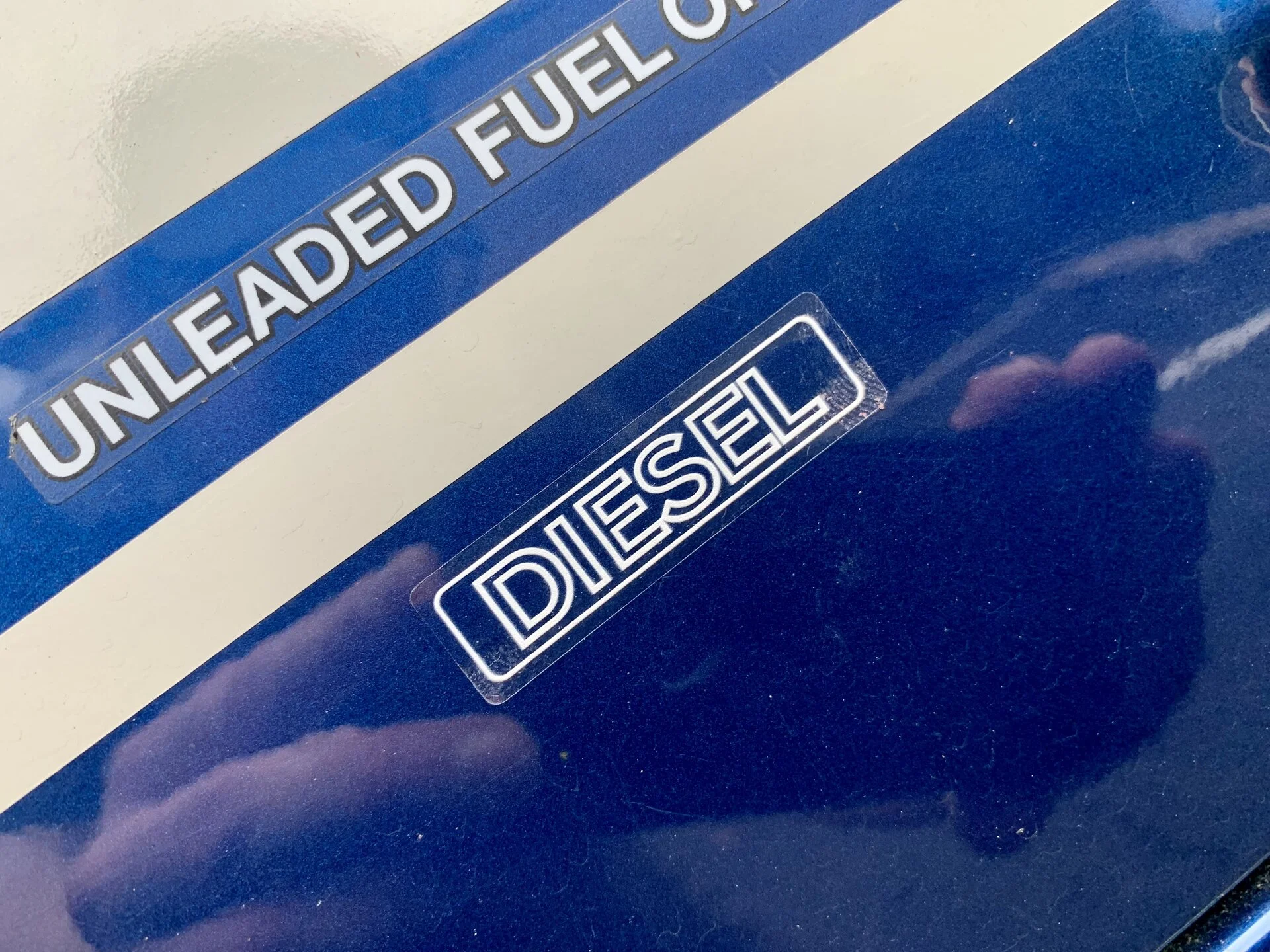

these are simply all Cereal Box Prizes for anyone who happens upon Jimmy's Barn .....
- but , a big big thanks to Jimmy for helping me make
12H-T BLISS into reality

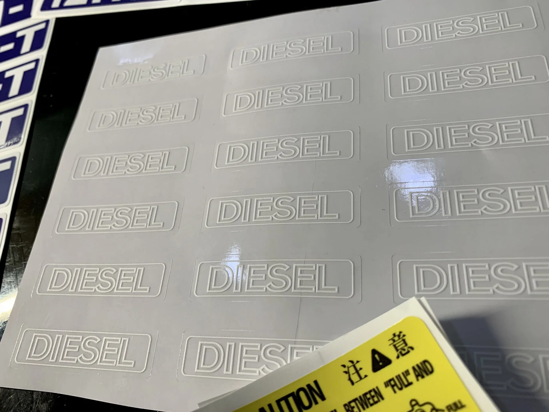

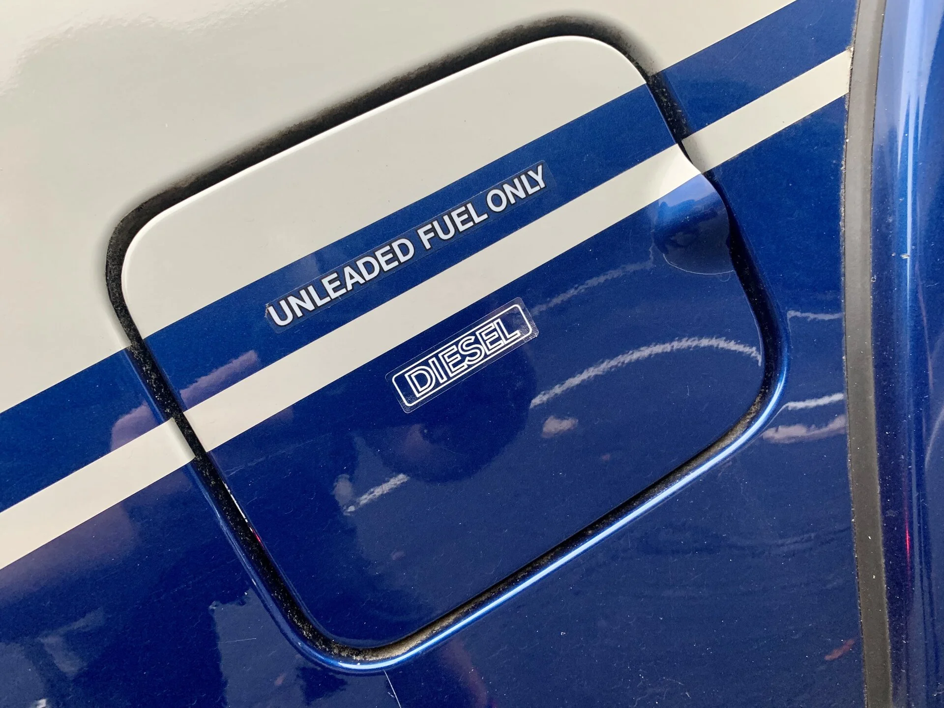

- the Translucent DIESEL decals are actually a screw-up from the decal chop , they gave them to me , while they ADD the missing BLACK outline , but they are sorta KOOL on a darker paint code for sure !
- the Japan Spec. YELLOW Coolant Decal got a few needed update tweeks , based on a TOYOTA SCUBA tank size round bottle i was lucky enough to bump into online , it's now the SNOW-VERSION standard , and covers all the bases for sure ,,,,, same exact size wide , simply double as TALL , the needed Refresh-Kits are out later this week as i get fully caught up on shipping orders ....
- the #7 mark head ASCO / AISIN hub dial bolts are going to be in a super super snappy BRIGHT Silver ZINC , in addition to gold too , JIMI will get a sack full to hand out in 12 pack fist fulls like the gold ones before ....
- the 4 door wire harness grommets are heading jimmy's way for a TEST Drive , well they do work , i guess he will find a use for the hand full i boxed up ..
- the new and exciting room lamp , is well 400% brighter , due to its over-sized bulb cavity , and like everything in my world , its 12V & 24V compatible ...
- oh…

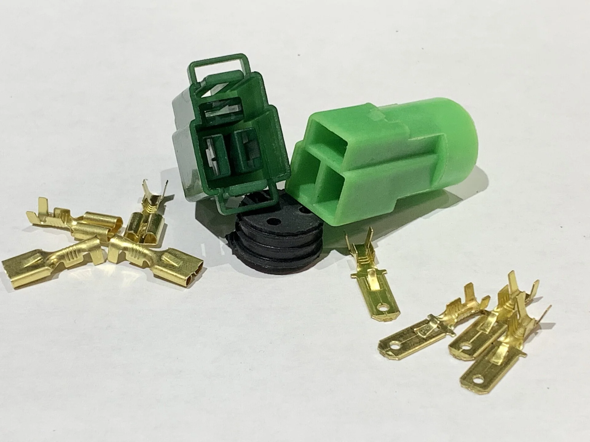

- Diesel alternator harness and device side 3 pin Connector kits Jimmy will have a 1/2 or dozen or so to help out who needs help there on that topic …
thanks again Jimmy ....
this will all see you by friday or sooner ,,,,,,:D
