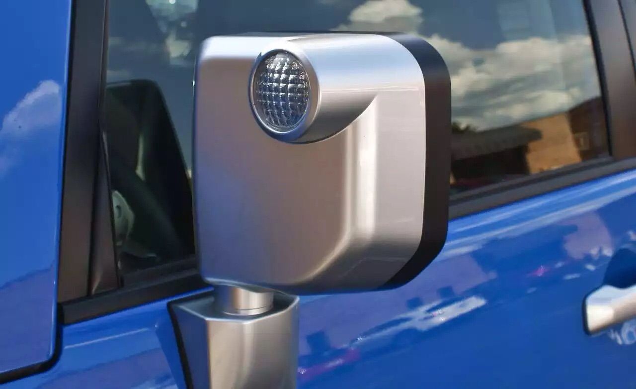

Really liking your build, then I noticed the TJ mirrors. Have you considered a pair of these instead? Saw some grafted onto an old Hilux and they looked really cool. You'd only need a custom arm to bolt on the tube door I guess.
Btw, I wanna do a white roof on my black Monstalined 80 series. It's too hot in the summer. How did your 75/25 mix turn out?
@AaronM33 the mix turned out just about perfect for what I was wanting. Stark white was just too white. If you do this, mix up all your colorant in a separate container so you do not have to mix it for each batch.
I like the FJC mirrors you mentioned; however, each trip we go out wheeling the mirrors take a pretty good blow and just flop out of the way, backwards or forwards. A local member put those on his 60 and it looks great!
Yeah I agree that white is too white. I'll probably buy both tints and mix like you did if I stick with Monstaliner up top.
I wouldn't wanna bust up a set of $150 mirrors every trip out either.
