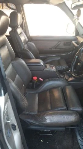

I picked up some cloth buckets out of an Audi this morning. It took a while, but I got the drivers seat installed today.
I plan on posting the fabrication and install here soon.
But, basically, you can put any seats you want in your cruiser, if you have the tools and time.
