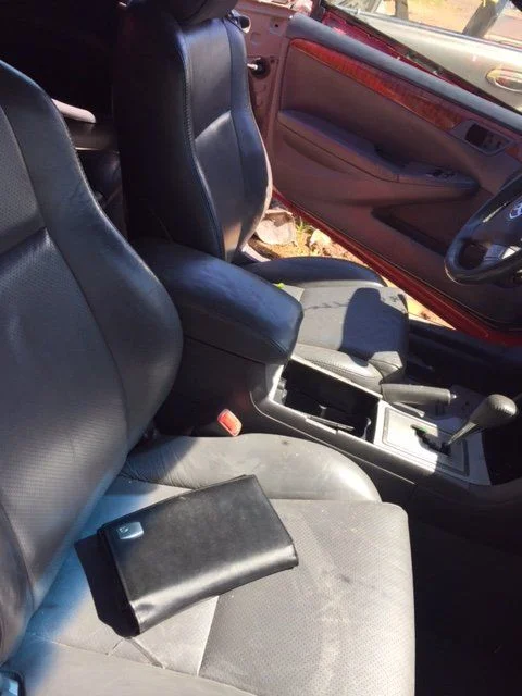

I just found these from a Toyota solara, they are gray, powered and have lumbar support.
Will update once installed in case someone likes them.

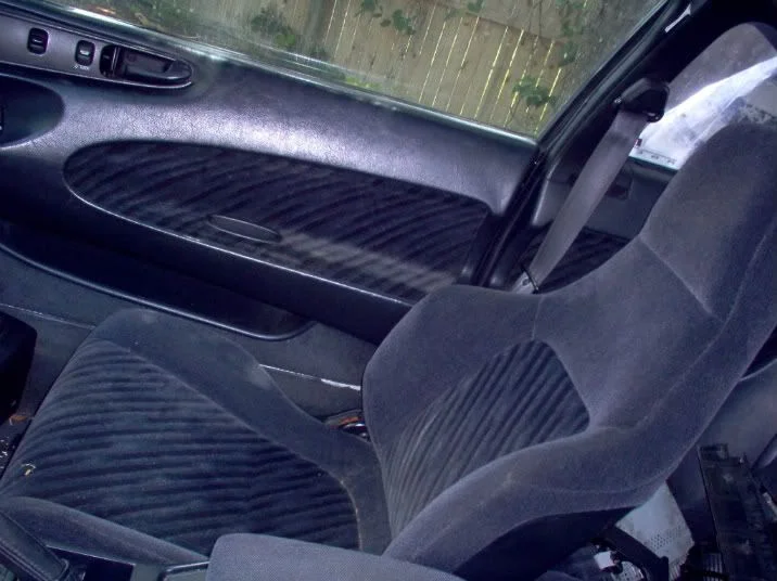

I Just bought a set for my son's 80 from a 2 door Honda. They are really comfortable, both back and bottom. Excited to see how those fit.

and this is the Honda seats I just picked up. Both sets were $30 per set at pick n pull.
