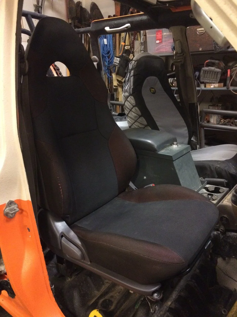

I dropped a set of Celica GT seats in my offroad rig. fabbed up brackets again. Much nicer fit!! pics to come.
I dropped a set of Celica GT seats in my offroad rig. fabbed up brackets again. Much nicer fit!! pics to come.View attachment 1219107
Nice work! My wife has had her Celica since 2002. Her seats are super comfortable. We've driven her car all over the east coast and driver fatigue never really sets in.
Great to hear. I plan on putting 4 point belts in, so the opening is perfect. Seat heaters and covers to come too.
