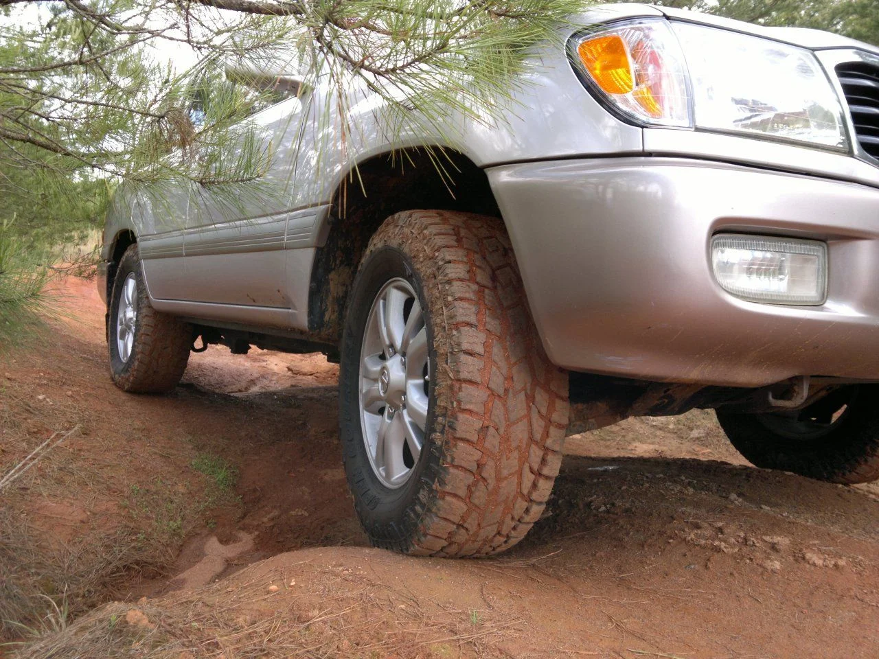

I have 285/65r18 BFG AT TA's on stock suspension Diameter = 32.5 per the web site
Totally fine no rub fill up pretty good, minor off road so far, just around the family farm no issues. This is slightly bigger than stock

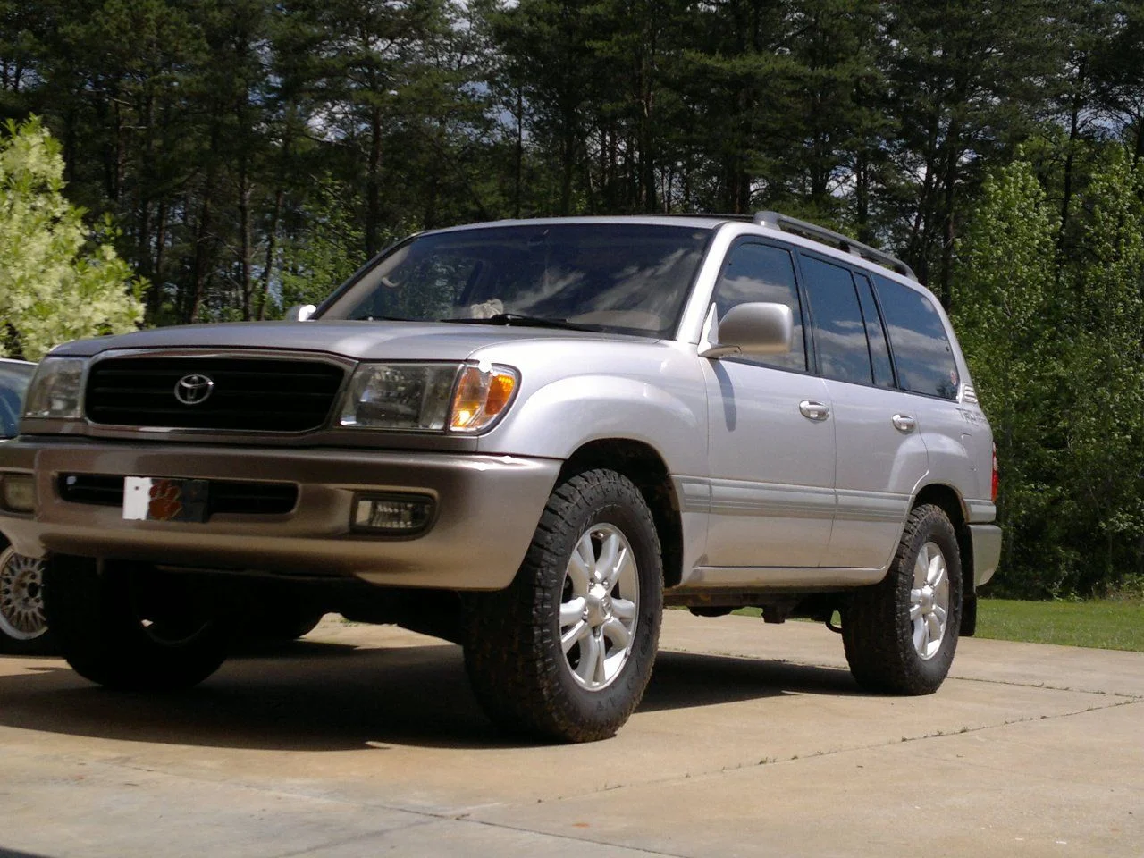

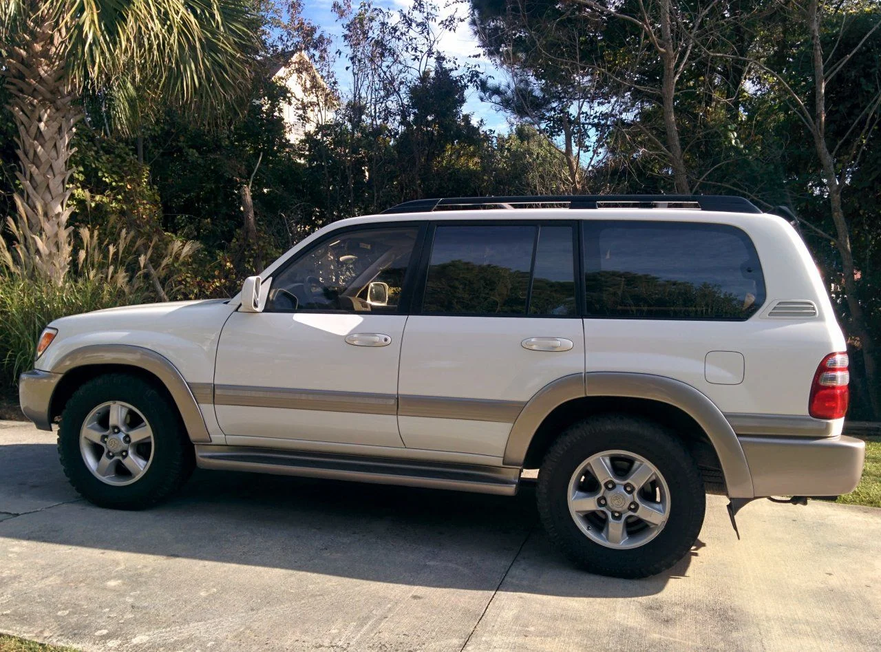

I hope to go 295/70 R18 Nitto Trail Grapplers for my next set.
