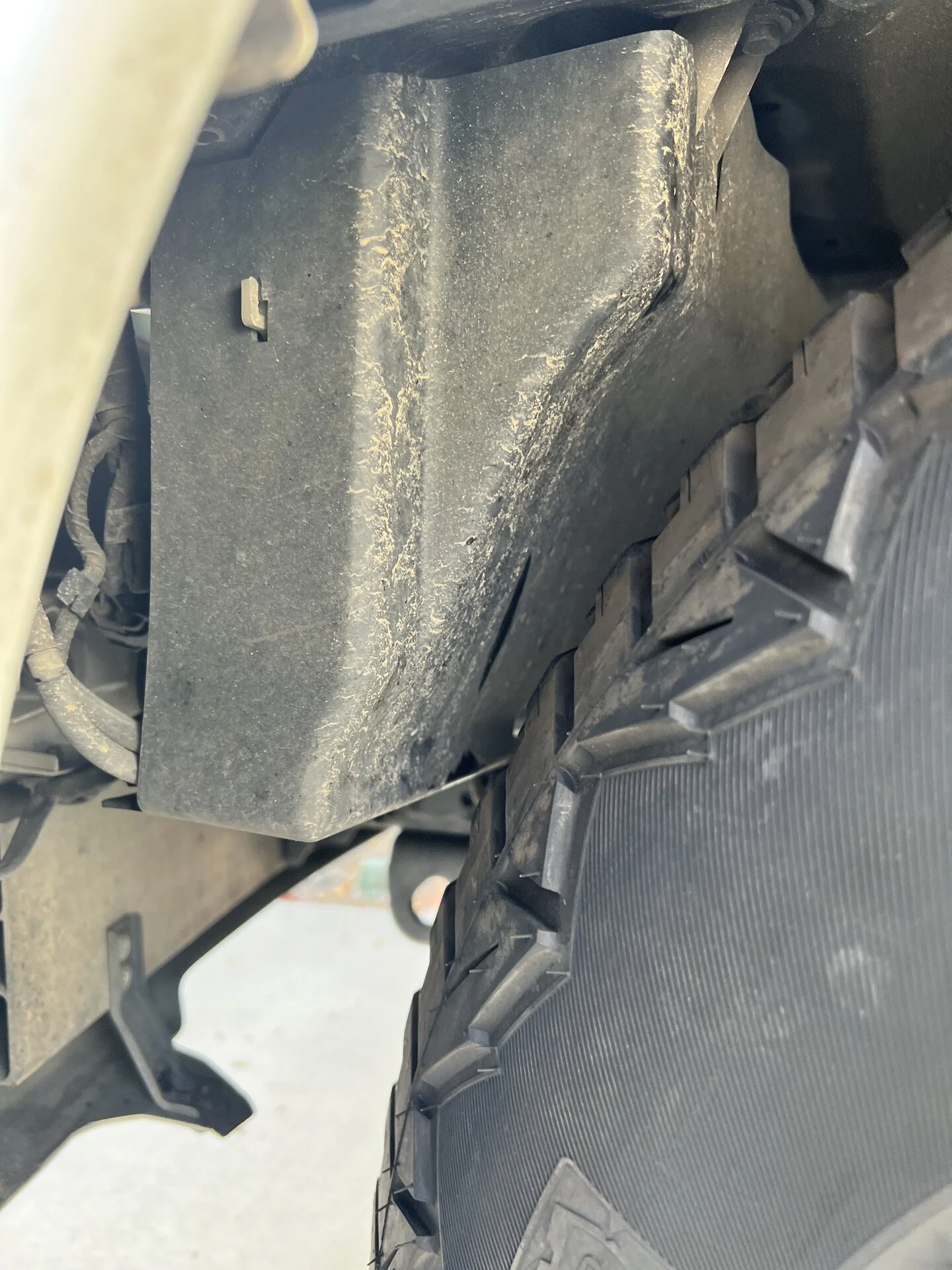

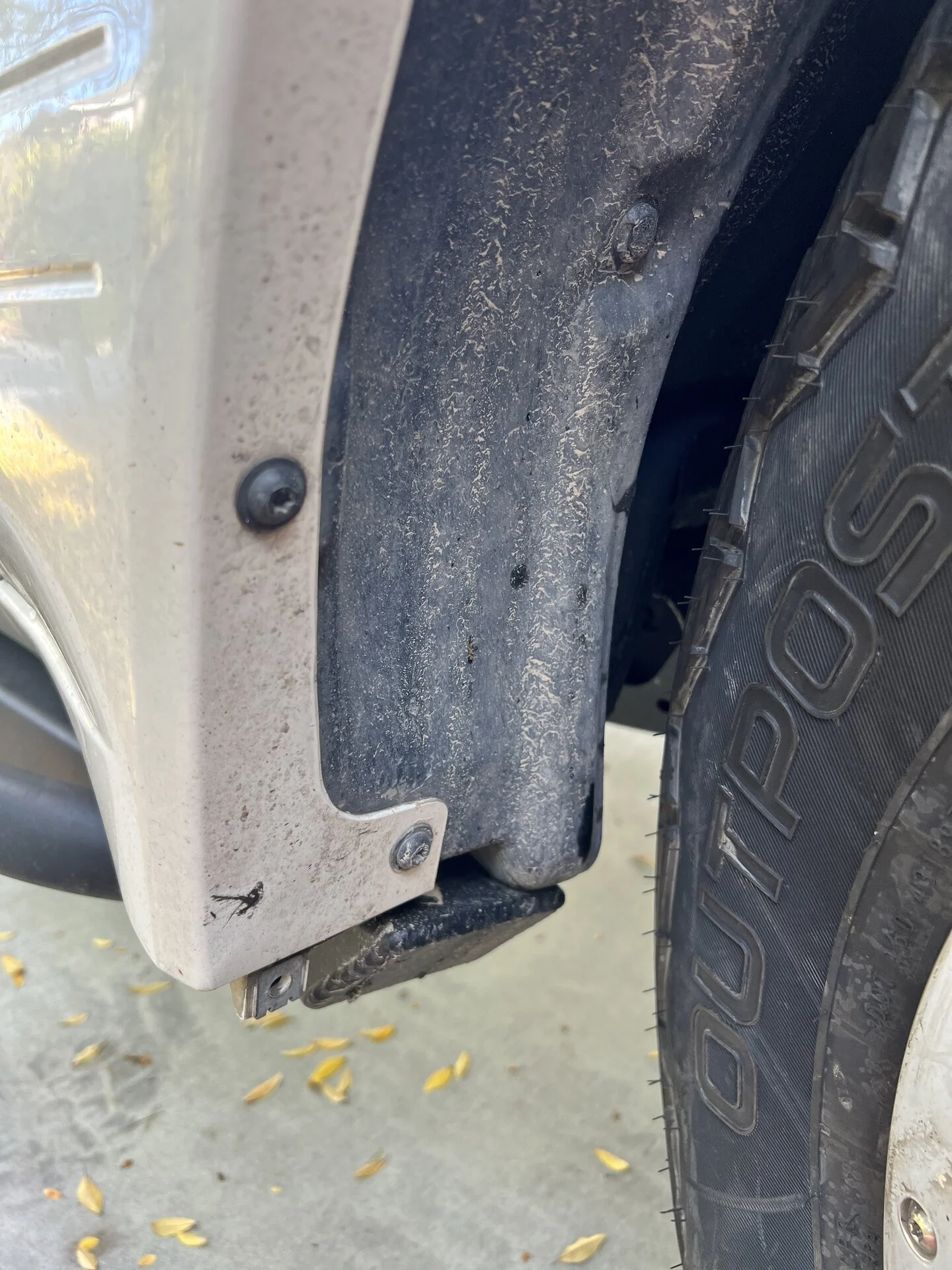

I just last month installed Nokian Outpost AT's in LT285/70R17 on Rock Warriors with 1.25" spacers for my LX470 that's stock on AHC. Slight rubs that I'm not too worried about. Audible rubs have only happened when I've been backing up over a driveway slant with the wheels fully turned or going over certain speed bumps. Visibly, these two photos' dark areas show the spots of the rubs.

On our application RW’s require a minimum 1/4” (≈6mm) spacer so in reality the offset is at least 44mm. As seen above when you use a 1.25” (≈32mm) spacer the offset goes to +18 and you start having rubbing issues with 285/70’s.
