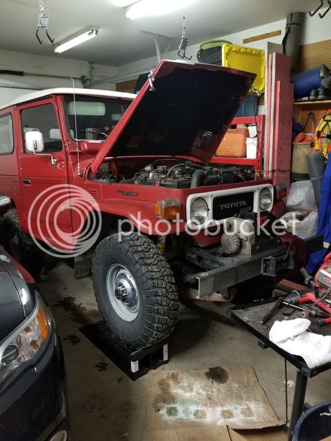

Test fitting the home brew ARB bullbar that I picked up last summer for < 1/3 price of a new old style ARB. It fits. Bullbar will ride on the front of the '77 and and the Warn 8274 will sit behind it.

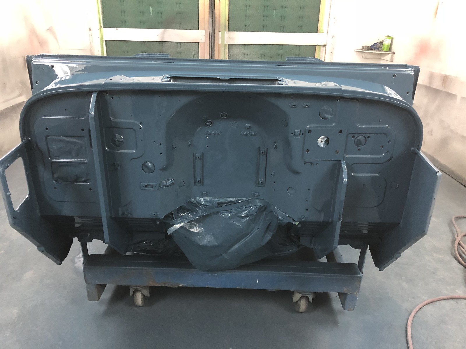

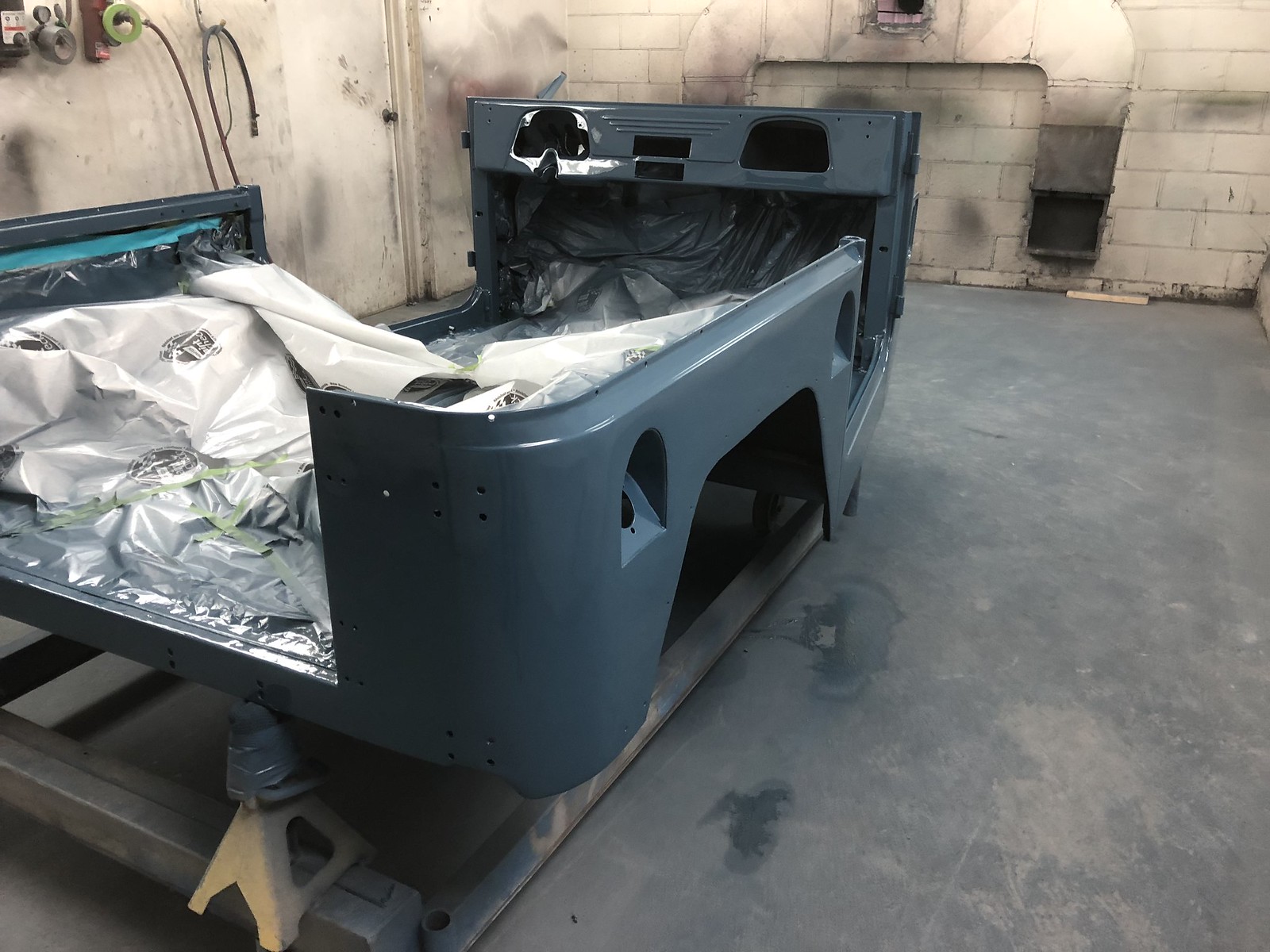

Got the final bits into paint on the 64...
Had to reshoot the drivers side fender and apron due to some issues like scratching and a small bubble.
Anyhoo, hoping to mount those tomorrow and get to work on the top cap! (Last step!)
