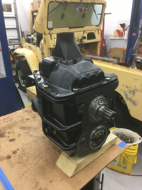

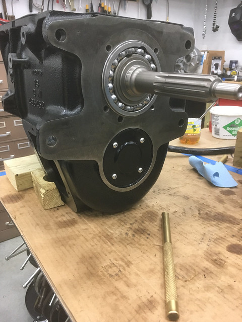

Rebuilt a spare sm465 adding new input and main shaft. Output drilled and tapped. Orion torn down getting new seals / gaskets. Curse the shade tree that uses ****ing silicon on everything.
