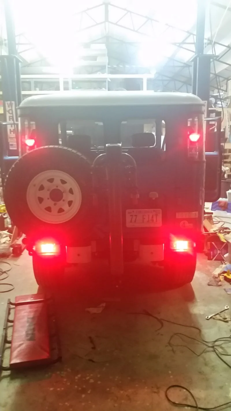

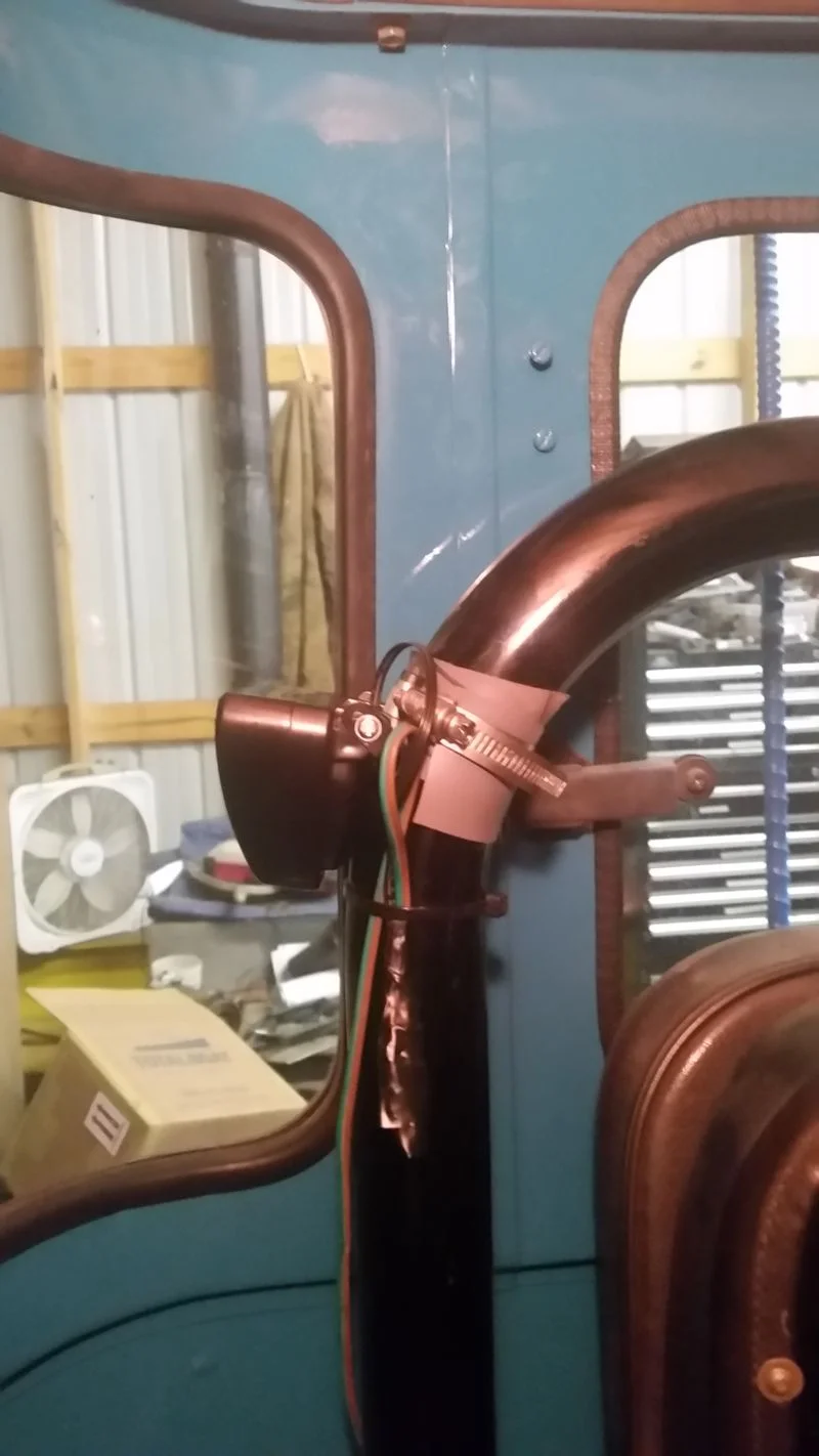

Added some LED brake lights up on the roll bar. Previous owner had some lights he had attached to the top that shown through the curved window. Never liked those. I wanted something attached to the roll bar if I ever remove the lid again. Very cheap lights from China, but were the form factor I was looking for. Wiring instructions said "Diagnose wires and connect correctly". Package had no indication as to what the three wires on the LED light did. I fiddled around with a battery until I figured out the wires.
full
full
full
