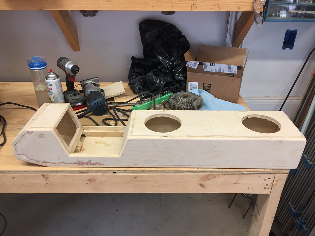

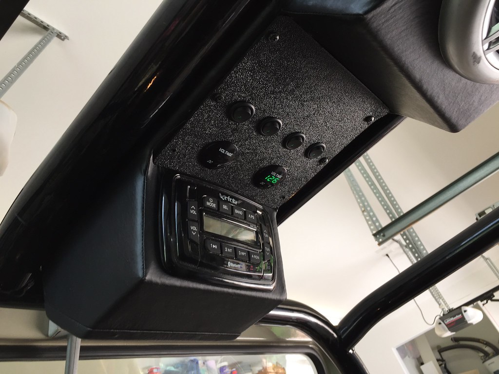

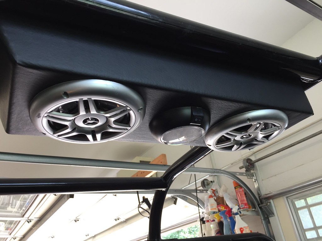

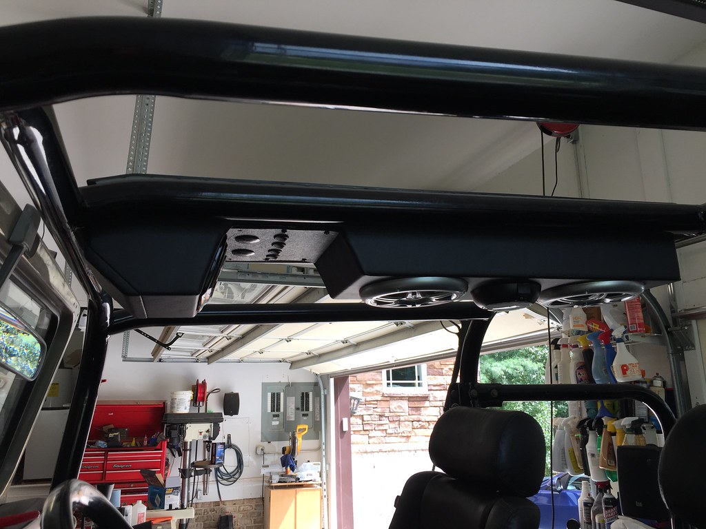

Finished building the overhead console for my 40... Holds a small amp, couple of speakers, radio, switches, a dome light and two volt meters. Here are a few pics:

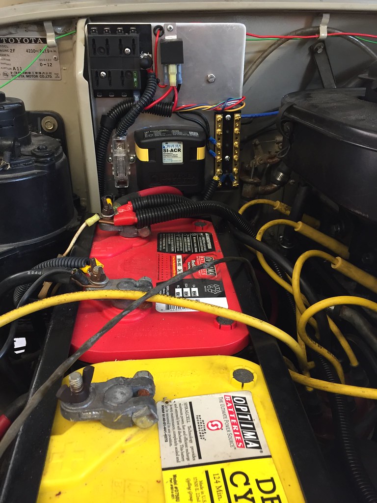

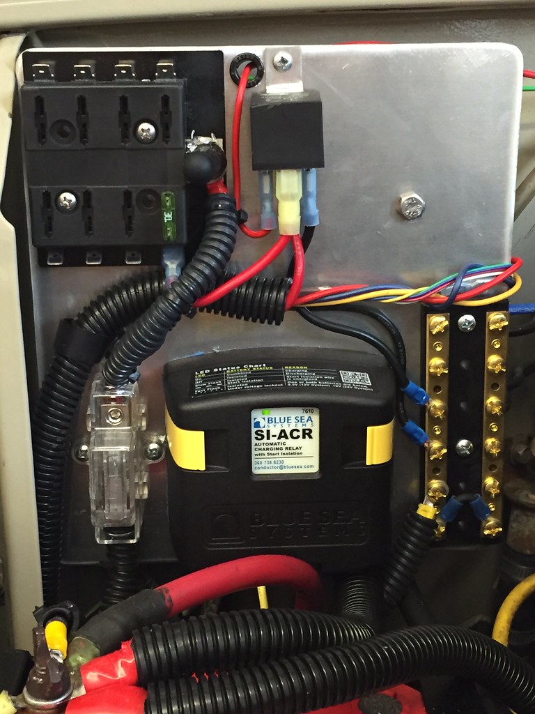

Also added an extra fuse panel under the hood with a buss bar, main fuse, relay space, dual battery acr, etc...
The twisted multi-colored wires running from left to right are for future expansion...
Nice work on the console Jeff.
