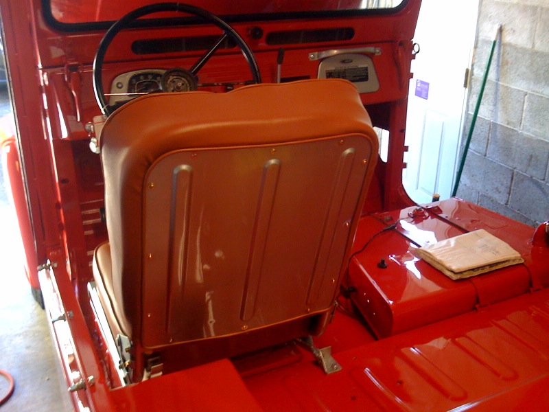

Mark,

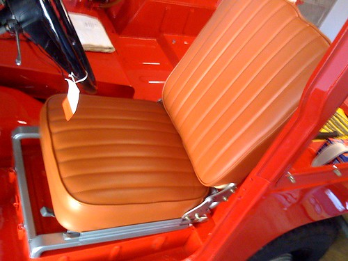

Would you do a write up and pics of how you did that to the drivers seat? I have ben NEEDING more leg room on the drivers side and did not know the best way to go about getting as much as possible!

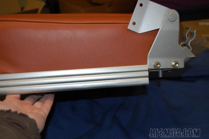

Here ya go!
!.Remove seat.
2. take off the 4 nuts that hold the seat frame to the seat.
3. Mark and drill four new holes in the top of the seat frame at new location desired. I picked 1.25" because it still lets me tilt the seat back a little forwards before the tubing hits the rear wheelwell.
4. Measure back the same distance on the sides of the seat frame where the latches catch the frame and mark it.
5. I used a 1/8" drill bit and drilled multiple holes to 'outline' the shape of the holes, then drilled inside them to collapse the center. Round file to finish.
6.Reassemble and enjoy!
The next stage is gonna be wickedly hard. I am considering cutting open the firewall and fabbing up a new footwell in the firewall that is 3" forwards!
That would be a magazine write-up.
Bulldog! Holy cow that looks awesome. Do you have a build thread, so I can short out my keyboard with all the drool?

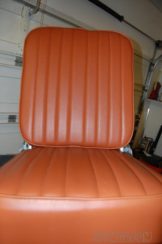

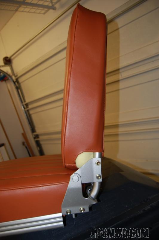

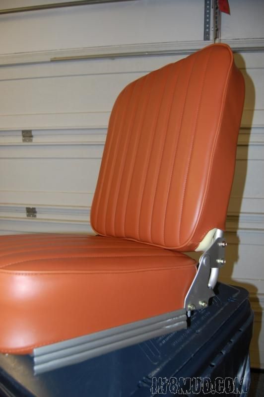

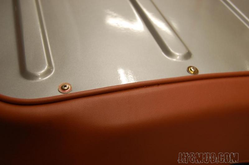

I put a 4'' old man emu lift with the U-bolt flip kit and also had my seats re-upholstered. It was a beutiful week......atleast until I got the credit card bill!!!!!
Nice Destin!
