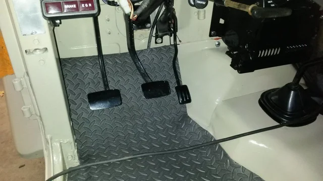

cupInstalled some floor mats made from some material I bought from sears. It was supposed to be a exercise mat. Not sure how well it will hold up.

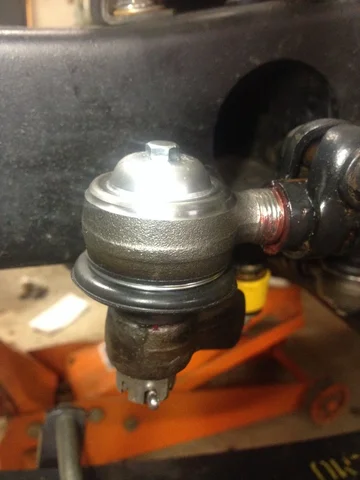

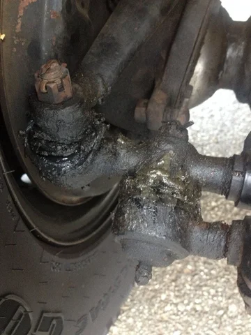

Hey that looks great. What order did you replace these in? I want to do'em all, but can't decide which one to start with.
Racer - NOTE, if your rig's steering is acceptable before you start, take dimensions between all the joints and use these dimensions when installing the new TRE's. That way the steering will be close when completed. If the steering is not acceptable or no known reference points, thanks to Coolerman, here is a good place to start with some dimensions: http://www.globalsoftware-inc.com/coolerman/fj40/21.htm
FWIW, here is the sequence I used:
With the 40 on the ground, I started with the drag link TRE at the center arm. Then I jacked up the rig, and installed both the passenger side TRE's. Next was the driver side TRE. I used a dimension of 47.44" between the center line of the passenger & drivers side TRE's, and tried to centered up the Tie-Rod between each threaded end. Finally, I installed the relay arm TRE at the center arm.
Plan on doing an alignment after you've installed all the TRE's.
