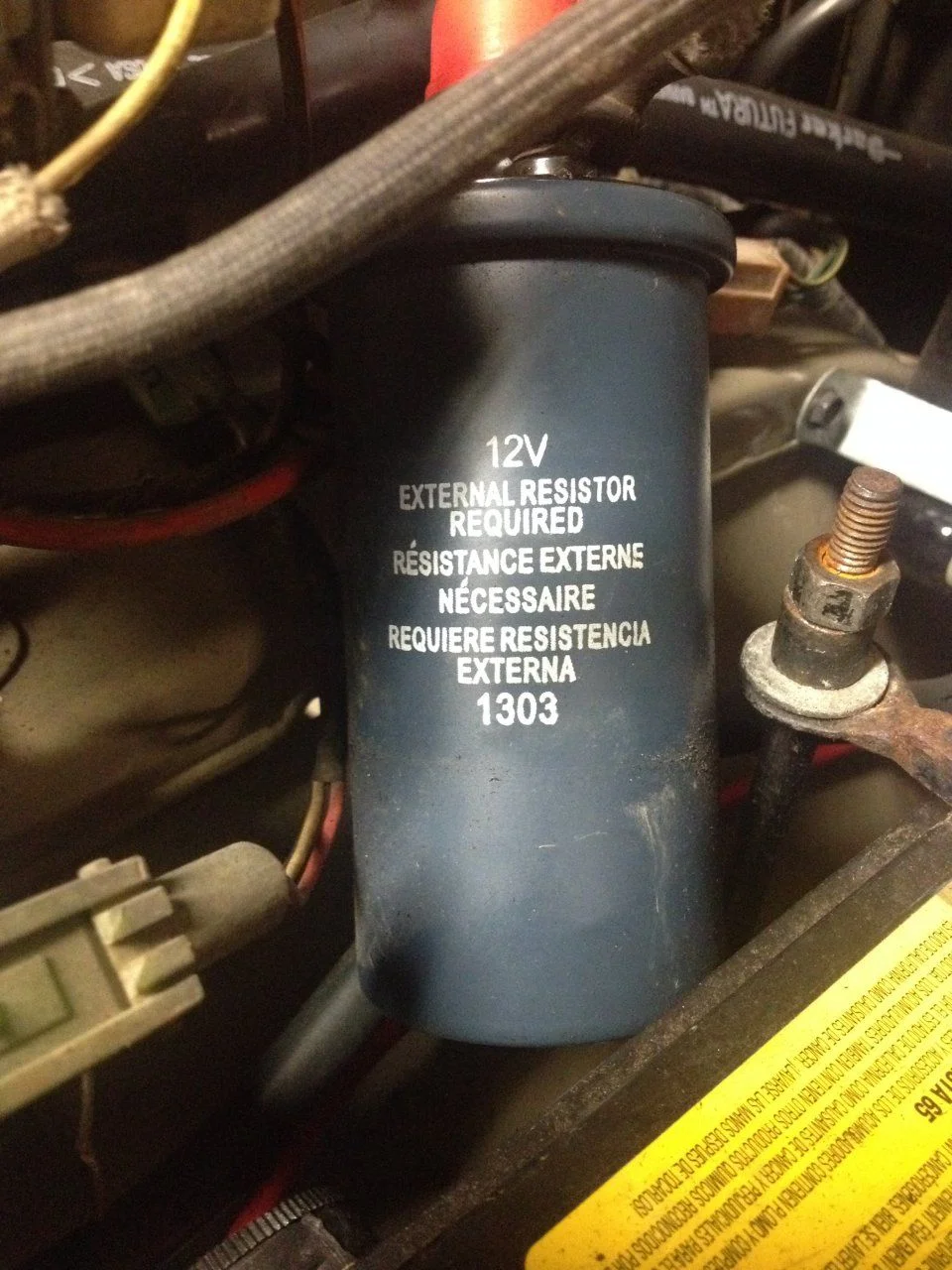

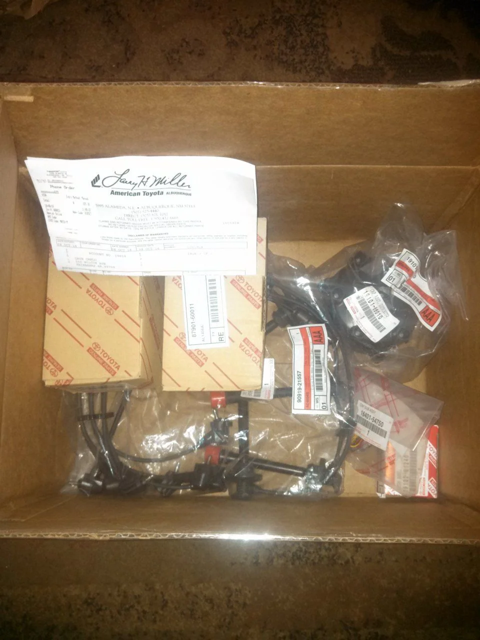

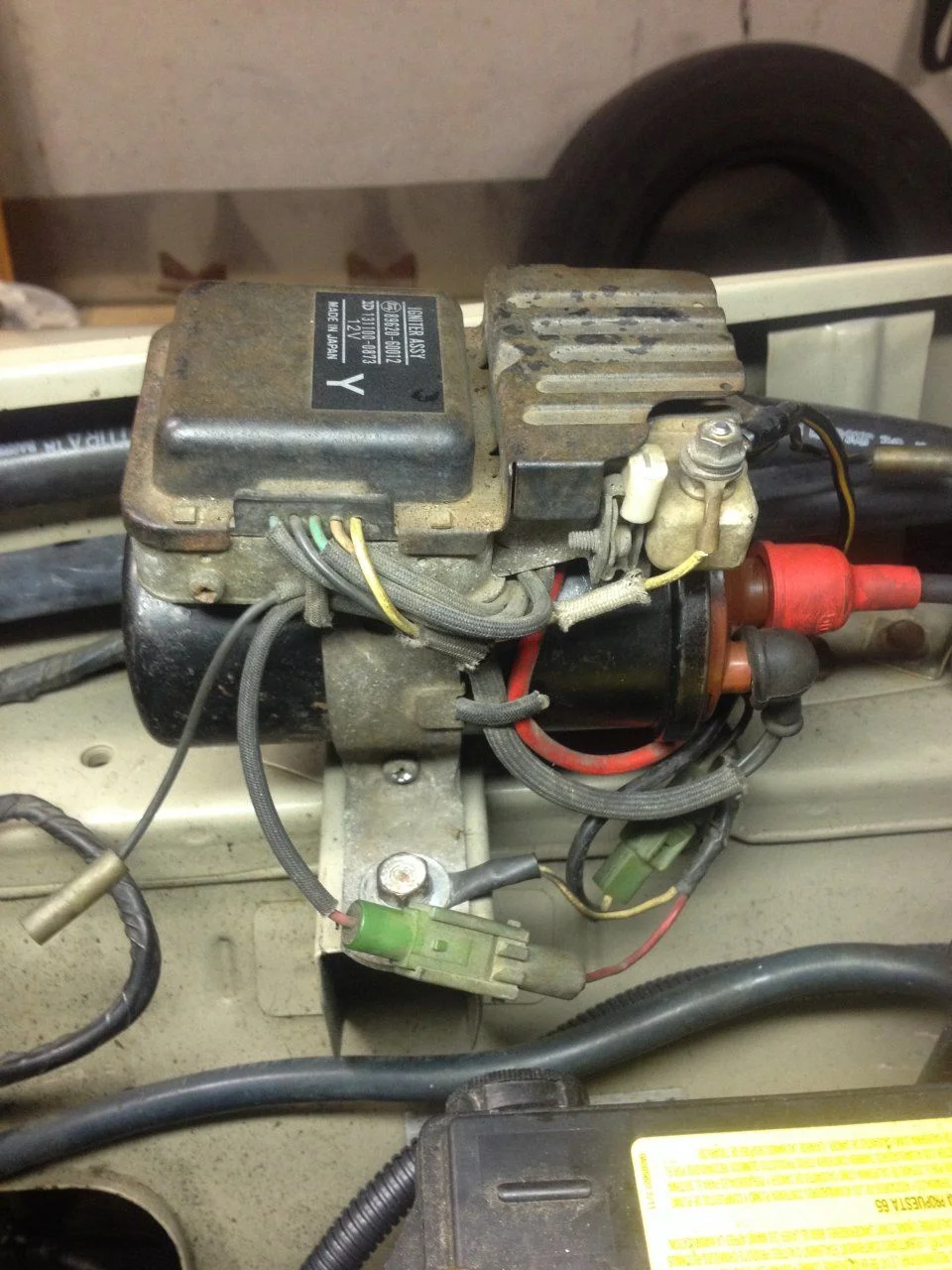

I replaced this aftermarket coil:
With this OEM Toyota #90919-02077 (Thanks to oestlarsen):

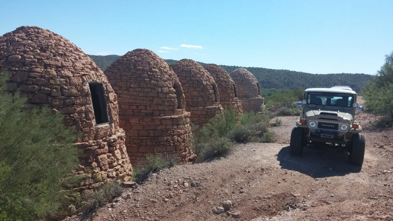

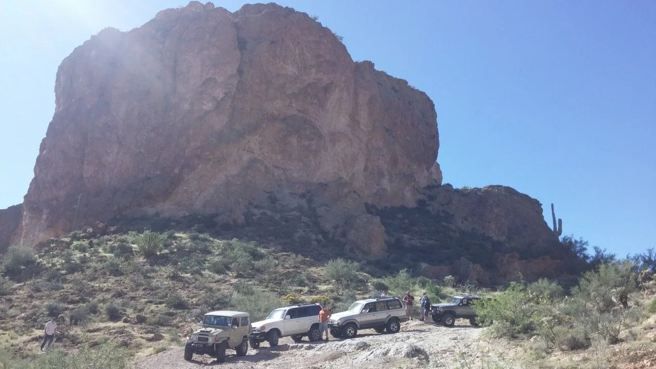

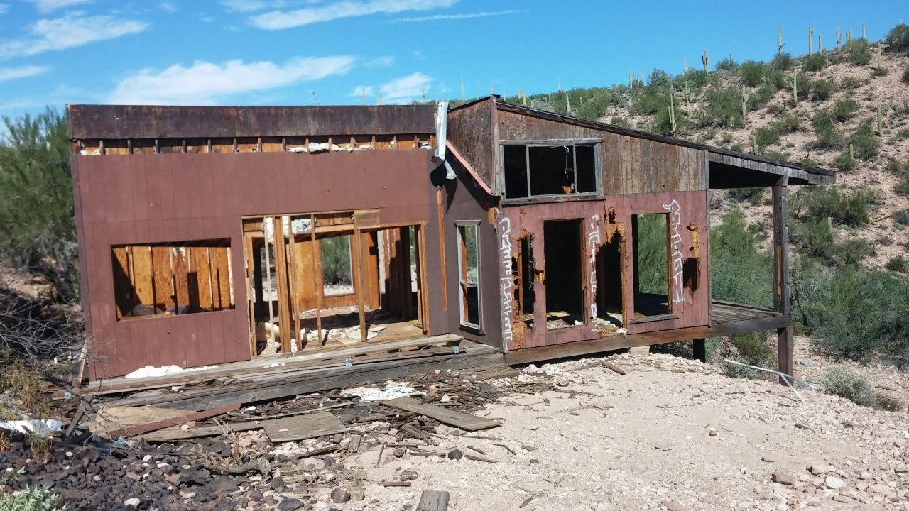

Went wheeling to Florence Junction , visited the coke ovens with some other Copperstate Cruisers

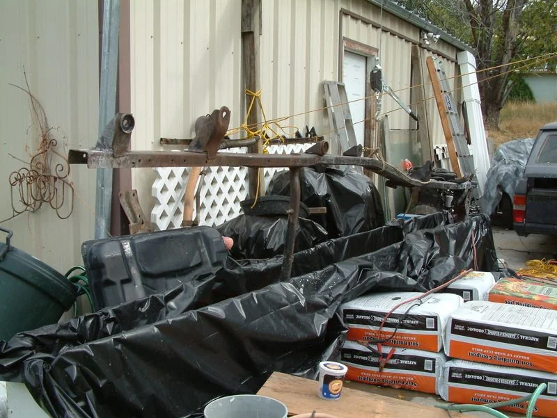

I Electrocuted my badly rusted FJ60 frame? Second picture is the almost-white clean steel.

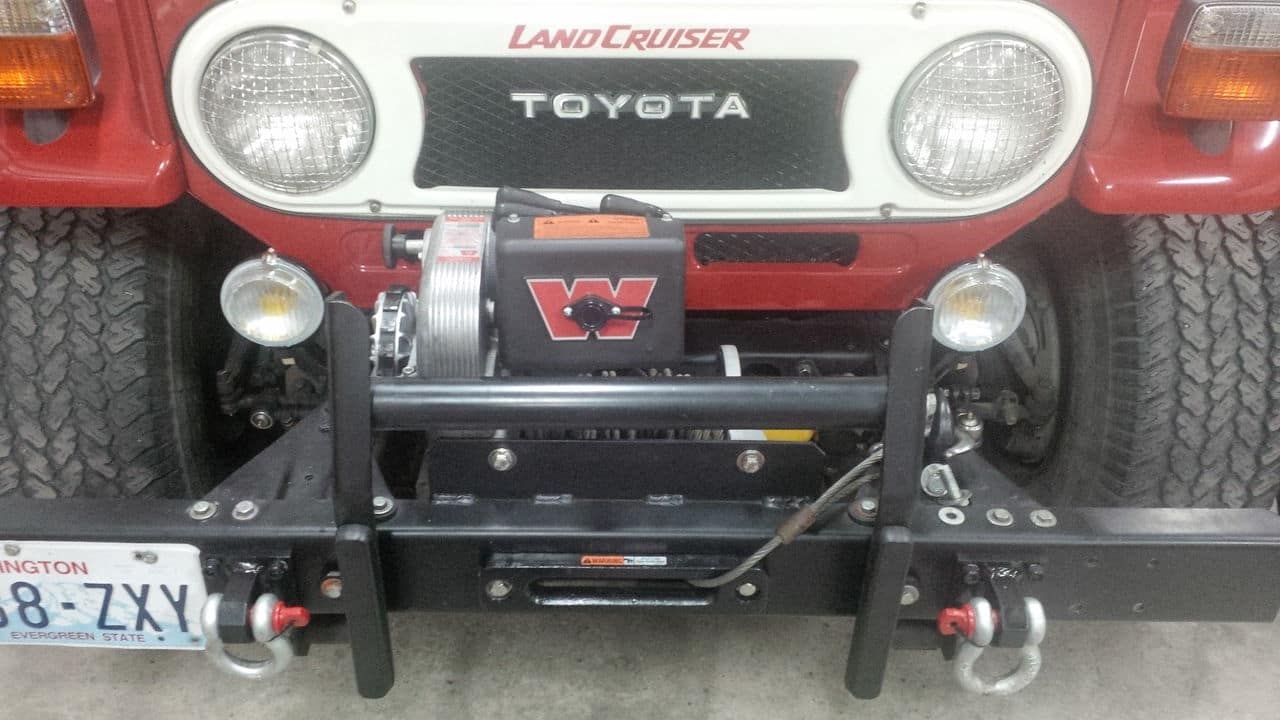

I installed a new to me Warn 8274, and a pair of the SOR vintage fog lights.

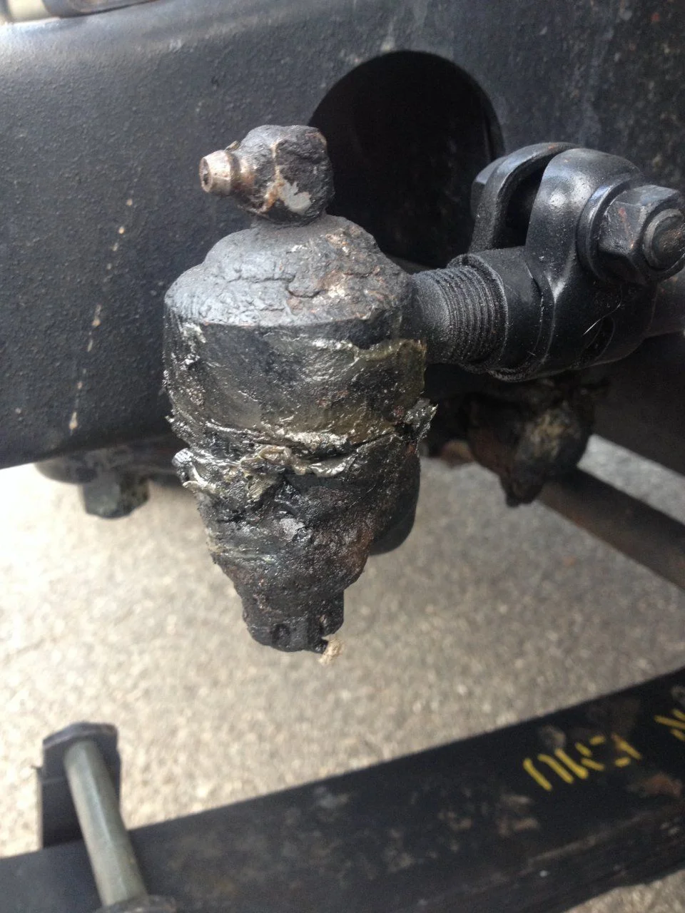

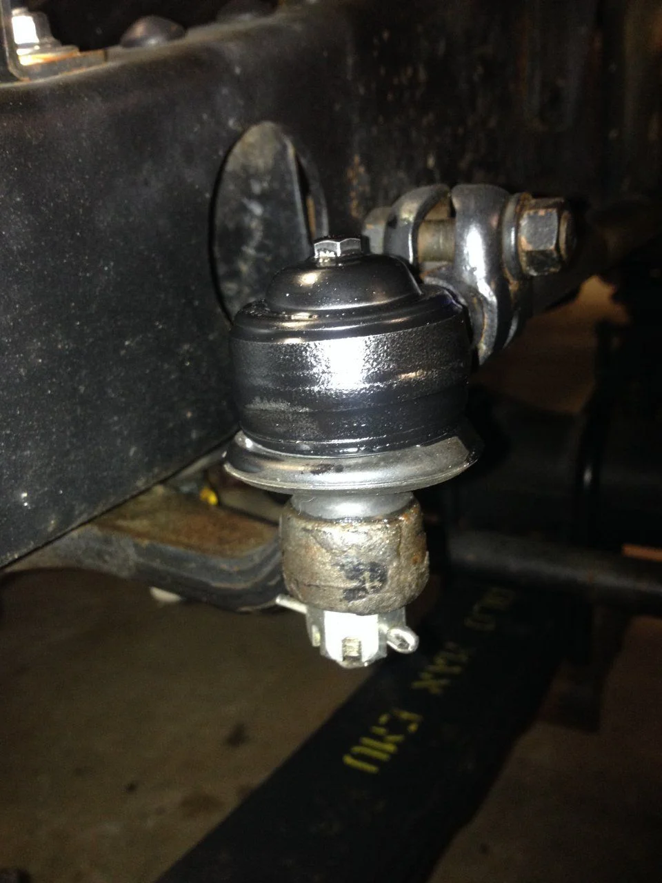

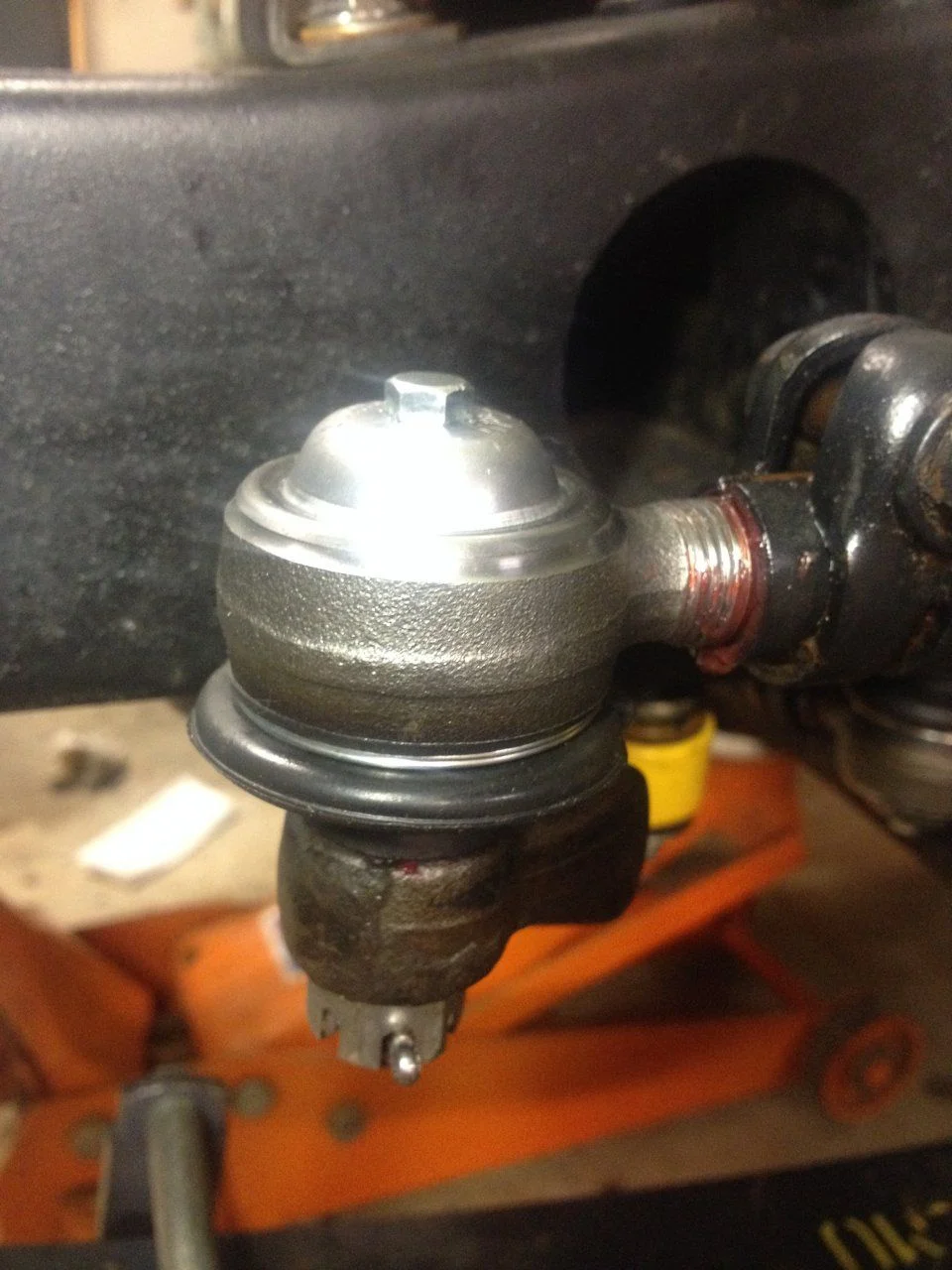

TRE's all complete, went from this:
To This:
Now they look like this (Casssis Saver - Antique-Satin Black)!

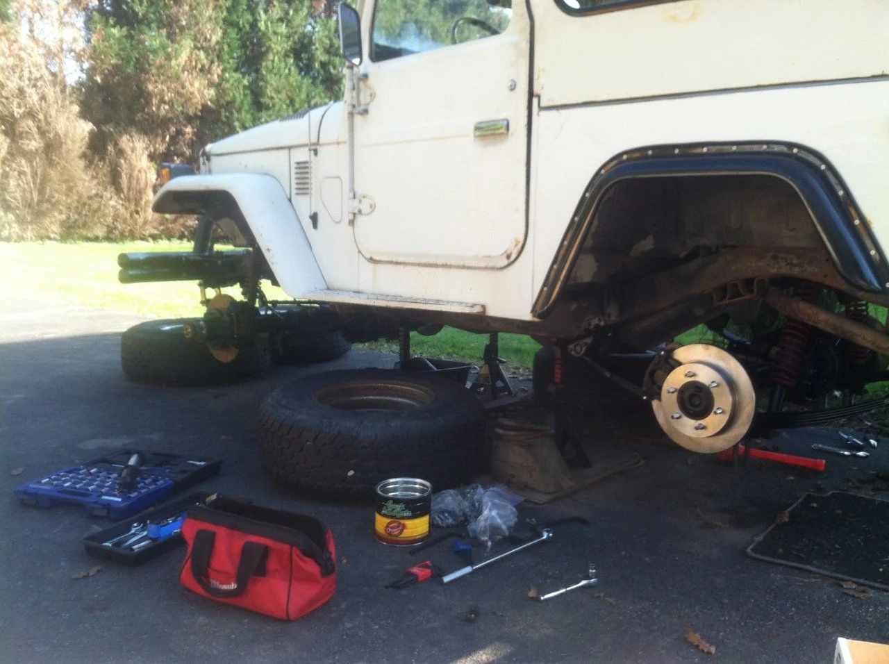

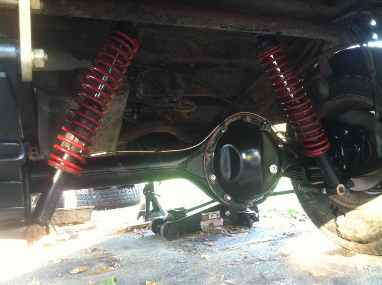

So, this is really what I did in the last 5 months, but AT LONG LAST my FJ40 is back on the ground. I spent the summer converting to 4 wheel disc brakes, rebuilding the front and rear axles with all new seals and bearings, new shocks, fixed some steering issues, installed an Aussie locker in the rear, tightened up and resealed the diffs, new paint on the axles and suspension components, and brand new brake lines all around. Glad to finally be able to stop without changing lanes!
Only issue - with the caster shims I added, I now have too much pinion angle, and my front driveshaft bottoms out - the cause? My V8 is mounted WAY too far forward in the bay, and my front driveshaft is, as a result, ridiculously short. Looks like the next big project will be re-doing the horrendous V8 conversion...
To This:
Why haven't you got grease nipples on them? (Is it perhaps because those boots don't allow excess grease to escape?)
I always like to put fresh grease in all my steering balljoints as part of regular maintenance.
(I don't think "sealed-for-life balljoints" will ever last as long as ones that can be regularly regreased.)
I'm still running original balljoints and I just replace the boots from time to time (whenever they start to fall apart).
