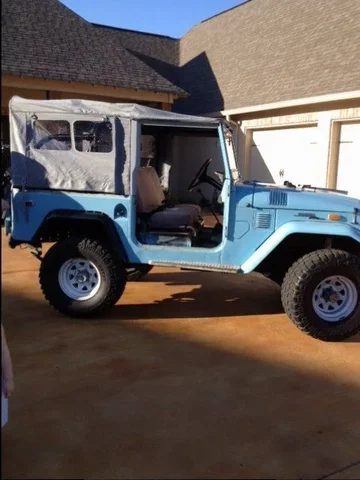

I put on my Trollhole top. (waiting on hardware) but this thing is amazing.

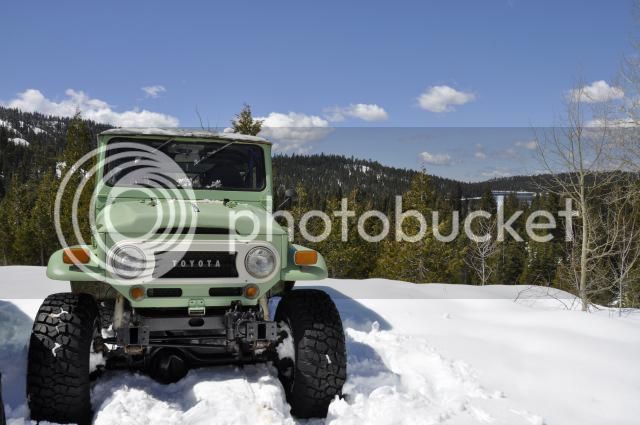

Had an awesome day in the snow yesterday. We went up to Yuba Gap and played around up there, I'd never really explored much up there and now I feel like I have to check it out more this summer. We got pretty far but once the sun hit we weren't making much progress and turn back and went home around 2. No one touched a tool box and only got the strap out once so it was a great day. Although when I was in the lead pushing snow my transfer case was making some really awful sounds.. I've suspected for a while it was going but yesterday pretty much confirmed it needs to be rebuilt. Oh well... not the end of the world.
That looks killer with the Capri blue! Hmm...

Thanks waterboy. Trollhole is in vendor section..,,,,you can thank me later;)
