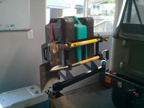

Finished up the new rear bumper with double swingouts
IMG-140320183520.webp IMG-140320183542.webp IMG-140320183550.webp IMG-140320183558.webp

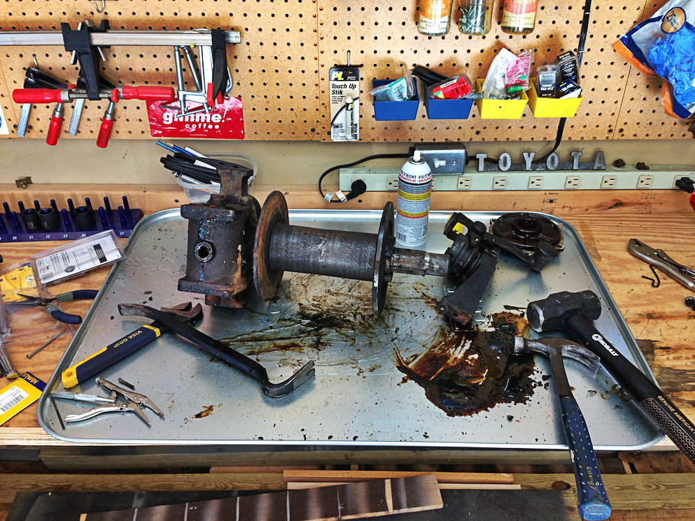

Started disassembling my PTO winch head for a complete rebuild:
I'm guessing it still had the original gear oil in it - like molasses...
