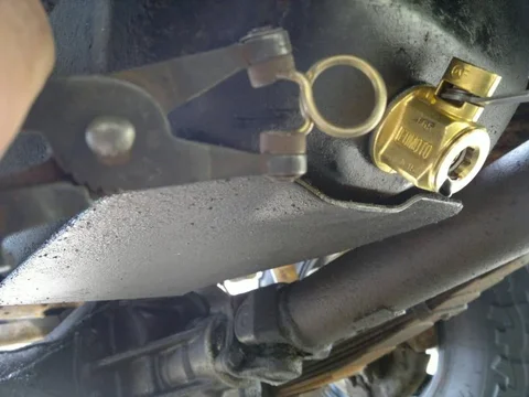

Installed my Fumoto drain valve in the oil pan , nice quality and will make changes a little easier since it can't drain all 8 qts at once .
FG-5 valve -

I used the additional safety lock clamp - it's just basically one of those wire type ring clamps and it's much easier if you use the KD tools or similar clamp tool to remove/install . Prevents smashed fingers and those things flying off into the uknown....
Valve has a very nice composite gasket that looks like it will last a good long time - no leaks at all so far .

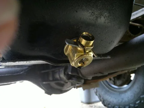

FG-5 valve -

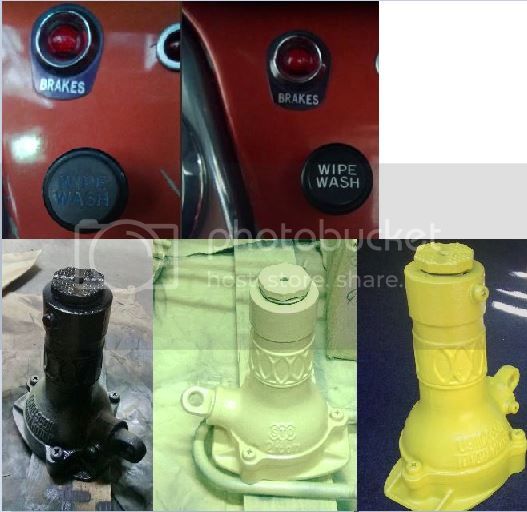

Spent some time yesterday refurbishing some dash knobs and my jack. The dash knobs were the best bang for the buck...$5 and 10 min. I was so pleased with the dash knobs I called my buddy who bought my '78 to come over so that we could paint his dash.

I put one of these on my wife's Liberty CRD and really like it as it's protected by the skid plate. I thought about one for the LX, but it would stick out like a dog's bollocks. Maybe I'll weld a skid to my pan when I rebuild my 2f as they really are nice to have-especially with the hose barb fitting. I drain my wife's oil right into a gallon milk jug using a 1/2" id x 3' piece of hose.

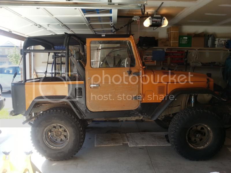

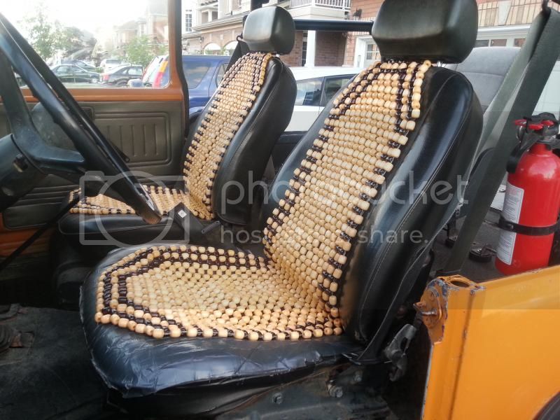

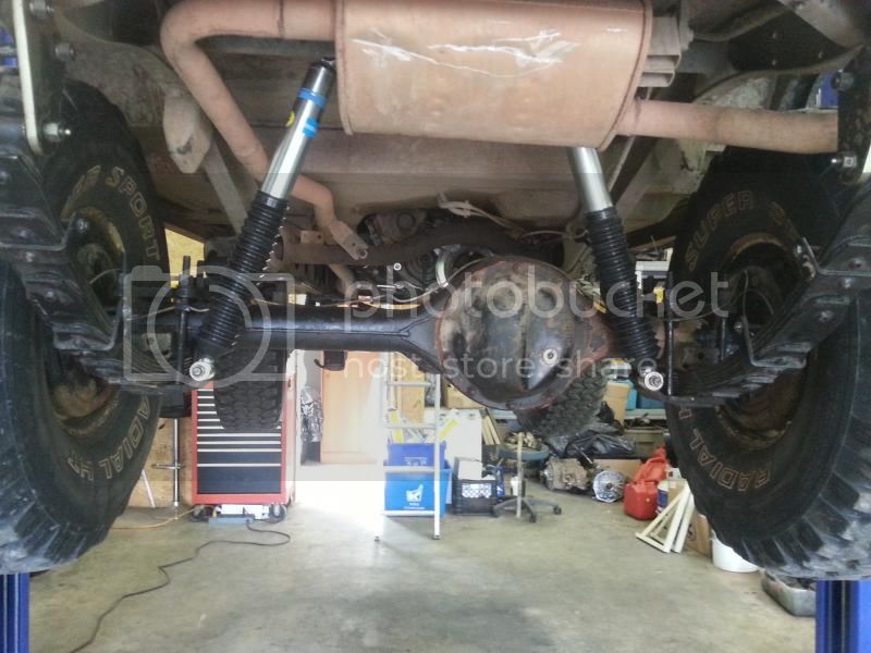

got a 4" alcans and billsteins installed, nicer ride, but still bouncy. rigged up brackets for rear seats that fit chevy lumina minivan 2nd row/middle seat with it's own seat belt. new SOR family top. and rockin the wooden beads to hide some duct tape!
...and waitin for some metal tech tube doors :)
