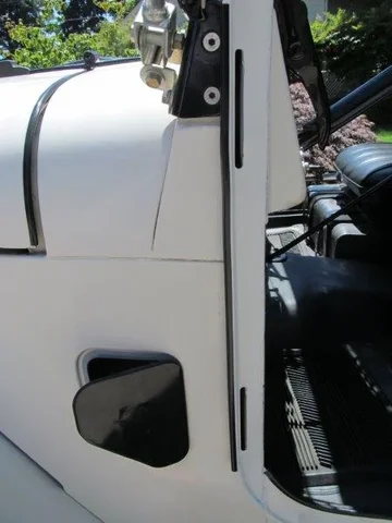

Put in new cowl vent tubes. Of the two old ones, the one on the right was missing completely, and the left one was deteriorated to almost nothing, but I was glad it was still there as it helped me find the fitting. What a bugger of a job it was for me, but I am so tickled that I was able to get it done! I solved the problem of water coming in the cab!:clap:
I took a few pics, and so did my DH.:)
nut plate alignment
Removed the body mounted hinges to get them powder coated .
A real bugger getting the bolts off ... Hope I can get them back in
What works for me is to fish a ~1.5" drywall screw (or nail or whatever you can keep a grip on) through the mounting holes in the A-pillar and roughly line up the nut plate.
Then insert the A-pillar half of the hinge through the slot - into position and then use the alignment tool through the hinge half, sheetmetal and through the floating nutplate. Once you have one hole lined up with all three parts, the other holes should be close enough for starting the bolts in adjacent holes. A bit of WD-40 or PB Blaster on the bolt threads goes a long way in getting them to thread in.
