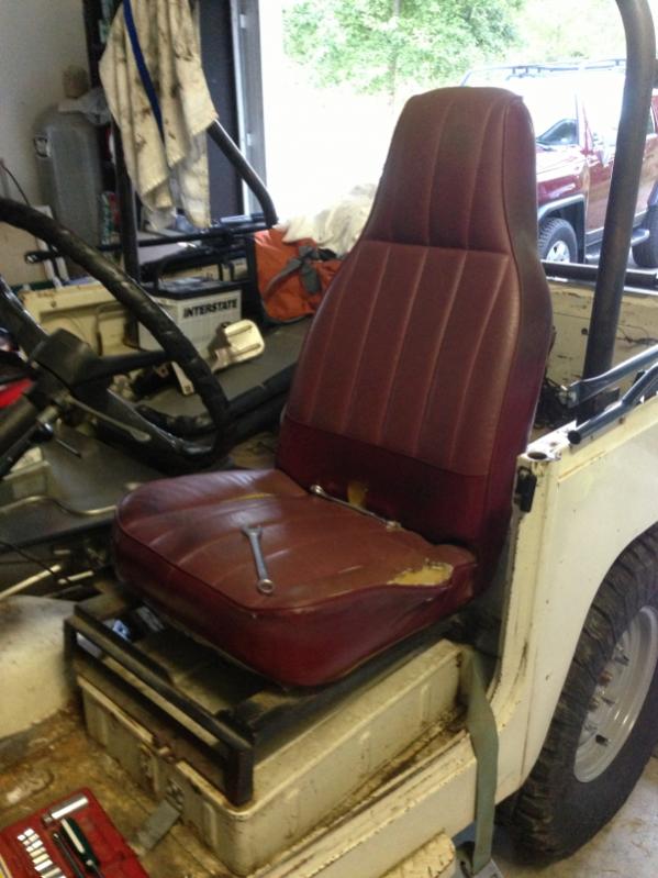

Stubby ratcheting box-end wrenches are a real boon in this situation too.

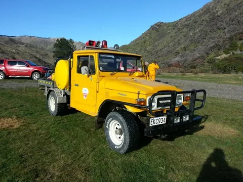

Here's a pic of a kiwi fire truck (1979 HJ45):

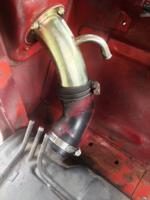

I've been smelling gas fumes in the rig lately, mostly after filling up. I thought I should check it out this weekend. I was thinking maybe the vapor separator split or a cracked hose. Here's what greeted me when I pulled the cover off.
My 2-1/2 year old CCOT aftermarket hose. :bang:
I guess I should feel somewhat lucky, in reading a few posts about CCOT's replacement, many said they were replacing them after a year due to failure. It was replaced when I installed the CCOT filler neck. The PO had jacked the factory neck so he could use his old style jerry can. The "new" hose was so pretty and new, that I left the old hose attached the the OE filler neck and tossed it in the corner. I was planning on ordering replacement fuel hose from McMaster Carr, so I dug out the old filler neck to get an accurate measurement on the diameter. My day became much brighter when I saw the original hose was still attached to the neck and it was in perfect condition for a 38 year old! :bounce::bounce2::bounce:
But damn if it wasn't a bitch to get it on! I had to pull everything to get it in place. The old rubber was much stiffer than the soft and cracked CCOT POS. Happily, the gas tank only had 5 or 6 gallons in it.

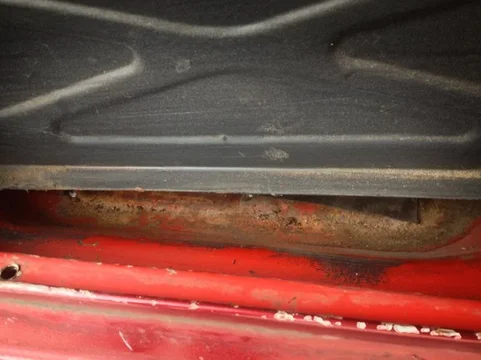

I did however get a peek at the pan under the tank.
Looks like I'll be scheduling a fix for that in the near future.
