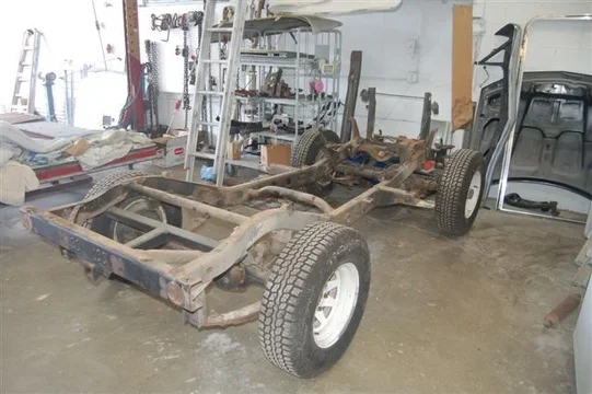

Stood in the shop during lunch and wondered how "let's get it cleaned up and running" turned into this...:D

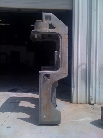

Started half doors.
