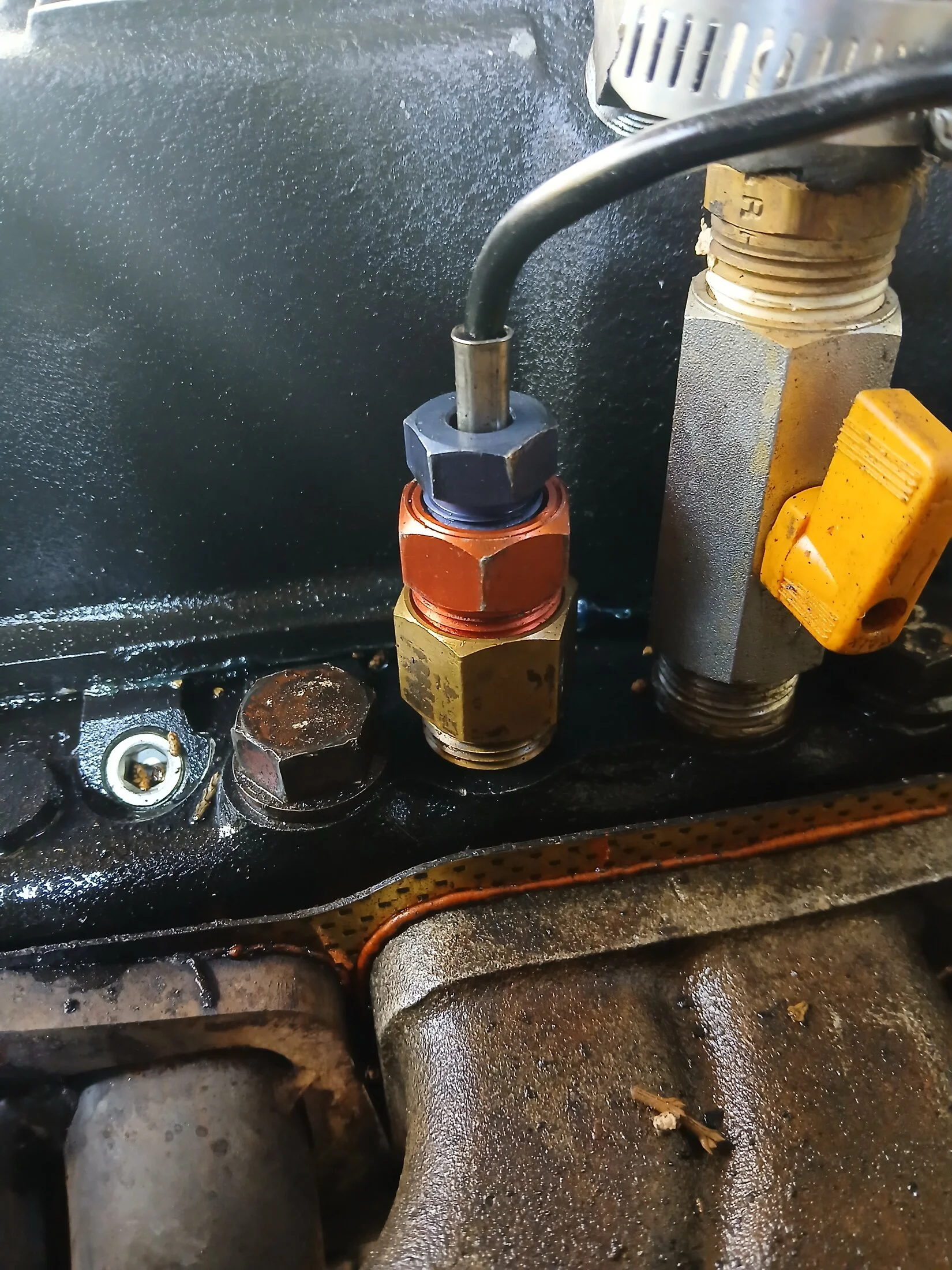

@cims1970fj40 …as I remember correctly, Red Line has the threaded adapter bushing to mount the coolant temperature sending unit on top of the head..which is where mine is on my ‘75 2F…
Read the full page to decide if you may need this…I did. 2F/F Reducing Bushing SNIPER EFI COOLANT TEMPERATURE SENSOR RL1086 (FU1-11) – Red Line Land Cruisers - https://redlinelandcruisers.com/shop/60series/fj60-2f-sniper-kit/2f-f-reducing-bushing-for-sniper-efi-coolant-temperature-sensor/

Was included in the Autometer watertemp gauge package...

Thanks for the looking out. That’s one of the items I bought.

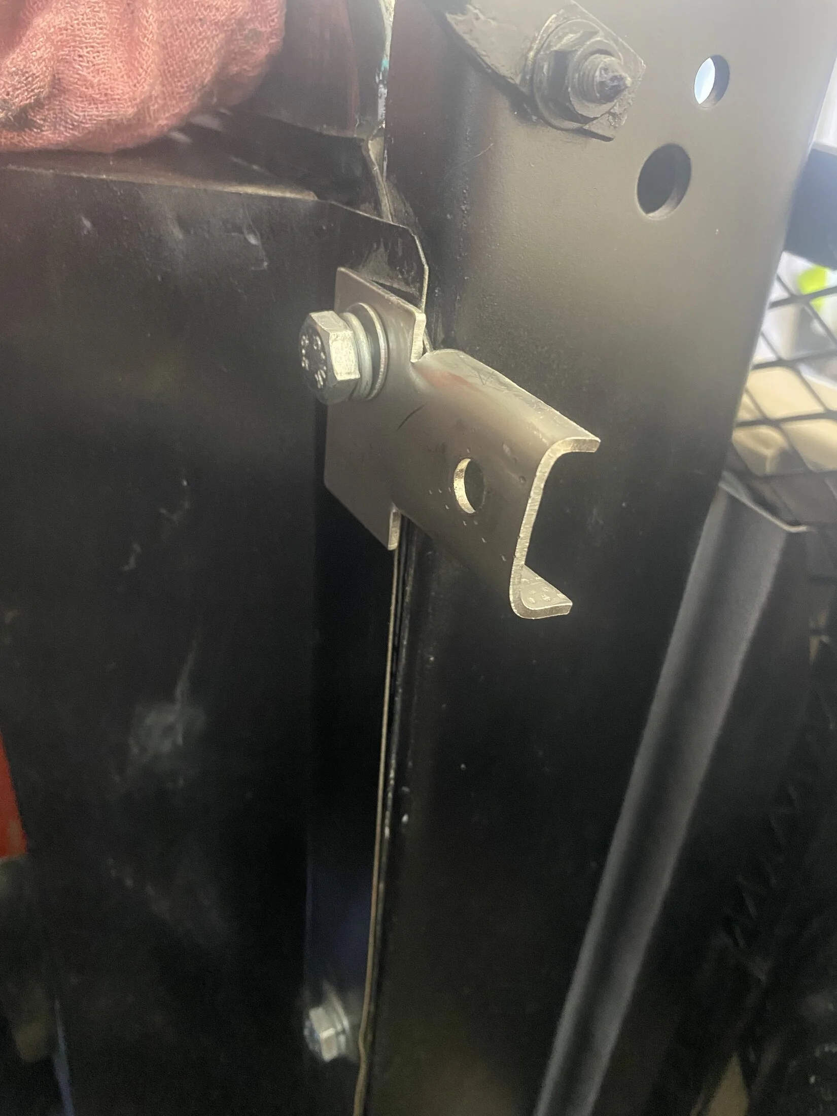

Installed a couple upgrades this week from @65swb45. During our off-roading trip my annoying loose-key fitting ignition switch leveled up to anxiety inducing. I’d get through a rough patch and look down and my keys were gone. Now I’m sweating cause I know I’m going to stall it and be stuck on a hill somewhere.

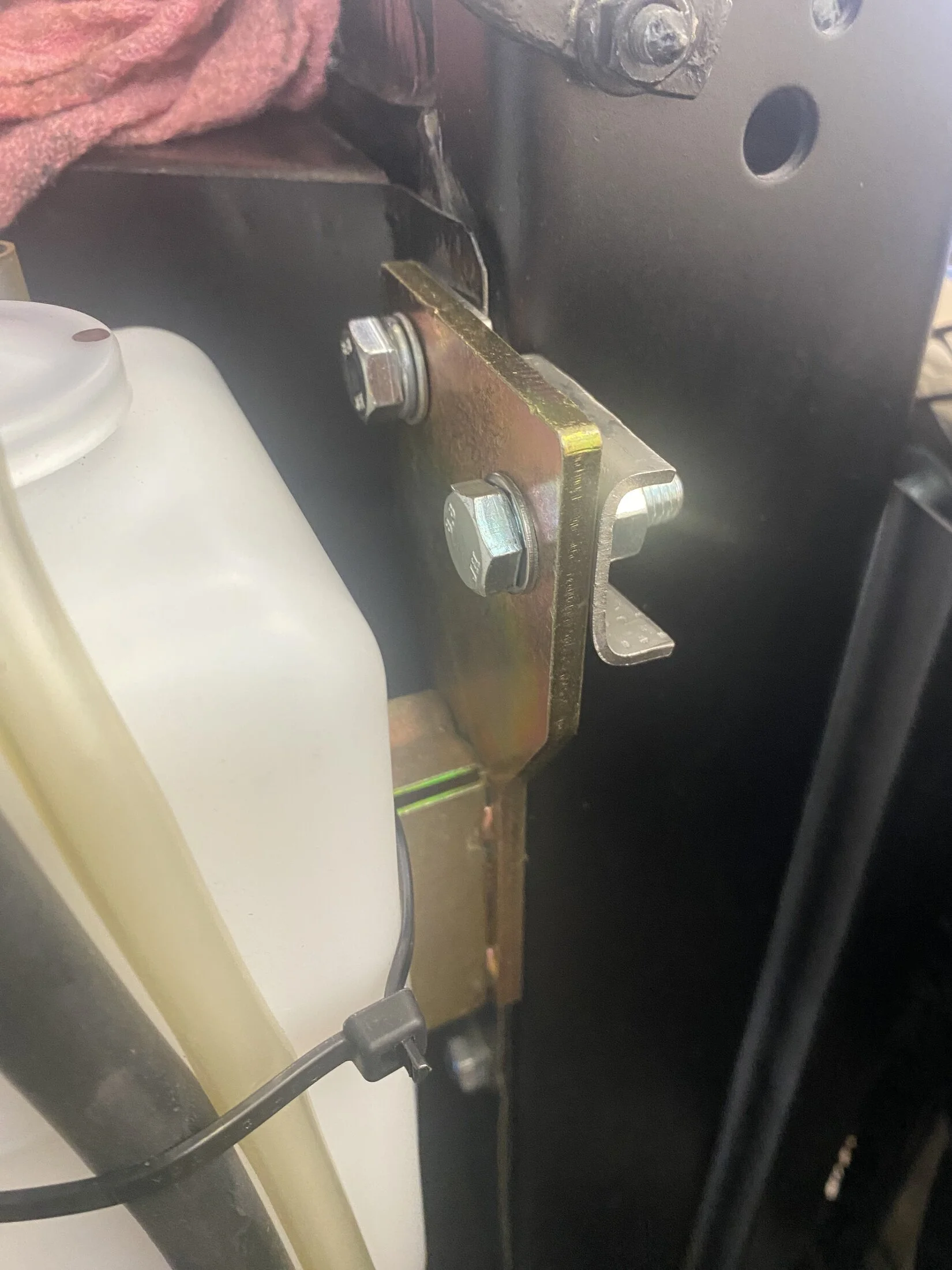

Second was to replace my Autozone special overflow tank; which would have been fine but it’s like my third one that leaked at the mold line.
I built an extra bracket for the new tank with some bent tabs that allows it to bear up against the radiator and not rotate since it’s on with one bolt.

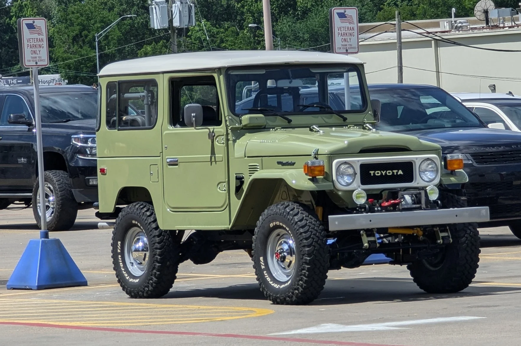

Took her for the first road test in 25 years up to LOWES and a fill up of some go go juice. Couldn't get out of the parking slot before being stopped by three people who absolutely loved it. Again at the gas station and down the road thumbs and rubber necking!! Crazy attention these things get😳😁
