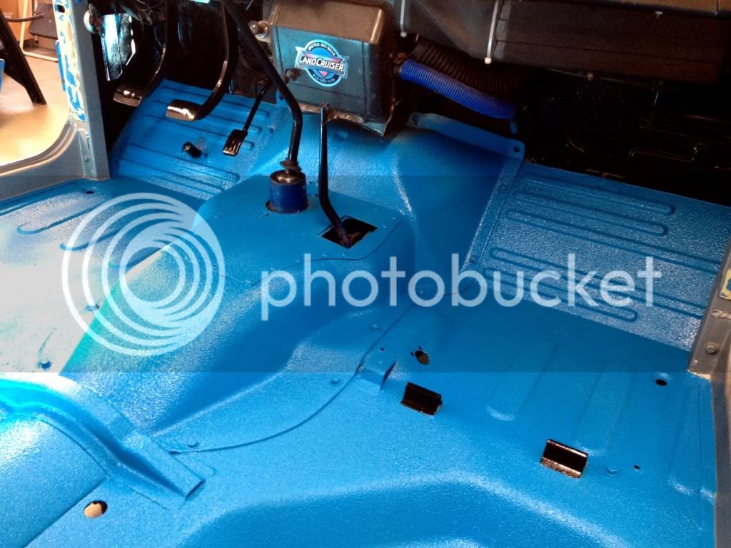

I'd like to read a step-by-step of the tinting process from someone who has done it. My 40 is the same color as yours and I'd like to line the interior. What did you use to tint the liner, where did you get the tint and what was the process?
Look really good.
Easy! I just did it. Add 2.5 oz of paint color to the bottle (get paint at auto body supply store) have them mix the color with no binders added use the paint code of your choice. When mixing you can go up to the 2.5 oz per bottle and I started with 2 oz then shook and compared the color to the truck. Add up to .5 more til you get a color you like. Once you like the color you know how much to add to the other 3 bottles so they are the same. Add hardner and shoot. This stuff is very nice and my 5 year old sprayed some. This is the easiest interior upgrade you can do! It took me 25 min to mix and shoot(I masked and prepped the day before)

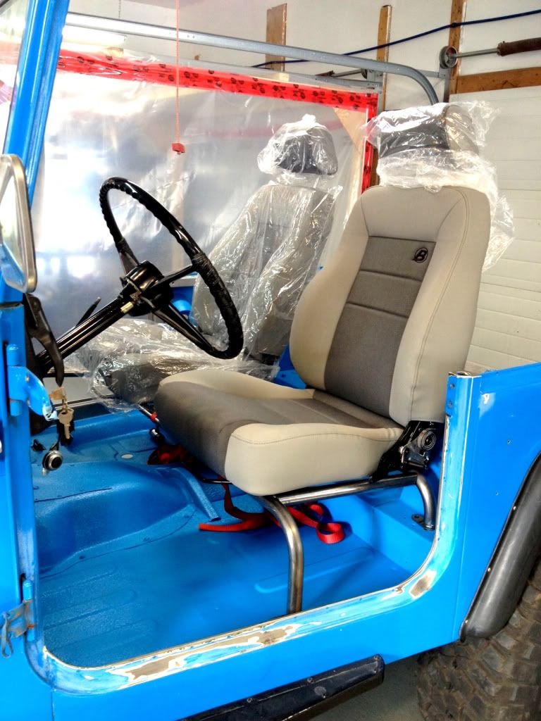

Finally got 100% of the new wiring done and actually drove down the street and back. First time on the road in over two years during restoration!!
