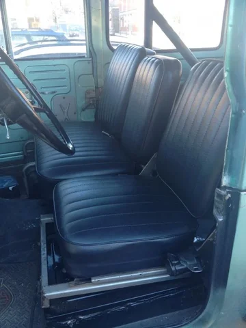

Scored some old school seats that are in mint condition! Got rid of the jerry-rigged buckets and now I'm bouncing and sliding down the road! :bounce:
