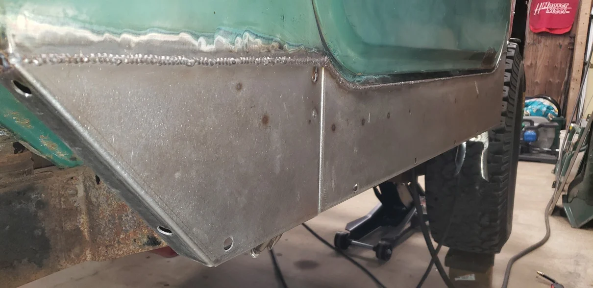

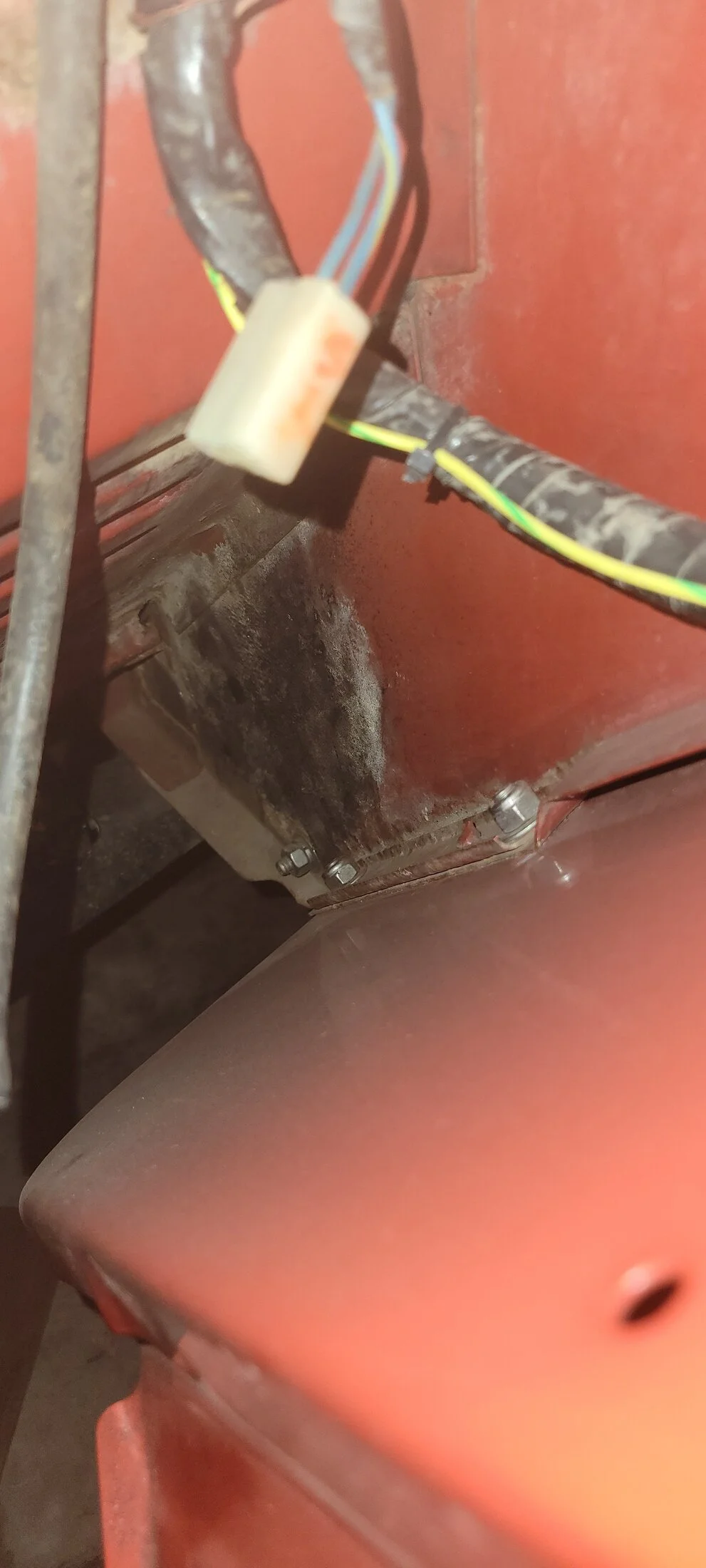

Just follow the angle down to meet the horizontal bottom of the rocker. Easy peasey.
Interesting there is a gap between the vertical bottom section of the fender and the body by design, but I guess the step covers it.
The fender bolts the frt of the step, the step then bolts along the bottom vertical part of the rocker and frame extentions.

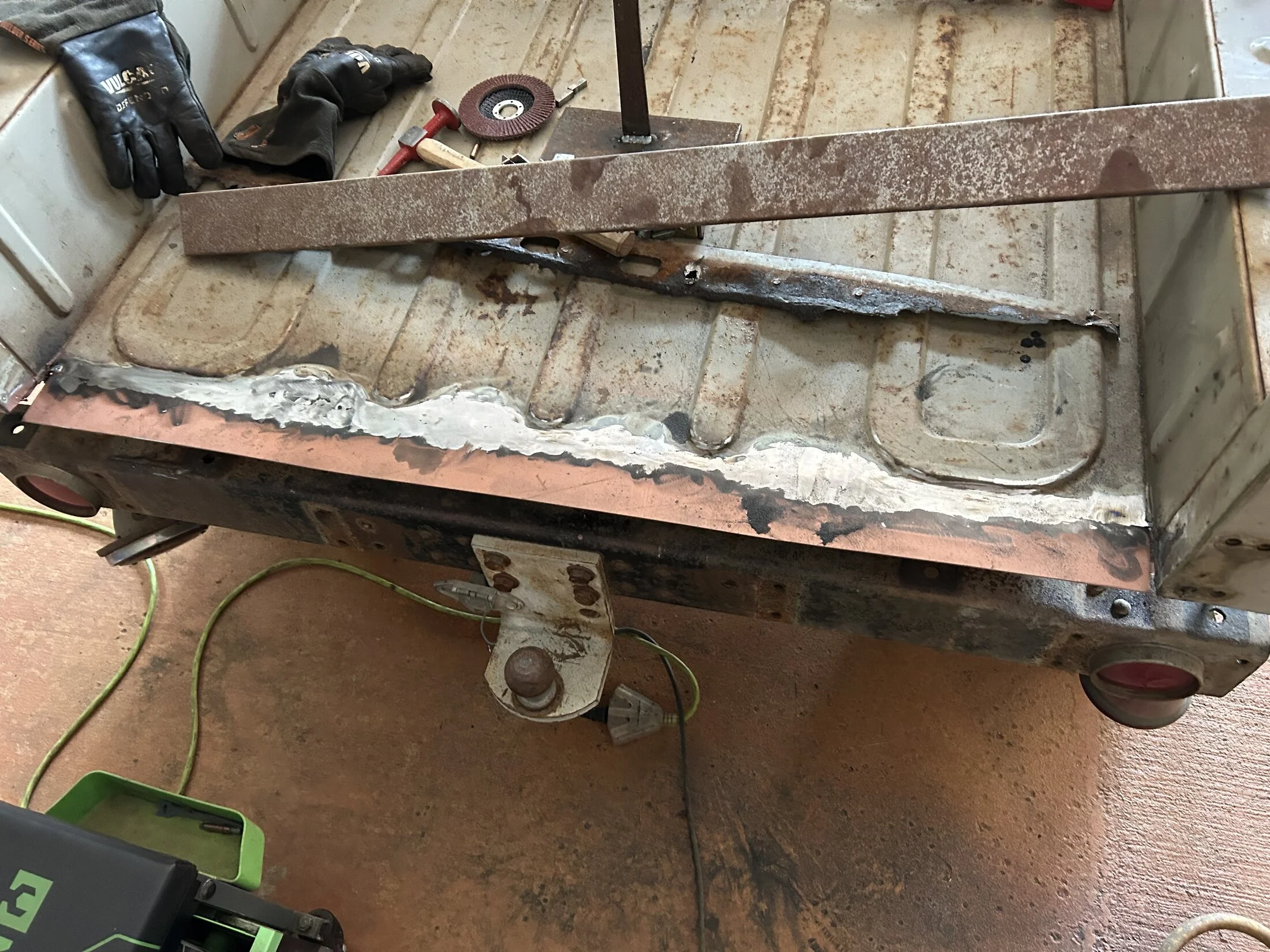

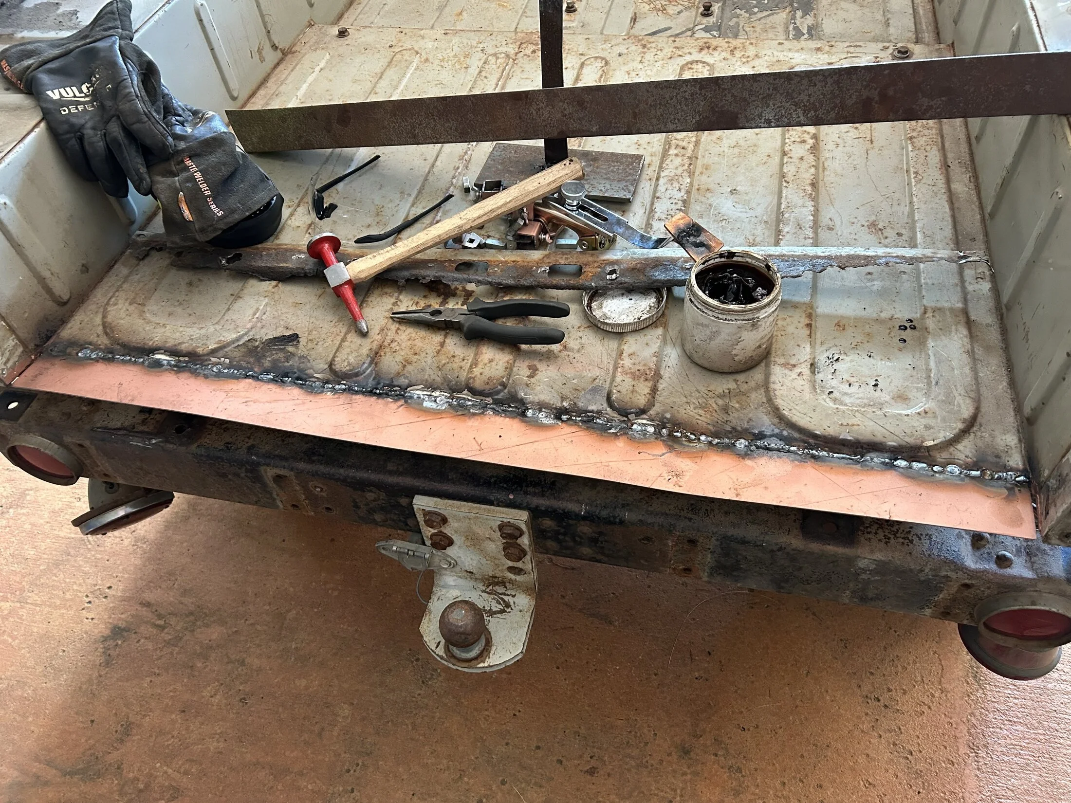

Only spent a few hours today working on it. Welded in the new rear bed end, cut out more of the drivers side pan, outside and inside kick panel, and made a rear sill cover from the sheet steel.

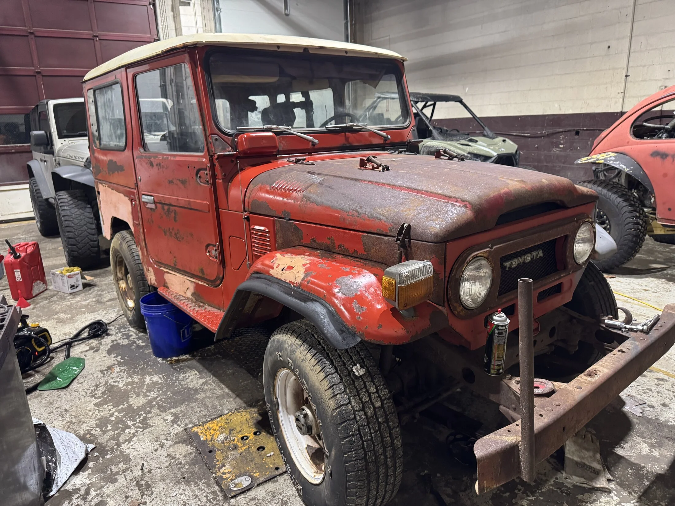

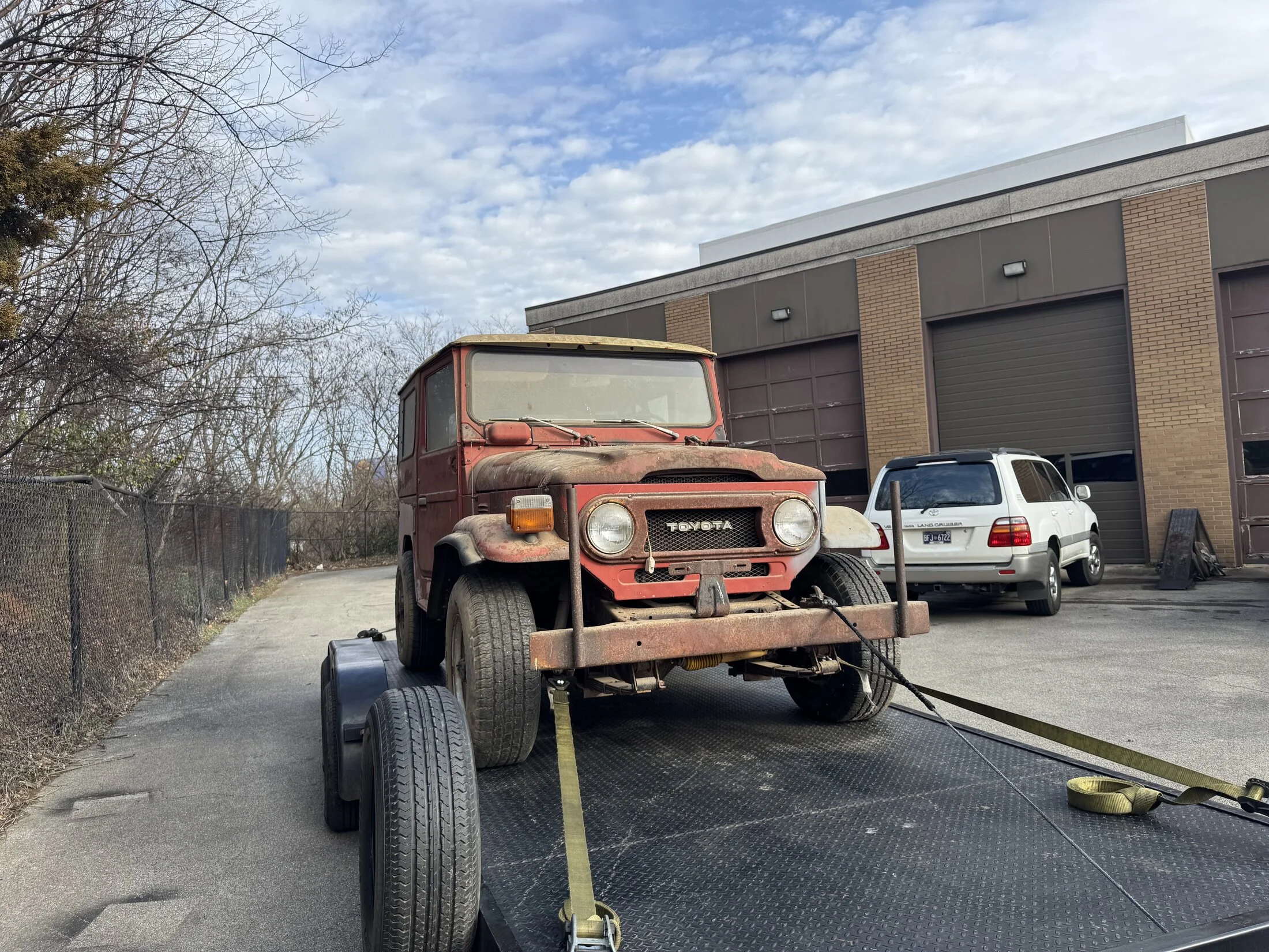

I picked up a well loved horse farm truck whose PO started a “restoration” before passing away. They’d owned it since 1985. It had been sitting in the lean to I (and a few good friends/ bad influences) pulled it out from under for who knows how long. Along with mice droppings and nest material, the ashtray was still full of his salems (even found a few still in the pack on the floor), and a bunch of the parts I had noticed were missing when I went to look at it last weekend.
Even though my 1967 has a 2F and 4 speed, the 1978 seems very, very different. While I originally wanted parts off of it, it’s so complete that it deserves to be revived and live on. So that’s the plan now.

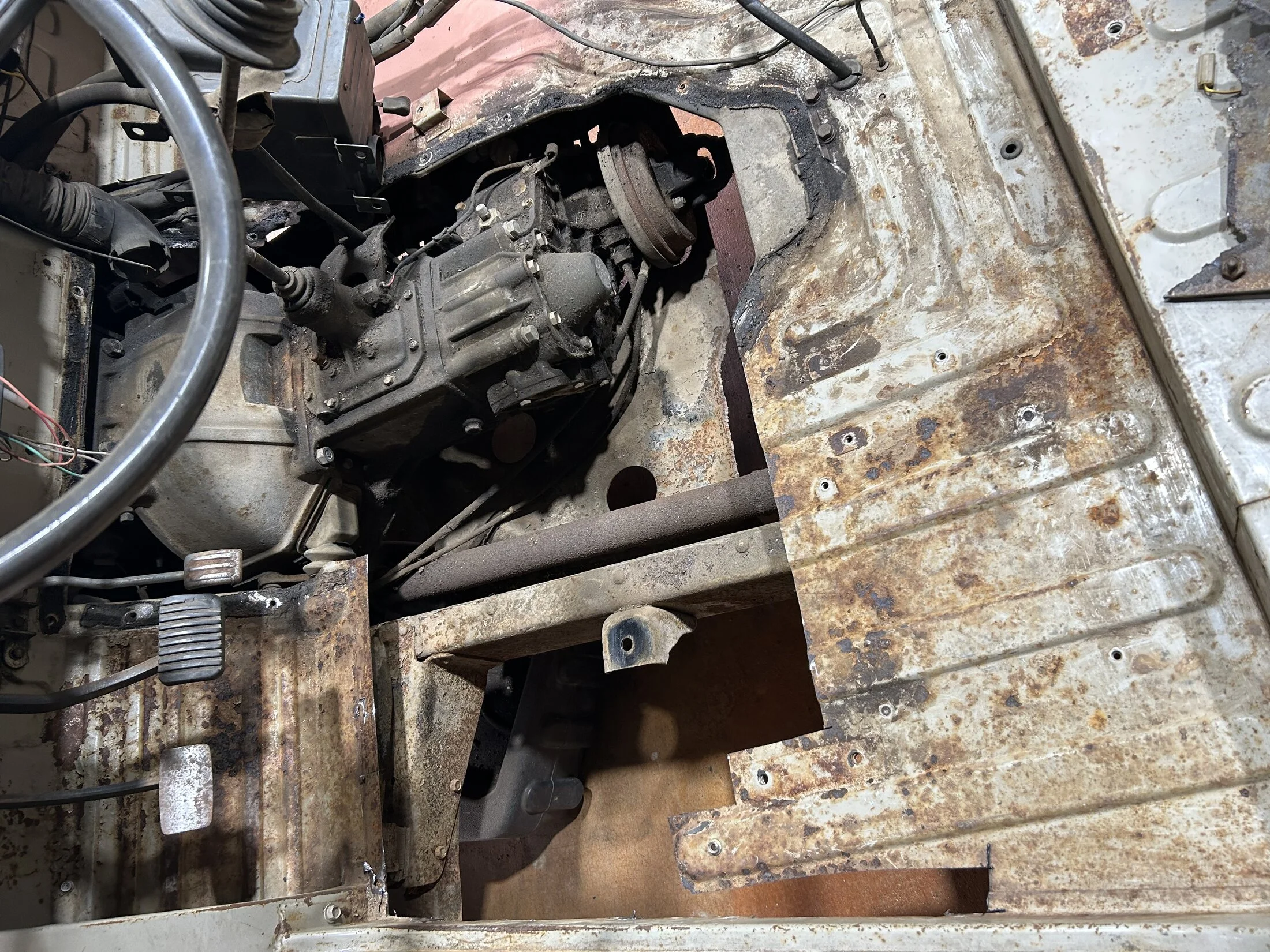

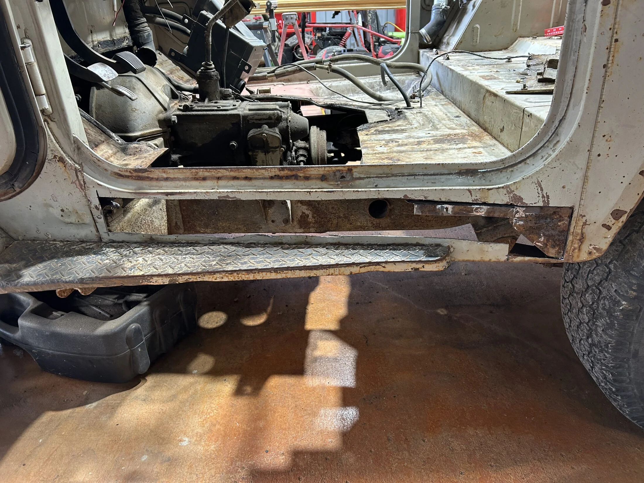

Test fit the rear sill cover I made. Waiting on the rear sill itself to show up. Discovered another glorious hole that needed to be filled on the tub corner. Cut a new drivers side floorboard and started stitching it in. I’ll finish the drivers side panels tomorrow. Inside kick panel will be fitted and bent and then I’ll put the outside kick panel onto that piece.
