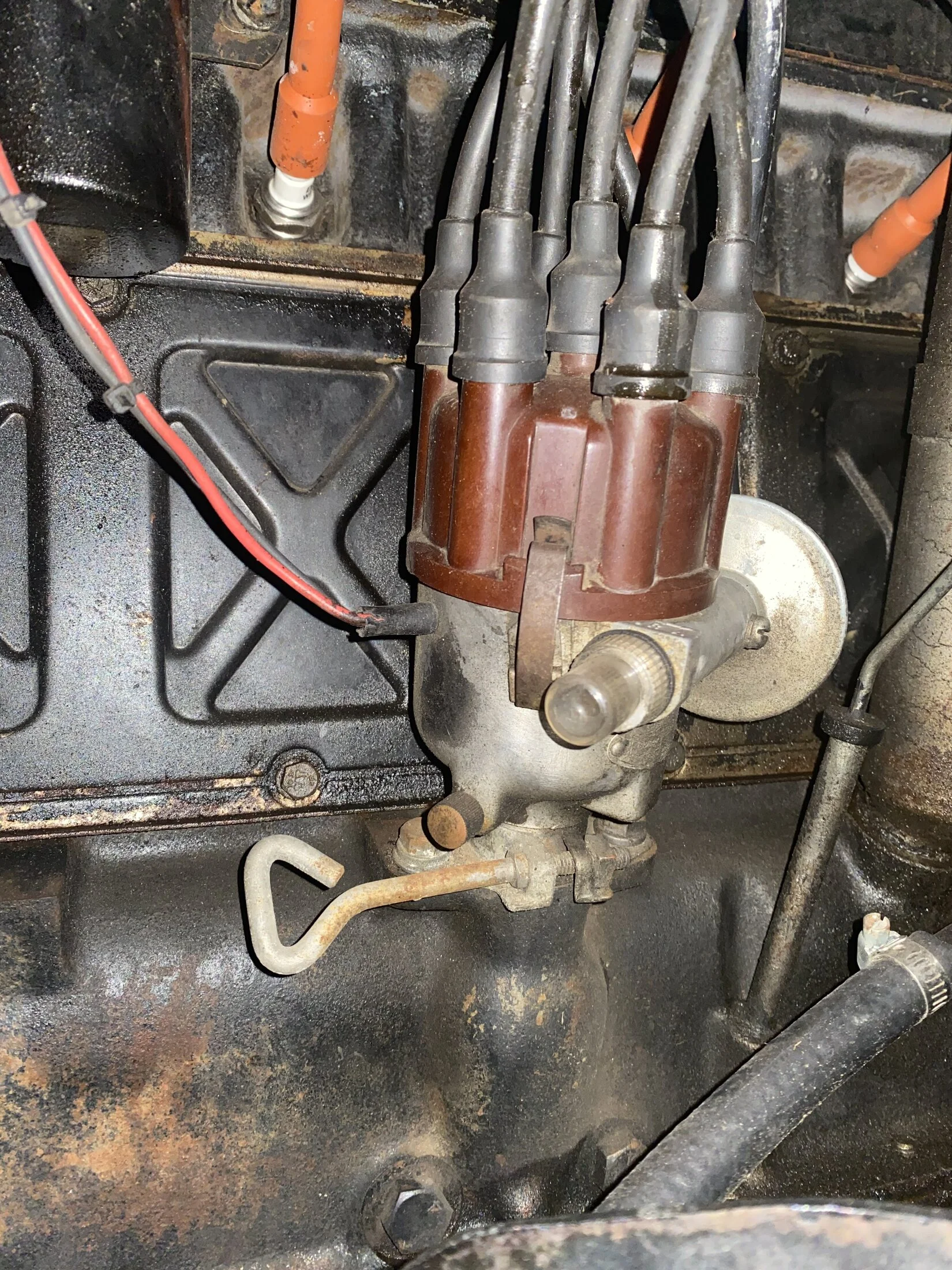

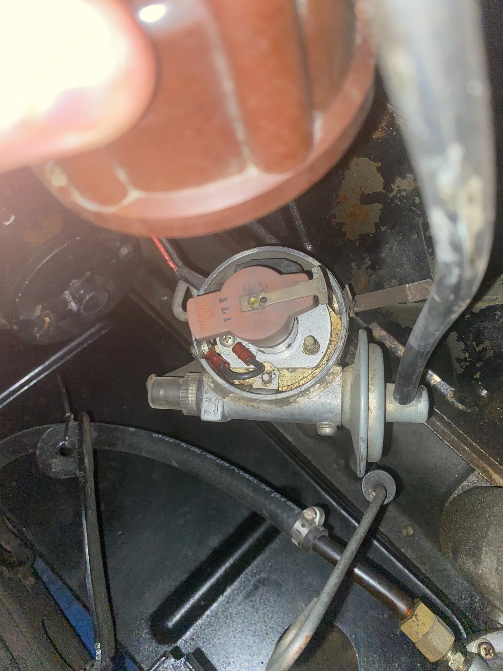

What distributor do you have? If you're still running points, set the dwell (point gap) before you try to time it. My dad always said, "Timing doesn't change dwell, but dwell changes timing". Also, know for sure what your vacuum ports on the carb do and hook up your distributor's vacuum advance to the correct port. Some distributors want ported (venturi effect) some want full manifold vacuum.
Great question on the distributor. I’m not sure if it has points or not to be honest.
Can you pull the top and rotor and send a photo of the inside?
Here are a few pics.

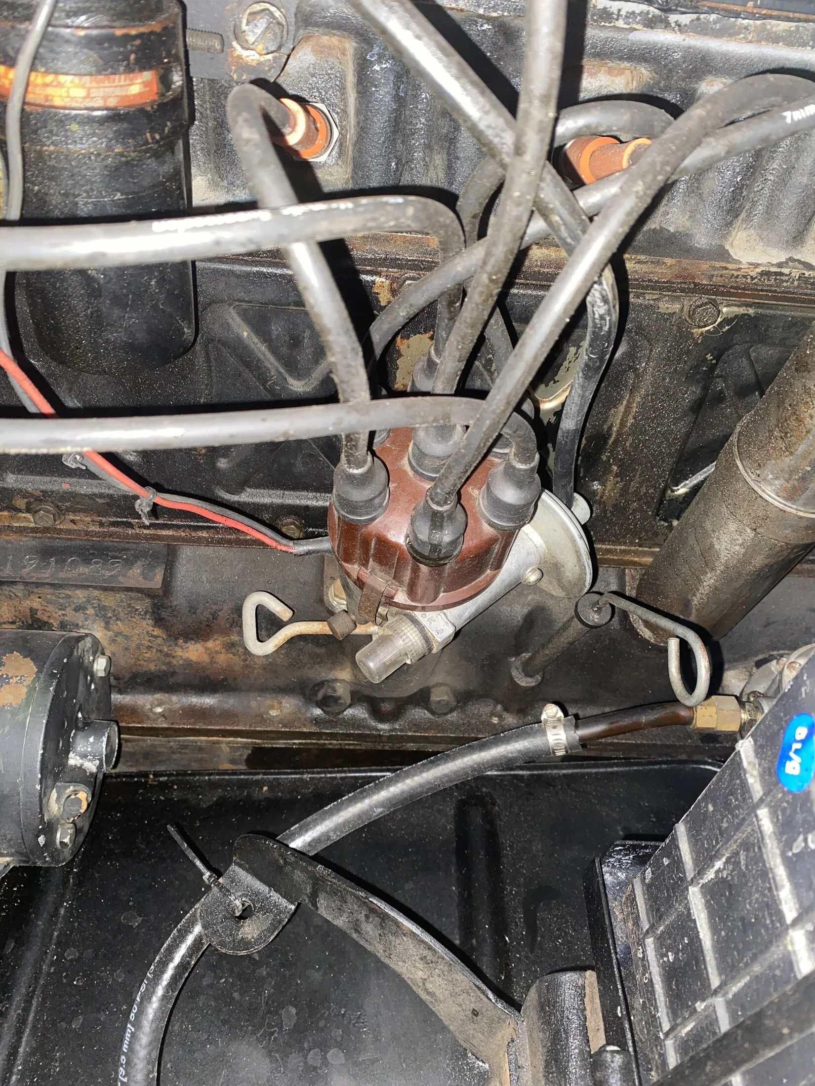

Does MUD have a newbie dunce award? If so, I nominate me. I couldn't wait to find out if my loaned out (or possibly lost) timing light was around, so I ordered a new one on Amazon. Of course they delivered it at 7am. Did you know they have ones with digital screens with built in Tachs? Even if my old one is found, it will never get used again. Sorry old friend, but the new guy has better tricks. I couldn't' wait. I started it, put it outside to warm up and then unboxed the newbie. Pulled it back in where I can work and went to find the 10mm that loosens the distributor. Hmmmm, what's this? One of the plug wires is disconnected at the distributor. How long has than been like that? Probably from when I pulled the carb. Hook it back up and shut it down. It dieseled like crazy. Loosen the distributor and checked timing. BB nowhere in sight. Adjusted a bit. Tightened, check again, looks good. Ran like a champ on the way to work. Shut down ok. If you need more evidence of my idiocracy, I can provide it as part of the nomination process. :bang::bang::bang:

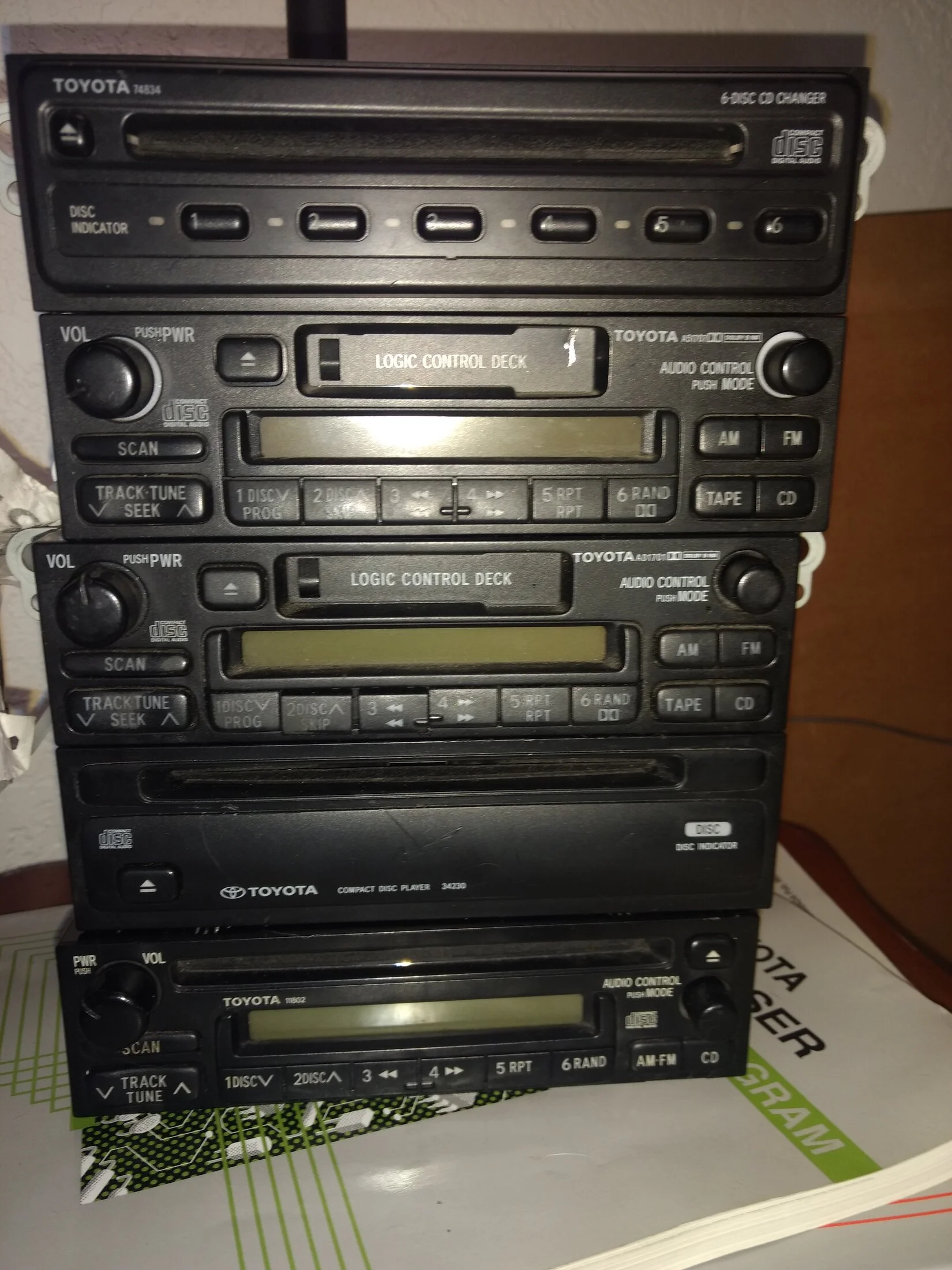

I installed a 2000 Camry single DIN Toyota branded radio in my 60. They also came in early 2000s Corollas and seem to be about $10 at the junkyard. AM/FM/Cassette + optional trunk mounted CD changer. You can wire the CD changer input for Bluetooth, which I’ve done. So I have radio, tapes, and I can set up some music playing from my phone. No adapters, no visible wires. I bet it can be installed in a 40 as well. It’s just a matter of wires for battery power (if you care about preset radio stations), ignition power, speaker wires, and ground. The Bluetooth system I cobbled together takes more wiring.
Tubular!! Given Toyota's propensity for keeping part numbers in production, I don't suppose you have a part number for said stereo? Granted, you said it was in a 60 so I suppose it is single DIN, but it might fit with some small tweaks... Honestly, AM has great range, but it's the cassette I'm really after.
No part number unfortunately, but here’s a photo:
These single DIN units came with either a cassette or single CD player. They also came with an internal amplifier or premium that uses an external amplifier. I like the remote CD changer with a cartridge but after the 1978 model not as easy to find a place to mount one. Those the single DIN changer in the glove box would be a good option. Interesting that the external CD players either single CD or six CD will work with either type in the main unit. The CD player was either a single CD or six CD that could be bolted together with the main unit to make a double DIN or use a remote six CD changer. The external CDs players with also work with the early 2000s double DIN audio with either a single or six CD changer built in. I haven't found any $10 units lately but I have collected a bunch of 1998-2002 Toyota audio units over the years. Some came with bracket the single DIN units slide into. Thinking might be possible mount to the dash of an FJ40. External amplifier would possibly to upgrade the amplifier from these units to more modern amplifiers. Toyota's amplifier around the turn of the century were pretty lame.
