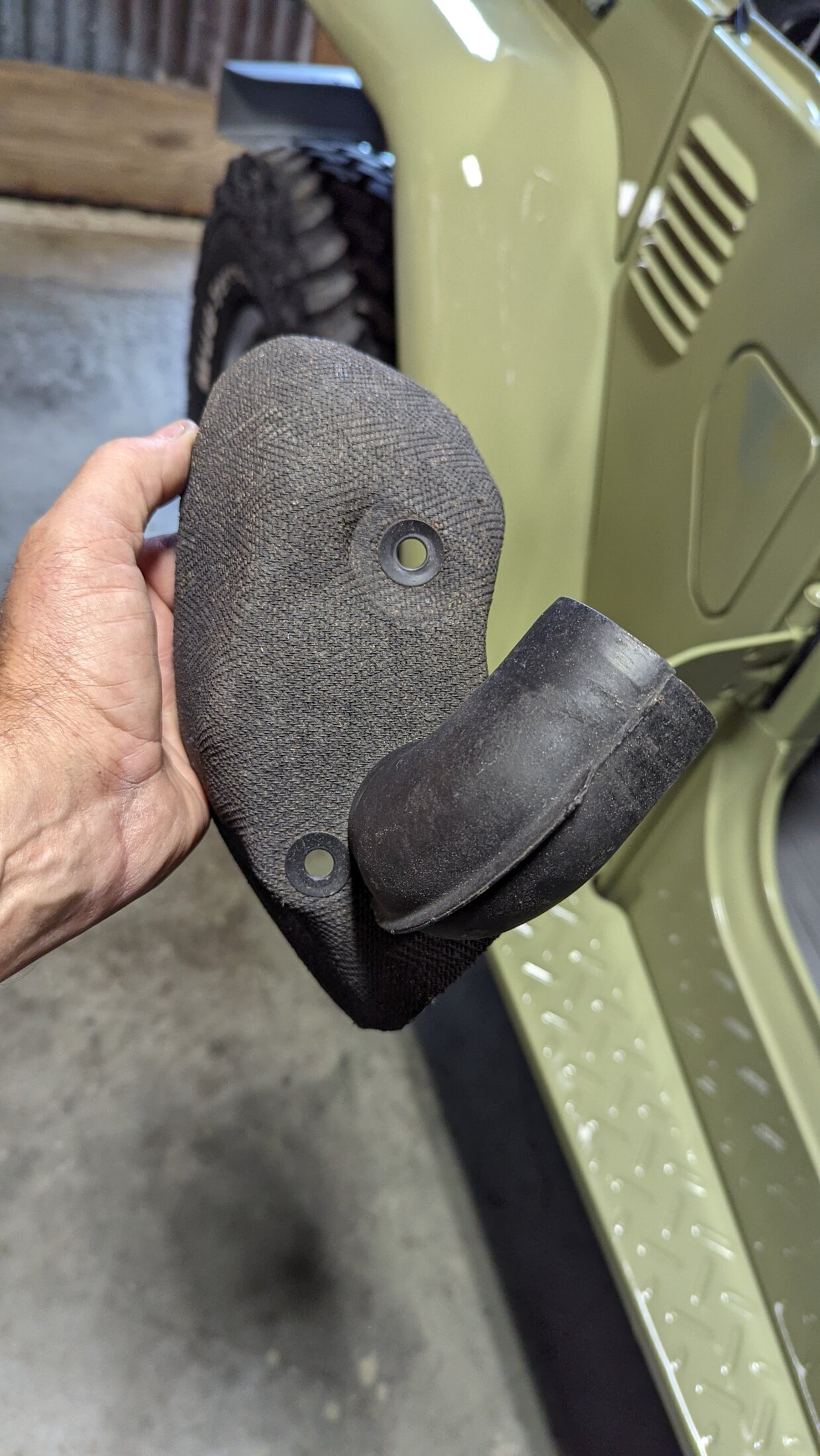

Installing some "unobtaineum" parts today 😎
I bought it years ago on eBay back when you could actually find new OEM parts (old stock) without getting raped.

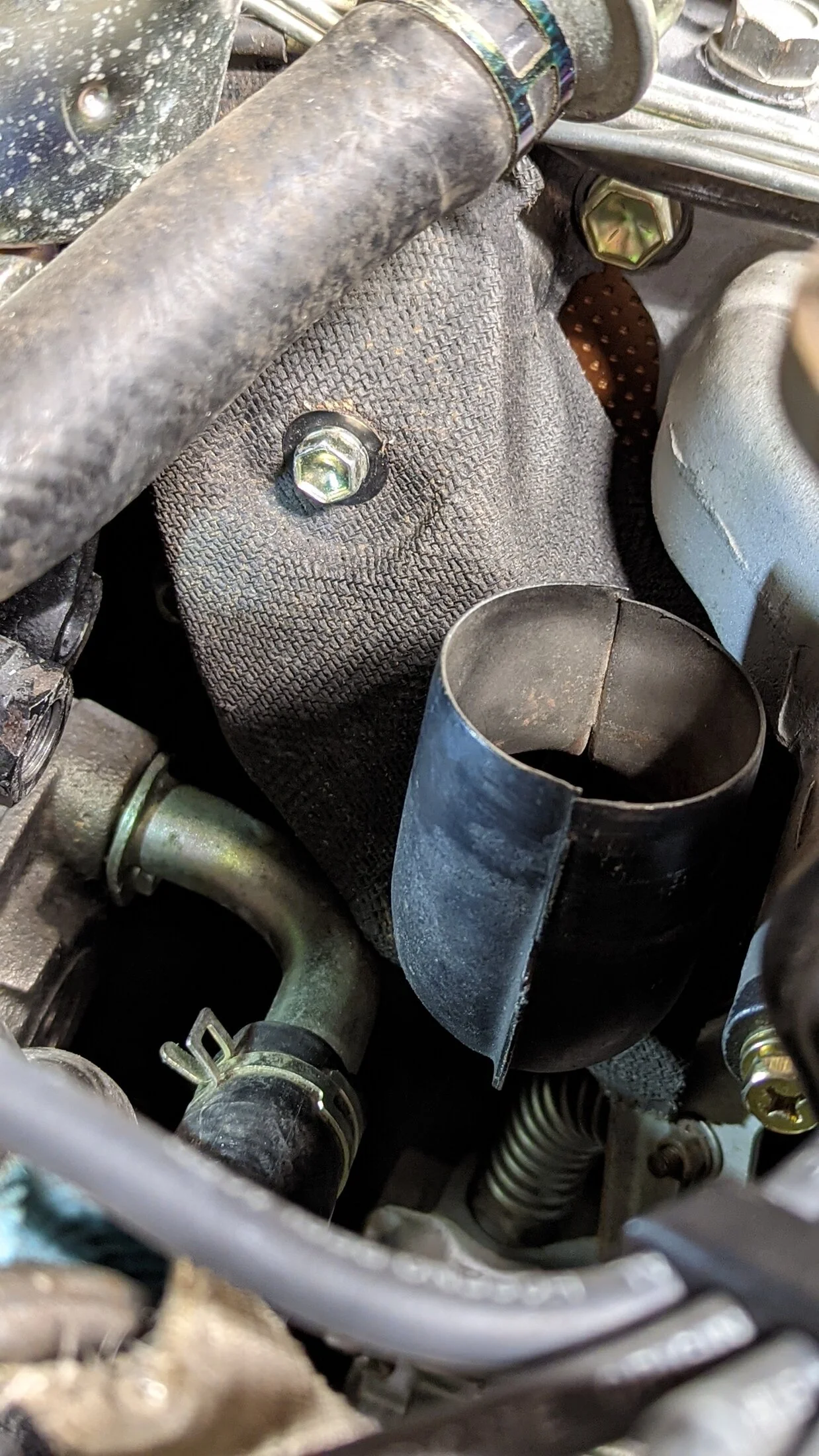

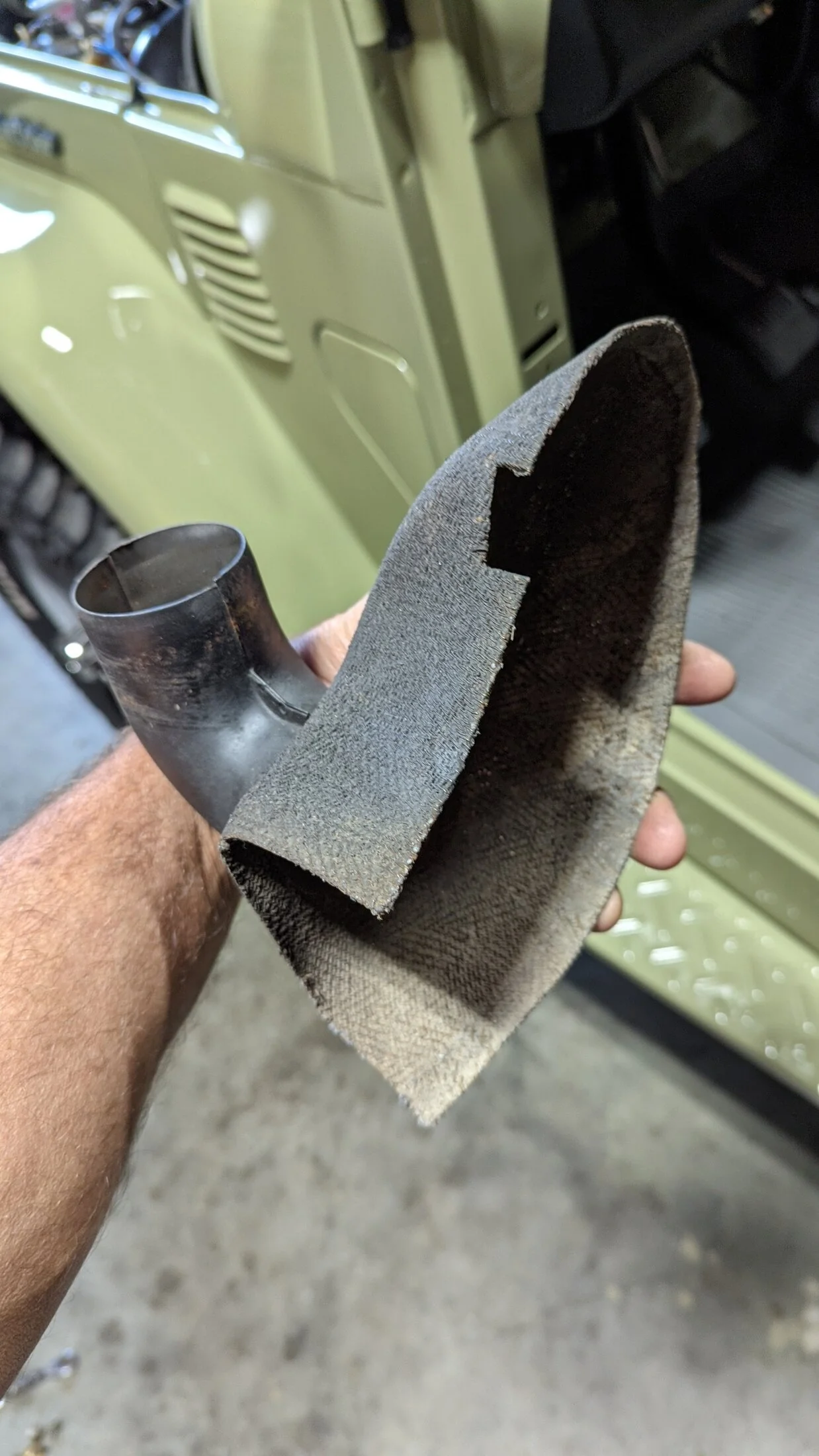

My guess is hot exhaust manifold air to intake via 2F air cleaner assembly? I tend to think that insulating fabric was inside the metal heat shield.
It is but never even made the metal shield as far as I know. Made the not the metal riser and mounted the the exhaust manifold. All that I've seen still attached only have the fabric pieces hanging off. Pictures posted

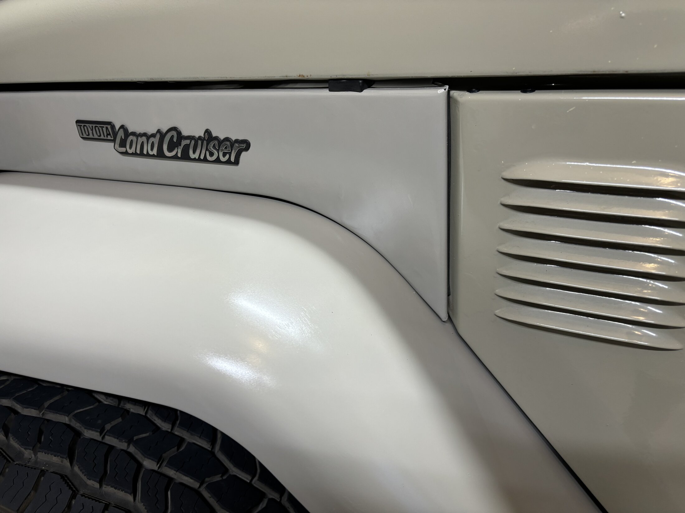

Spent last week disassembling and restoring the paint on the front quarter. When I got the truck, two panels looked like they had spray painted over 80 grit sand paper.
I used the Dune Beige from CCOT and (no surprise) it doesn't match my truck, but, to be fair, the rest of the truck is not factory paint either. I am happy with the result in that it is smooth and clean and shiny. I'll eventually do a frame off repaint and rust eradication. At least I know these panels are sound and rust free.

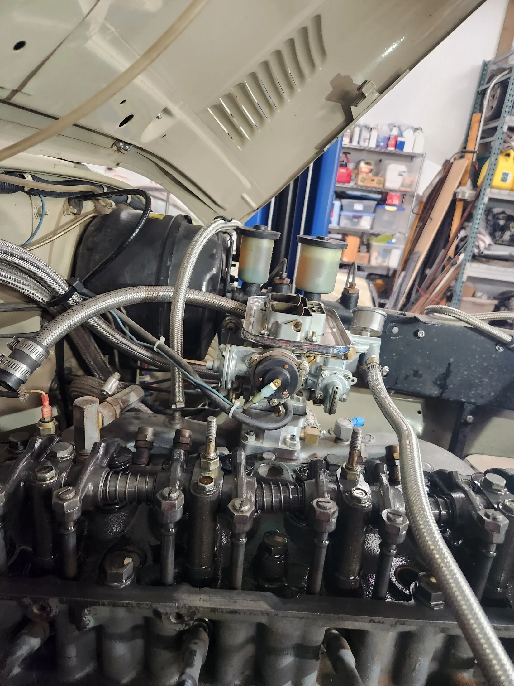

Continuing my various projects, I rebuilt the Weber (Empi) carb today. I wish this thing had the original carb setup but it doesn't. It started fine, ran fine when warm, but would die in between. I assumed a plugged idle jet or screw or maybe the choke hanging up in transition. It wasn't all that dirty, some junk in the float bowl, but everything was very loose. Screws holding the top to the body finger tight, etc. The screw holding the accelerator linkage to the choke housing was really loose, causing the linkage to "walk". I took everything apart, installed some carb kit new bits and added locktite to the screw that holds the accelerator linkage. It started up fine, the choke seemed to transition well. It took me all day so I didn't get to drive it. Hopefully tomorrow.

Well, it's not better. If anything it's a bit worse. Harder to get the high idle down and backfired and died until it got full warmed up. I'll work on the choke adjustment. If there a way to convert these to a manual choke setup?
