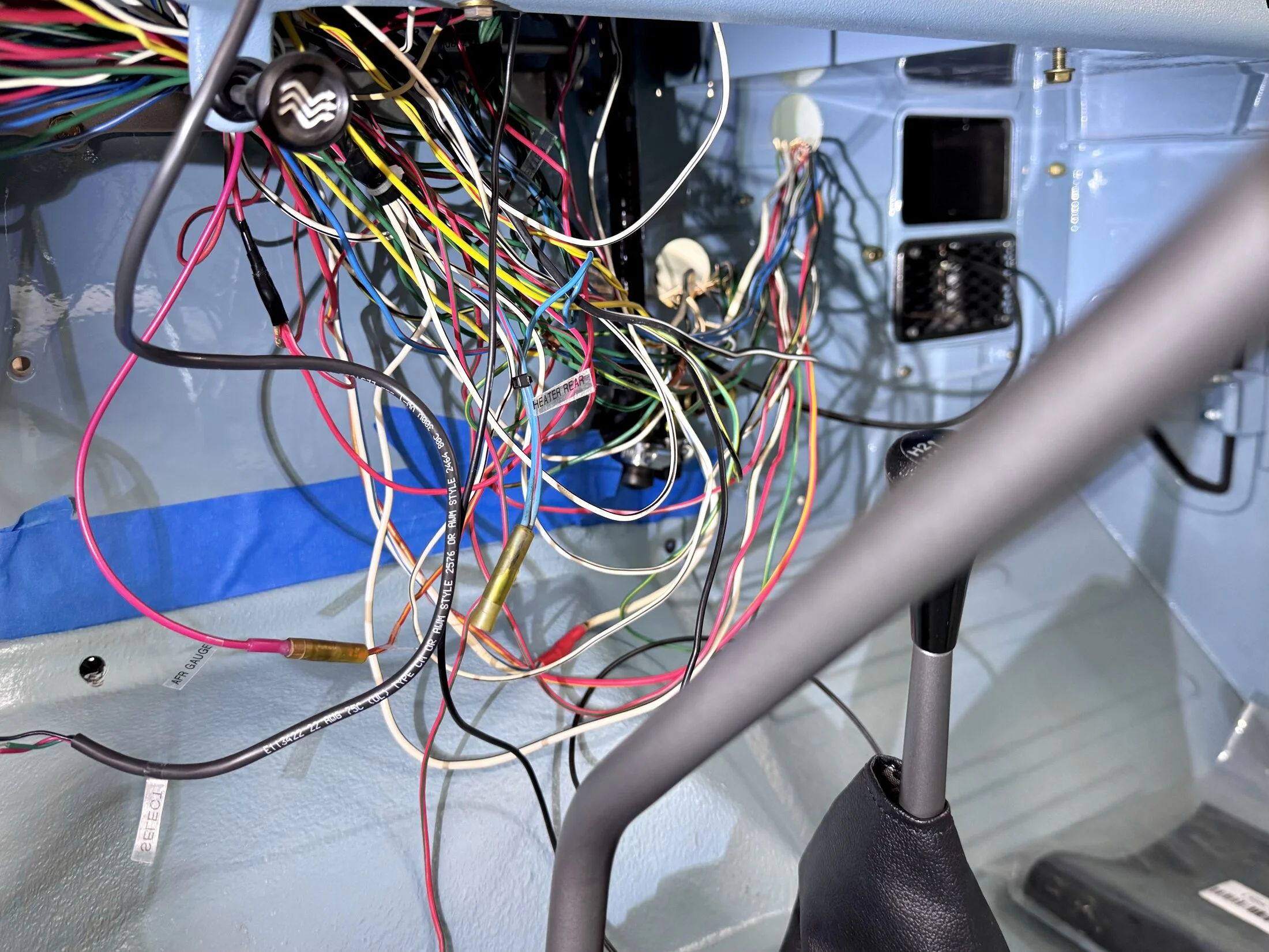

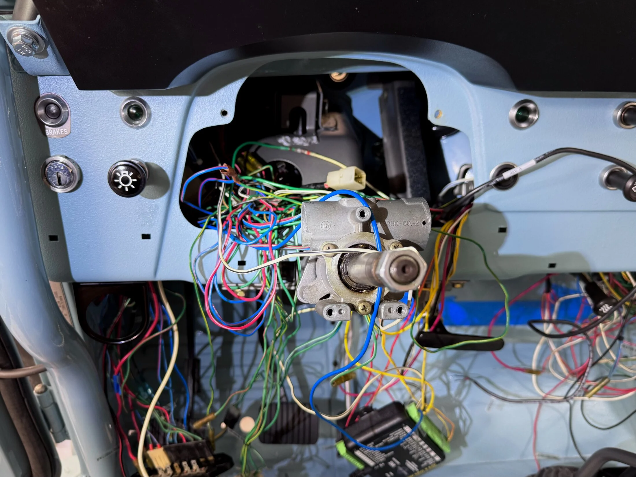

Working through the spaghetti! Thanks to everyone on the site for the help gettingn5ings sorted out. It’s the original ’72 harness that was mostly intact, but with a ‘76 drivetrain, DUI and Dakota guages there needed to be some moving things around. To add to it, only about half of the colors on my harness match the diagrams along with other small anomalies.
With everything spread out, it was easy to sort and everything is working 😮
I can’t remember why now, but for some reason, I decided to put a ‘76 steering column in the ‘72.

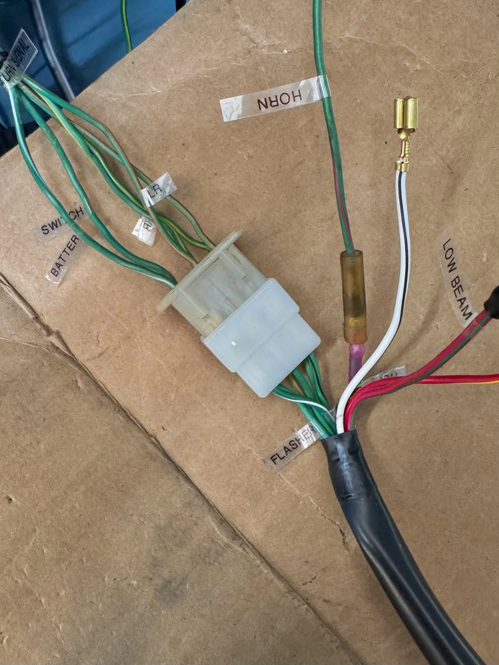

Now that I’m tackling the wiring I was really stressed about the late models turn signal switch with the early harness. Much thanks to Coolerman and all the previous posts on the subject I was able to get everything working. Again, most of the published info on the switch was wrong but after playing with it and the multimeter, I was able to get it working.
The big key is pulling the horn lead out of the connector and switching it out with the green/white lead from the brake switch.
Here is how it ended up looking

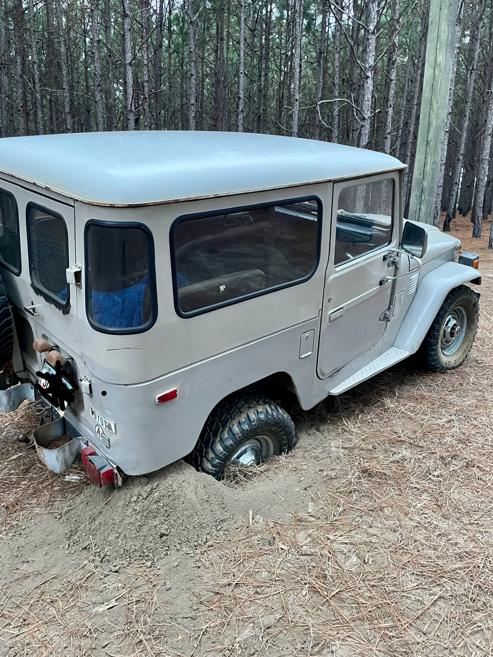

Looking at how that back wheel is dug in...did she keep going after hitting the pole?

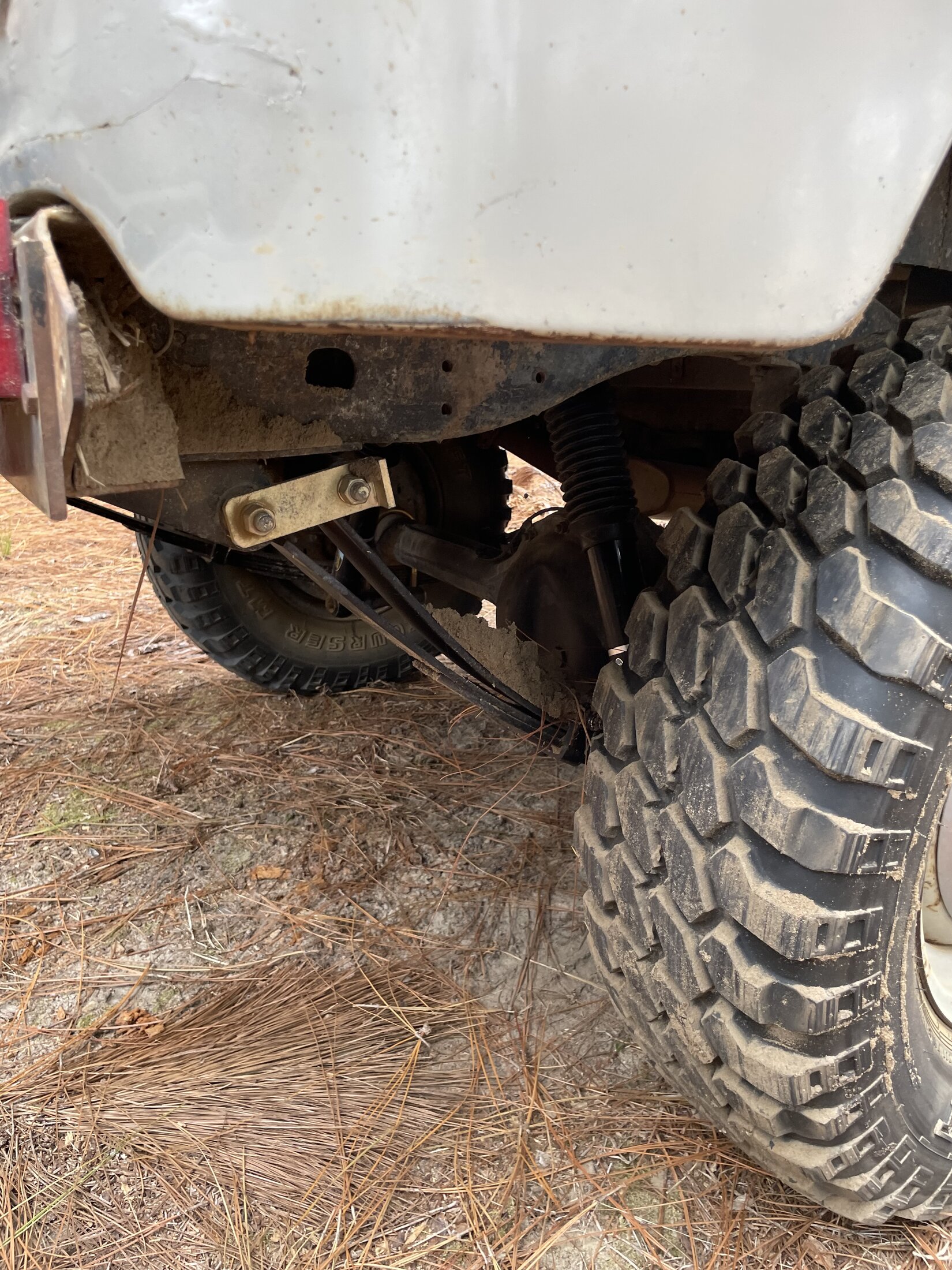

Not sure since I wasn’t with her at the time. The back spring shackle was inverted though. I managed to get it corrected with a bottle jack. On a good note, the new dobinson spring rear sag is gone now. Some of you guys that have the “sag” should try inverting the shackle over night and it magically cures the sag or just let your wife drive 😂

Looking at this picture I’m inclined to think she was mad at you big time.

Aren't those "Anti Inversion" Shackles? :oops:
