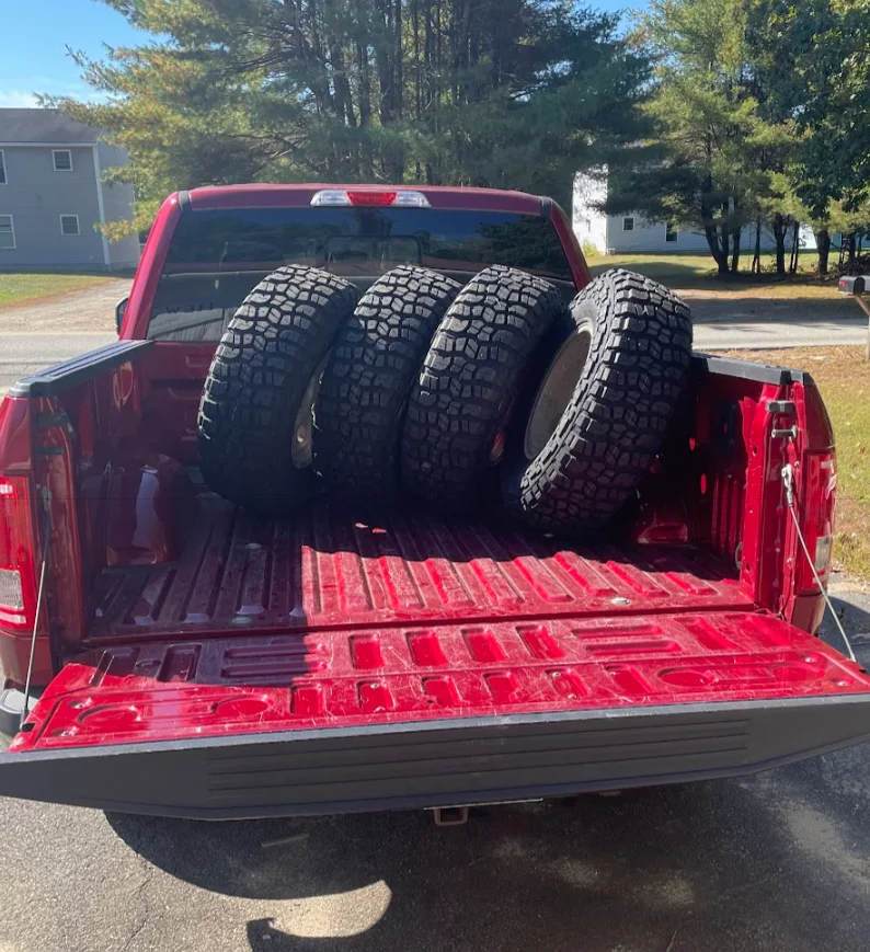

The old girl got some new shoes.

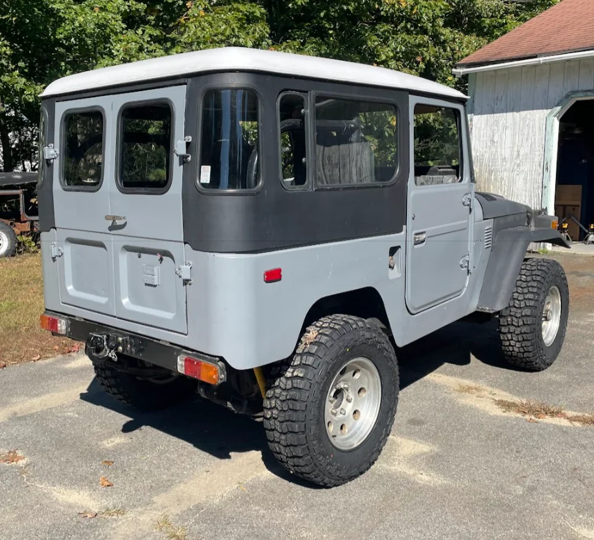

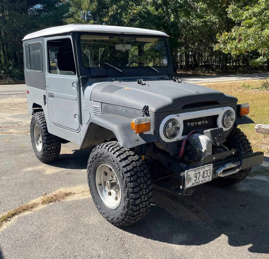

All doors got a refresh too. New door seals, window channels and rear window gaskets and paint
Trying to wrap up the final bits and pieces before the VT Pilgrimage this week. If you don't know about it, check it out.

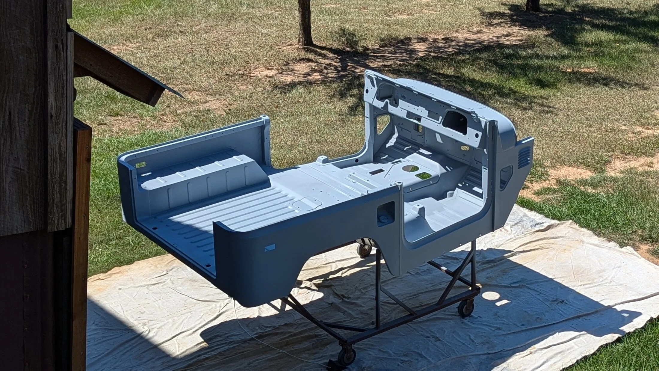

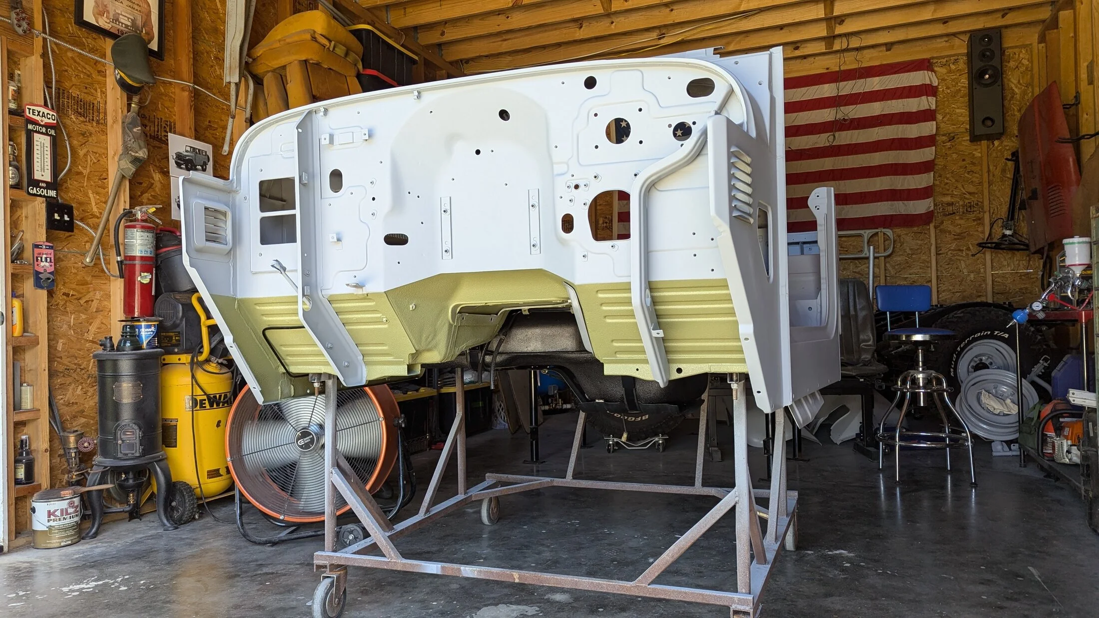

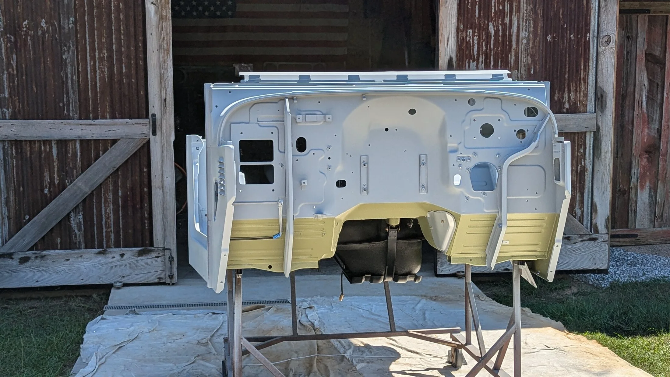

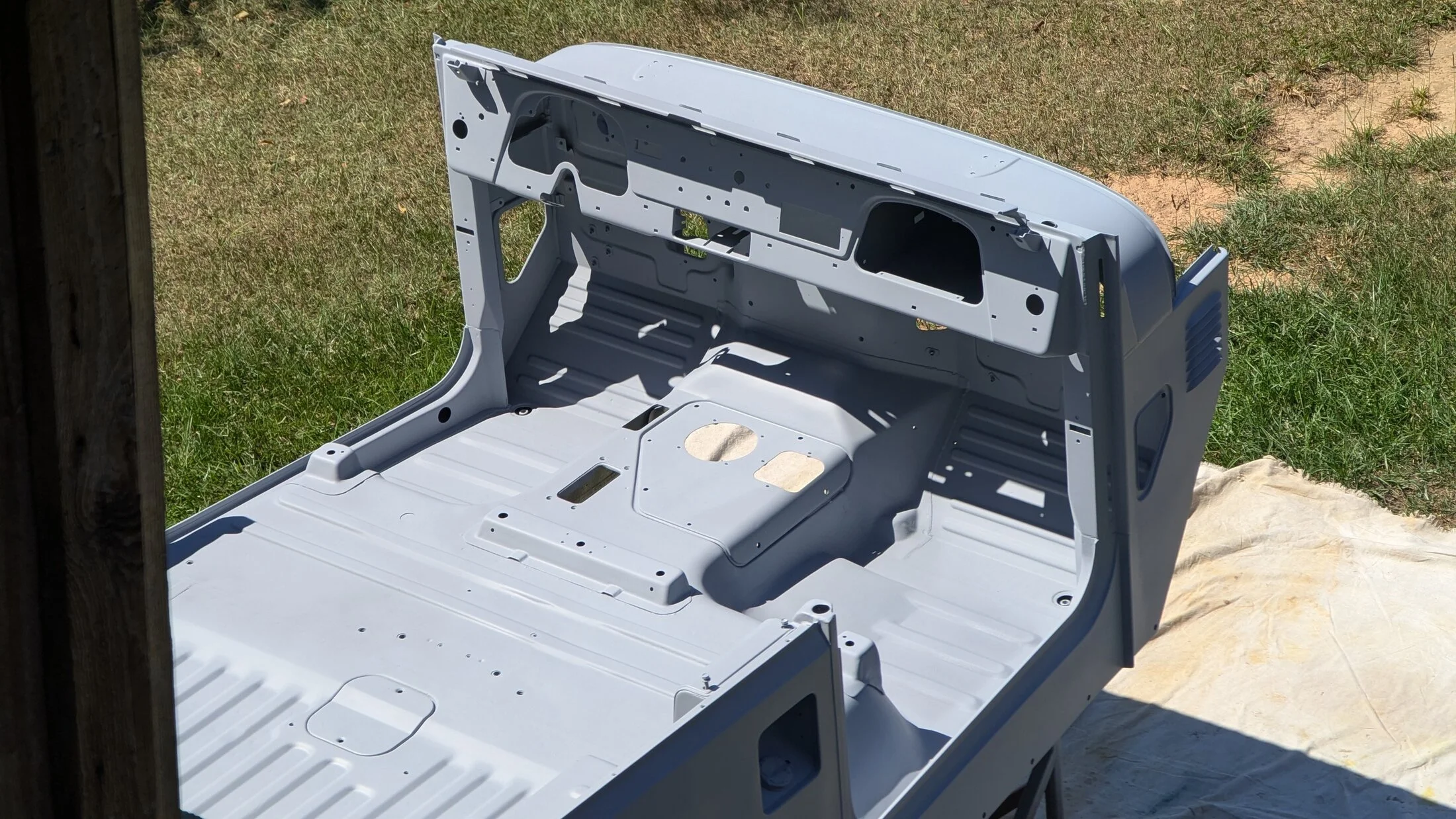

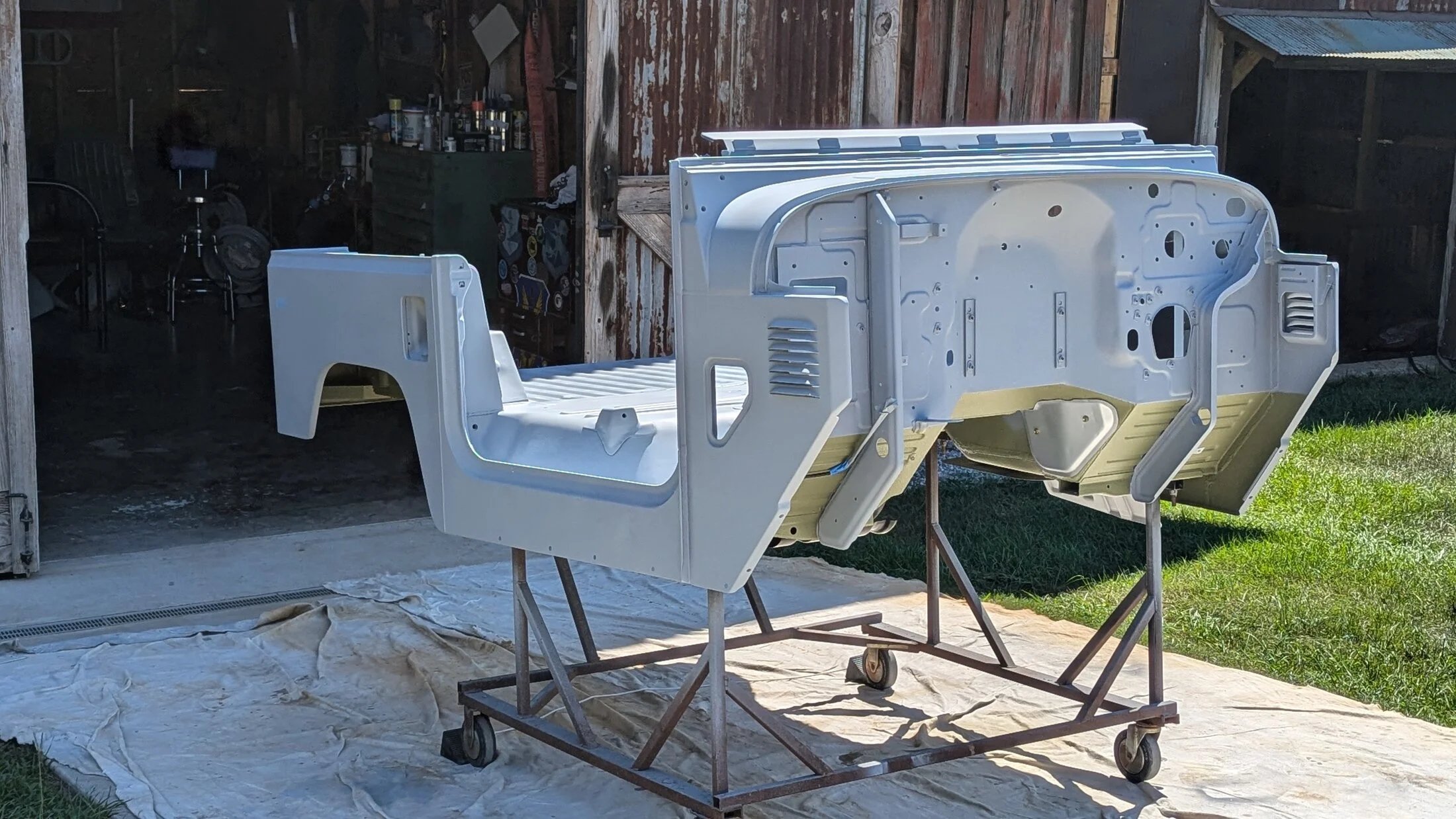

Finally have her primed and ready for final sanding then on to paint. IDK about any of you but seam sealing is a bitch!!! Sealed the qtr panel /door seam with 3m product and it shrunk considerably! Tried again with another 3m type sealer using a small profile shape to hopefully match what was originally on it and anticipated shrinkage......this one didn't shrink at all!! Don't know if I should cut it down and try again or leave it!? You can see them in the pics
Looks good. If the two products are the same type of material makeup. I would just caulk over the old. If not, then I would test a small seam with the new stuff and make sure it adheres really good and then proceed.

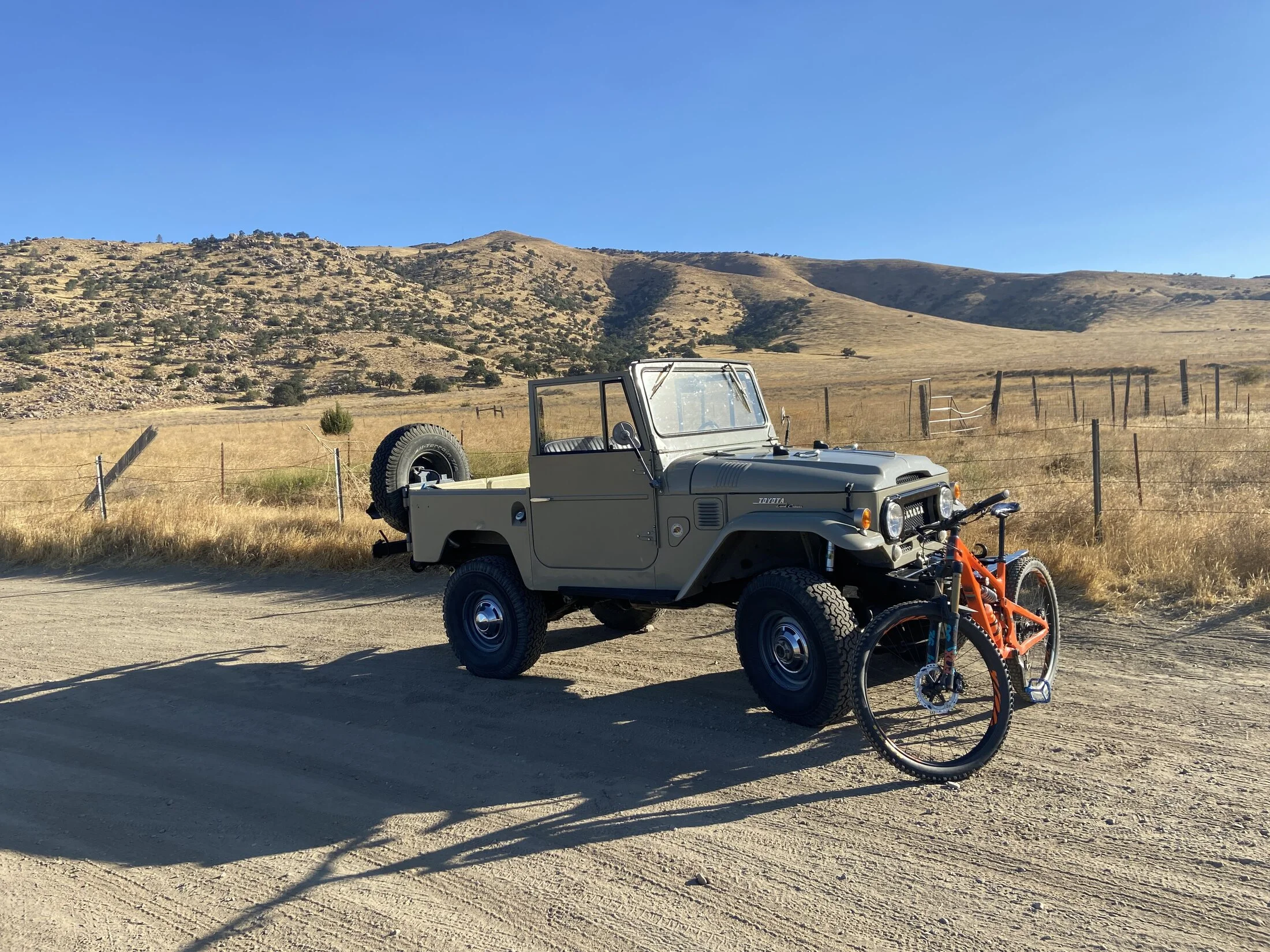

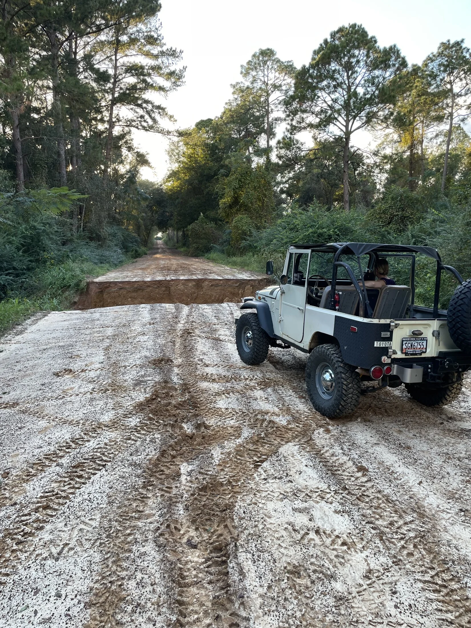

Got in a ride.

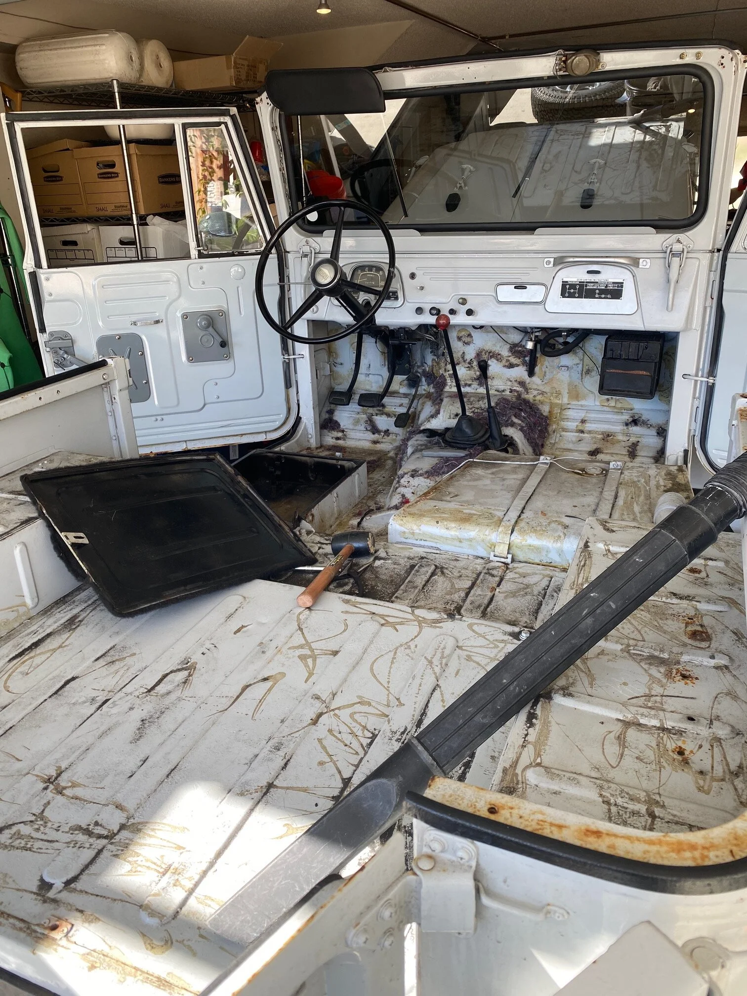

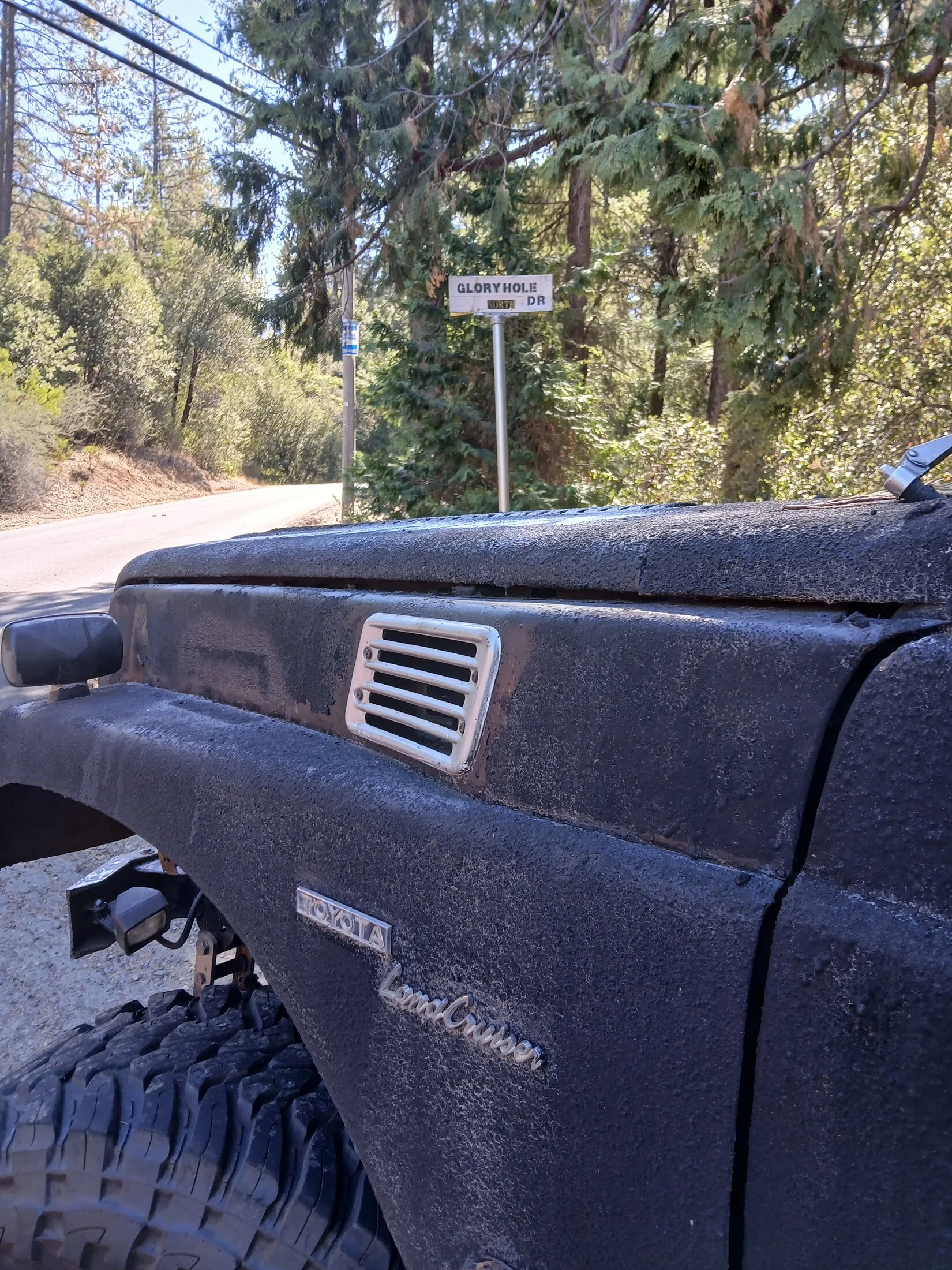

I have been driving her almost daily for the past six months. Just put her in the garage on Sunday, removed the old carpet, seats, roll bar and fuel tank. Getting ready to tackle some rust and spray on Lizardskin followed by a bedliner. I redid the hardtop this summer with LP paint on the outside, Lizardskin on the inside, followed by a new headliner.
