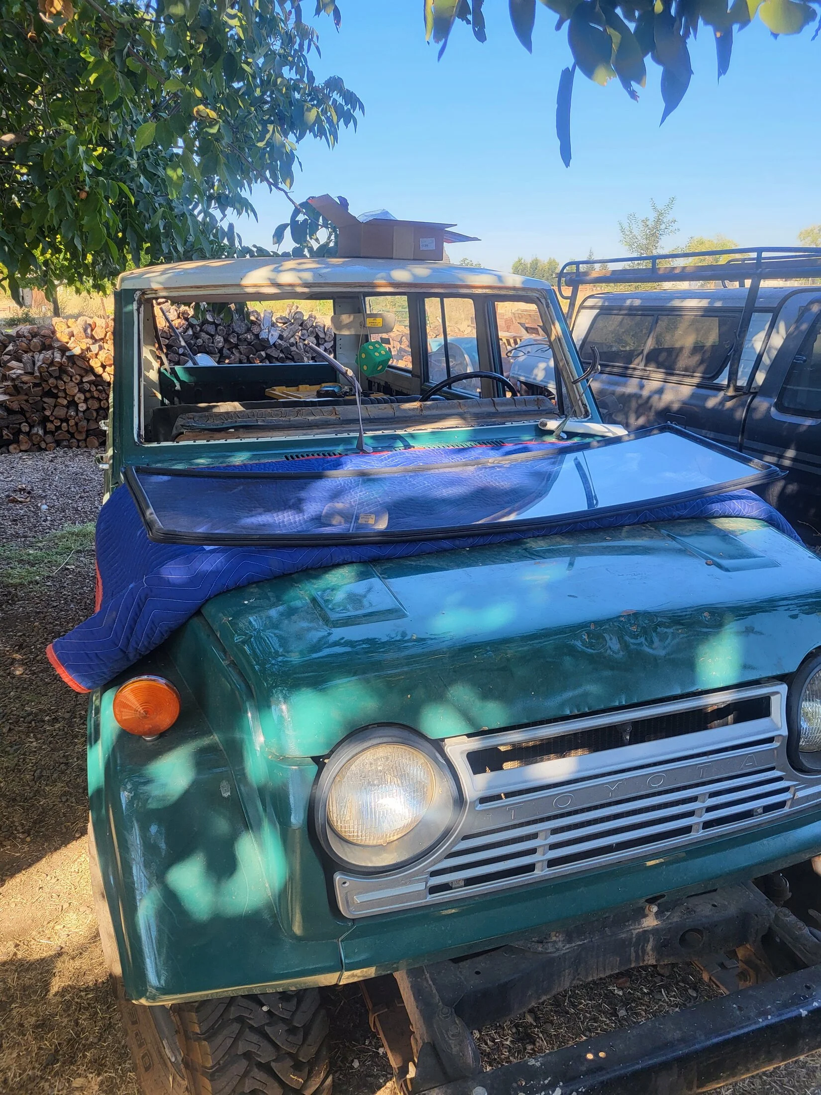

I broke my fj55s windshield a few months back and I need to cut up my parts truck soon, so yesterday I pushed out my broken windshield and got the good used one out of my parts truck to transfer over.
On the 3rd try I noticed a tiny chip starting to Crack and spread. Lame...
Then as it starts to drop in, another small Crack. Damn.
I keep going because there's not a lot of options at this point.
On the last little push I pushed too hard and spider webbed out the whole passenger side, but got it in.
I'm not even that angry.
I tried something new that I was extremely uncomfortable with and almost was successful.
The secondary issue of getting the glass out of the parts truck allowed me to attack it with the Sawzall last night and I got everything from the floor up loaded in my pickup for a scrap run.
Once I'm finished moving, I'll pay a professional to put in a new windshield.
