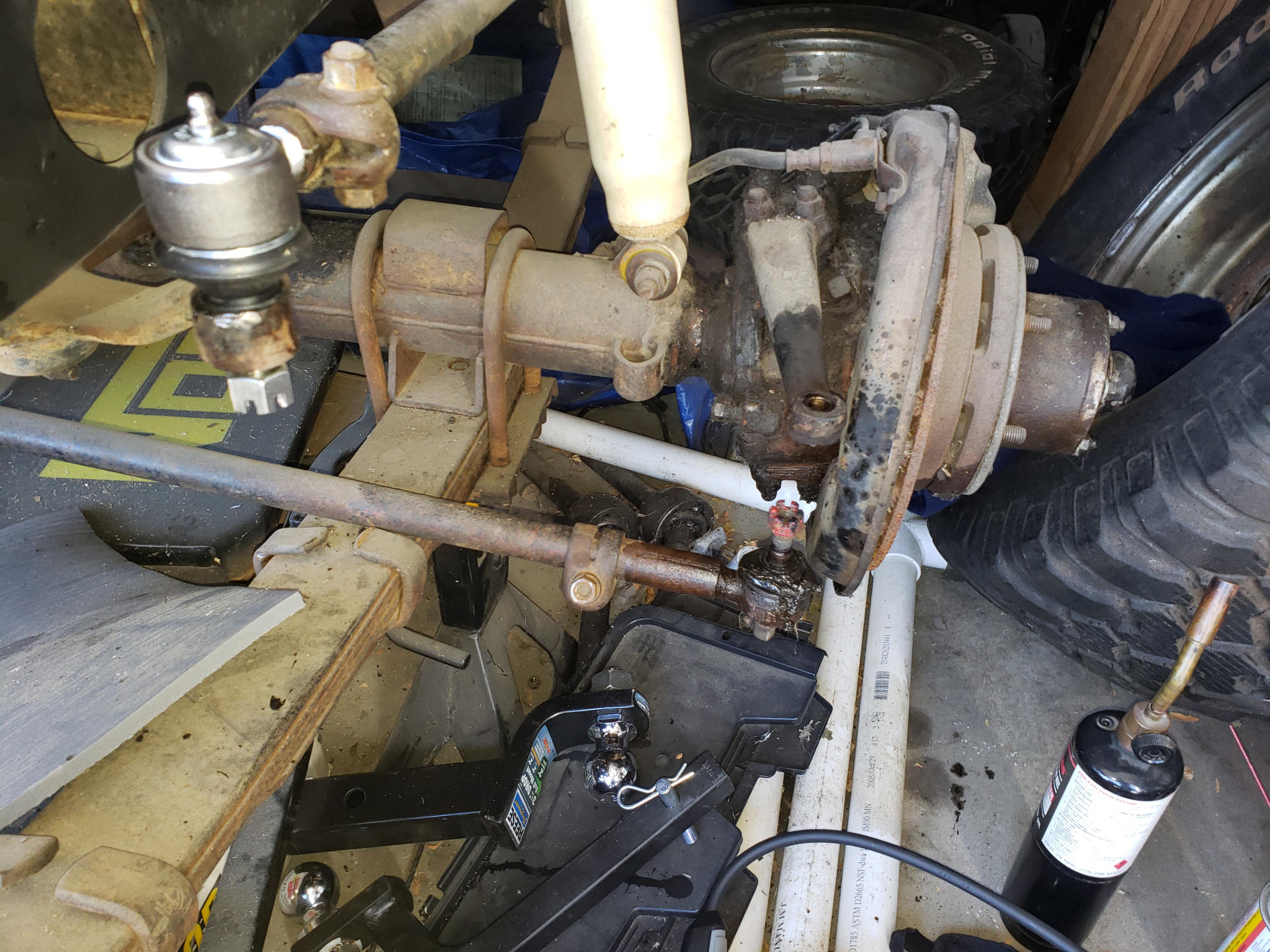

One TRE out and replaced (loosely for now), and a second one out, but it's being a PITA to remove from the rod. I'll let it soak and hit it with fire again. I also cleaned up the threads on a stripped windshield screw hole on the pax side and replaced the screw. Tonite I'm going to try to figure out what I have with the front hubs - 1979 FJ55 axles.
You might want to hit up Kurt at Cruiser Outfitters for some Aisin Freewheeling hubs. I'd put Kroil on for breaking the thread bond.
In 55 years of playing with my cars or trucks, aside from a formula a friend in the navy told me to mix up, I have found nothing better than KROIL for rusted, stuck parts and fittings. Probably 5x the cost but….
