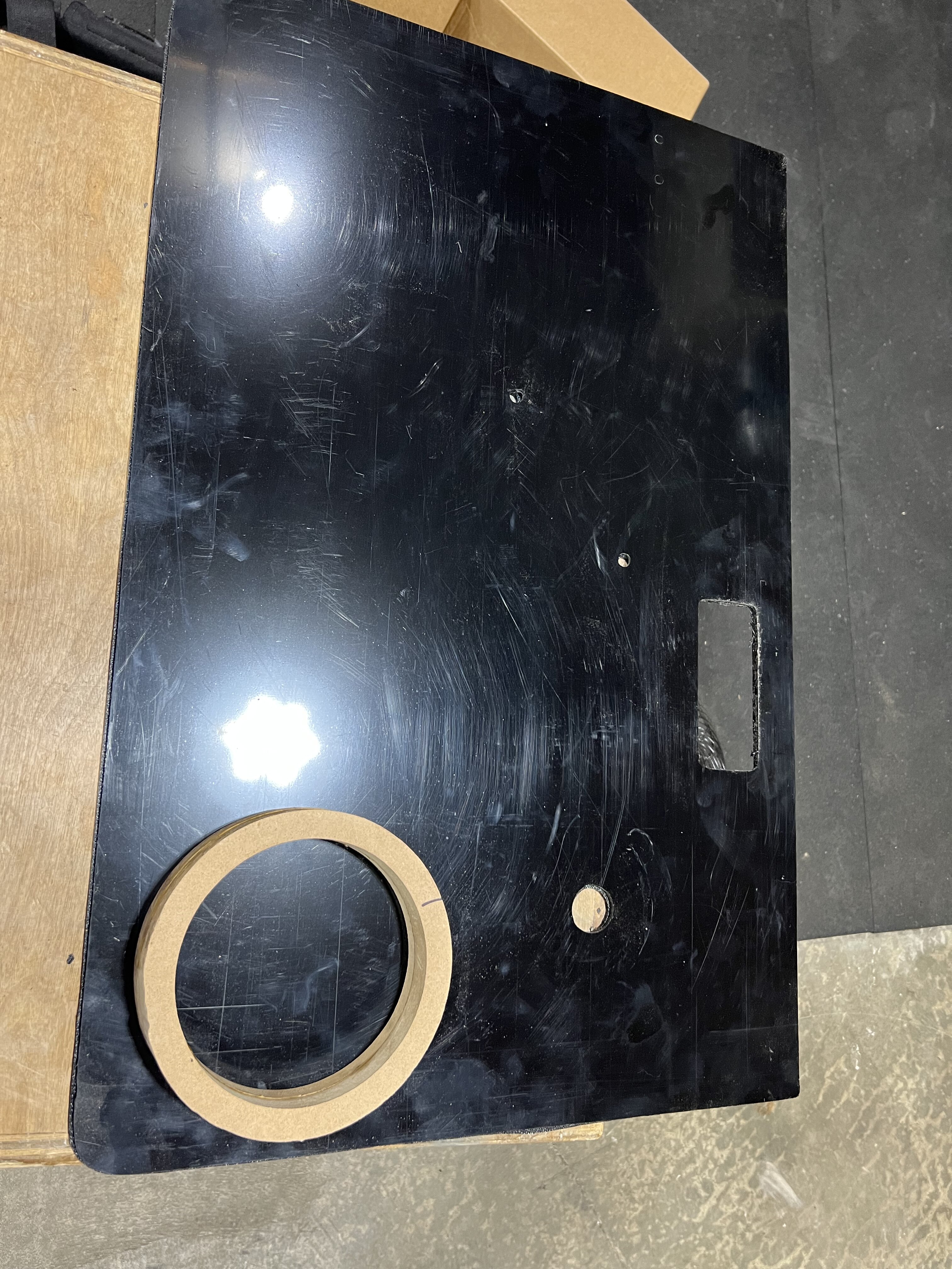

More work on the door cards. Cut out ABS sheets that match my PVC cards from CityRacer. Machined a 3 degree angle on a stack of 6” speaker rings. Spaced them at the bottom of the card and attached with template tape an screwed from the back.
I then routed out the hole.

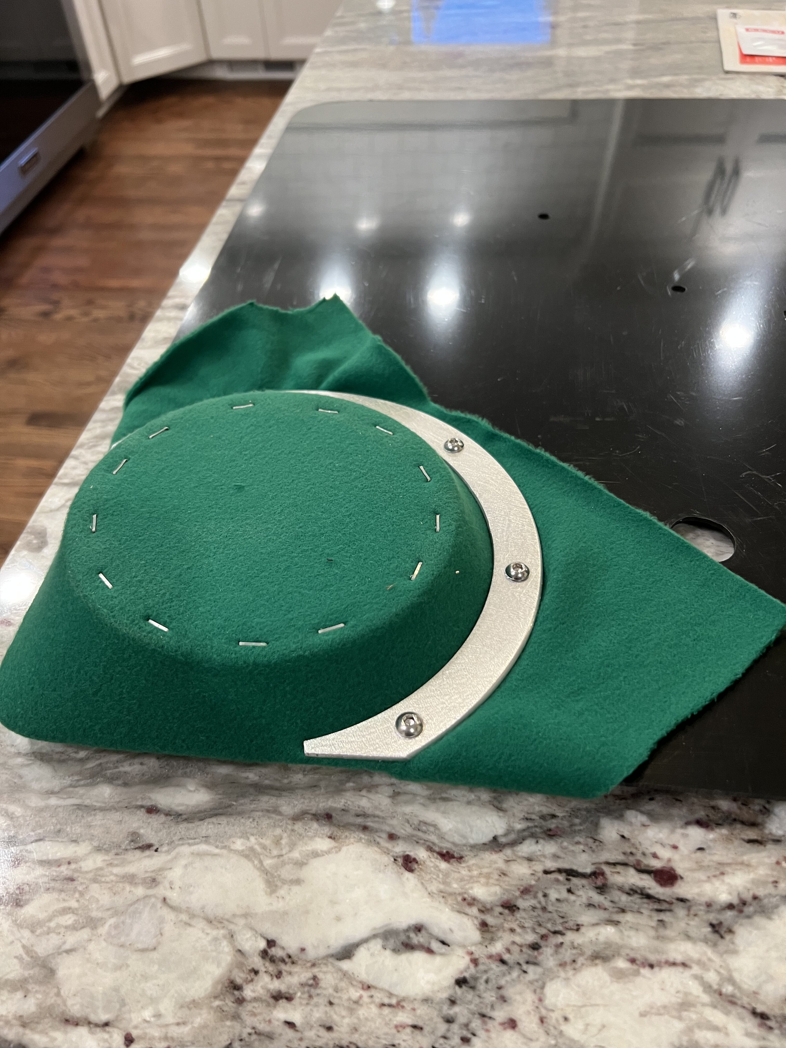

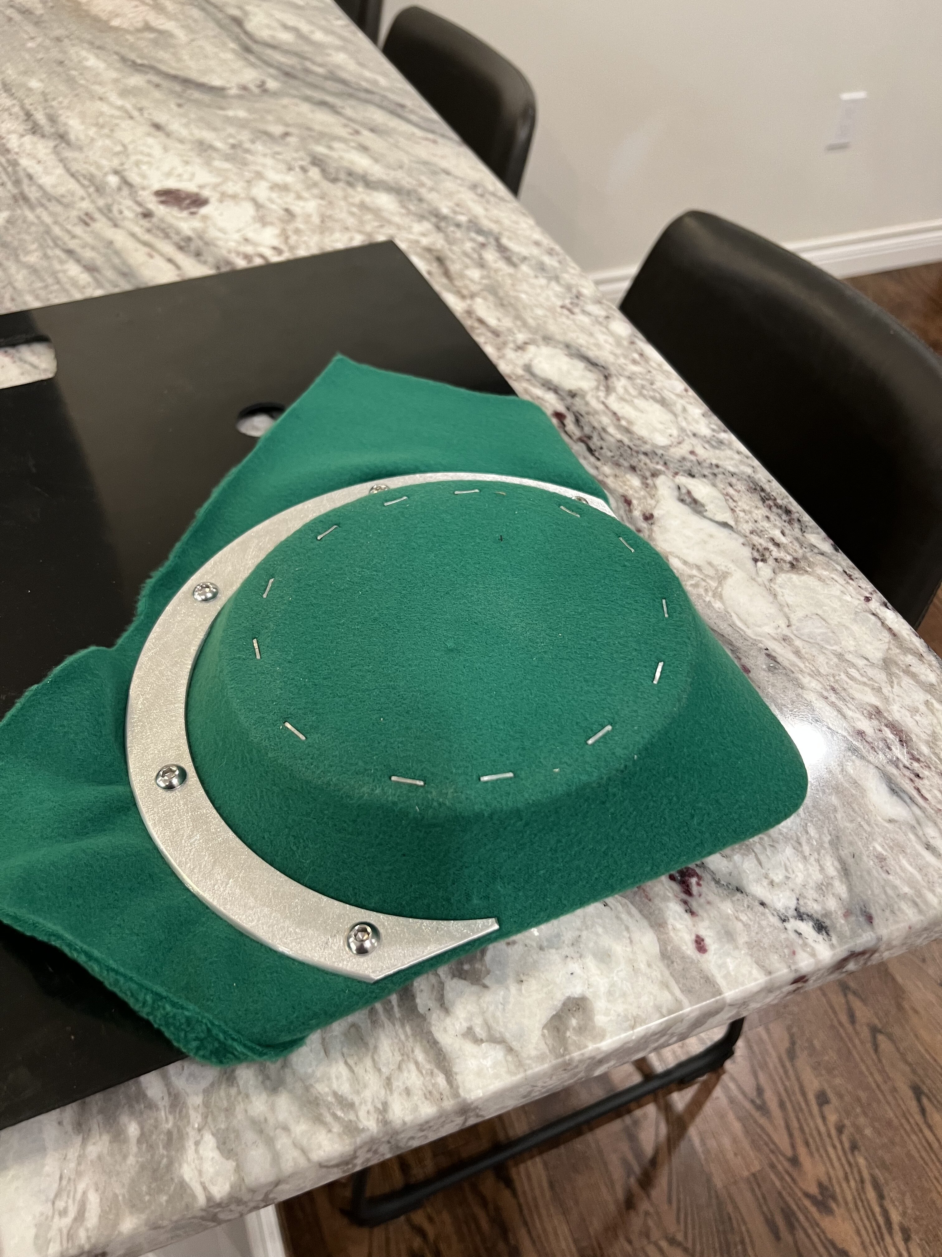

I cut 2 10 inch aluminum rings out of a spare sheet and smoothed it with the drill press. Added threaded rivets to hold 1/4 20 stainless screws in equally spaced holes around the rings.
Lastly, covered with green fleece, stapled to the wood speaker rings and secured with the aluminum rings.
It is now ready for fiberglass. Just have to learn how.
Look up “West Epoxy Systems”. They do have some very user friendly information and it’s not just boats. Their materials are used for all kinds of great projects. They publish a quarterly magazine …free. It is called “Epoxyworks”
good luck
You can find good info on working with fiberglass in the restoration section on iboats. Be sure you have good ppe, breathing fiberglass dust is bad.
