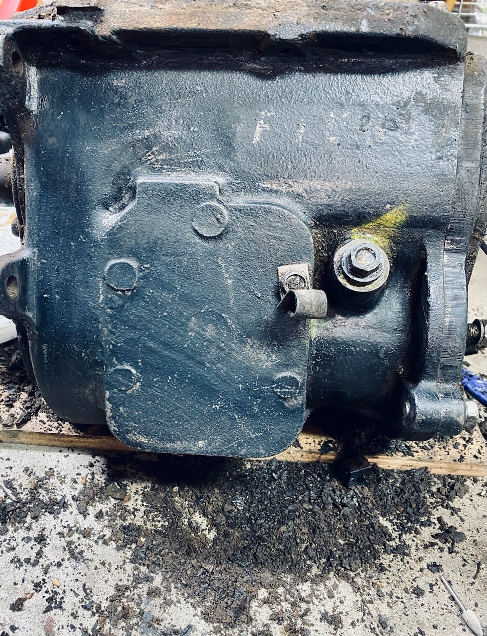

Time to get cracking on refurbishing this 4 speed for my 4 on the tree conversion. Impressed with how fossilized this old gear oil and dirt is.

Is there a build thread for this? I was planning to go floor shift with a 4 speed swap, but now that this exists I am really considering it
For me personally it will be logged in my 40's build thread: Builds - Clifford is home again- a 1965 FJ40 FST - https://forum.ih8mud.com/threads/clifford-is-home-again-a-1965-fj40-fst.1094984/
There is info on this particular type of swap in this thread: tranny tech 403-thats 4 on the tree! - https://forum.ih8mud.com/threads/tranny-tech-403-thats-4-on-the-tree.134392/page-7#post-14550328
It follows the general 4 speed swap instructions that have been laid out by many mud members over time. Then deviates when it comes to the shifter setup and requires a modification of the transmission hump... or swapping in a fiberglass hump if I can get that to fruition.
