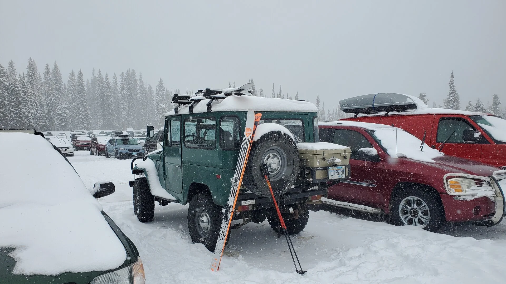

Took it out to play in the snow.

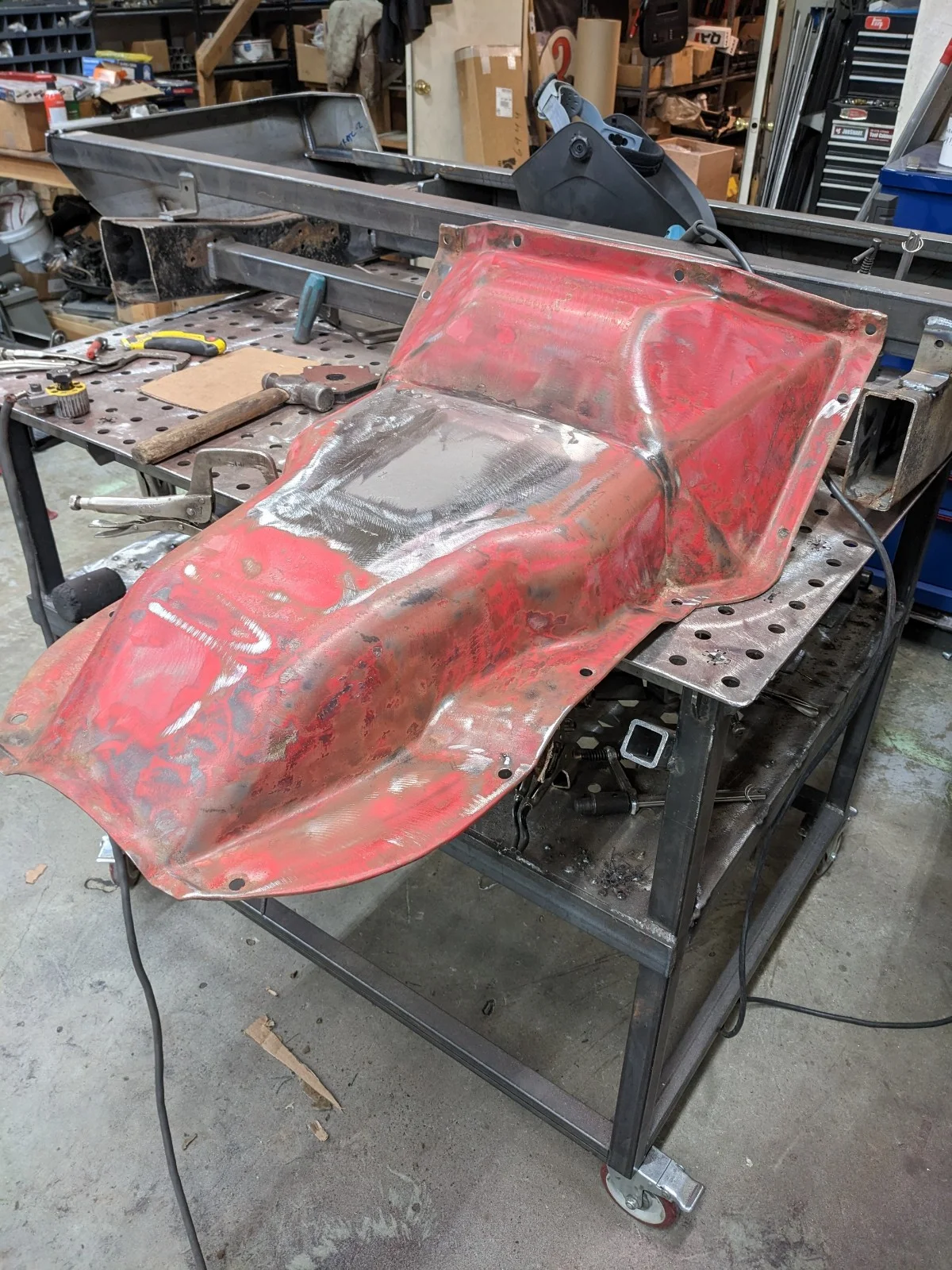

Welded up the trans cover. (will cut proper holes once tub is reinstalled)
Sprayed 2 coats of epoxy primer and 3 coats of SW Genesis 309 freeborn red down this morning.
Ready to set tub next week and get to the bodywork on the outer tub, hood, fenders and all doors.

good thing you brought the ice chest. Wouldn't want the drinks getting warm
The cooler carrier barely holds all the beer and ice! ;)
