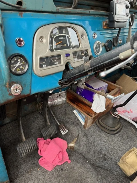

Two guesses
-You adjusted the brake and clutch brackets so you have more leg room
-you put a second cushion in the column surround to raise the steering wheel up slightly more.
Two guesses
You are the winner! You can’t see the actual mod in the pic, but you can see evidence of it.
I went from 3 on the tree to 4 on the floor two years before I did the Saginaw conversion. Seeing as I no longer needed the extra space above the column for the shifter stalk, I cut the upper column saddle and added metal to it, moving it closer to the instrument cluster. I got lazy about modifying the lower saddle and just shoved an extra 1/4” of rubber down there.
Extra 1/2” of room between the steering wheel and my lap. The Saginaw U-joint doesn’t care.
Brian Parsons, right? You should be in the computer. I’ll get the shipping quote and call you tomorrow.😉
AWESOME!!! Haha super pumped and thanks for the challenge!

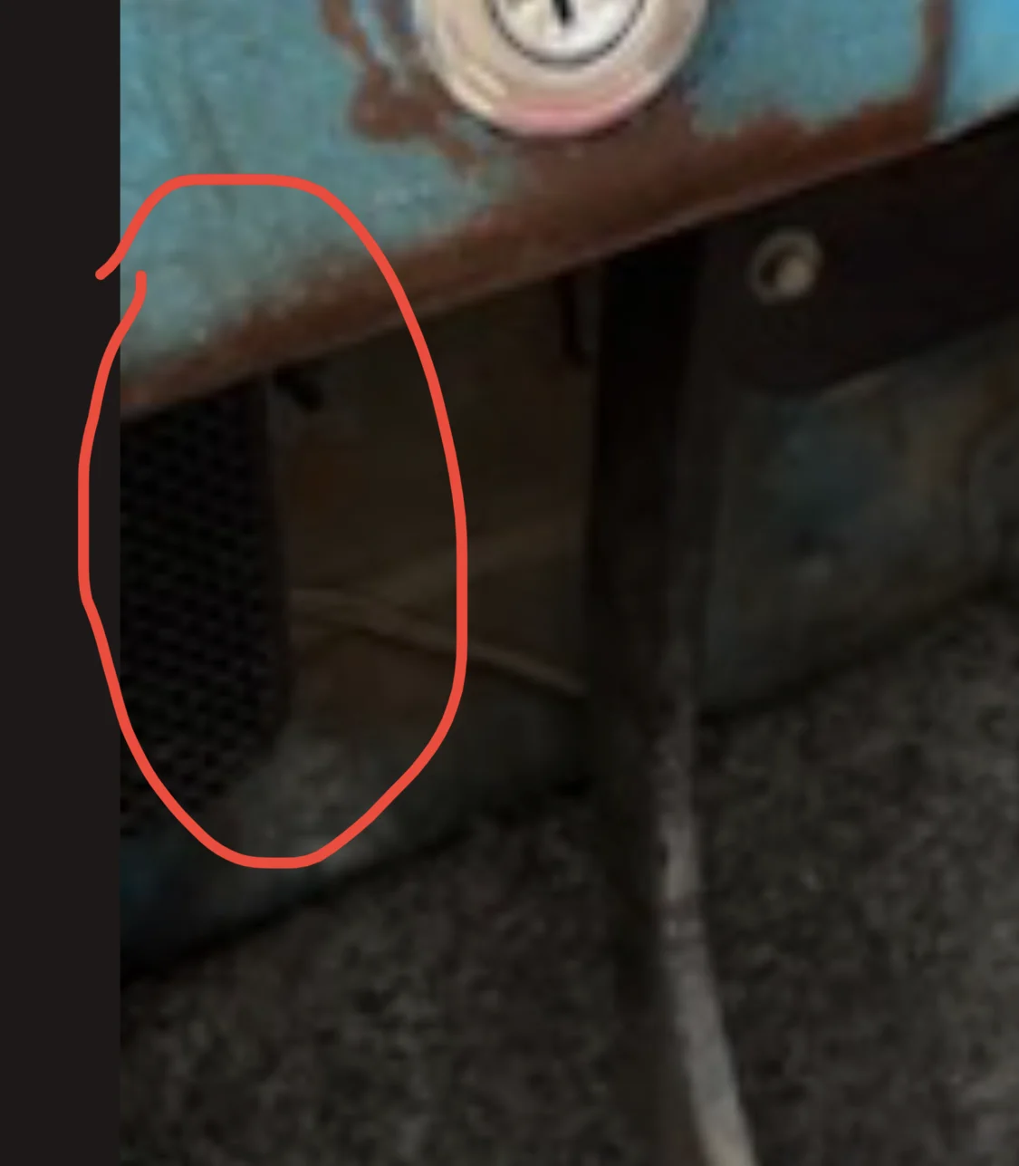

Dang! Late to the party but when I saw Mark's pic my first thought was why is the colum mounted like that? Then thought, bet it gives tall Mark a little more lap room...

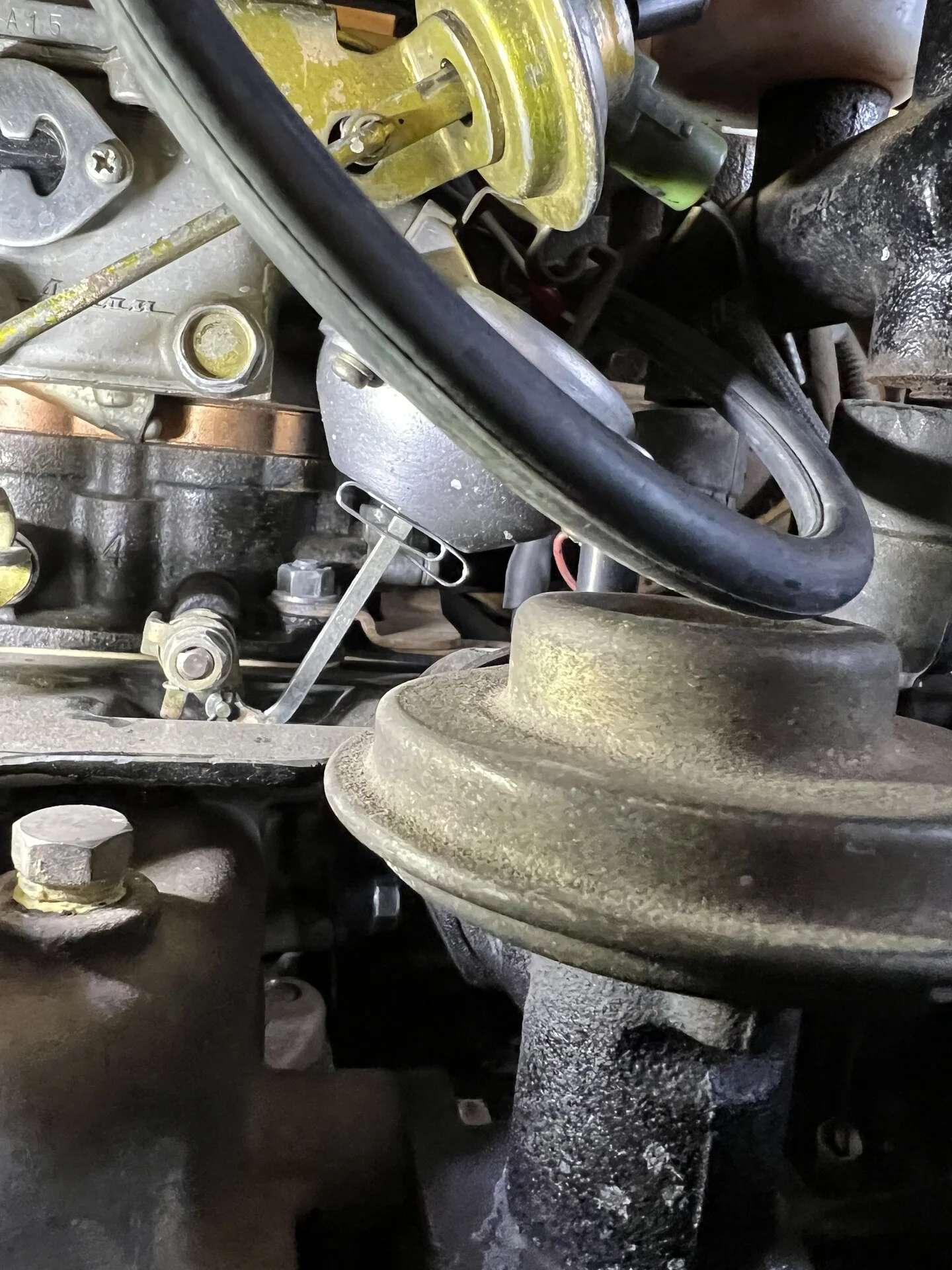

Quick update from my earlier post this week - I did the paper clip test Mark (@65swb45) suggested. I honor of his previous game in this thread - minus a prize, put the pictures in order... is the first picture displayed the pre drive, or is the second picture pre drive? (Drive was up a long hill in 4 gear - actually drove for about 20 minutes between pictures).
Got home and have whining noise now in the engine bay - think something isn't right with alternator along with the noise(that I can tell). Noise went away after sitting there in the driveway for 3 minutes while I was trying to location source. Maybe the fan. Was dark out and cold - that didn't help.

Looks like your replacing the diagram :)
You guys with your vac secondary… pictures don’t matter much when they are essentially the same lol
Btw noise could just be belt slip… it’s cold … they get hard and slip more if your adjustment is marginal
Or… could just be a bad belt
