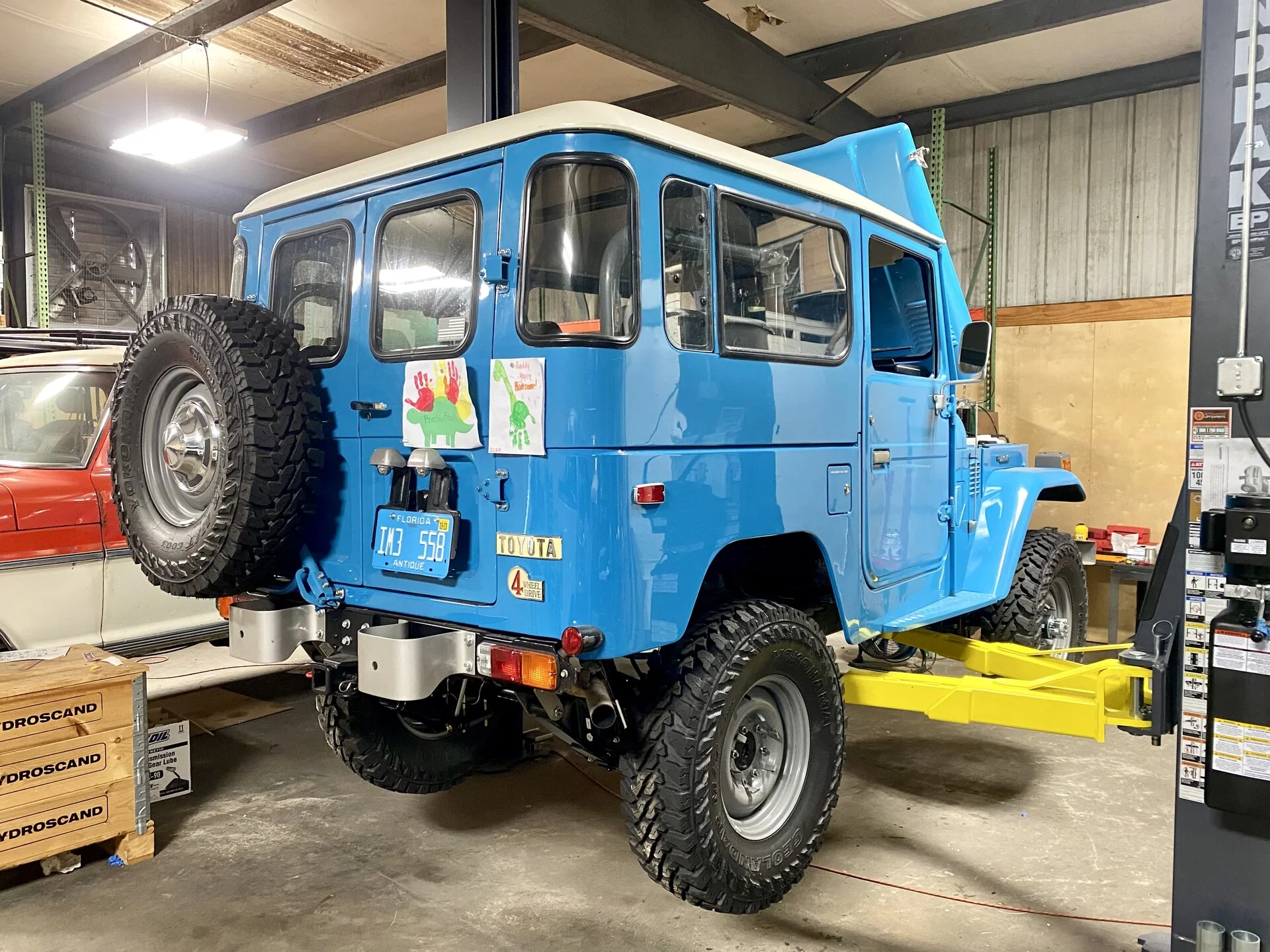

Back on the road after 9 months!

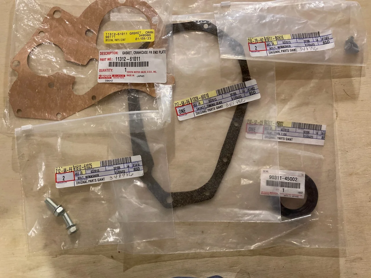

Discovered the two lower bolts on the timing gear cover are the source of small leak. (ordered parts to fix).
Then, Installed new Energy Suspension body mounts (two 2x4’s with blocks and jack..,don’t forget to unbolt the tub from the front fenders). My truck never had the mount that gets bolted down through rear floor…Need to deploy some precision measurement to blind drill to hopefully hit the bullseye in the frame mount hole to install my last two mount.
What parts did you order to fix the small leak at the bottom of the timing gear cover? I have the same problem.
If it’s just leaking past the bolts some FIPG will cure that.
