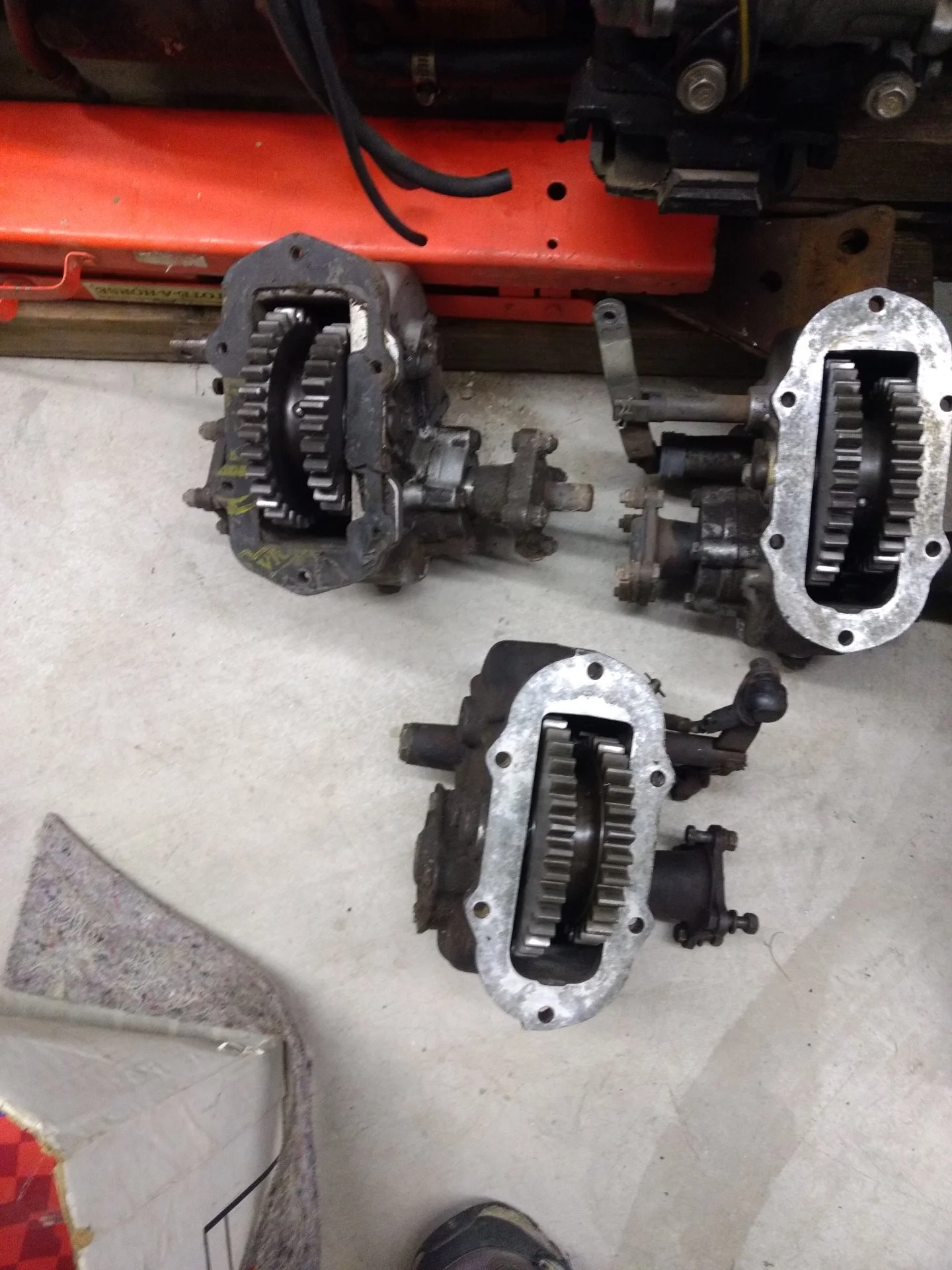

Rear output shaft for the PTO.
These are the three different PTOs mid 1963 on used for the front winch and have a rear output for other options never offered in the US
Before some else does I should correct myself. 10/82 the lever to engage the the PTO moved to the front. This was because of the H55F option that moved the transfer case close to the torque tube. The output shaft no longer supported the rear output which would assume had to do with clearance to the torque. This is the lower one in the picture was pulled from a wrecked 84 HJ47RV with a four speed. 11/84 when the 70 series started the PTO changed to a single direction. 60 series changed at that time but remaining 40 series built after that date still used had the two direction. I was in the process of converting a single direction to a two direction when Trade for a early one piece transfer case PTO and drive shaft for one from a 8/80-9/82 PTO and 40 series driveshaft.
