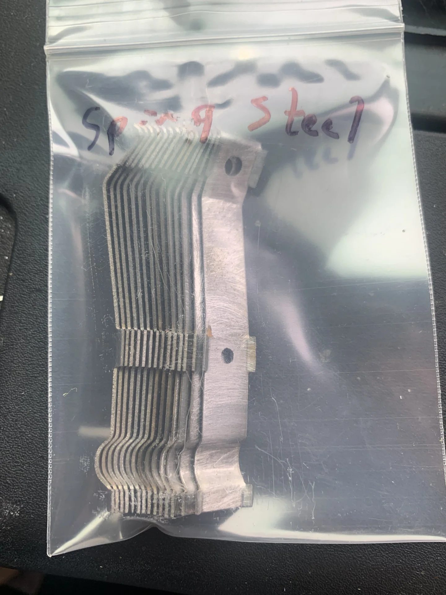

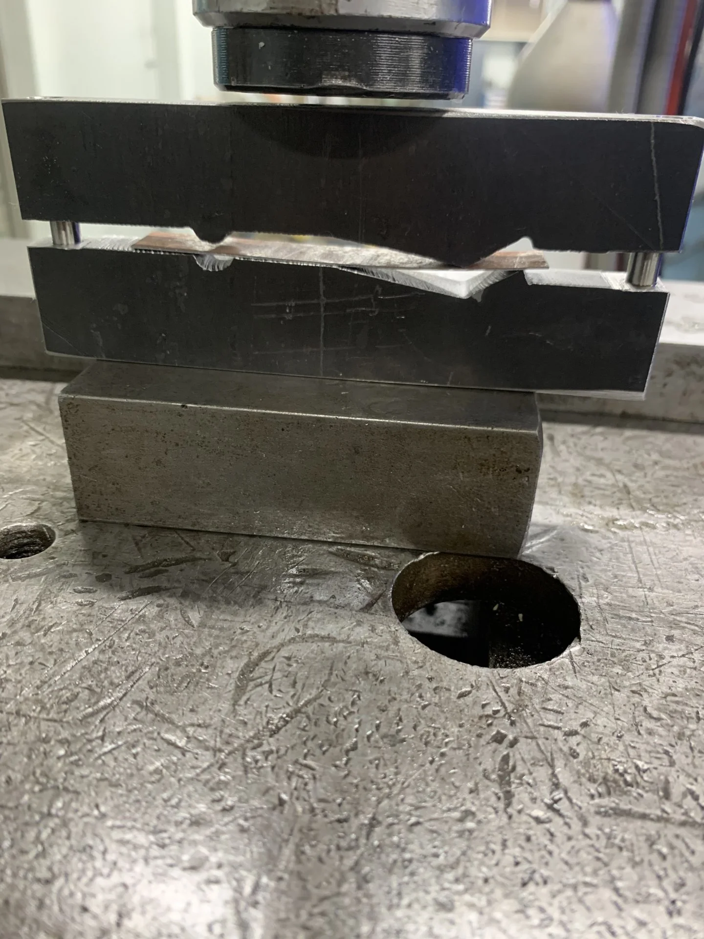

borrowed a part measured it. made a die. MADE IT BEEEEEP!

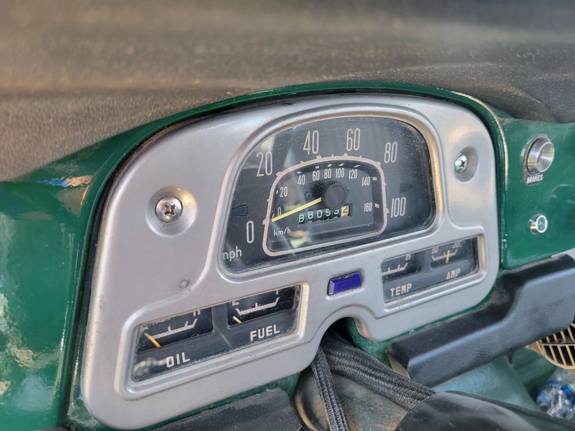

The great thing about an alternator (as opposed to a generator) is that it will only put out the actual amps needed or drawn by the stuff in the system, up to the rated amperage. The one thing that would be smoked in a 40 is the ammeter, assuming that any secondary wiring you added for a winch and etc. is up to the task. I have been running a 200-amp alternator for 11 years now, and it is great for my purposes. I did replace the ammeter in my instrument cluster with a voltmeter, and upgraded my battery, starter, alternator, and ground cables to much heavier gauge than stock.
All very good upgrade measures. I will note, however, current is dependent on the load and not what the source can supply. So, your first sentence is true of all electrical sources.

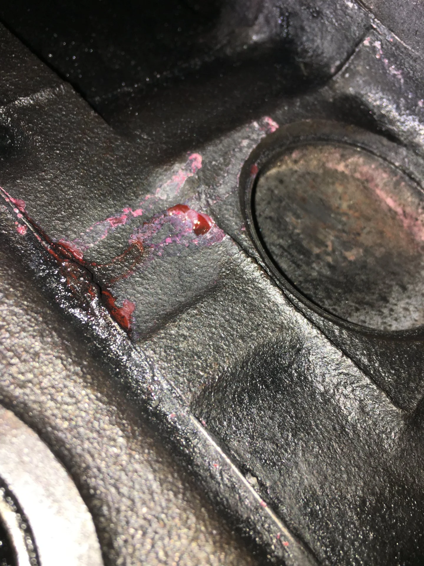

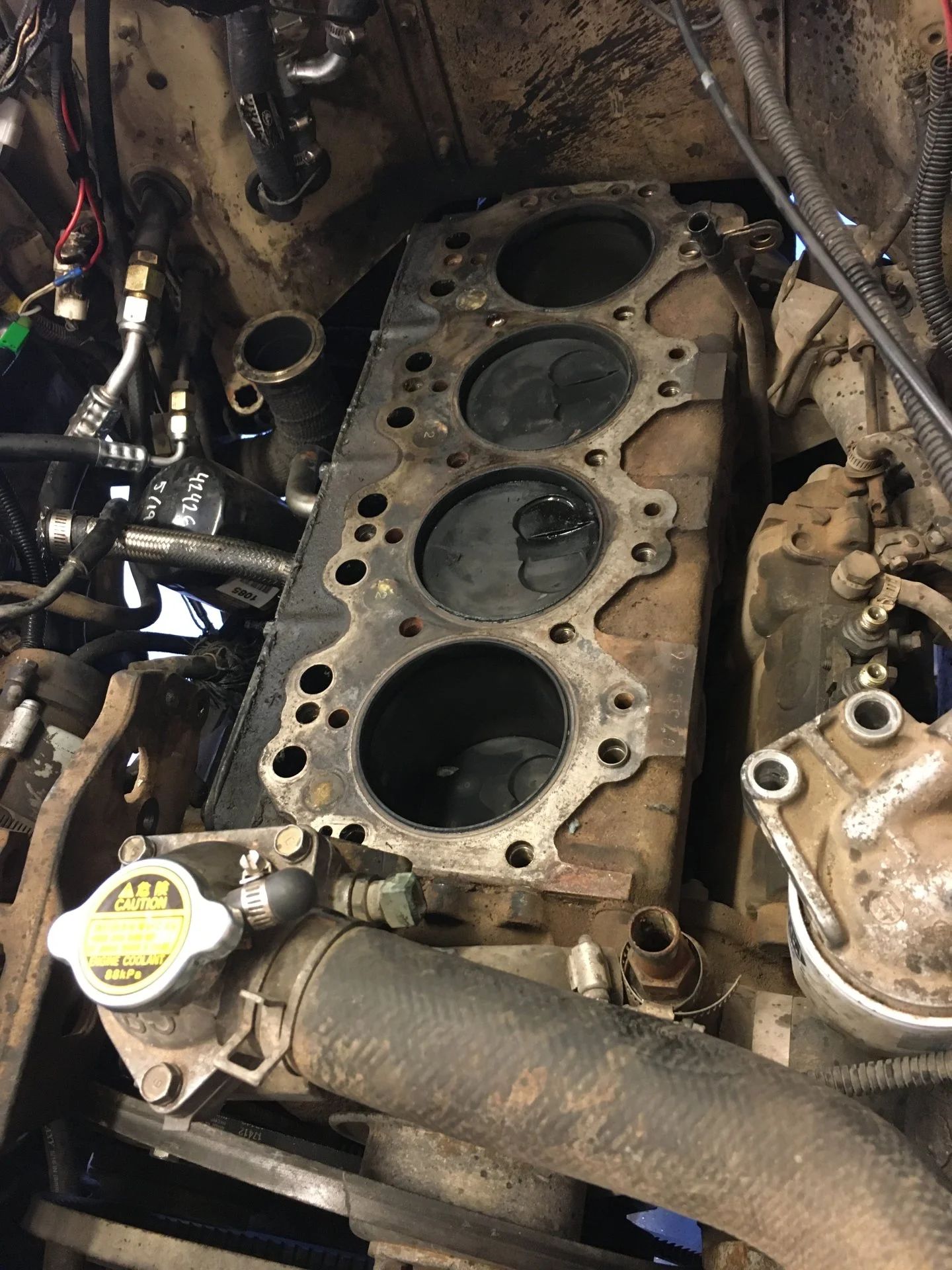

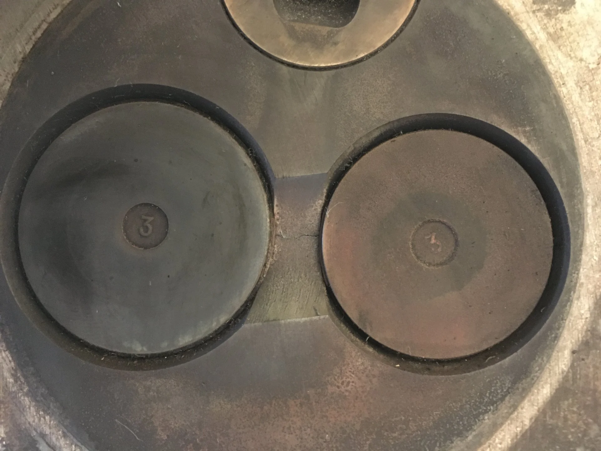

Noticed a read stain on the back of the block ... coolant seeping out the back of the head :oops:. Pulled everything apart today and the old fiber head gasket is torn at the back. Of course the precups are all cracked and the head has classic 3B cracks between the valves at every cylinder too
Funny thing is I just got back from 500+ miles of driving to Colorado and back and the truck did great up the mountain passes, and never even tried to get hot. The 3B is tough.
Thinking I will just throw new precups in it and an MLS gasket and see how it does

Is that a crack between the intake and exhaust valve or just the casting?

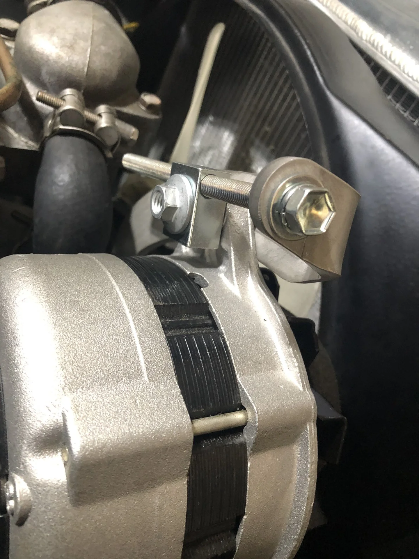

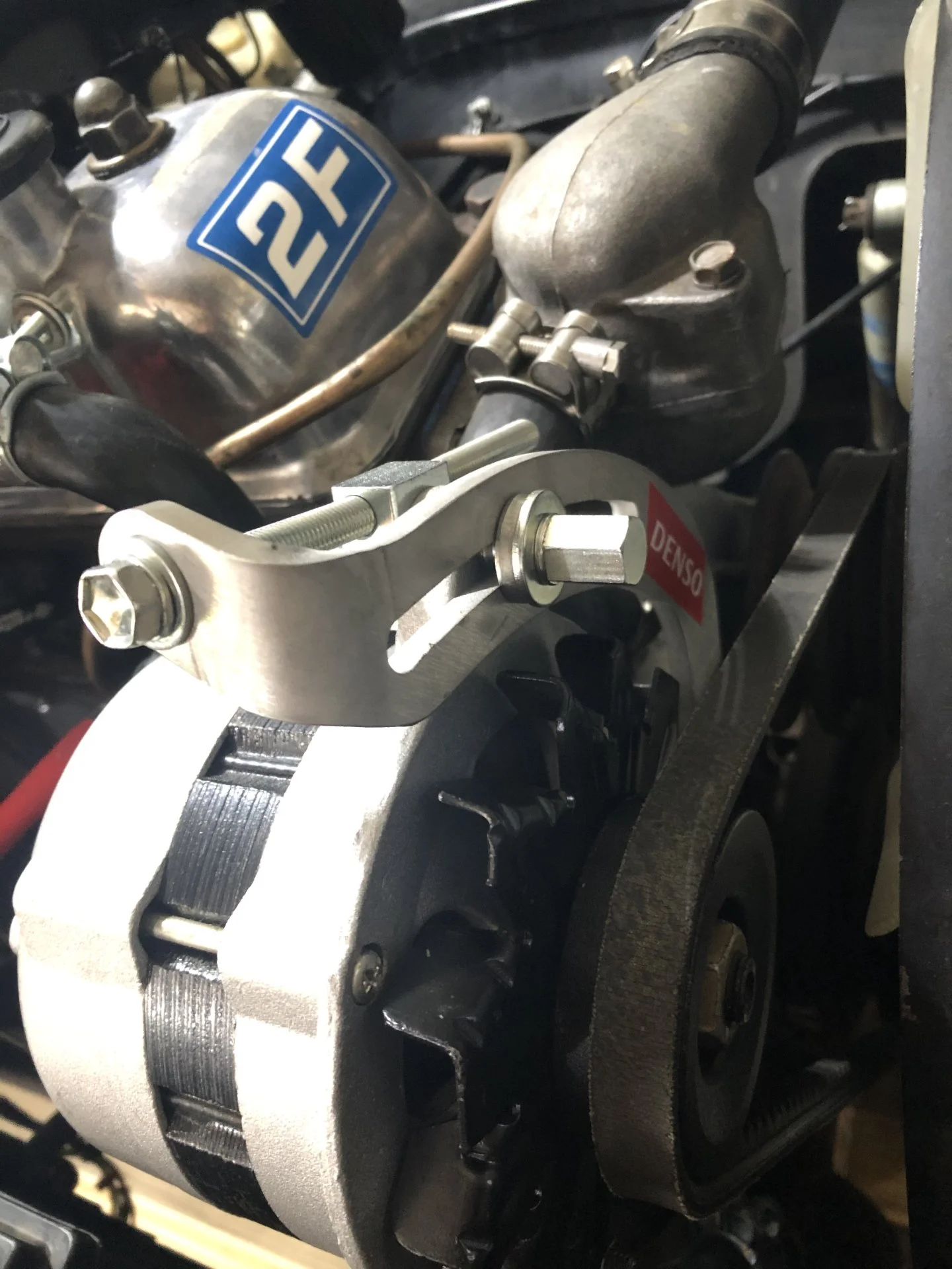

Added a sliding alternator tension kit from Vintage TEQ.
