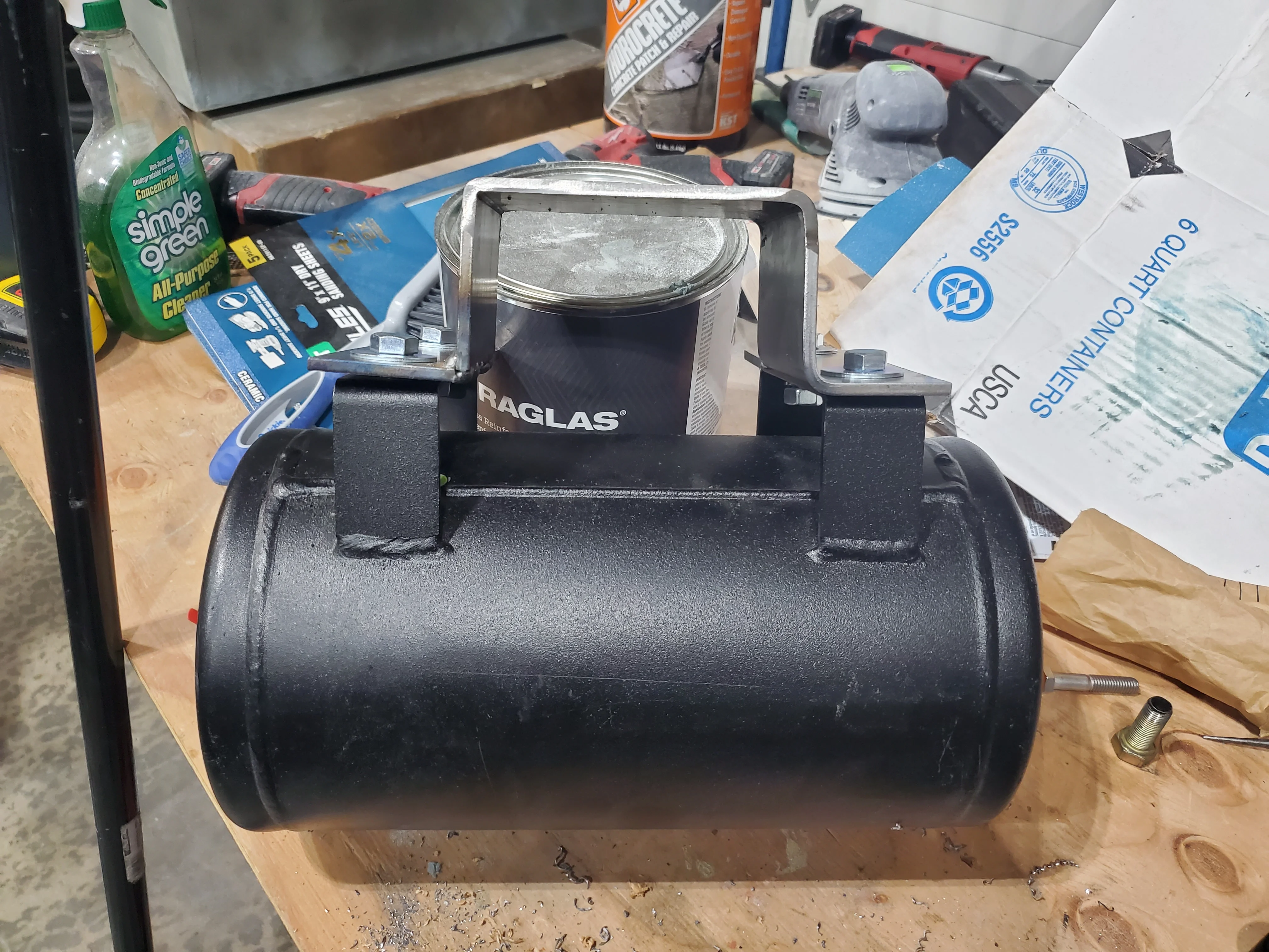

Over built a bracket to mount my 2 gallon air tank. I didnt think I'd have clearance to z bend this bracket on my press so I scored it and tried to use the vice. Got it to fit in the press, but broke off one ear. Welded it back on.
I'm planning on routing via a Wits End manifold to an air chuck up front and one in the rear using DOT air brake line. Since the ID is smaller, I think I also leave a close air chuck with a fat line for air tools and reseating beads.
