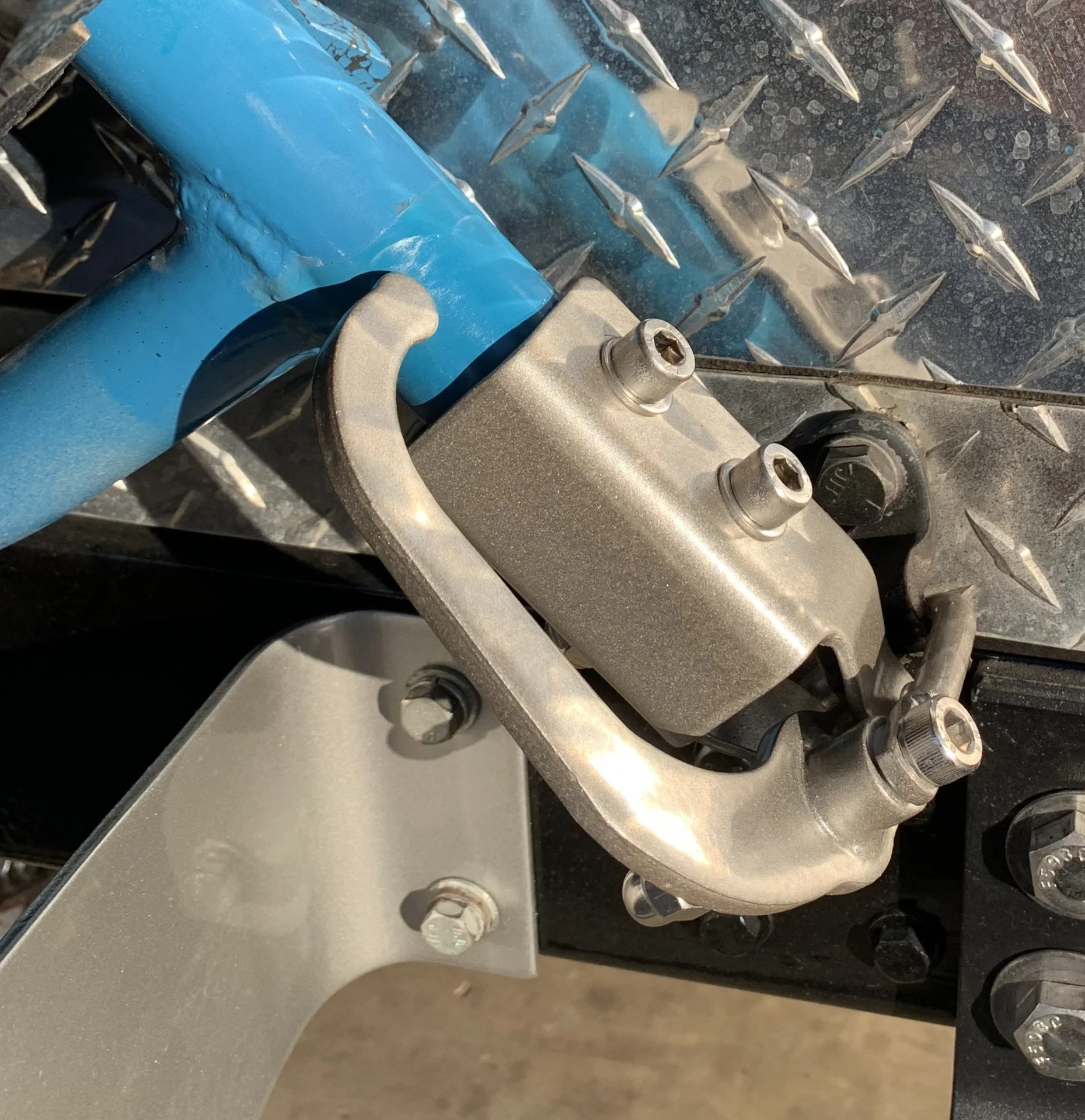

Thanks for the follow up. Finished the install yesterday.
  • Ended up punching out the factory pins. One side of the pin holes is smaller - I threaded each of the smaller holes for M8 bolts.
  • Powder coated the assembly with Prismatic powders Vegas Gold
  • Modified a nylon spacer to replace the metal spacers that had worn down over the years on the hook portion of the assembly (lower bolt)
  • Used a stainless M8 x 60mm socket head bolt on the upper hole, secured with a stop nut and added an acorn nut. This allowed a gap between the two nuts so I could include a spring from the handle to the carrier (like OEM).
  • Used an M8 stainless screw on the hook hole to allow for handle movement
  • Used two M8 x 50mm bolts and stop nuts to attach to the carrier
  • After all this I showed it to my wife for her amazement. I was the only one who was impressed, though :-)
I'm impressed man... so now there are two of us.

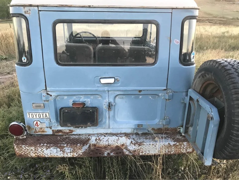

Before

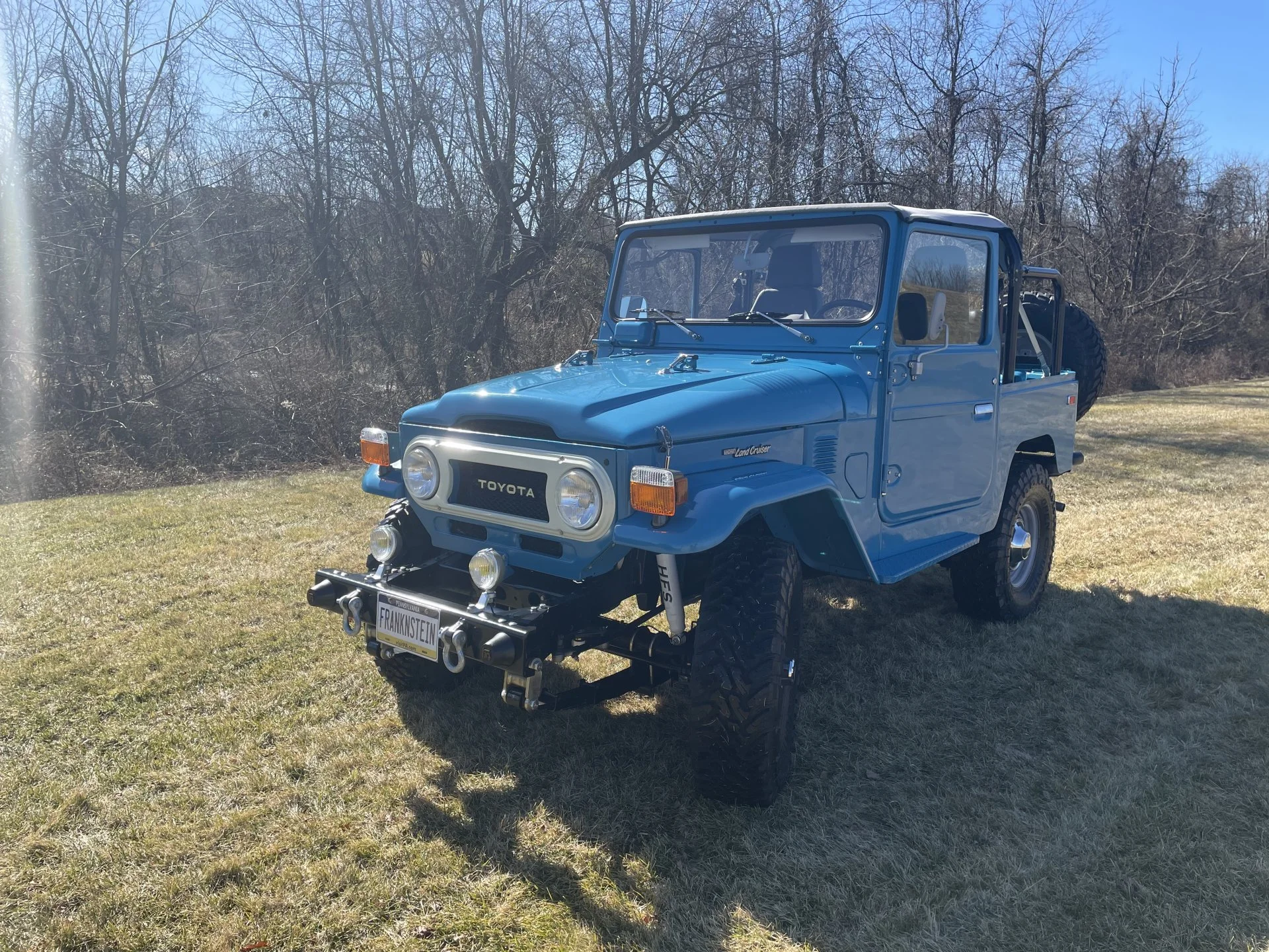

After

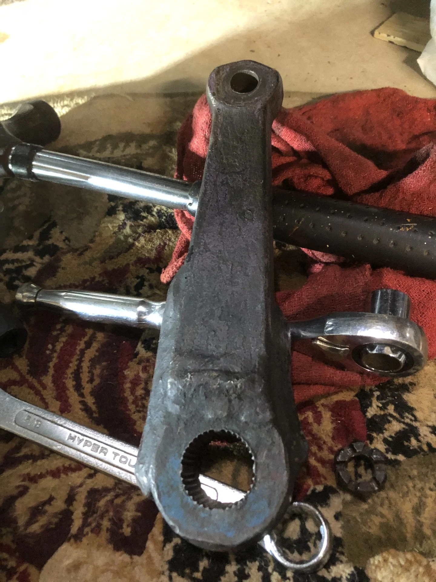

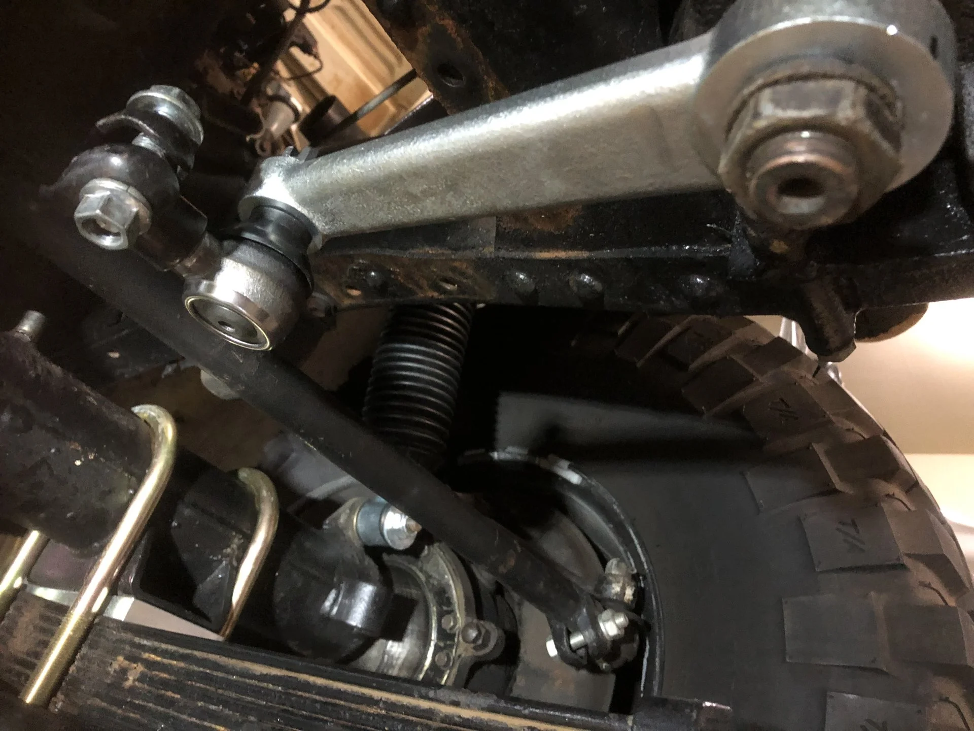

Short of just scrapping the whole present manual steering setup (definitely non Toyota!) I’ve chased down various parts to make said setup a little safer maybe…… plus, it actually handles fairly well! Other things on my present to do list so power steering is on a cold back burner for a while longer!

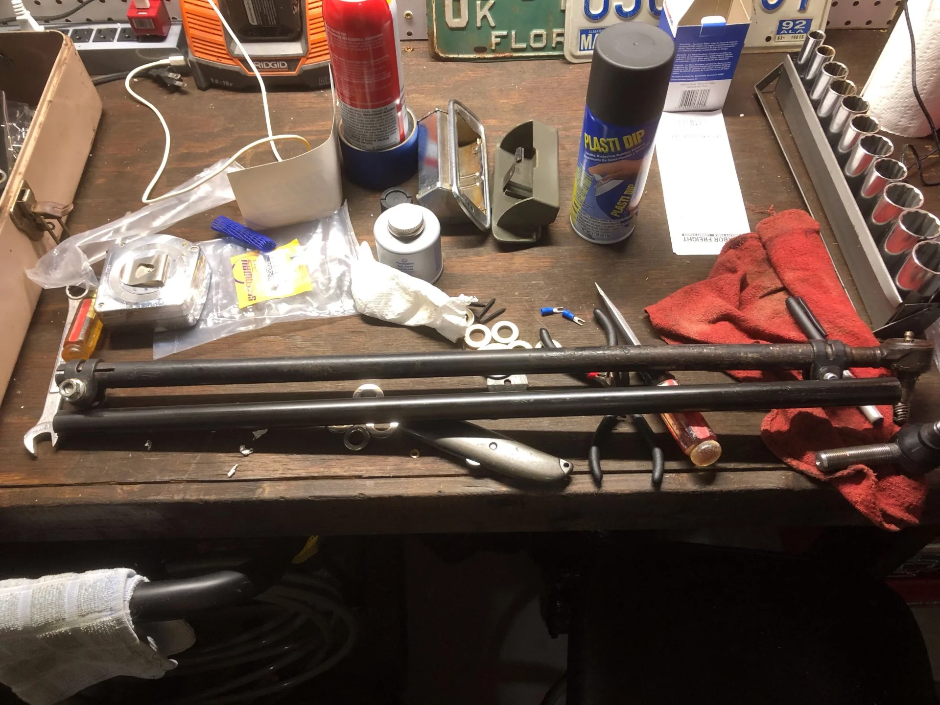

Top is a ‘slightly’ bent relay rod… below is a new and slightly longer (and straight) rod courtesy of @cruiseroutfit with the 17mm LHT and 11/16 RHT ends…
Found a TRE with appropriate threads to fit into new pitman arm (which was NEEDED imho)
I imagine a PO in the past knocking back a few and looking to make his new steering creation with an ancient Saginaw 525 box work ……. “Here Vern, hold my beer, I’m gonna weld sumthin!”
Finally found a universal arm with correct splines and shaft diameter……. At least it looks better? Safer?

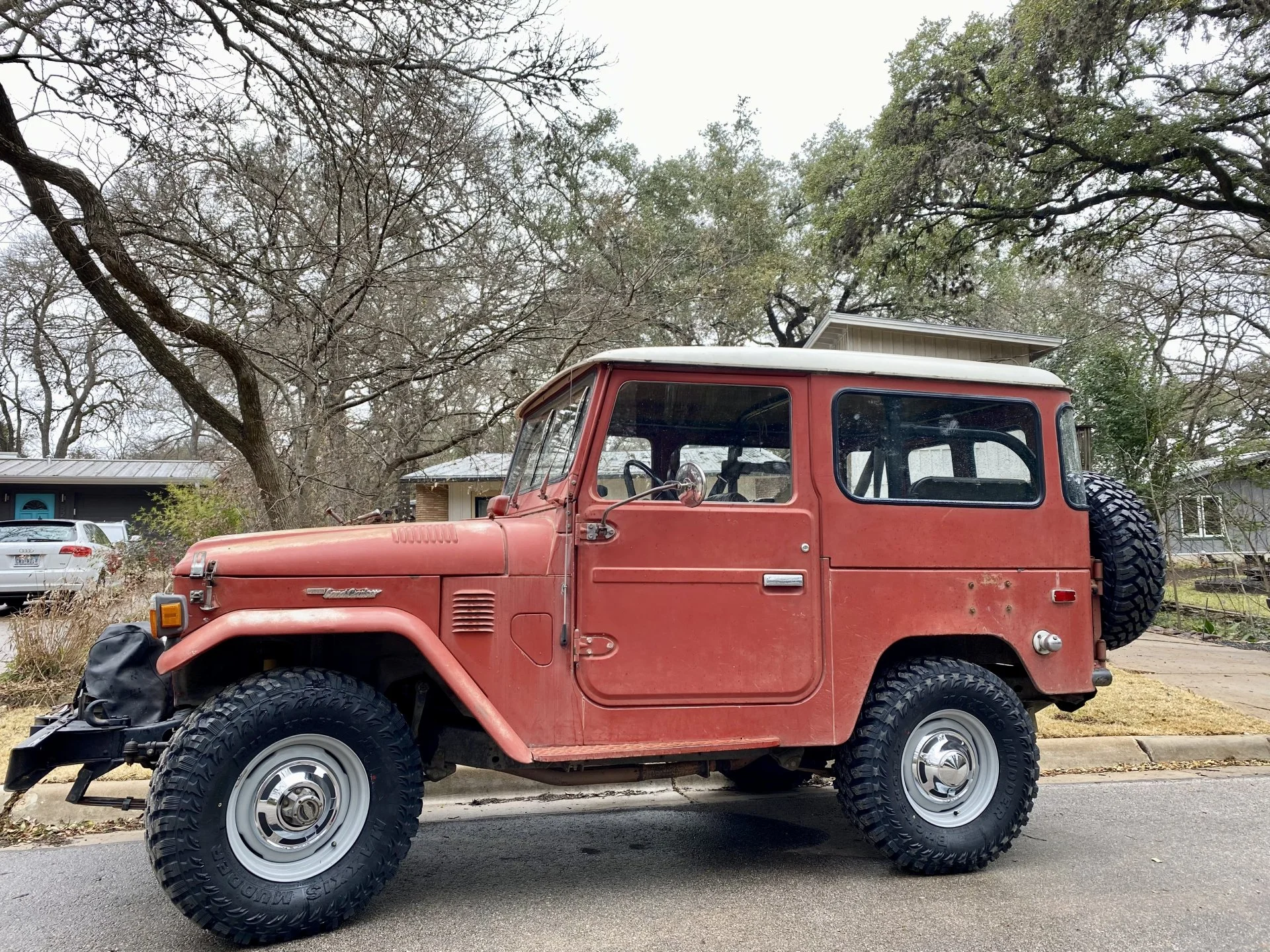

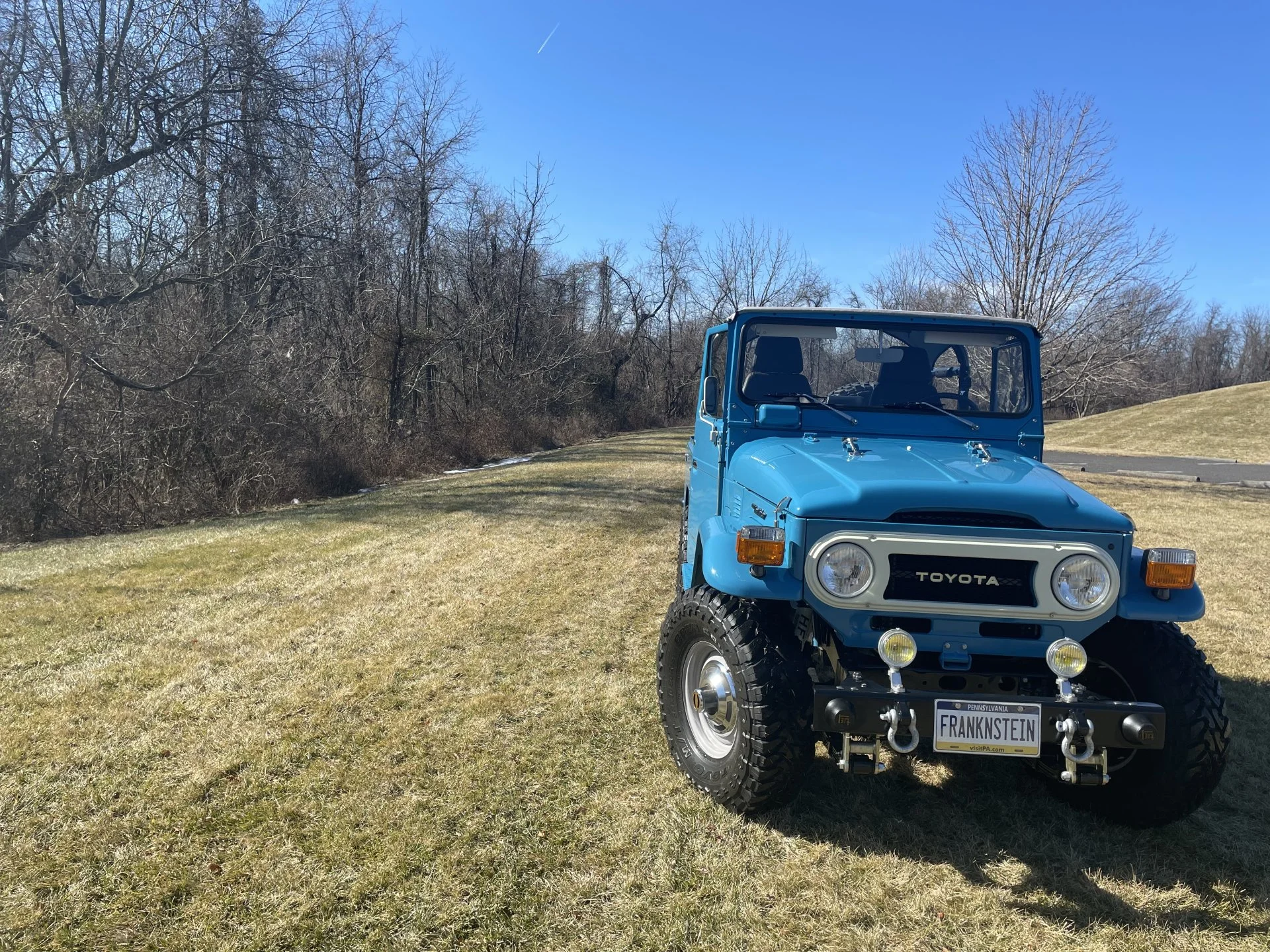

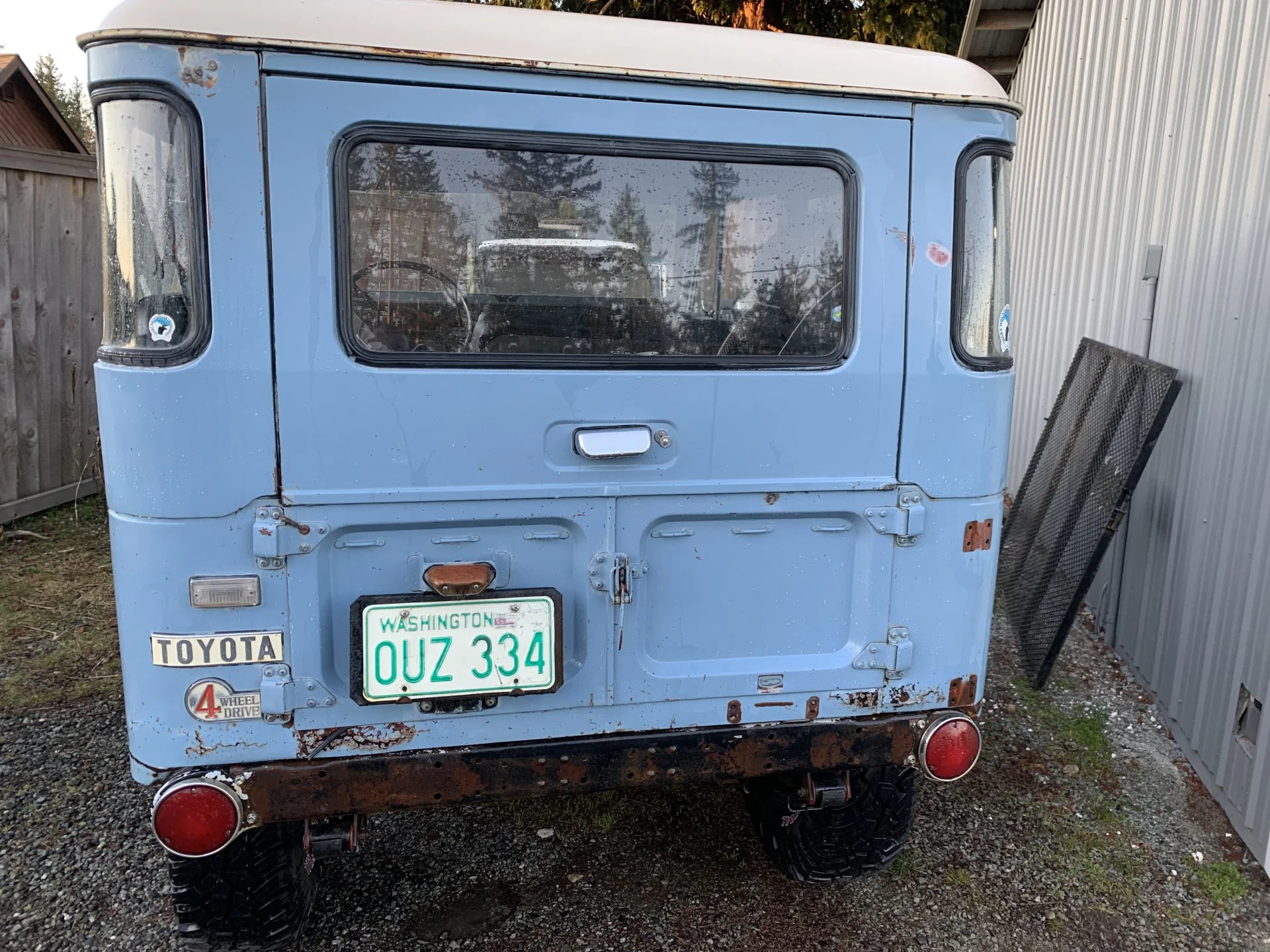

Installed new wheels and tires, replacing the old chrome plated aftermarkets that were on there. Went with the skinny look
Finished buffing the whole thing to get rid of the chalky oxidation. Used CLR in the rear sill where a little rust was poking through and where the tire carrier hinges bolted to the tub. Looks way better now but I should’ve taken better before pics.

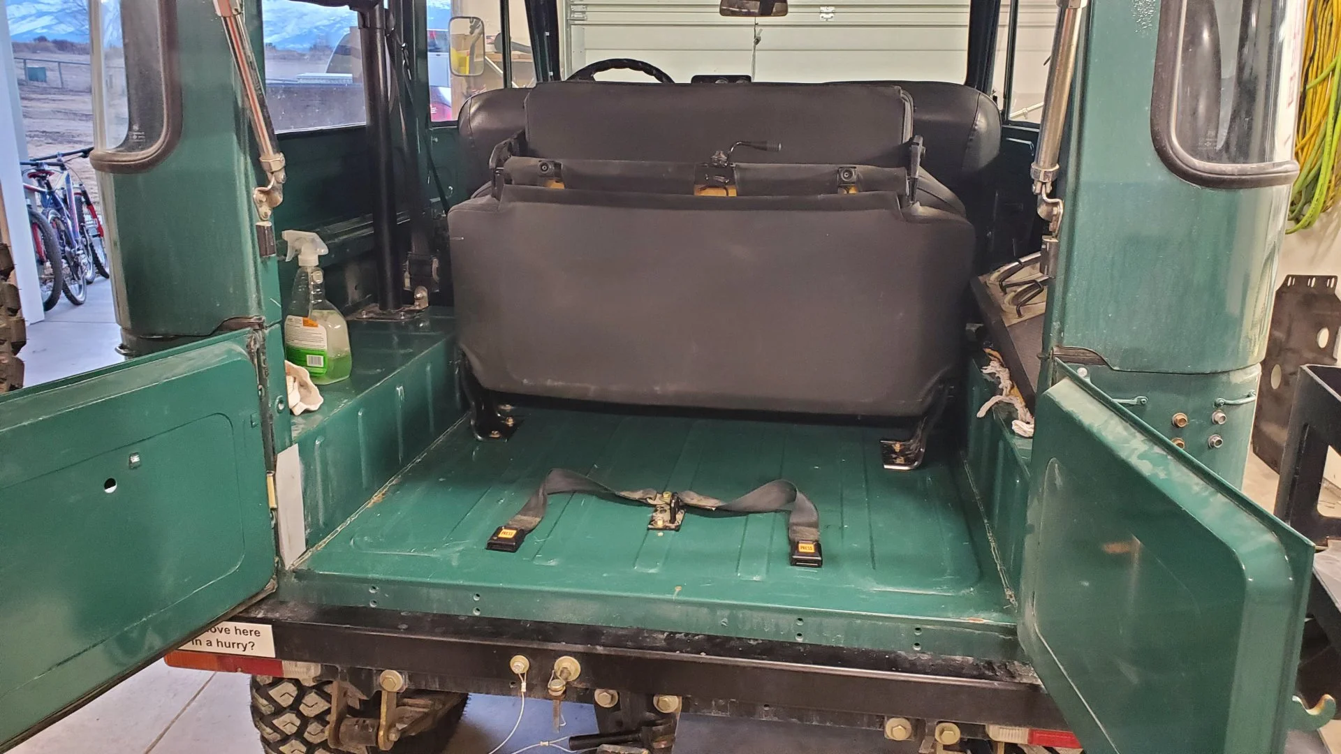

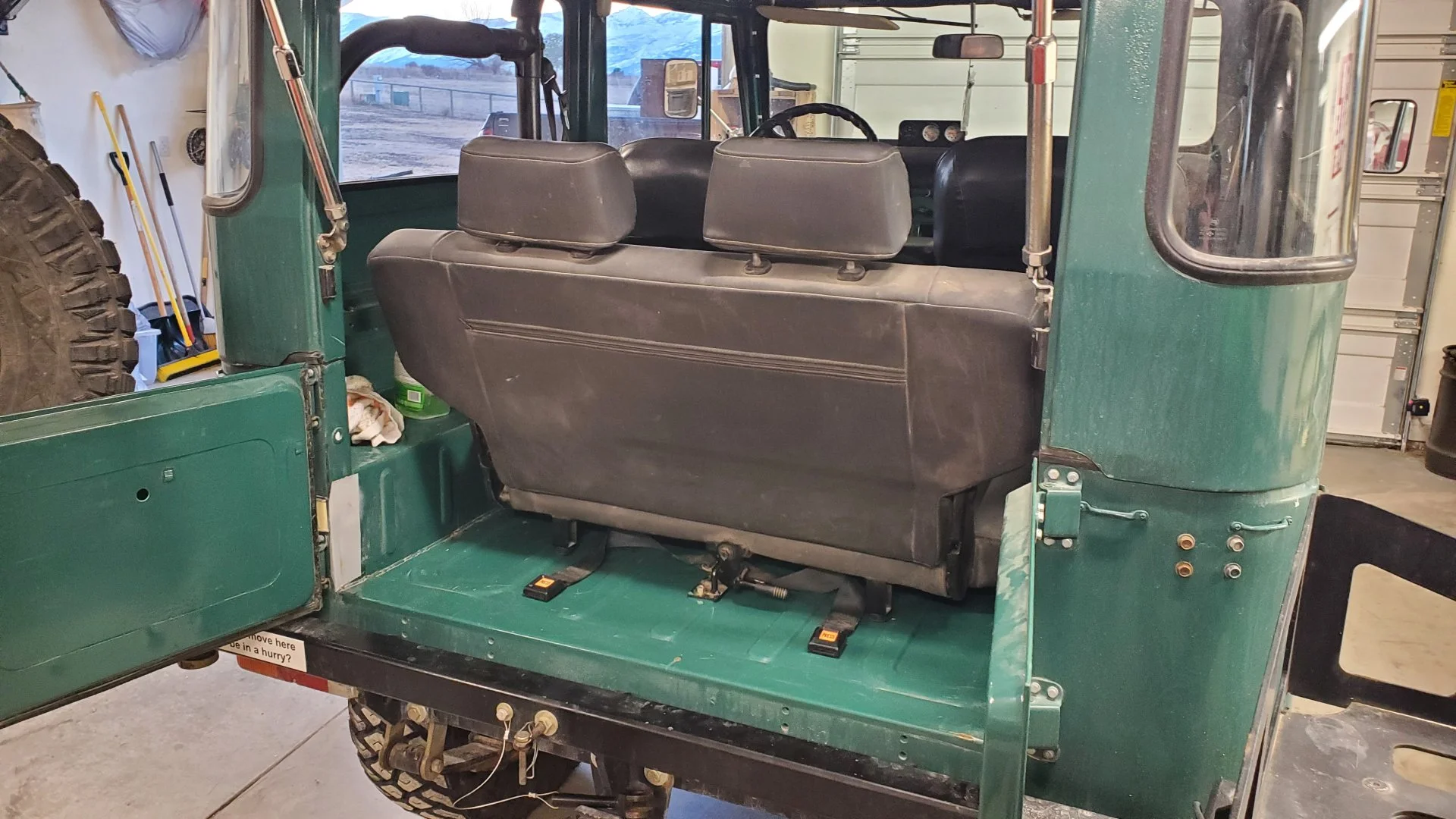

Swapped my fold and tumble in place of the smittybuilt box. Found a small nymph in the back, something that I never fish with! Could have been @desmocruiser last summer!
YJ seat?
I’ve got a TJ seat for mine. Same basic design, but no cutouts in the back rest for wheel wells. More details on the install? Could it be mounted further forward?
It's the Bestop Tarilmax II fold and tumble seat. Super basic installation for it, the 2 front brackets and the rear latch bracket, I added steel plates underneath the body for each bracket for some added strength.
I'm sure it could be moved forward a few inches, maybe even up to 6 inches, I pushed it as far back as I could because my daughters are both tall.

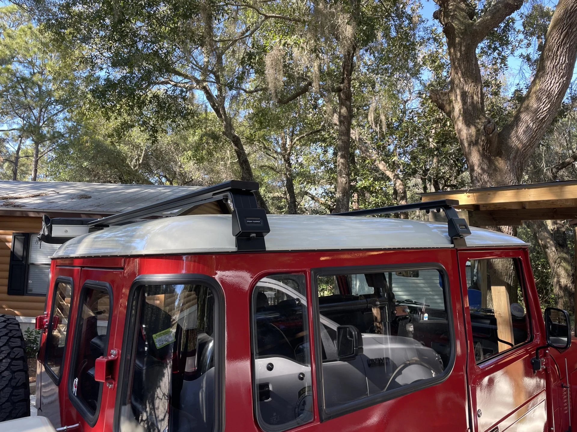

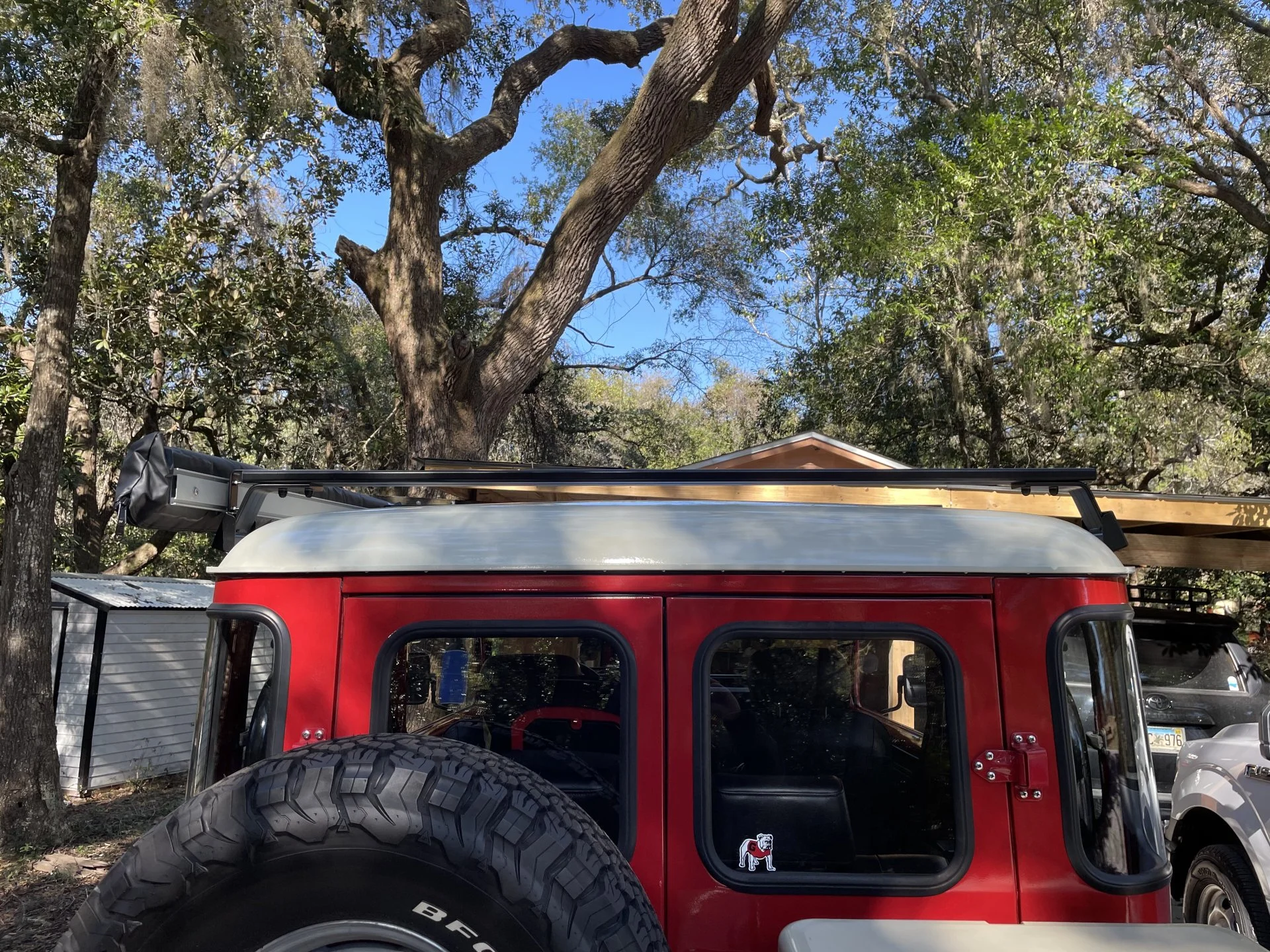

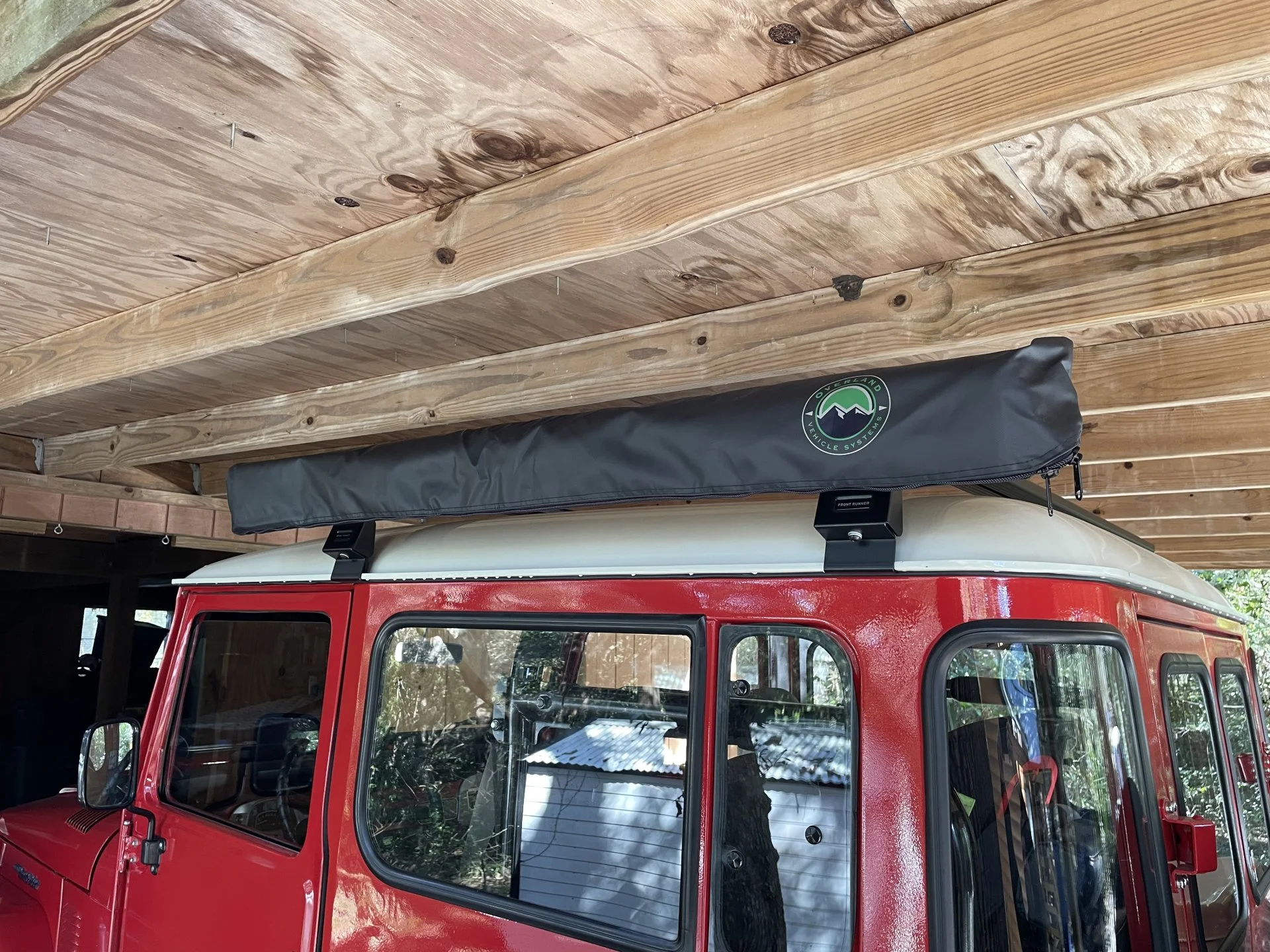

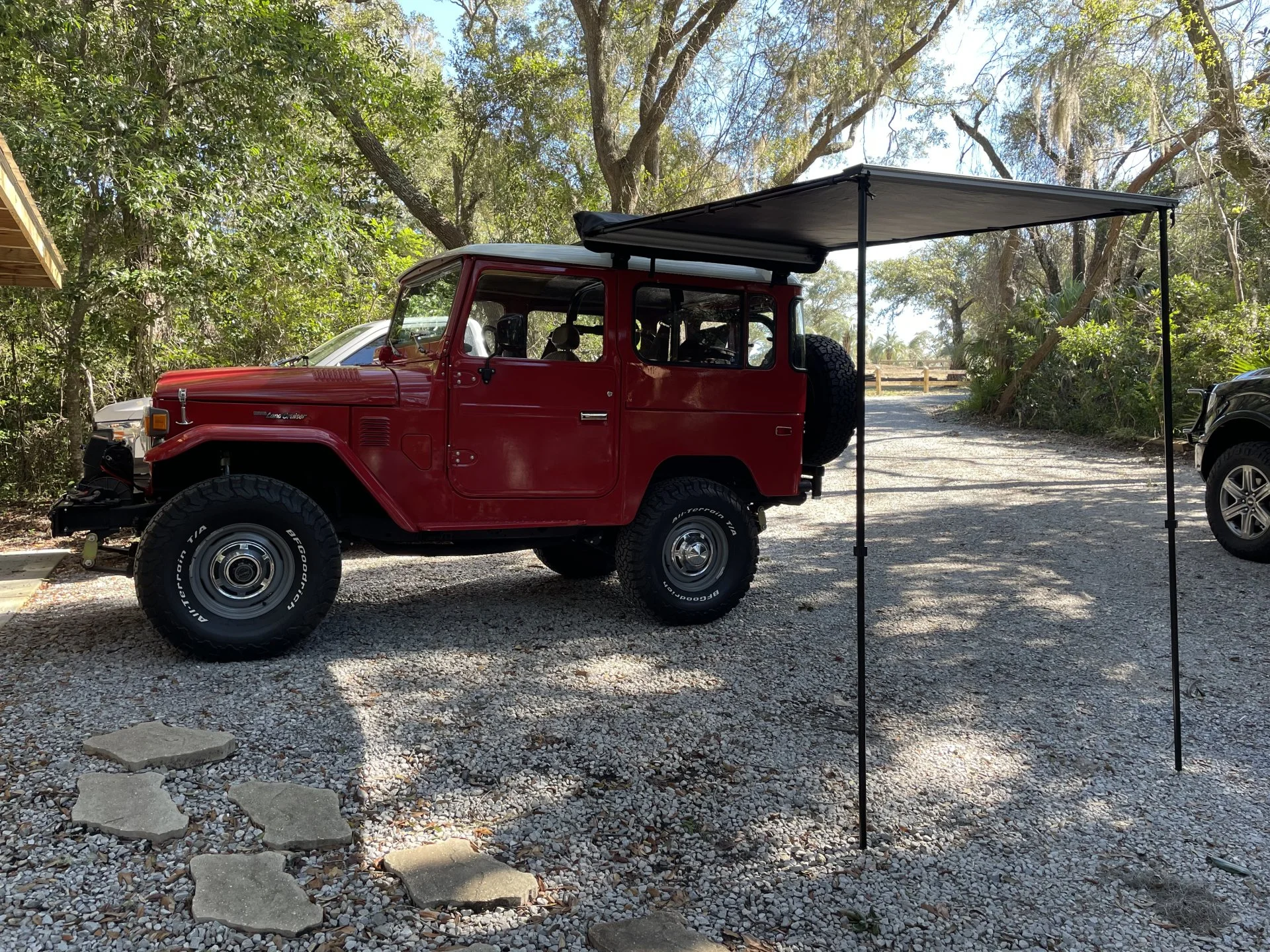

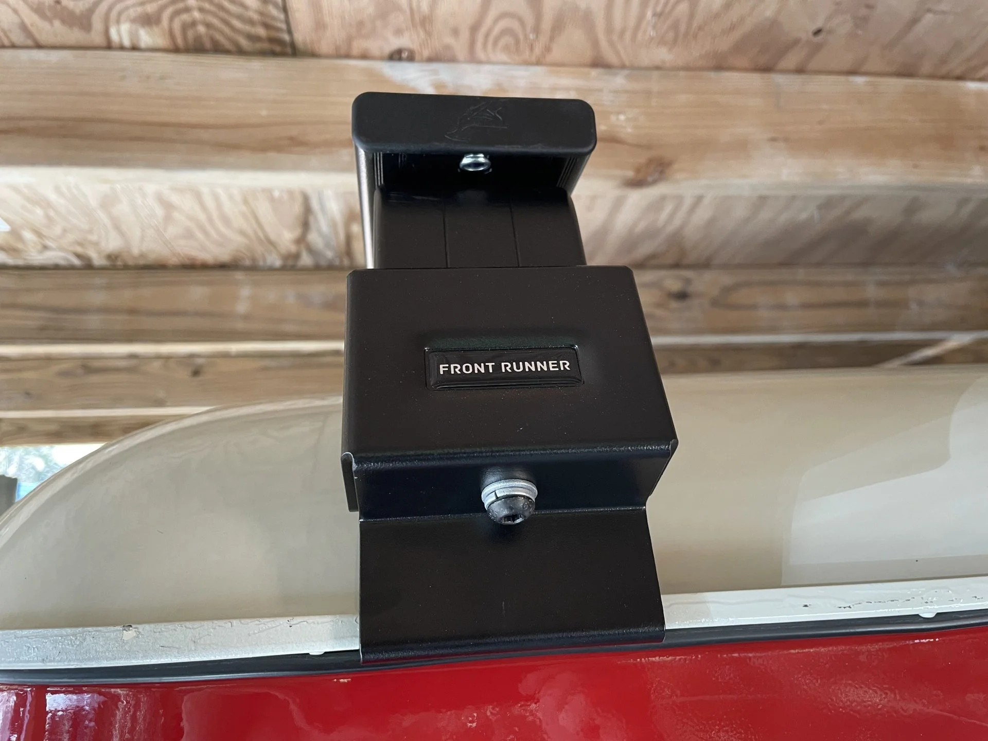

We are heading over to the St. Joe's in June for a few days in the 40 so I'm working out some storage options ahead of time. The roof rack went back on last night also.
Between the beer cooler and 3 Jerry cans I'm going to have a packed rig.
Unless I borrow a raft, then I'll have a trailer option!

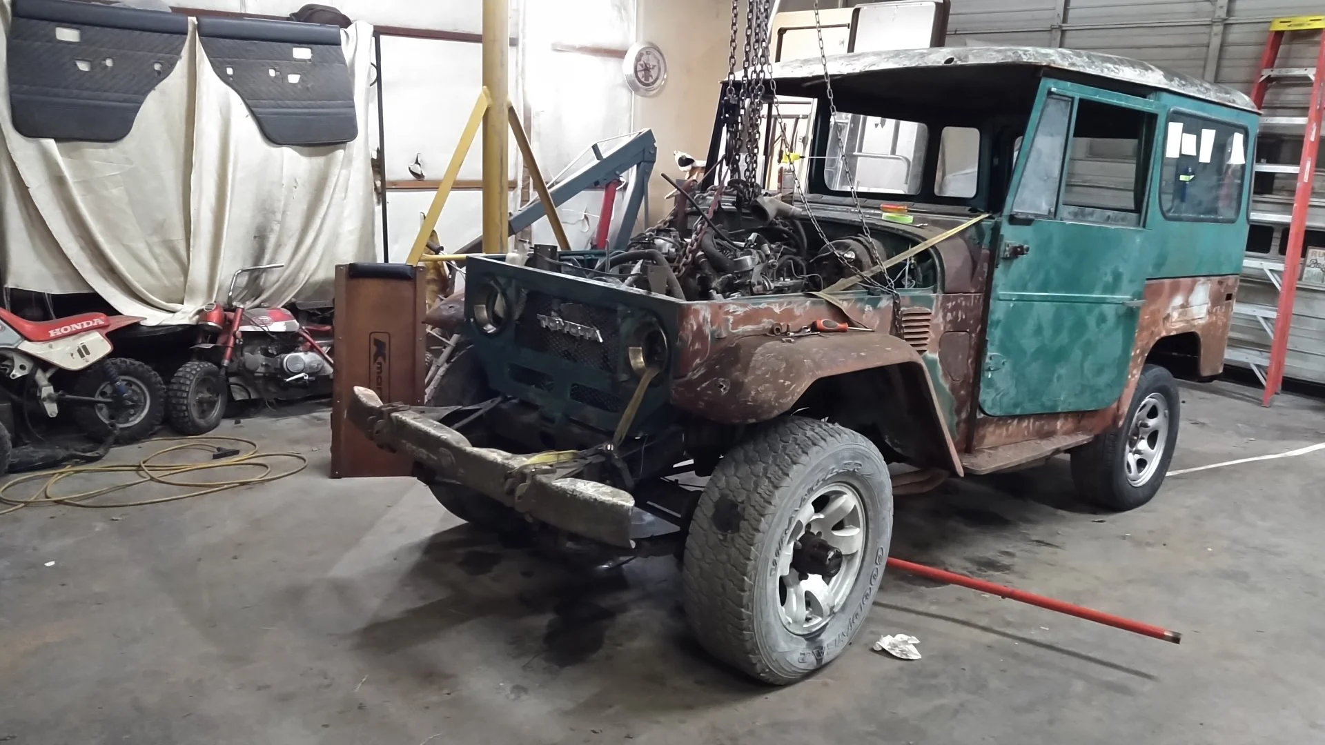

After 2.5 years took my rig out for a little drive. This is the first time since the major rebuilt. Tried to calibrate the dakota digital speedometer but 0 ppms, so i need to check wiring. Also ran out of gas twice as I took it to get gas and calibrate the fuel system. Not luck there either. My ohms jumped all around. Does anyone have an opinion on oem versus non for fuel senders? Im leaning toward city racers oem one.
I also bled my saginaw and hydroboost brakes going lock to lock 5x and then 3 pumps of the brakes as one cycle...40 times. I finally have power steering.
Lastly, timing via the sniper was all over the place. Watch and modified my timing table based on the holley video, but following it exactly, Im seeing as high as 23 degrees in idle bands and 45 in strong power bands so Im a little worried.
But it was awesome even for a short drive.

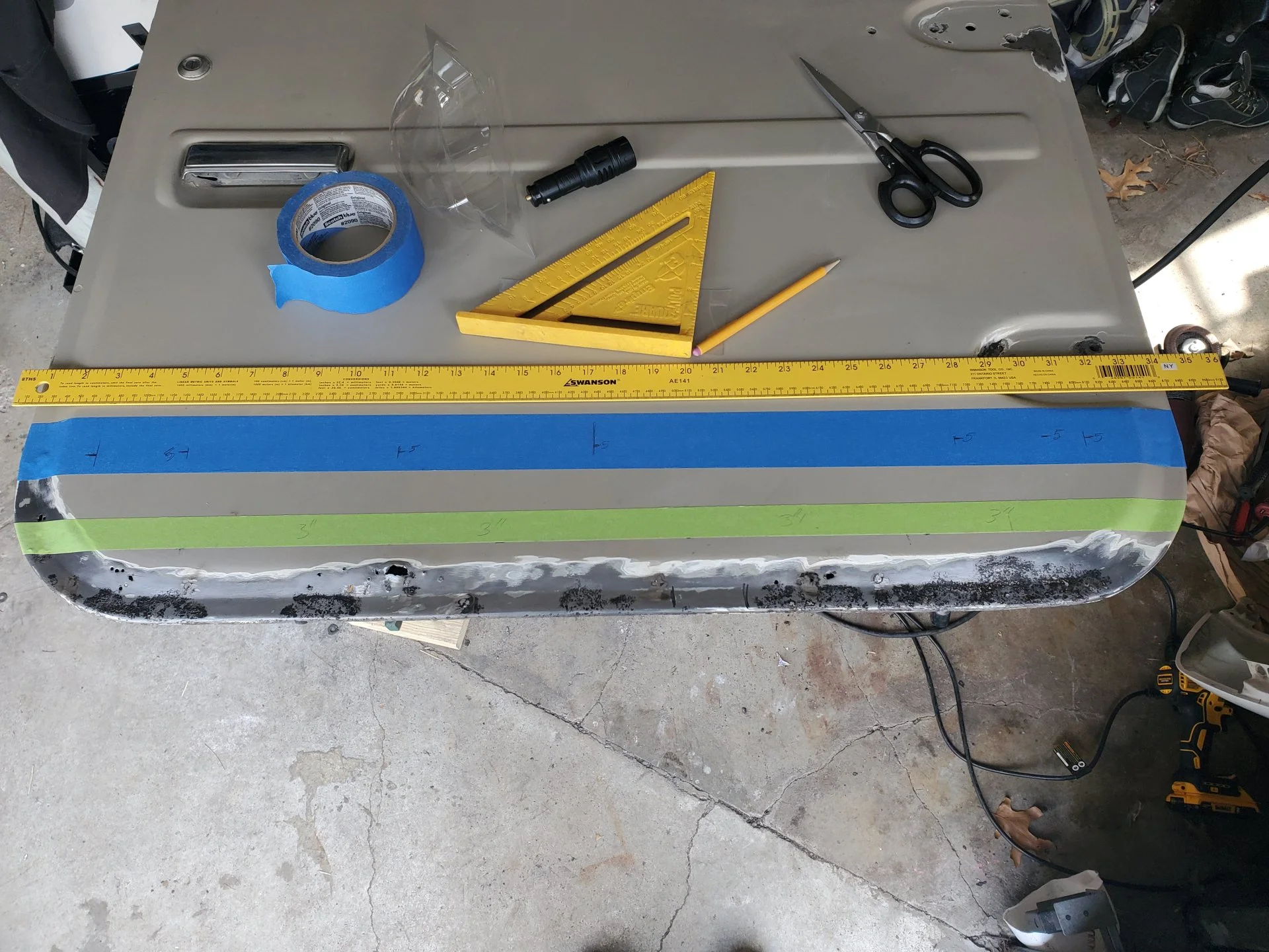

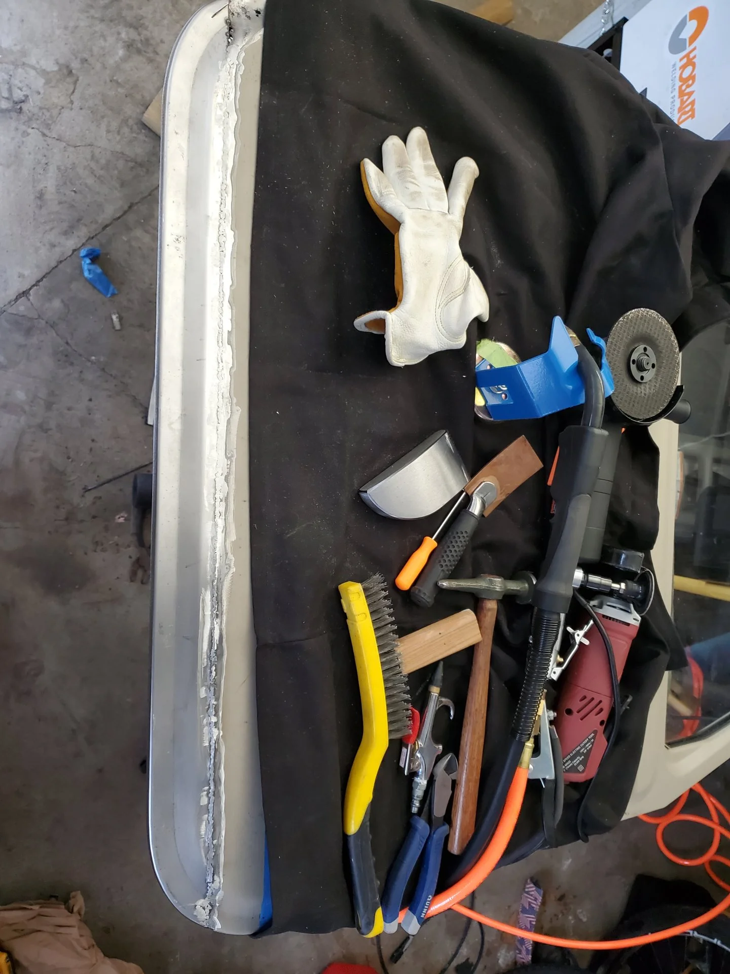

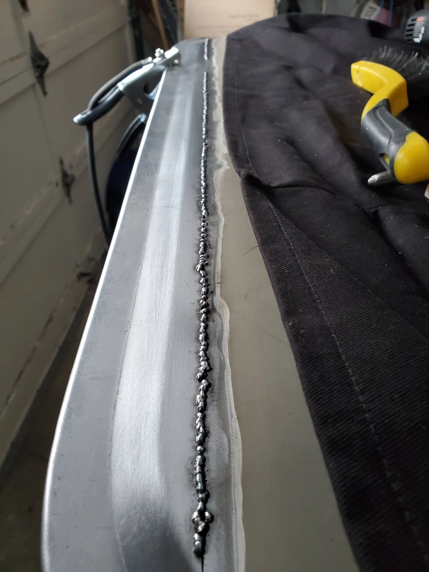

Replaced bubling paint, rusty door bottoms on passenger side door. It took almost as much time contemplating the cut than the actual cutting and welding.
Nicely done- from what I can tell in the pic, it looks like you were able to avoid warping the door. I'm impressed. How'd you pull that off?
I tried everything and still basically ruined my doors and had to pay out the wazzu for a good used set to replace them. :(
