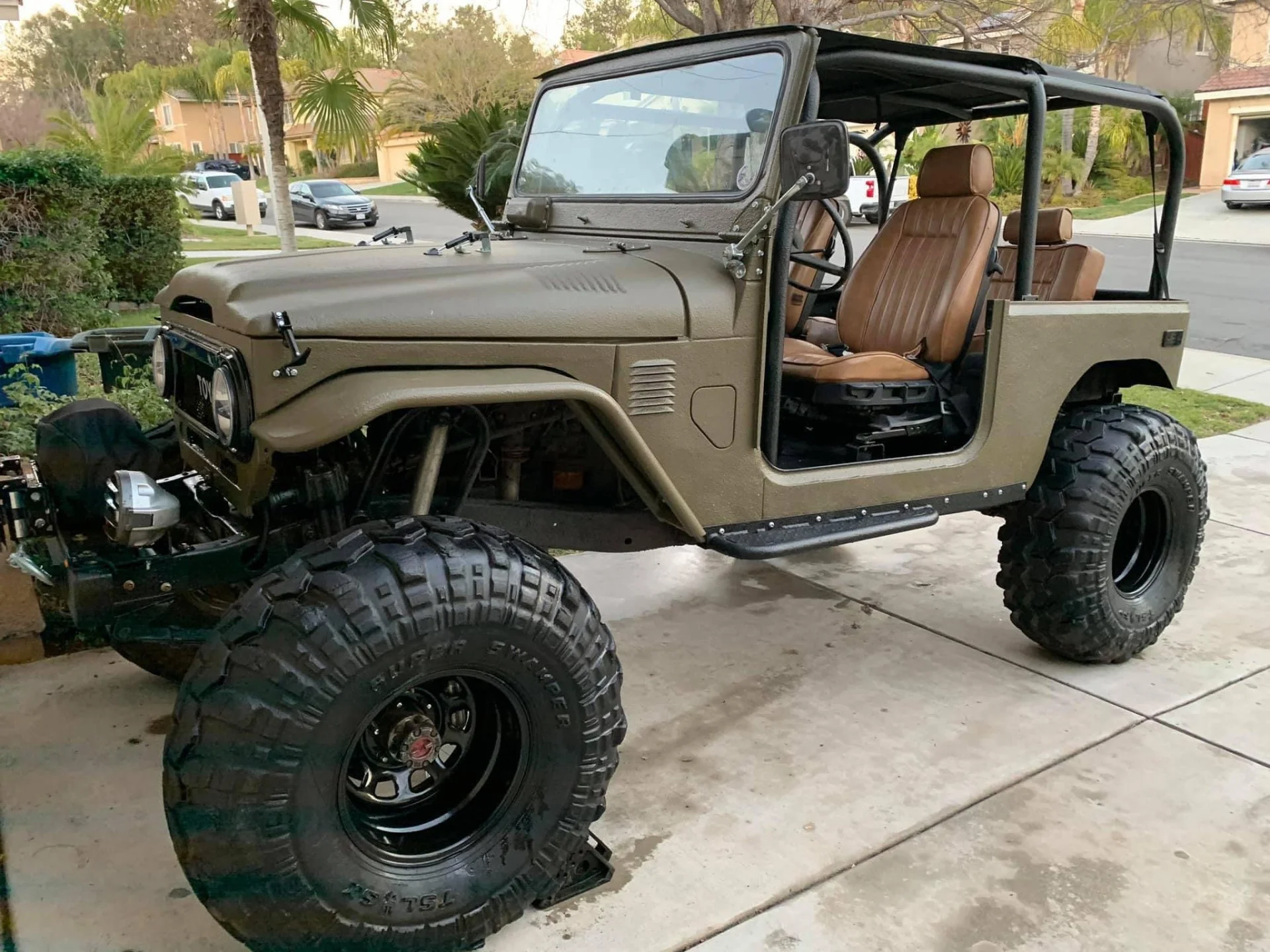

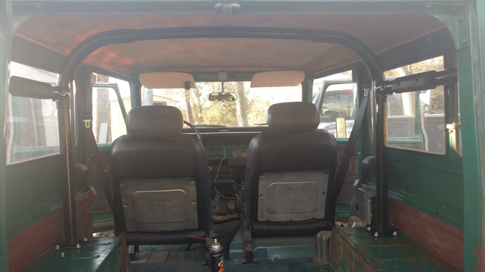

This weekend I was finally able to get my factory rollbar back into the FJ40 for the first time in 11 years. It went through some rehab and paint; it's still got some gnarly battle scars on it, but that could describe my whole ride :) .

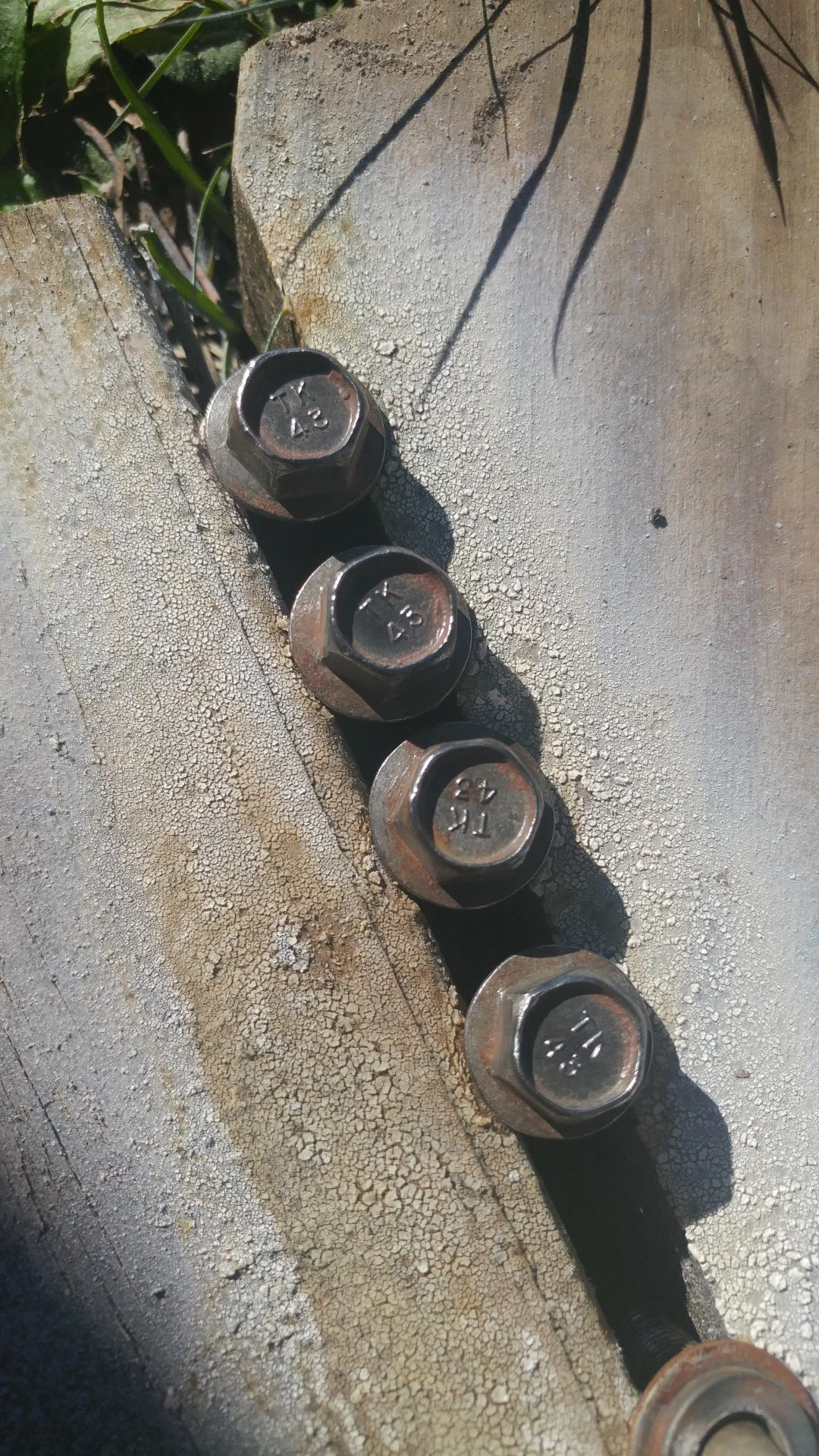

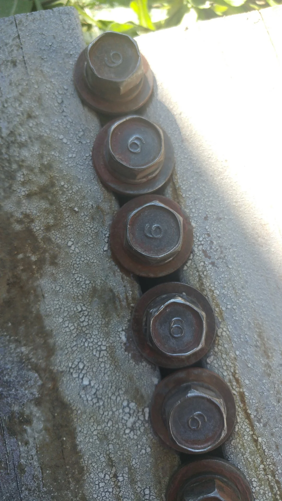

I ran into something that I didn't know about the rollbar bolts, so I got on the forum to try to find the answer. Surprisingly I found about 4 threads asking the question, but without a real clear answer, so I want to drop some rollbar bolt 101 stuff right here that I figured out. So, each downpost has 4 bolt holes. 3 of them are standard fare, M10-1.25 bolts, original part number 91651-61025, 12 needed. These are marked with a 6 on the head (maybe 9). They are available to order from Toyota, but I ordered some in December that still haven't shown up, so I cleaned up the original ones.
Now the fun part. Each downpost has 1 bigger bolt. It is located at the inner-most (towards center of tub) front-most (towards the engine) bolt hole. This bolt is SAE 7/16-20, but, with a 14mm wrench head on it. Luckily I still had all 4 of these unicorns. The original part number 90101-11465 is showing as discontinued. The head is stamped TK 43. The old MicorFiche scans incorrectly state that 2 are needed, it needs 4. It dawned on me later that these are the 4 bolts used to secure the rear seatbelts, so it was the US market safety requirement, just like with the shoulder harness belts up front.

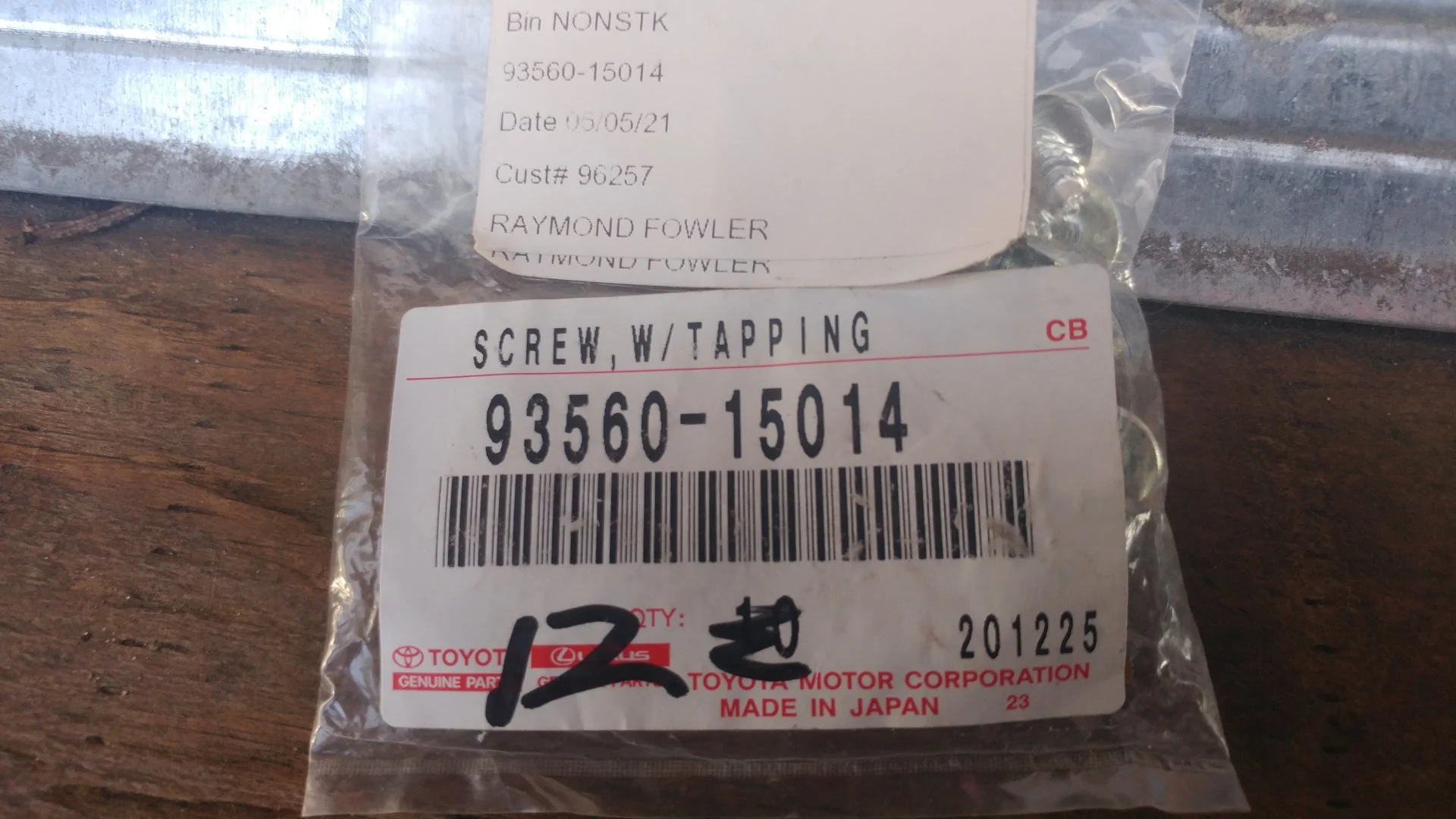

And lastly, my rollbar pads cleaned up really nice, so they deserved OEM Toyota screws to put them back on, part number 93560-15014. I hope this info helps someone out in the future. 🍻
Not 100% certain but I think your main hoop is facing the wrong direction, pretty sure the pads should be facing the rear passengers.🤷‍♀️

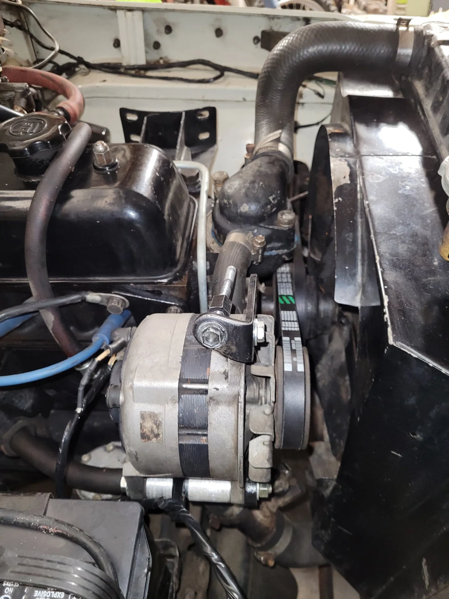

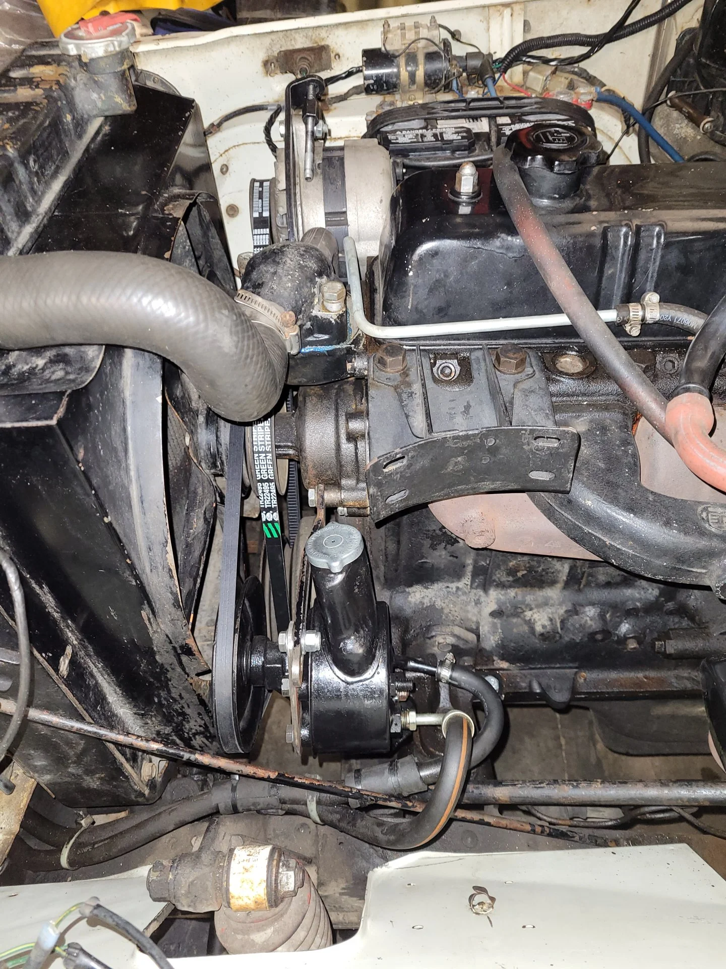

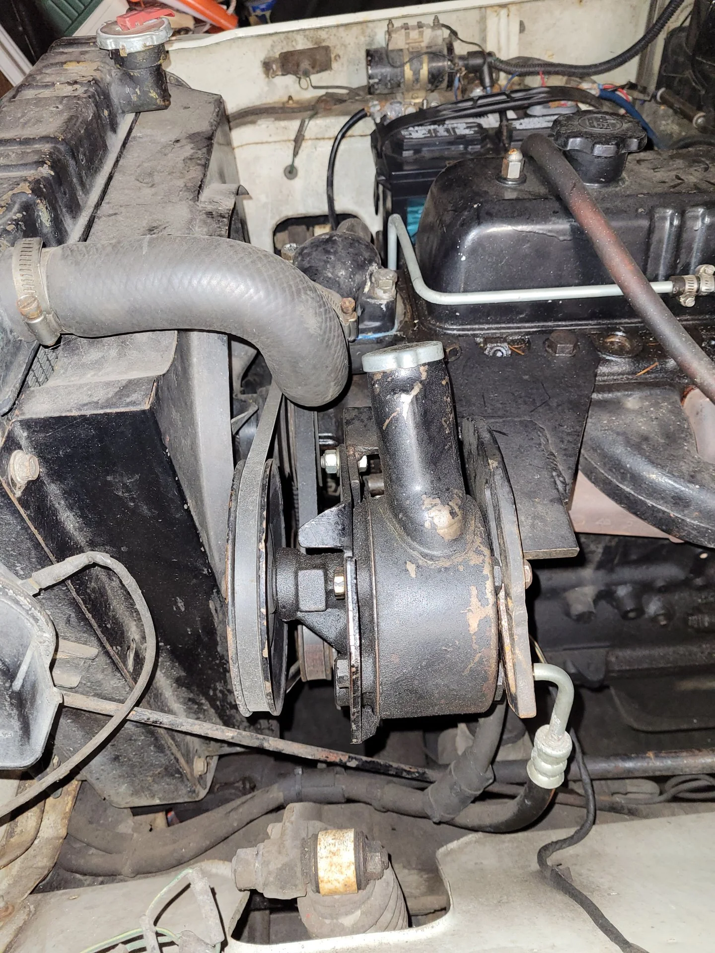

Moved my stock "F" alt to passenger side with a factory mount, belt did not line up when mounted as stock, so I made some spacers which allowed me to avoid buying a diff alt. Belt is good
Then moved my Saginaw pump to where alt was.

i can help here i think
- u already are set up for success with your " Abraham Lincoln DOUBLE Groove TOP HAT style Pulley
- Your Alternator Drive Belt now is a Optional Power steering equipped land cruiser 2F FJ40 / FJ60 8/78- 9/87 Factory Option VANE Pump equipped set up ....
- Because you do not have a smog pump the Inner water pump pulley groove you simply abandon all together entirely
- its hard to see well but i assume u have a 2 groove crank pully right ?
- same , outer groove belt routing
- no inner groove use
- now , really set up sweet
- all belts pulleys grooves aligned up as they should be
EXCELLENT WORK hands down !

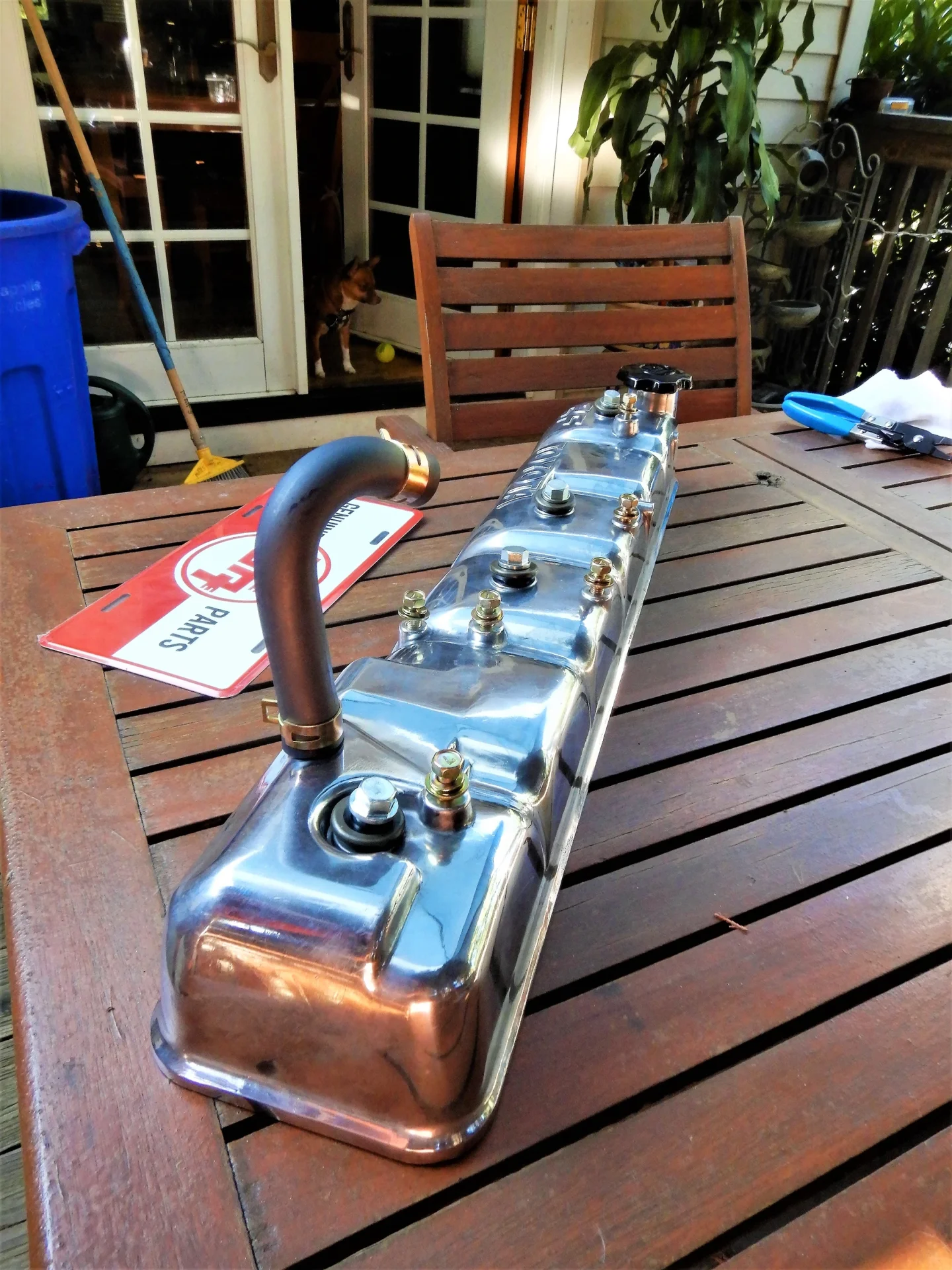

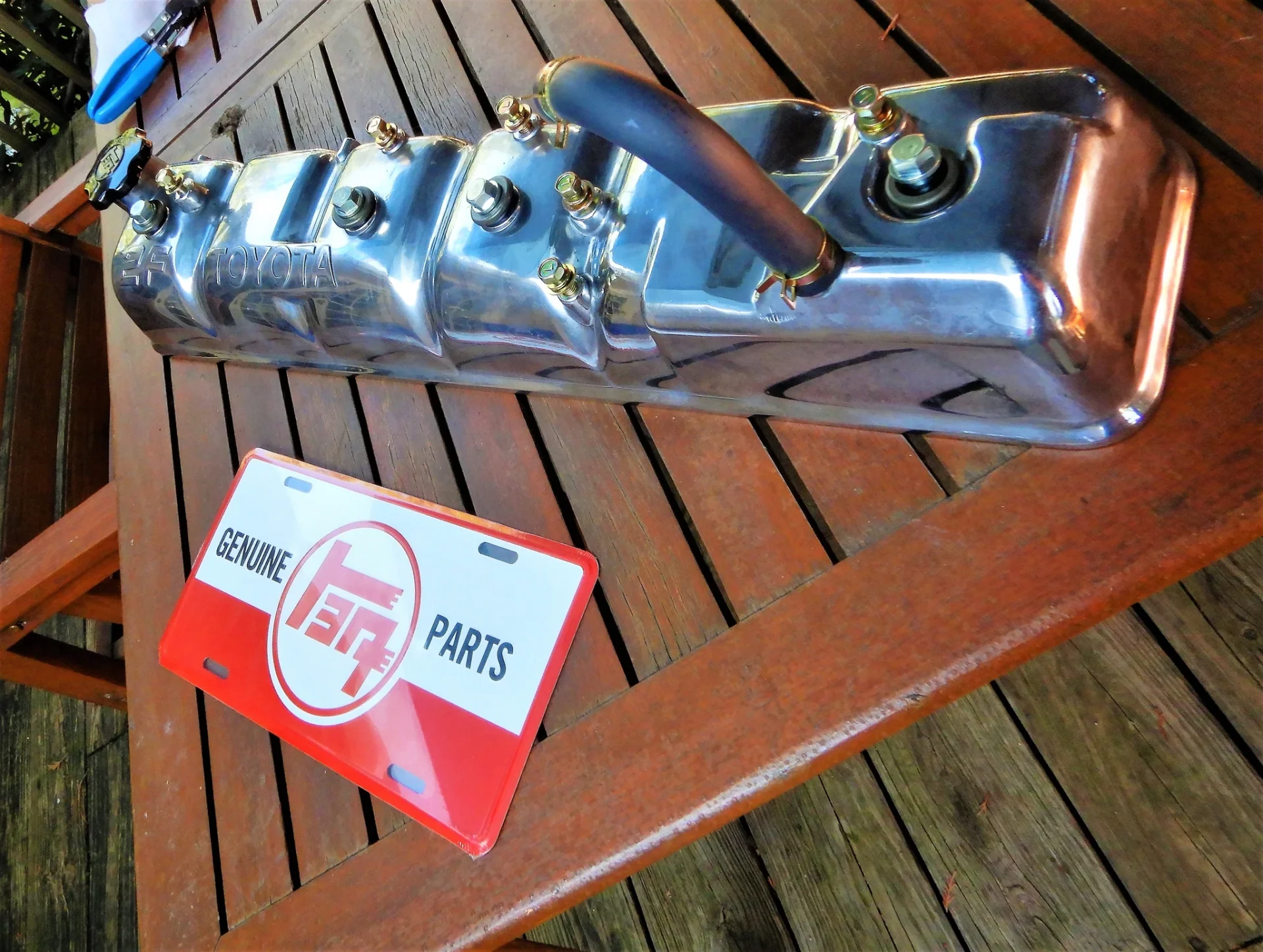

12262-66021
Valve cover hose ih8mud
Seems like the same thing. Might be cheaper going through Toyota or ebay. OP on thread said it needed to be trimmed and this was to fit it onto a 1f engine valve cover. Might not need any "trimming" if you need to fit it to a 2f cover. If it fit the 1f it should fit the 2f.
12262-66021

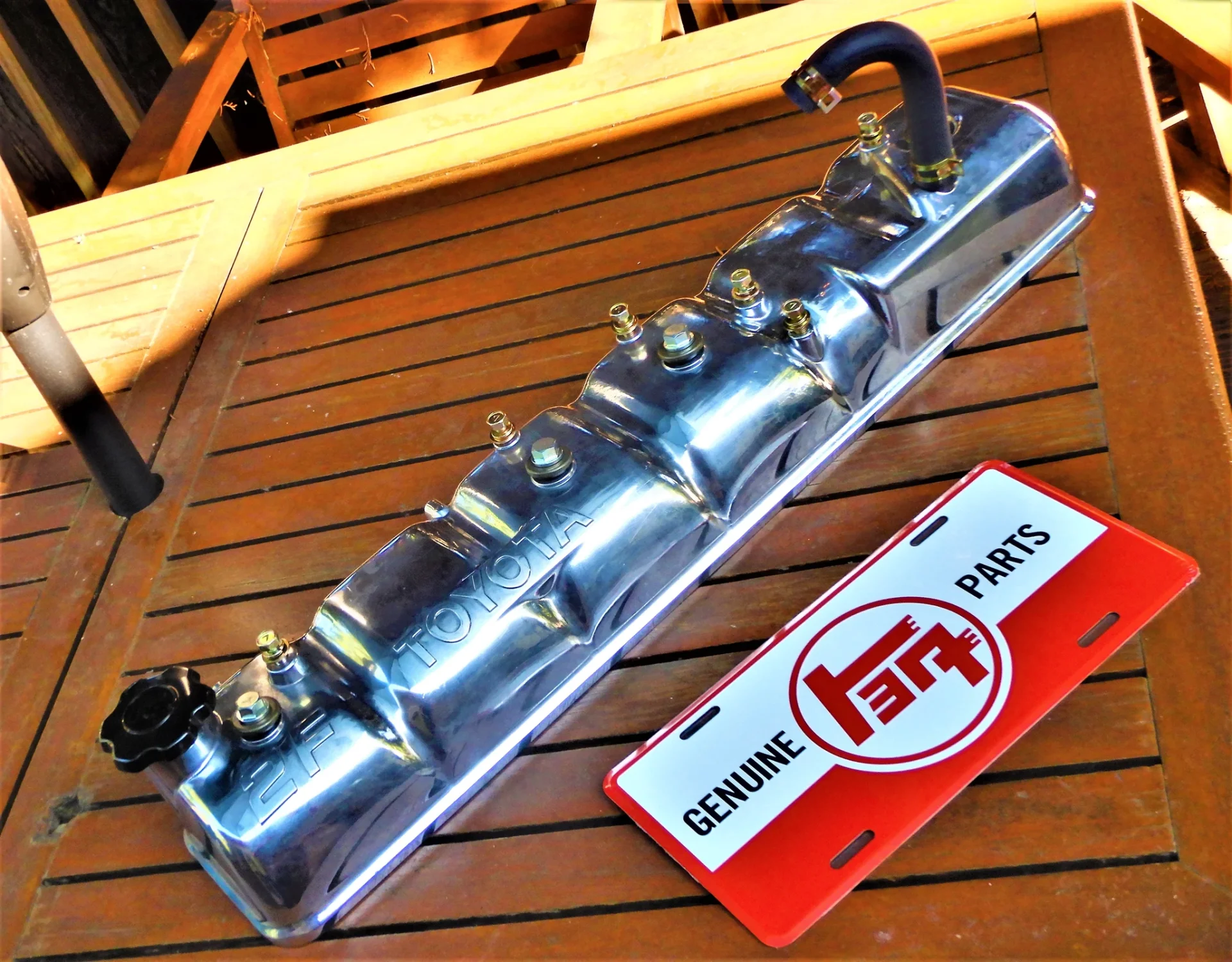

i am very familiar with the entire 2F valve cover to Air cleaner box breather hose topic , the 90910-06036 everyone now is needing ..
1/75-9/87 FJ40 / FJ55 / FJ60 has been NLA / Disc. for longer then i can remember , i strikes me as extremely ODD Toyota would AX such a wide range application
needed part so young in its life cycle ?
but they have done stranger things then this for sure , like stopped Importing the FJ Cruiser back in 2014 here in the USA-Spec. but continue spit them out from plant
A-11 for most of the globe ?
i was able to SKUNK-WORKS up a same in kind TOYOTA Genuine Part in JAPAN using my OEM Paper Print Media parts substitution and interchange chart and graph

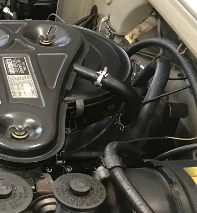

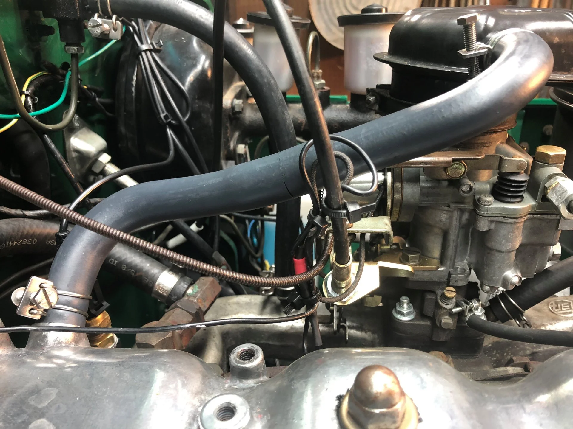

I can attest that OEM part #12262-66021 did not work in my application because the inlet or the valve cover is closer to the firewall than the stock valve cover. Hence the hose was to short. Matt's solution was a good fit for what I needed.

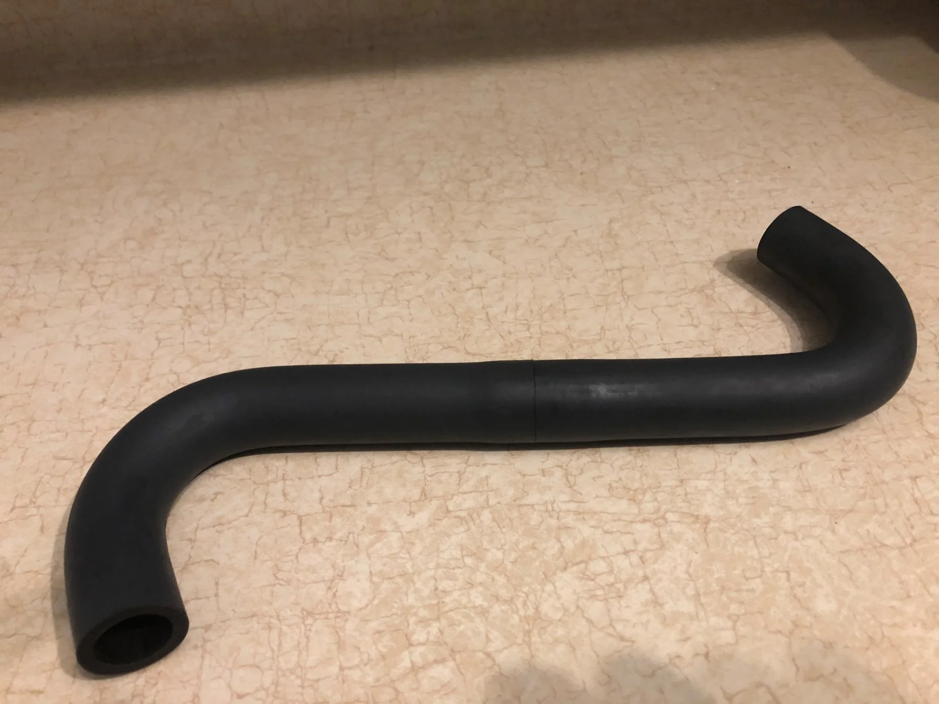

Installed a new air breather hose courtesy of Toyota Matt. The issue was connecting a 1975-1978 OEM F2 Aluminum valve cover breather to the original air cleaner assembly. Matt came through.
Is that new hose split? Looks like two 90910-05101 hoses put together? Pretty nifty idea.

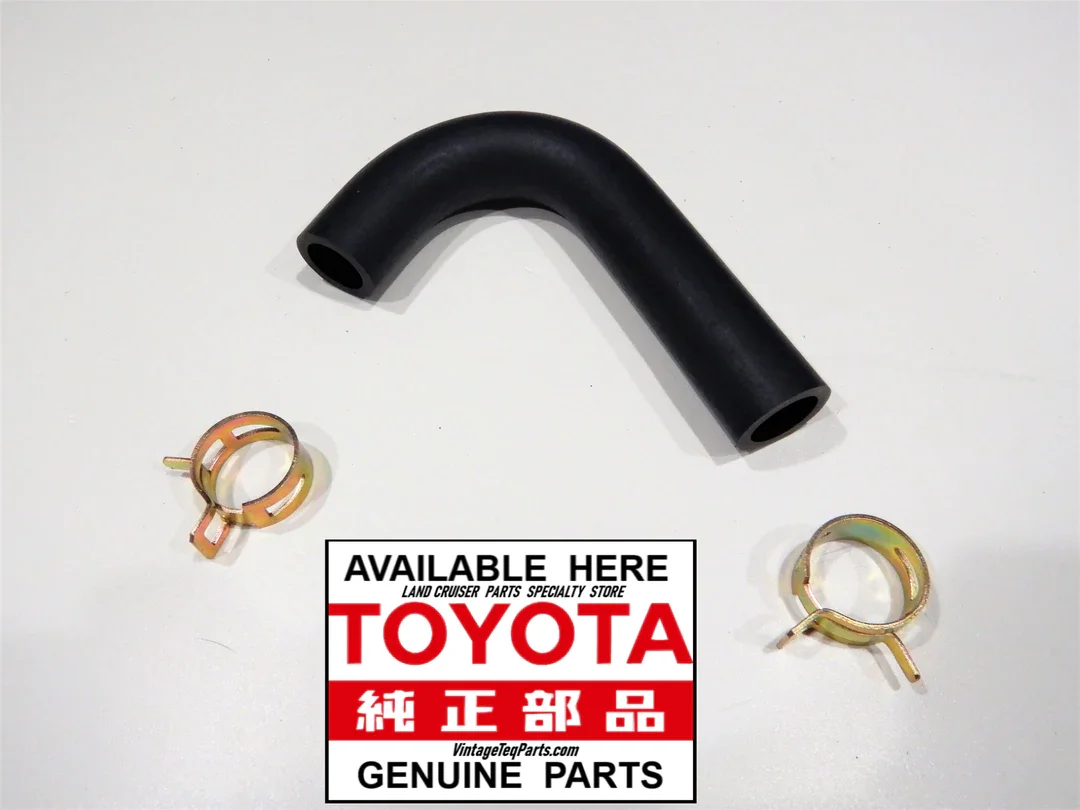

Installed the 90910-05101 (1/75 - 7/80) VC to Air Cleaner hose my '77 not too long ago.
I wonder if you could use the 90910-05101 as a substitute for the NLA 90910-06036 hose? Someone more knowledgeable than me might know.

ToyotaMatt,
I appreciate the response but an unsure what you mean by "unnecessary mis-alignment of your current 2 belts set up in the pulley faces"
Both belts , alt and power steering pulleys are aligned and run true.
Pic's may make it difficult to see this?
I am using a "F" alt on the 2F alt mount.
The 2F passenger side alt mount with the "F" alt mounted as a factory did not align the wider pulley on my "F" alt to the wide pulley on the crank and waterpump.
With the alt mounted and located to the inner front "ear" of the 2F mount ,the wide groove pulley perfectly aligned to the inner large belt sized pulley on the crank, water pump and alternator. Spacers do not locate the alt.
This allowed me to use the small groove pulleys on the crank and water pump and power steering pump.
Its all working as it should with no issues.
Crud. Yep, consulted the Microfiche and you are absolutely right, I should have done that in the first place. Thank you for pointing it out though, much appreciated! I have these holes in the front hoop that used to have a gun rack mounted in them and I used those to remember which way to face it. So I trusted the PO on that one :doh: I rationalized that the pads faced forward because you would fold down the front seats and get into the back and not hit your head on metal. Well.... I guess I know what I will be doing to my Land Cruiser this weekend :frown: After the Lovelady LoveFest parade of course.

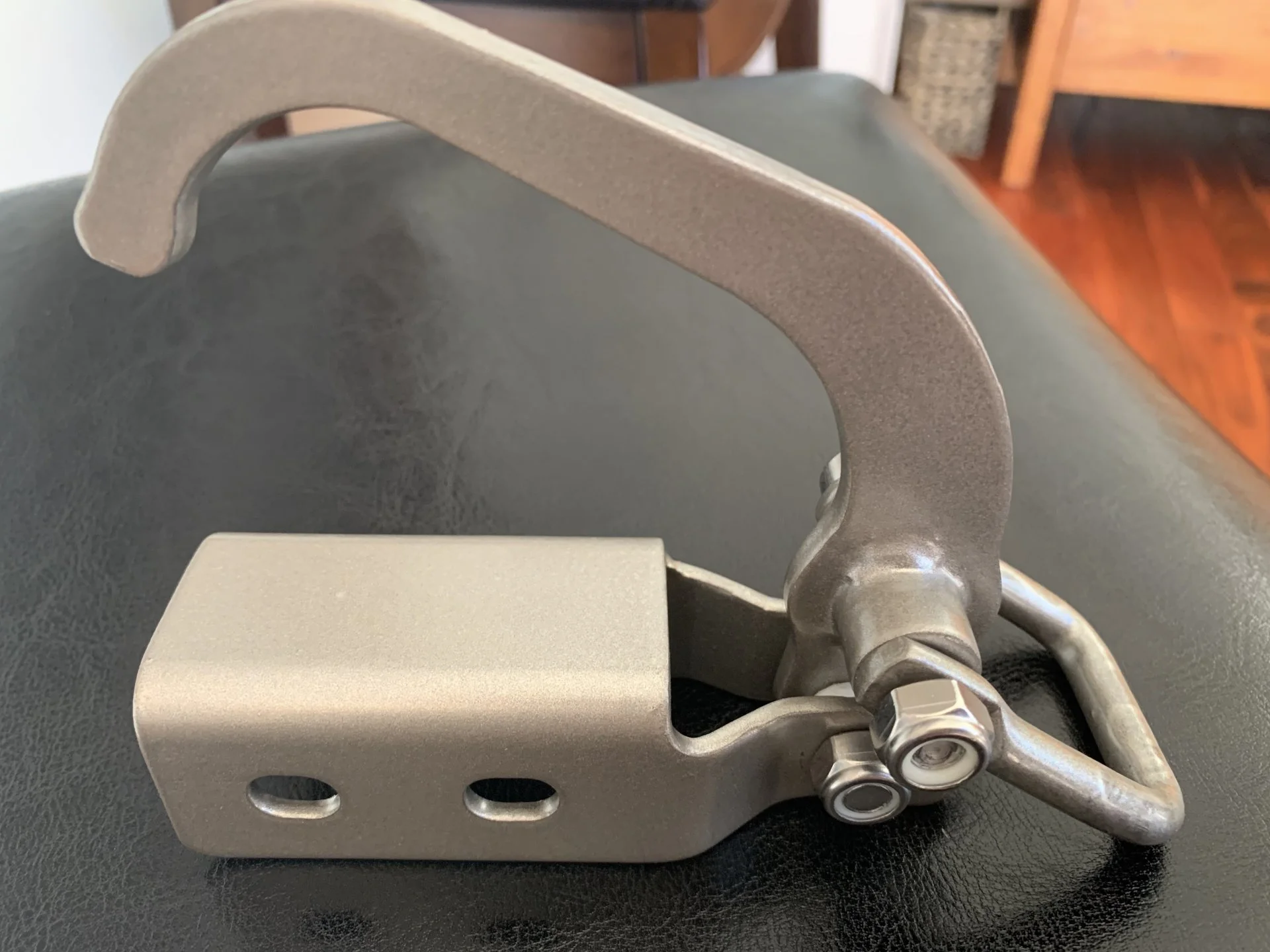

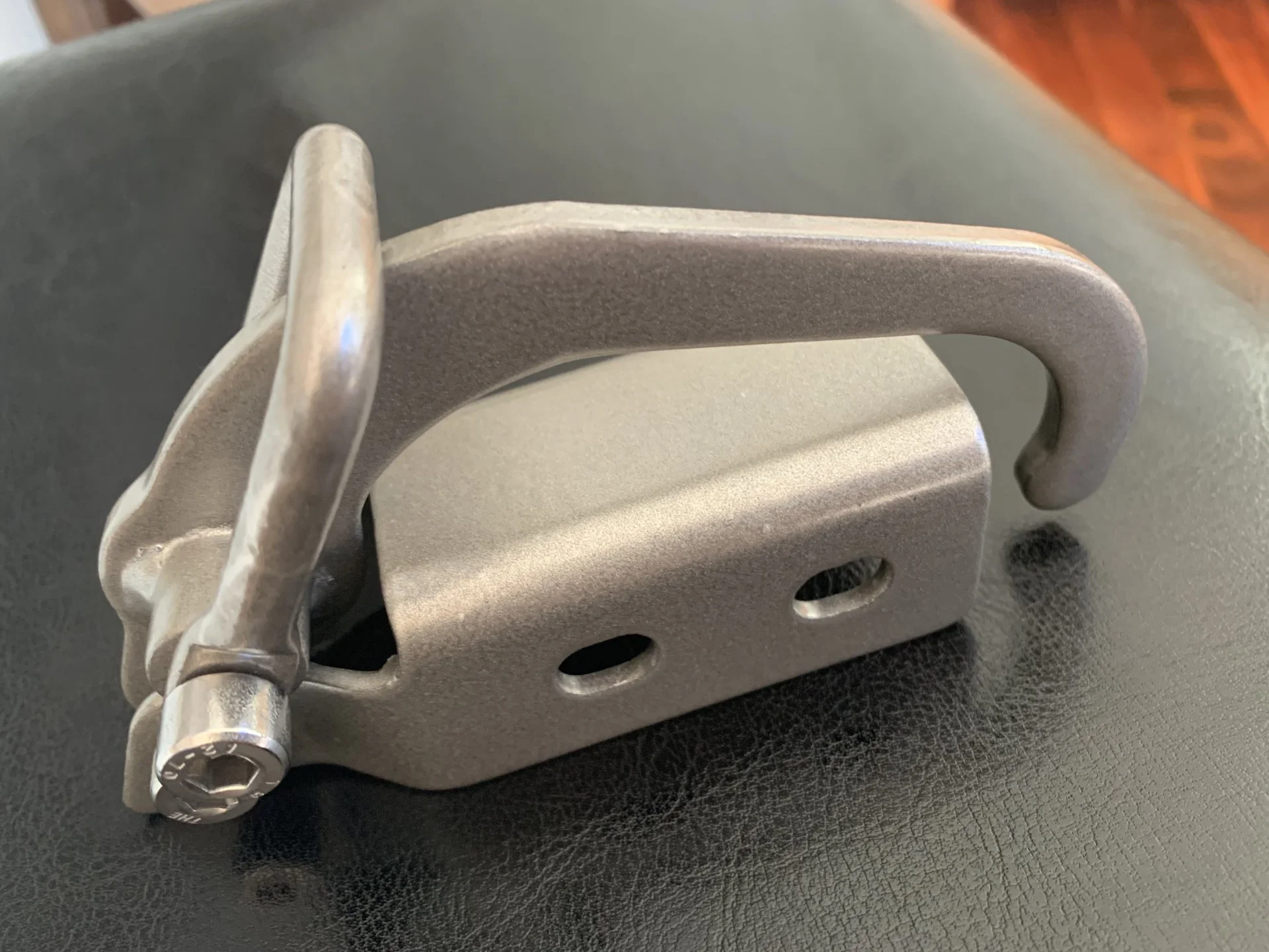

Did you make or follow a write-up on this. Would love to overhaul/update mine.
Thanks for the follow up. Finished the install yesterday.
  • Ended up punching out the factory pins. One side of the pin holes is smaller - I threaded each of the smaller holes for M8 bolts.
  • Powder coated the assembly with Prismatic powders Vegas Gold
  • Modified a nylon spacer to replace the metal spacers that had worn down over the years on the hook portion of the assembly (lower bolt)
  • Used a stainless M8 x 60mm socket head bolt on the upper hole, secured with a stop nut and added an acorn nut. This allowed a gap between the two nuts so I could include a spring from the handle to the carrier (like OEM).
  • Used an M8 stainless screw on the hook hole to allow for handle movement
  • Used two M8 x 50mm bolts and stop nuts to attach to the carrier
  • After all this I showed it to my wife for her amazement. I was the only one who was impressed, though :-)
