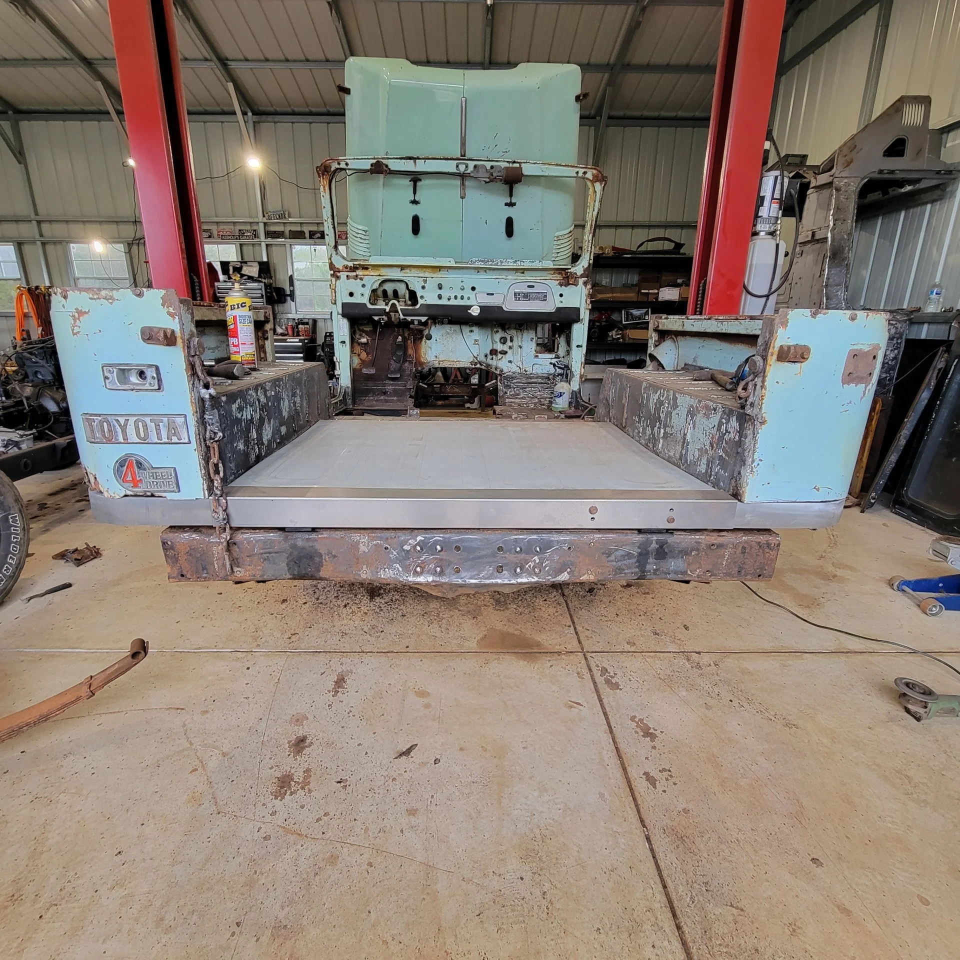

Got the rear sill and bed floor mocked up today.

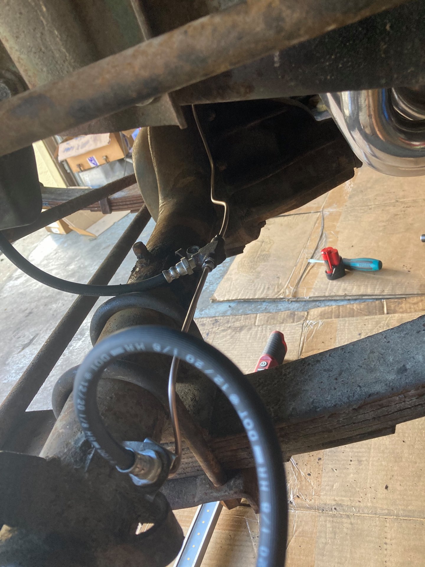

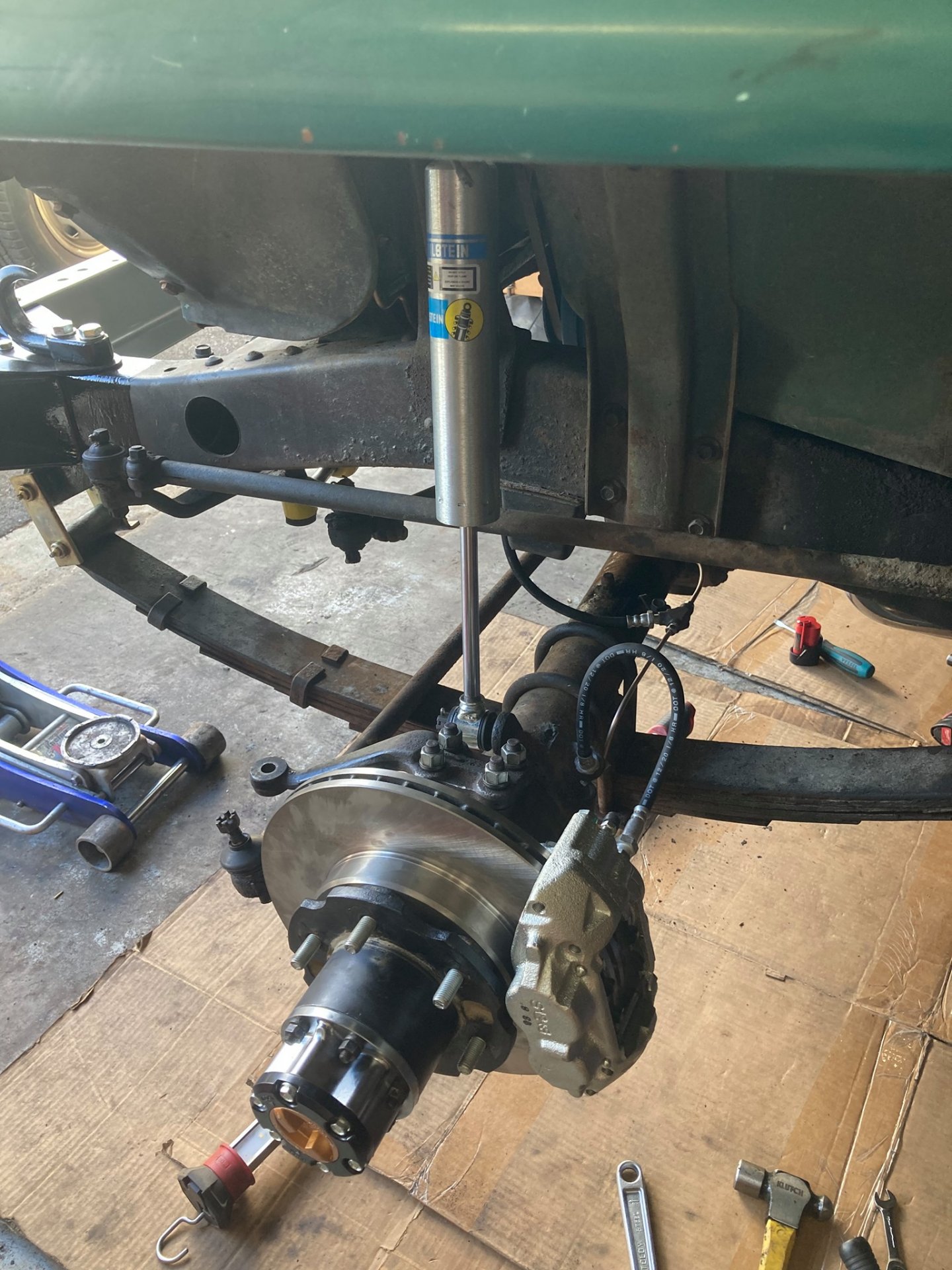

Disc brake/large-pattern/fine-spline conversion on @Fj40surfer 72 this week. Along with that we did new stock-height Bilsteins, spring bushings, pins, shackles, all new OEM brake hoses, and rerouted the front circuit hardline away from the header (It came in with the front hose rubbing the header collector).
View attachment 2813505View attachment 2813506View attachment 2813507View attachment 2813508View attachment 2813509
great idea on rerouting the front brake hard line, I will surely copy when I convert my drums to discs!
