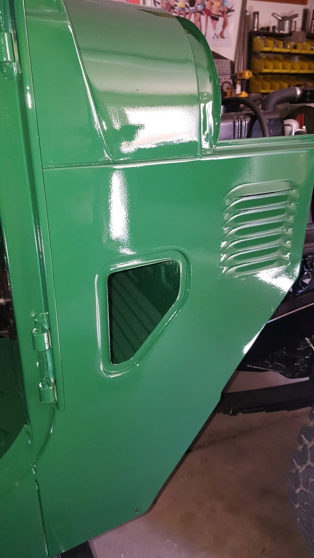

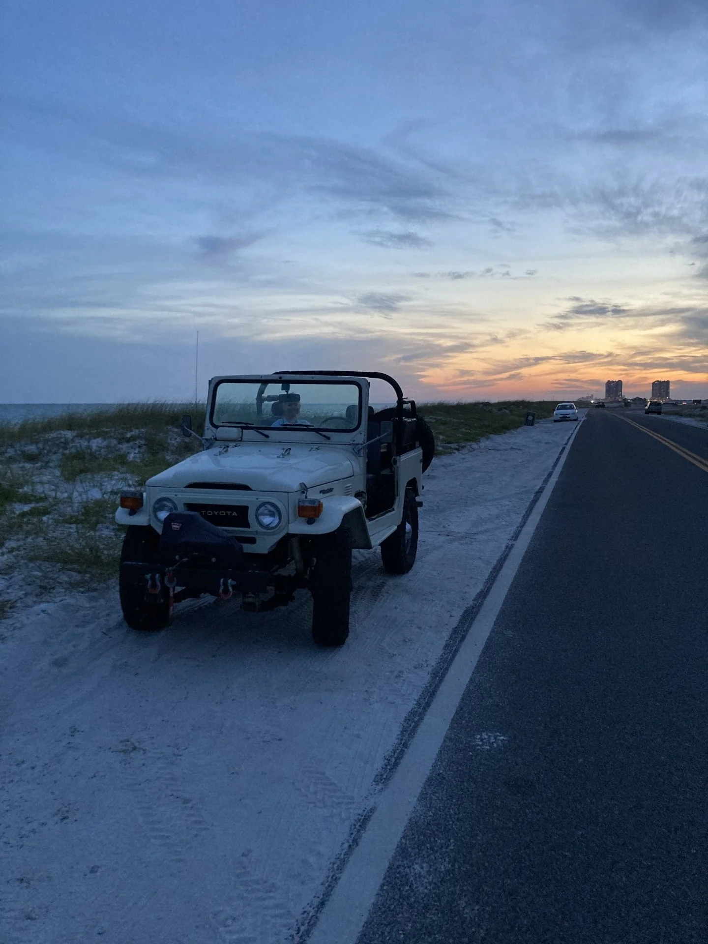

My low buck paint job turned out pretty decent looking. I am pleased. :smokin:

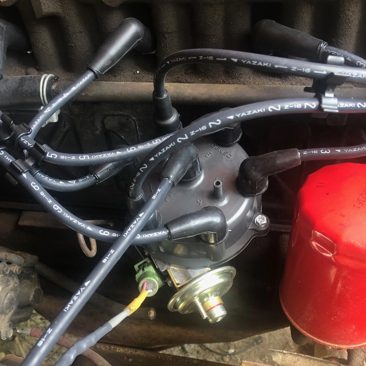

Small stuff for the '73. Installed FJ60 plug wires to accompany the FJ60 distributor. I think it took longer to order the wires than install them. Pressing the boots to the plugs and distributor cap was a reminder of how well OEM stuff works for the application. This engine had some generic loose fitting wires that I yanked and sent to the trash.

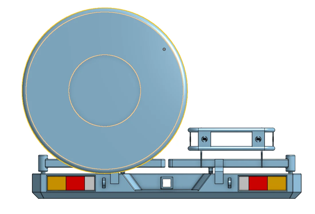

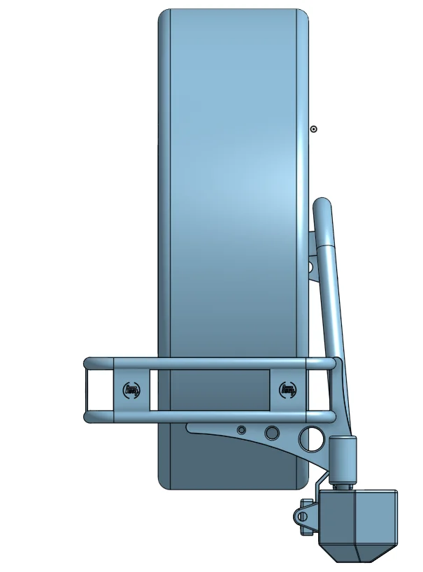

I finished a rear bumper design for @HAMBURGLAR11, sharing it if anyone wants ideas for a bumper. Let me know what you think.
It is currently designed for a 40" tire, and a 20" cooler, as of Hamburglar's specifications.
