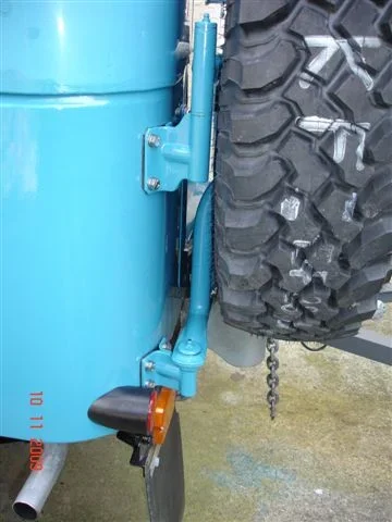

This arvo I took that annoying rattle outta the spare wheel carrier!!:bang:

are those for sale and if so how much do they cost ?
The rattle drives me crazy too. I need some for my 75 and tried day and night looking through hardware stores for the right size. I don't own a cnc machine or have the cash to have some made. Very nice job. They look like their made of brass and wondering if through time if the brass will be too soft of a metal to keep the integrity of their shape. Also noted that you have a new spare tire. Which brand is that?
My shorty came with the grease nipple, so that's not factory then? Easy enough to drill out and tap in the lathe if not.
My carrier had no bushes in it so I drilled the carrier shell out to 23mm in the drill press, and turned the bushes to 23.2mm outside, 20mm inside. The scrap brass bar was only $5kg, cheap and easy job. Maybe brass isn't the ideal material for wear but I'd say it'll last for many years, I can make some more when they wear out.

My spare is a BF Goodrich KM1 235/85 R16 Sepuku.
And I made my bushes to last forever and I think they will do that because you're not continually swinging the tyre-carrier back and forth (and vibration won't ever cause wear unless there is excessive clearance in a bush). Furthermore ... my material was "phosphor-bronze" which is specifically designed for uses as bushes (having low-wear properties).
Tyre-carrier bushes see FAR less use than door hinge bushes.
